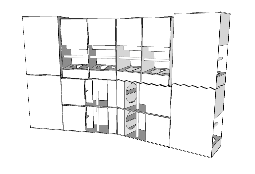

Hi Art,
I've been thinking about using wings of delayed end-firing arrays to double down on the directivity control. More like dreaming really 😀

Hi Art,
Dan,
Not sure what your array would do at any given frequency, but it is not what we normally call an end fire.

End fired arrays (as defined by Bob and generally accepted in the pro audio world) do not increase frontal area and forward gain (above the 6 dB per doubling of cabinets), they have less output than the same speakers in a large stack. They are often used for live shows because sight lines are obstructed with a large array of subs.
If one has the option of a large frontal area (whether a pile of subs or subs with wings), electronic means of achieving cardioid patterns are not needed.
Art

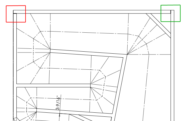

Like I stated in another post, I have purchased (6) 5x5 sheets of 3/4" 13 ply baltic birch. I also purchased a couple 4x8 sheets of OSB for a test box of Xoc1's Real 6 Fold TH. Martin (Xoc1) is working on a custom baffle (talked about in his TH-18 thread, specifically posts #482, 488 & 490) for this prototype.
I'm planning to use the B&C 18SW100 as they have pretty high xmax (12.5mm), have greater technology over the TBX series and will take 1700W without a problem; resulting in a calculated output of about 128dB after power compression.
Martin, was this plan intended to have the top board between the front & back or on top of the front & back boards? (red or green box below?)
