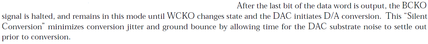

"Stopped clock" operation eliminates BCK related noise (great idea) at the moment of conversion (when it matters most), but does not eliminate other contaminants.
The above is an urban legend. There is no "moment of conversion" where removing the mainly BCK and Data related noise matters.
It is likely still an improvement, as typically stopped clock uses a higher frequency for BCK than needed, causing other potential issues, but being easier to filter.
And the period during which this easier to filter noise exists is only 50% or less of the time. So any process using averaging (e.g. FFT) will show improvements.
If no signal conditioning is used and especially if the source is modern CMOS logic with very high edge rates, stopped clock can provide objective and likely subjective improvements, but it is preferred to use correct signal conditioning instead.

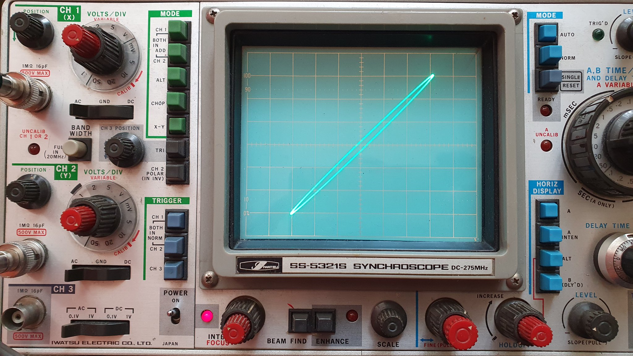

I can't understand what I see on the picture. X=L, Y=R, there is some phase difference (20 us or so), but why? Freq 440 Hz, I/V is DC coupled.
The conversion does not happen at the same time in both channels? The difference seems in the order of 1 WS time.
How do you determine if there is a time difference if the X axis is no longer time?
IIS input or SIM?
