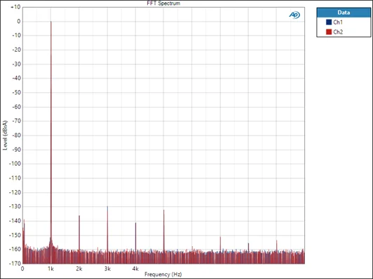

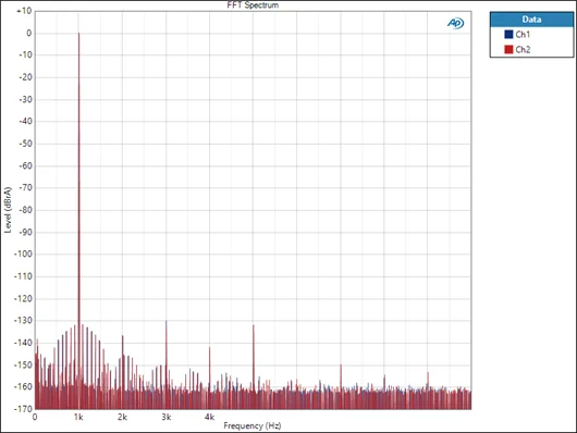

HOWEVER, it requires some care in implementation. Here the possible jitter Plot of an AK4493 driven from AK4118 MCK with the AK4118 used correctly:
Do it wrong, you get this:
So I think recovered Clock from AK4118 done right is good enough for a 16 Bit DAC. Available at JLCPCB for under 5 Bux and in stock.

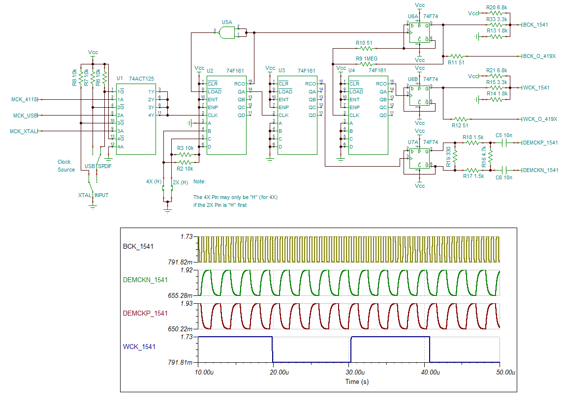

4) What Clock Division Logic Family and Devices for lowest Jitter?
Somewhere over the rainbow, or was it in this thread, ecd and others discussed logic families and jitter.
Among the readily available logic series the 74F series is among the lowest for Jitter, not far off from 74AC. Best in principle is ECL but cost and complexity increase to a point where it becomes pointless. Internally, as remarked the TDA1541 is ECL but the TTL-2-ECL conversion on the input will have more jitter than all the rest. In the CD-77 I used ECL for drive and reclocking, but it is not really advantageous over simpler circuit and was slated to be replaced.
When comparing, bipolar dividers (74F, ECL) tend to have higher flatband phase noise, but a much lower 1/LF rise corner, meaning they do better on close-in jitter. I had some nice diagrams illustrating this, but I'm foxed as to where I left them, so you have to take my word. Modern low voltage CMOS logic has this problem more and more and even if RMS jitter is low (especially when measured above 12kHz) close in jitter is often not great. So really only 74AC logic at 3.3...5V or 74F logic should be considered other than ECL, based on the circuit noise.
Another factor is "ground bounce".
For CMOS IC's, which are comprised of "Complementary MOS" Inverters or more, each time an inverter or gate switches, we have an unavoidable current spike at the switching threshold. With fast enough edges and logic the spike while relatively high in current amplitude passes very fast (nS or so). But, each inverter or gate that is connected in series will add it's "spike" to the general cacophony of everything else switching.
As these currents will flow between supply and ground pin and are ABSOLUTELY UNAVOIDABLE, they will cause a voltage drop in the IC lead frame (and PCB in poor layouts). This is a big problem, as inputs and inverter's or gate's in general rely on the Mosfet threshold voltages which are referenced to ground pin (via inductance) for the N-Channel pull down device and to Vcc for the P-Channel pull up device. It means that when the ON CHIP rail or ground voltage shifts the trigger point shifts.
For generic CMOS 10mV noise equates to ~ 1pS jitter in a simple IC, like an inverter (for a clock oscillator). As 0.5V ground/supply bounce in the chip lead frame are not unheard off we are unavoidably adding data/clock dependent jitter in the 50pS region.
By comparison ECL is differential so there is no ground or supply bounce at all and F(ast Schottky) TTL circuits also have much less ground bounce as there is no "switching spike" from shoot through current and as technically the switching point is based on current flow, not voltage, inputs are less sensitive to ground bounce.
So, summa summarum, 74F series IC's are best suited for our clock divider, over 74AC and more modern IC's. The intended 512X (22.5792MHz/24.576MHz) Clocks are well inside the specifications.
We can use a 74F161 or 74F163 programmable counter to make a pin programmable divider with a division of 1-16. We still need another divide by 2 behind this, so 74F74 creates the actual 50% duty-cycle BCK and we can simply select the BCK as 32X of 1X, 2X & 4X Sample rate based on the MCK. Minimal jitter/phase noise. I have seen these dividers (as 74AC) in super low phase noise reference clocks. Another 74F161/163 & the second half of the 74F74 create the WCK from the BCK.
This divider chain would be for a SRC419X. It needs reconfiguring if we use another solution with SIM Out. Then BCK comes from the second 74F161 (we just cascade) and is divided down to 16X plus we reclock LE with the BCK. No real other change.
We also need a 8X DEM Clock locked to MCK. This means divide by 64 (24.576MHz/64 = 384). So two pcs of 74F161/163 or 1pcs 74HC4040.
We could use a second 74F74 to reclock Data (L/R or IIS) but I see little benefit from doing so. We just use the jittered Data at 3.3V P-P and attenuate and slew rate limit. There is no drawback I can see, we just need the data to arrive in the BCK window.
Here would be such a clock divider in detail.
A 74ACT125 Buffer is used to buffer the 74F161(163) input, as there is ~ 0.6mA flowing when the clock Pin is low, which are directed away from the Clock input of the 74F161. The buffer placed right next to 161 takes care to return this current in short loop to 161 GND if the clock is low.
As a buffer is pretty much mandatory, it is also used as clock selector. A crystal clock option (SRC419X asynchronous) is included.
The circuit outputs a fixed 8X (352.8/384kHz) DEM Clock (with the signal conditioning shown before), plus a WCK at BCK/32 and a BCK divided down from MCK. The BCK division can be selected as 8/4/2 for 1X, 2X & 4X sample rates.
If there is no intention to use a crystal clock or the crystal clock would be (say) fixed to something like 24.576MHz (for a fixed upconverted 192kHz Sample Rate on the TDA1541 and 6.144MHz as BCK) the circuit can be simplified by reclocking BCK from MCK and then dividing BCK by 2. Advantage here, we do not particularly worry about dividing MCK by the correct Ratio, as we use BCK to create our clock.
In this case DEM would need dividing by 64 from MCK. We will keep a 74F74 as final stage with differential Out, so divide by 32, so 74F161 & 1/2 74F74 or a 74HC4040 or similar.
The elaboration of this case is left to the reader.
Ok, in the above divider, we have a spare 74F74 section looking for a job.
The rate estimator in the SRC419X runs on LRCK and the reference clock. It has an LF corner of 0.00025*FS, or 48Hz for 192kHz sample rate.
Now, looking at the LRCK from something like XMOS we see as much as 1nS jitter and a lot is low in frequency.
If we want to (optionally) use the SRC function, we better reclock in the incoming LRCK into SRC419Xwith the source MCK.
Now input and output will have low jitter, so we do not rely on the ASRC to clean jitter, which is not great at.

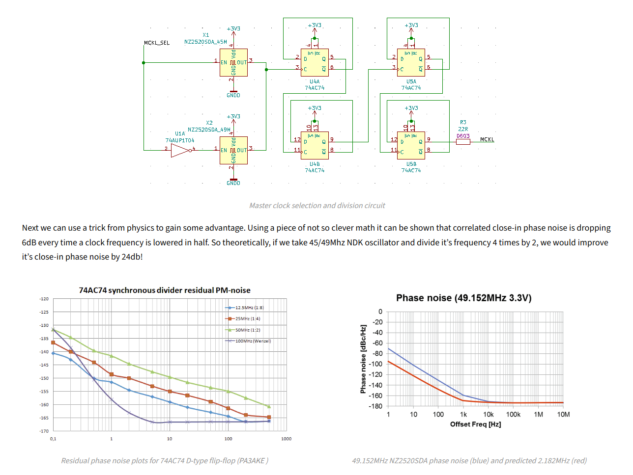

Ryanj captured most of ecdesigns latest recommendations in his 3rd revision. This includes the slow DEM clocking that many find subjectively improved over the earlier recommendation you cite. Gabster 2000 also has an offering. iancanada has low jitter building blocks.
