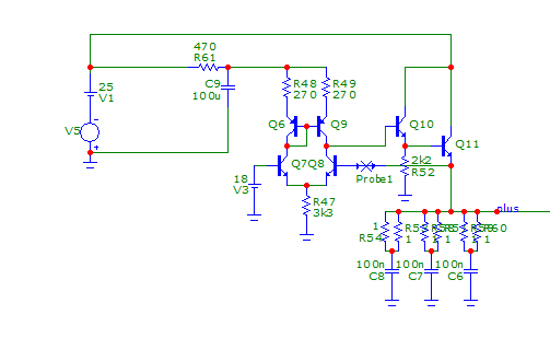

As usual with simple circuits, it needs good regulators. The simple regulator I showed will benefit from a RC filter before the mirror:

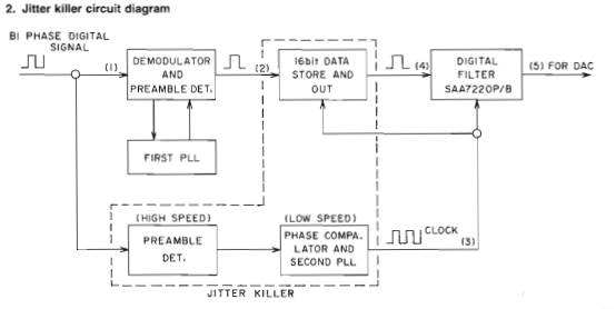

I was looking at the jitter killer system in the Marantz DA-12 / Marantz PM-75 / Philips LHH-1000.
It's a quite involved way to make a 16 Bit FIFO:
A pair of 16 Bit shift registers is used to create a series to parallel conversion, then parallel to serial and clock out via "slow PLL Clock".

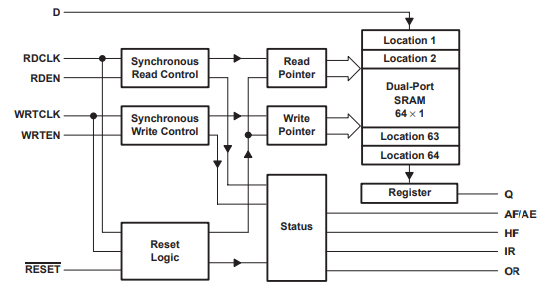

The 74ACT2226 would be even better. Two completely separate 64 Bit FIFO's. But nobody I can find stocks it. Direct order from TI only.
With 64 Bit we can "assemble" two full 16 Bit words before we clock out the first word and have always +/- 1 word margin. Two independent FIFO's mean we just need this IC. On the input we select which FIFO receives BCK based on FSYNC/WCK +

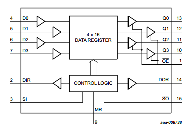

One more simple FIFO logic IC. Can build these more complex ICs multiplying this one? 74HC_HCT7403
The hc7403 looks interesting, but it seems essentially unavailable from any substantial source.
The hc40105 remain in long supply at 60 cent each. It can be cascaded to 32 bit.

The hc7403 FIFO or the hc2226 FIFO's make for a more elegant design.

BUT I happen to know the reason why Marantz was so complex.
It was planned at one point yo use 16 x opto coupler. At a maximum of 96kHz this was well feasible in the mid 80's. It was however eventually cancelled. Had the optoisolation never entered the picture, the circuit might very well have used a hc40105.

In order to replace the '673 in that particular circuit you would need 4 '40105 and, assuming 4 bit versions, 4 serial in parallel out shift registers. However they arrived at it they arrived at an elegant solution.
Not at all. 1 x 40105 will be overkill actually.
The 673 & 674 form a simple 16 bit long FIFO for IIS Data. Nothing more. The circuit only stores a 1 bit x 16 data words. That is data is delayed by 16 bit.
A single 40105 can do that 4 times.
All the rest is not needed.

The 673/674 form a 16 bit long 1 bit FIFO, output data to SAA7220.
The output clock (BCK2) comes from PLL that locks on the Preamble and uses a very nice LC oscillator. The input comes from the SPDIF receiver.
Yes, there is 16 bit serial input parallel output shift register. And it connects into a 16 Bit parallel input serial output shift register.
1 input and 1 output for IIS Data that is delayed 16 BCK periods and that then is send to the SAA7220.
It's functionally a simple asynchronous fifo, 1 bit wide, 16 bit long. The 74HC40105 is 4 x 1 bit wide and 16 bit long FIFO.
