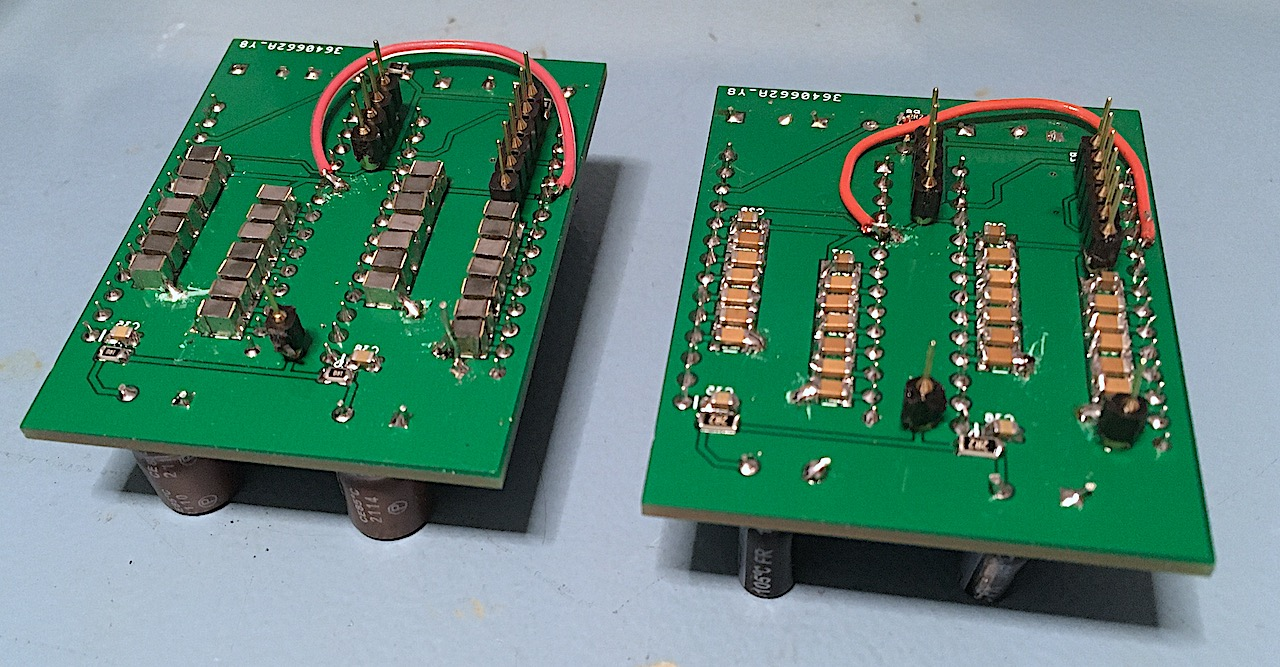

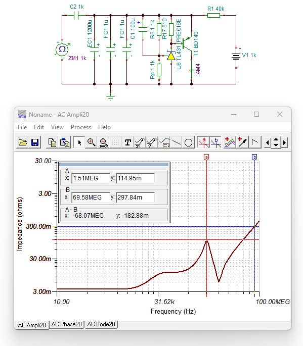

Ok, so I sat down and pulled all the various strands of discussions, greatly appreciated input from @lcsaszar etc. together,
So if we make a PCB I suggest this:
I decided to bring a lot of stuff on board, simply because it places control into our hands, which I had left off originally. The inputs are now compatible with TLL variants and 2.5V -5V CMOS Logic.
The Shunt regulators are based on ones I have used multiple times before, the impedance is a few mOhm. Noise is the TL431 noise, which at 20uV RMS will seem high, however with the TDA1541 the PSRR is high enough this really doesn't matter at all.
Low impedance over the audio spectrum and beyond is by far more important. As shown the shunt regulators dominate up to ~ 35kHz. After that the decoupling capacitors take over.
The 1,000u Electrolytic (Os-Con here) & 1uF SMD Film (Panasonic, CDE etc) keep impedance well controlled. Additional bypassing does not help. As is the impedance of one of the 5V rails looks like this:
The peak ~ 1.4MHz will coincide with 88kHz sample rate @ 16 Bit BCK so it is of some concern, but it's still only at a fraction of 1 Ohm.
I suggest the following adjustments to make a PCB:
U4 can be 7824 or LM317 (TO220) (or any of many others)
U7 can be 7805or LM317 (TO220) (or any of many others)
All the flip-flops get a TH & SMD (SOIC) double footprint, so any number of 74XX74 logic families can be used. The (obsolete) 74F74 logic shown is non-saturating bi-polar logic (you CAN read that as "kinda Class A logic" ) comparable a little to what is inside the TDA1541. It is capable of 125MHz clock for flip-flops and adds only 26pS jitter. There are more modern CMOS logic options that add less, but most are chip scale SMD packages. A footprint for these could be placed below the PCB as well.
Add pin's to stack a 2nd PCB for a balanced DAC and selection for IIS/SIM operation of TDA1541 and L/R or balanced operation.
Signal lines to the 2nd piggyback PCB are from before the attenuators, power at the Os-Con. The second PCB is identical, but we do not fit all the logic IC and shunt regulators, it only holds a 2nd TDA1541, decoupling and signal attenuators.
The attenuators went back to a version of John Brown's, with higher impedance and no capacitor. After understanding the silicon level creation of the PNP input transistor better, I have more confidence into the 12pF input for TDA1541 capacitance being pretty low tolerance and not much signal dependent. Using our own logic here (74F74 with less voltage swing than 3.3V CMOS) makes sure we know exactly what drives our attenuator, again overall it is about controlling variables.

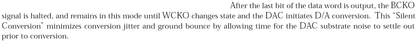

From page 8 of the PMD100 datasheet.
So, you confirm exactly what I wrote.
Urban legend. For the TDA1541. And for "Conversion".
Now A DAC with fast CMOS logic, or a digital filter with fast CMOS logic, that's another kettle of fish.
Note the datasheet does not mention "conversion". Just LE Jitter induced by ground bounce.
In the TDA1541 the PNP input transistors operate in class A between +5V and -5V, not GND and it doesn't directly determine the slicing level for the inputs.
The "slicing level of the TTL2ECL converter is set in a NPN differential Amp biased from DGND towards -5V.
So BCK induced noise doesn't really do much to to LE switching in the TDA1541.
