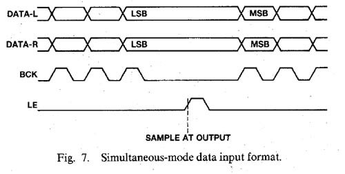

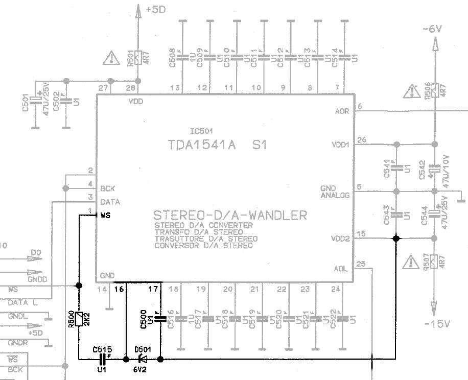

I thank you all of you for the work you are doing and I appreciate it very much. Some points of view can be "universally recognized" and others perhaps a little "bold" and distant from the "canonical doctrine" of the TDA1541 engineers. However, I believe that I want and can only adopt some techniques addressed here, namely the attenuation of the signals digital inputs and I would like to see a comprehensive image of a double-sided simply PCB layout of the ground routing. For the rest I think I will remain faithful to:
1) Dem Grunding
2) Sim mode with CPLD (by miro)
3) lm317/337 PSU
4) AD844 + AD817 I/V converter.
5) Also my caps are: 1x 4.7uF + 1x 1uF + 5x 0.47uF
6) Not Oversampling (which you have already explained to me is not ideal with DEM GRUNDING implementation which instead requires 4xfs. 7) Maybe for point 6 I could ask Miro to reprogram the CPLD code to get 4xfs.
1) Dem Grunding
3) lm317/337 PSU
6) does not hold IMHO. As I pointed out several times, the DEM frequency does not need to be 4xfs. The first requirement is it is advised to be >2xfs and < about 200...250 kHz. The second requirement is that the filtered DC should not move, and that implies a symmetrical, stable, jitter-free DEM oscillator. I am not quite sure about the first requirement, we have seen 50 Hz DEM clock working. The DEM capacitors and internal current source form a filter, so simple. There should be DC or at most <<1/2 LSB (90 microvolts) on the DEM pins. Filter for that and you are done.
Ok...so...4xfs ( Grunding used) is no indispensable?
Please can you explane me how can obtain 2xfs?
I never tried sim mode, but I think it is the same. It is LE not WS. The 2.2k should go to the output of the frequency divider that scales down the BCK. But I haven't tried it.

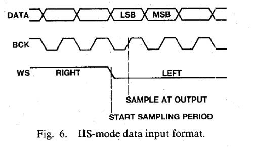

So WS does it stay connected like this?
No. The sync circuit should not be linked to WS if using no oversampling.
While bck must be divided by 16.,should the rest of the connections in SIM mode remain identical?
You MUST use IIS BCK to divide down, not SIM BCK. SIM BCK is usually stopped clock, so the DEM system would stop for part of each sample.
IIS BCK is normally 64 X Fs. Divide by 16 using a suitable IC (e.g. 74LVC161) gives 4 X FS.
One problem of the Grundig DEM sync is that it injects a net disturbance as FDEM into the DAC.
Using the Tubee style balanced clock feed eliminates this issue and the net current flow is balanced and no additional disturbances are added. In this case a pair of 74XX74 make a better divider because they have a "balanced" output.
It is also possible to use any particular MCK and divide this to a fixed FDEM (e.g. 22.5792MHz / 24.576MHz divided by 128 gives 176.4kHz/192kHz).
