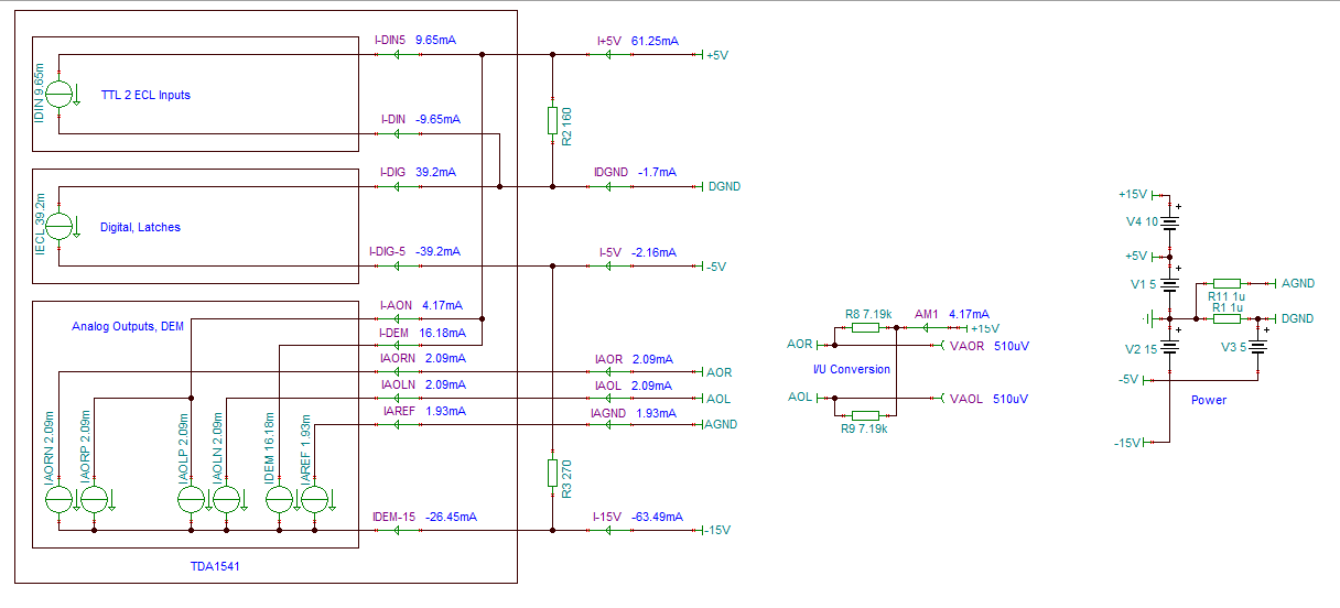

Like this we get in effect 60mA from +5V to -15V with a few mA error current flowing into the shunts. This suggests ~ 80...100mA current into the whole system. So we end up with (say) this again:
This PSU will be ~ 36mOhm or less between +5V and -15V from below 300kHz pretty much to DC with a minimum ~ 6mOhm (quick back of envelope calc).
The included PSUD screen shows how effective the RC chain is in killing noise. I doubt any more effort will give material improvements, objective or subjective. For that it's quite minimal really.

  1. Audio current in Pin 28 (+5V) - this gets nulled to +/- 1/2 LSB mostly semi-random stuff around Fs. This is a biggie.
  2. Data related current in the input PNP's cancels out. Not as big, but each of the 4 inputs draws some signal dependent current (see most likely schematic in this post) There definitly are a few mA involved, balanced operation makes this set of currents cancel for Data, so the only disturbance's on+/-5V are clock related and unless we use the "stopped clock" operation, they are continuous and steady thus not an issue in terms of PSU modulation which can cause .
  3. Any mechanisms inside the TDA1541 that cause data related leakage into supplies or audio is cancelled also.
  4. If we use re-clockers with 74F74 (some of the lowest jitter other than ECL and hard to use exotic CMOS) and load outputs equally, again, signal dependent currents do a disappearing act.
So we end up with a reclocker and TDA1541 that have very low signal dependent disturbance's ("noise") on the power supplies and where we can separate out (+/) - 15V from the rest, with a choke between AGND and DGND, separating analogue and digital sections completely.

The I/U conversion, if discrete, get's more complex, but we have a benefit here too. The Base Current of the input transistors will be appx. complementary (especially if matching transistors for beta) and thus also cancel to zero.

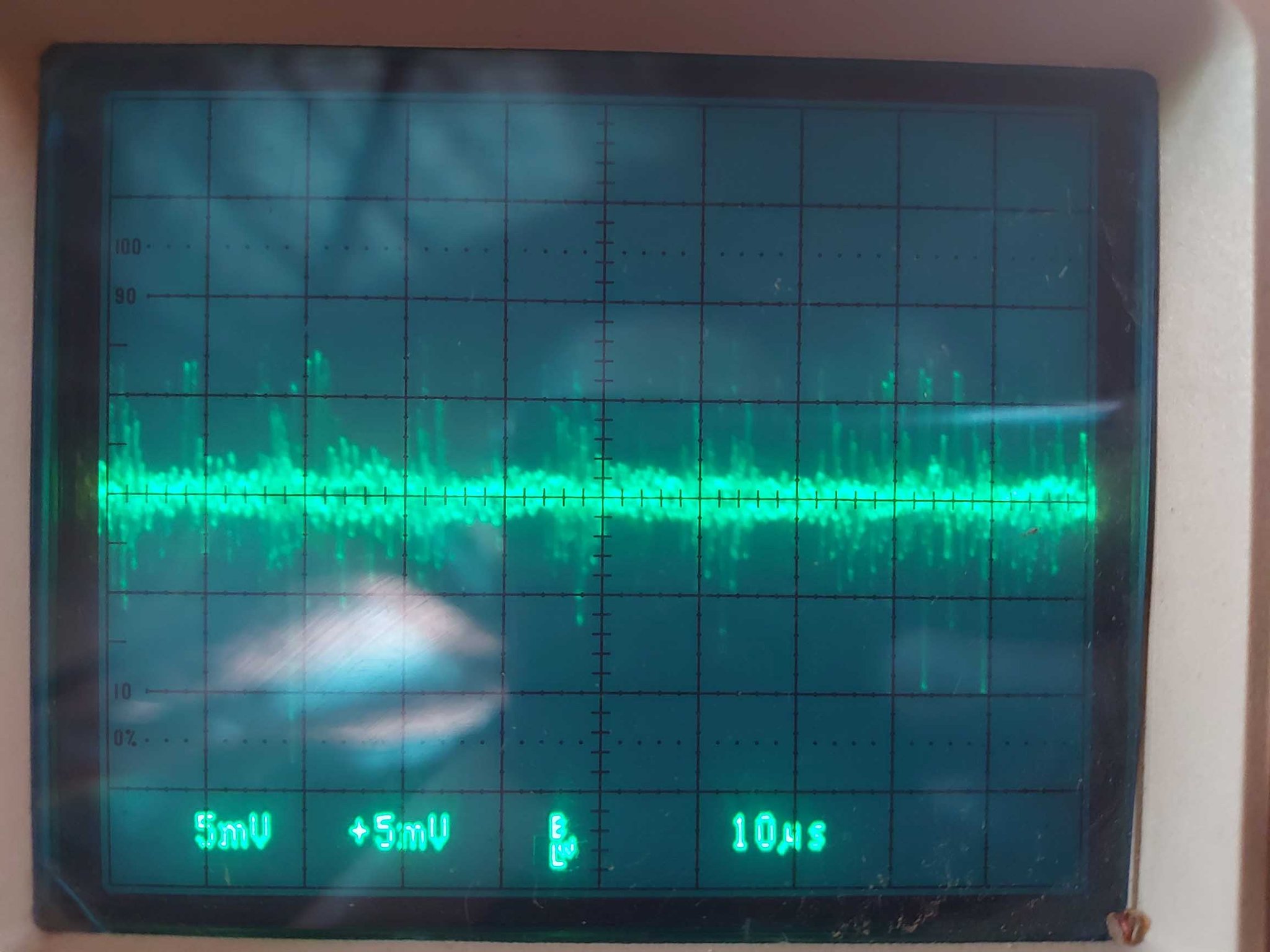

I measured this with music playing by using the "poor mans differential probes" technique with 50R terminators.
I had one probe on each AOL, AOR output (normal and inverted) and then used the add and invert functions which left me with this wave form (actual V level much lower due the measuring technique flaw), which I suppose is the common mode noise that will be canceled out when converting back to SE.
Load was around 15RIV. To me the overall sound was excellent when using a DAC this way, Might couple well with a SE tube circuit to add some H2 back.

When I ran balanced in one DAC (one channel inverted) the current demand being much closer to constant, I could take out the bypass cap (giving higher zout) and the sound was almost the same, but when running single ended without the bypass cap, the dynamic powerful bass was diminished.
