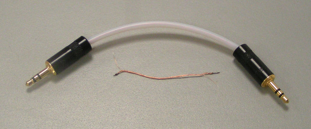

Is it OK to use a stereo jack - two channels + earth ?
Where is the border line for "thinner" - I have litz wires of 0.1 mm - shall I try five of them for a channel or ??
You can use a stereo jack with 2 channels + earth.
0.1mm would be fine, but you need low impedance for the earth lead or you might experience problems with hum.
The impedance of the signal wire is not that important as the current running through this wire is extremely low. By using a single 0.1mm signal wire, the interlink capacitance can also be kept low
I am now testing 15 x 0.1 mm insulated wires in parallel for earth and a single 0.15mm wire for the signal, all twisted together. Capacitance is comparable with conventional interlinks.
The single 0.1 mm signal wire is screened by the surrounding earth leads. I advise to use a different colour for this wire so you can pick it out easily after twisting the wires together.
In order to prevent breaking of the fragile 0.1 mm signal wire I folded it in a Z-shape at each end (within the plug) so when pulling the cable, all tesion is distributed to the point where the multiple earth leads are soldered to the plug.
John,
Is the signal wire 0.15 or 0.1 - you are mentioning both - not a big difference but still. Different colour of a litz wire ?! - they are all the same.
May be my misunderstanding, please correct me.
Thanks,
Ignat

Hi niamex,
John,
Thanks,
Ignat
Sorry, I used 0.1mm lacquered OFC wire, all the wires are the same.
When twisting 16 wires together and one of these is going to be the signal wire it helps to use a different color for this signal wire in order to identify it.
