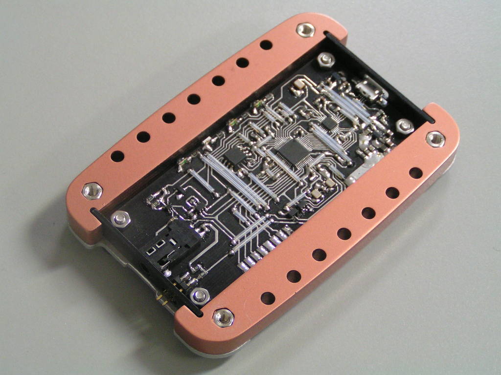

I attached a photograph of the XTOS prototype. It supports 44.1/16 ... 192/24.
It is USB powered and connection is made through a micro USB socket. I use a SMPS 1V core voltage regulator (in order to minimise USB bus current) and a 3V3 LDO plus dedicated power supply monitor and reset circuits.
The small chip close to the USB socket is a USB to parallel converter, the PHY. It contains on-chip voltage regulators. This is a new version of the PHY where the bias voltage issue is fixed.
The large chip is the XMOS multicore (state machine) processor.
There are 3 low jitter Epson miniature crystal oscillators for 26 MHz PHY & XMOS clock, 22.579 and 24.576 MHz audio clocks. These oscillators are powered by a low noise LDO voltage regulator.
The Toslink output signal generated by the XMOS processor is synchronously reclocked by one of the audio clocks (depends on selected sample rate) in order to ensure low jitter. I use an ultra high speed D flip flop for reclocking.
There are 4 indicator LEDs for USB connection, streaming, 16/24 bit and bit-perfect test.
The bit perfect test requires a test track with a sawtooth signal on it. This audio file is automatically detected and it initiates the bit-perfect test. The bit-perfect test can be initiated at any time during listening, it is not necessary to put the XTOS in a test mode.
The XTOS works without drivers when the source supports UAC1 or UAC2. Jumper setting on the XTOS can force the XTOS to power up in UAC1 or UAC2 mode. If one uses Windows and wants to use sample rate higher than 96 KHz a driver is needed, the Thesycon driver for example. In this case one has to check various settings in order to achieve bit-perfect playback. Mac and Linux support UAC2 and work without drivers.
The XTOS firmware can be updated through USB when required.
These products are fully handcrafted, the PCB is exposed, developed, etched, tinned and drilled in house. The via's consist of solid copper wire and are riveted into the PCB by hand. The parts are soldered on the PCB by hand in order to minimise thermal stress and ensure long service life. The PCB is routed single-sided (like all my new designs). The other side of the PCB contains a solid ground plane. Wire bridges are made of tinned copper wire with PTFE (Teflon) insulation.

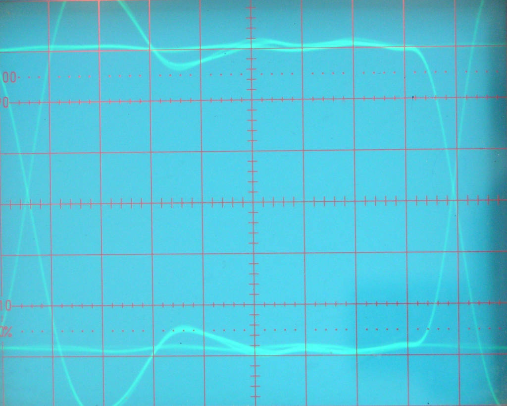

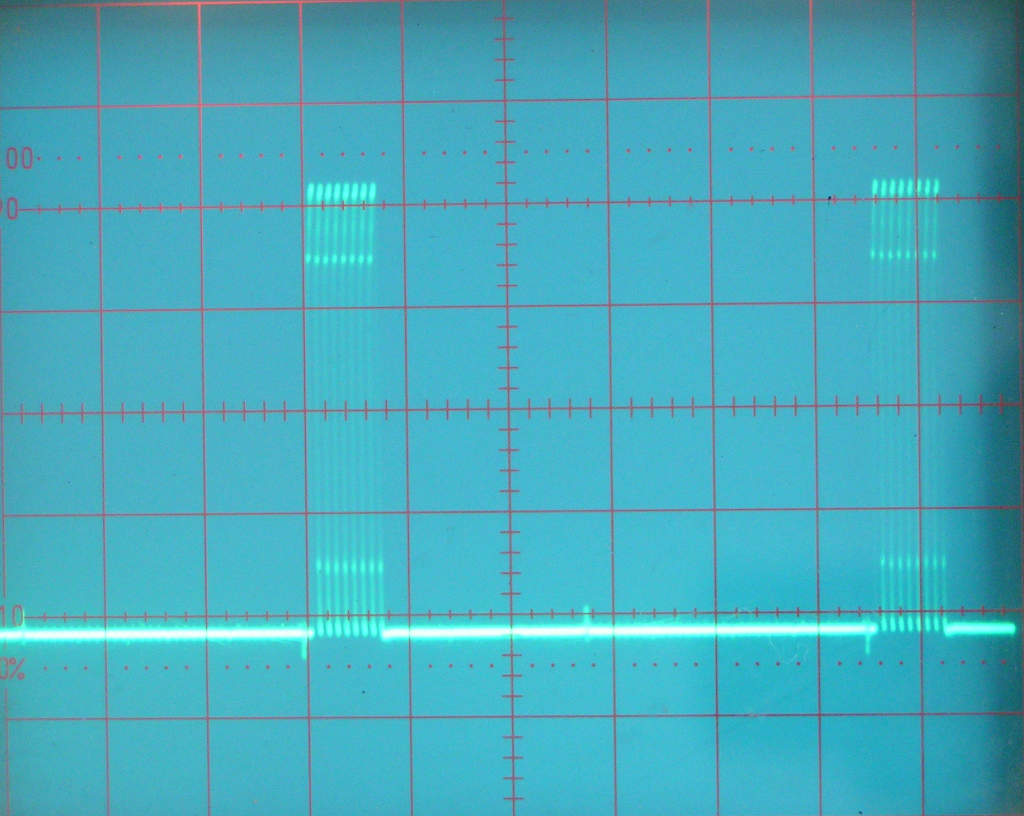

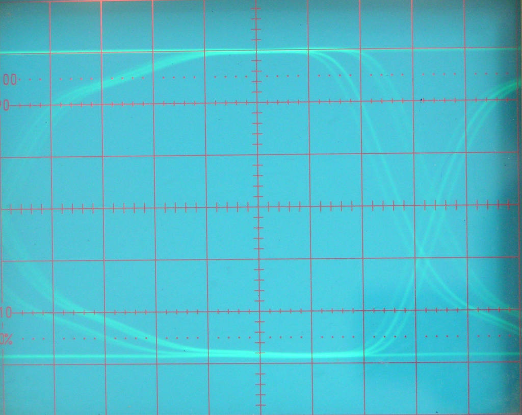

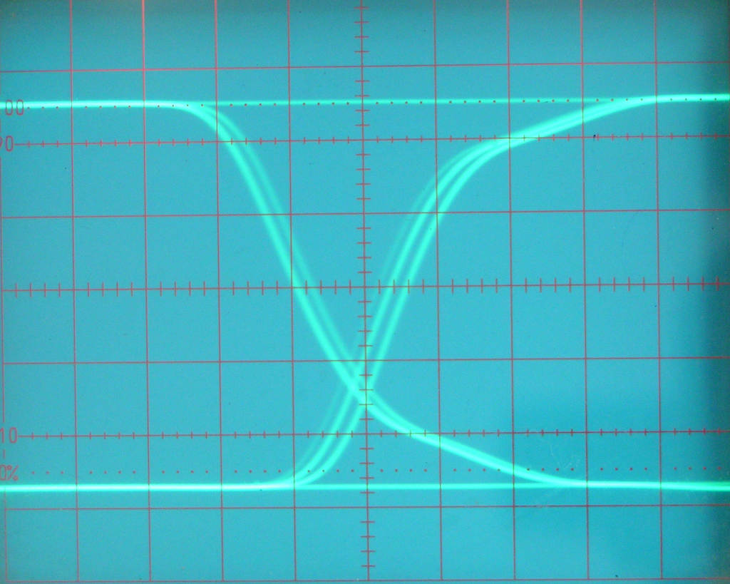

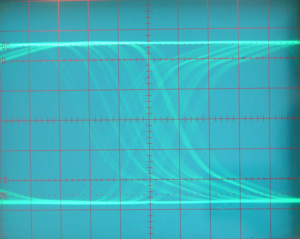

I attached some oscillograms illustrating Toslink jitter
Oscillogram #1, XTOS SPDIF output, 192 KHz
Oscillogram #2, Optical receiver output, 1 meter plastic fiber, 192 KHz
Oscillogram #3, Optical receiver output, 5 meter plastic fiber, 192 KHz.
Oscillogram #4, optical receiver output , 5 meter plastic fiber, 44.1 KHz.
Measured jitter increases with increasing sample rate and fiber interlink length. When applying pressure on the fiber interlink (stand on it) data corruption occurs due to temporary deformation of the fiber. So it is advised to keep the fiber free of mechanical stress (pulling, bending).
High jitter is measured at the Toslink optical receiver, regardless of Toslink source jitter. However, the recovered PLL clock from a good quality receiver like WM8804, DIR9001, DIX9211 does not show any significant increase in jitter. PLL recovered clock jitter remains around specified 50ps regardless of input jitter.

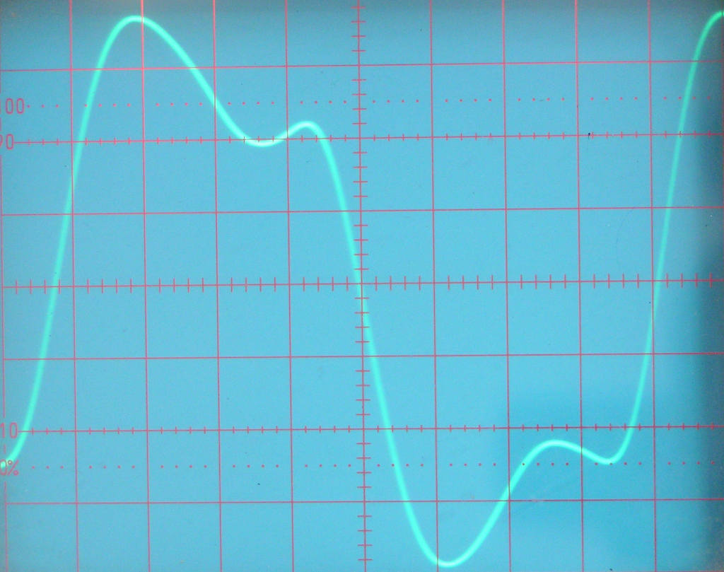

Oscillogram #5, PLL recovered clock
But 50ps is still too high …..

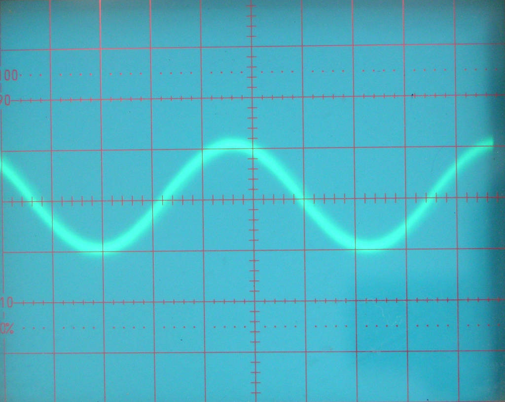

The passive clock further attenuates jitter that is still present in the PLL recovered clock by up to 174 dB.
Oscillogram #6 shows the 24.576 MHz passive clock output.
It is a sine wave with extremely high spectral purity. Even the best masterclocks would have big problems generating something that even comes close to this almost perfect sine wave. The passive clock tracks the input clock so it always runs in perfect sync with the source clock.
Because the passive clock does not require a power supply and does not contain any semiconductors it can always offer lower phase noise and lower deterministic jitter than any other conventional crystal oscillator. This is about as good as it gets.
-> Toslink jitter issue solved.

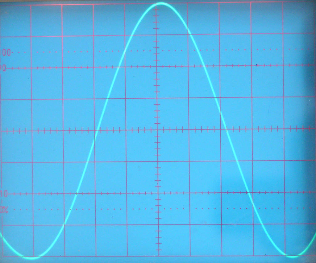

Oscillogram #7, multi-stream interface data burst clock signal that is used to pump multi-stream serial data into the Mosaic DAC core. The burst clock frequency equals 12.288 MHz here (192 Khz sample rate). The small glitch between the clock busts is caused by the latching signal TLE that is used for output sample timing.
The final oscillogram #8 shows a -60dB sine wave (completely unfiltered output signal!) generated by the Mosaic T DAC. I used a 5 meter plastic Toslink fiber and 192 KHz sample rate in order to create worst case conditions illustrated by previous oscillograms.
I use a noisy PC and a XTOS USB to Toslink converter.
Scope is on max. sensitivity (2mV/div) and the prope is set 1:1. When short circuiting the scope probe with this sensitivity setting I get similar amount of noise. So the visible noise on the -60dB signal is mainly the result of the oscilloscope noise floor.
As you can see there are no glitches, even at 192 KHz sample rate, and DLE error is vanishing low. This is one of the advantages of the novel common-rail matrix concept. This oscillogram also shows how clean the unfiltered output signal gets when HF source interference is effectively blocked and ground loops are completely eliminated.
Jitter and interference also enter through I2S signals, so all data and I2S signals throughout the Mosaic T DAC are synchronously reclocked by a synchronous reclocker array in order to maintain extremely low jitter and noise throughout the DAC circuits. The limited 13 MHz interface bandwidth (Toslink, 192 KHz) reduces unwanted spreading over the DAC circuits and keeps the DAC output signal clean regardless of source interference.
The Multi-stream decoder also attenuates I2S interference by 87.5% because it runs in data burst mode with 12.5% data density. This reduces average I2S interference by 87.5% as following oscillogram shows.

...The passive clock further attenuates jitter that is still present in the PLL recovered clock by up to 174 dB.
Because the passive clock does not require a power supply and does not contain any semiconductors it can always offer lower phase noise and lower deterministic jitter than any other conventional crystal oscillator. This is about as good as it gets...
John, thank you, for such an comprehensive response.
Regarding your particularly intriguing passive clocking, from your above description it seems that it may be some form of very high-Q filter, possibly a multi-element crystal lattice bandpass filter, as were once common in RF applications. However, that you also describe your passive clock as being able to track the recovered input source clock frequency argues against my guess of a passive high-Q bandpass filter - at least, not without an electronically tunable center frequency via some active element.
Were you able to measure the close in phase noise rejection of the passive circuit, say at a 10Hz to 1Hz carrier offset?
If you prefer, please feel free to respond via PM.
