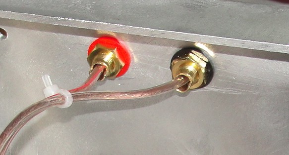

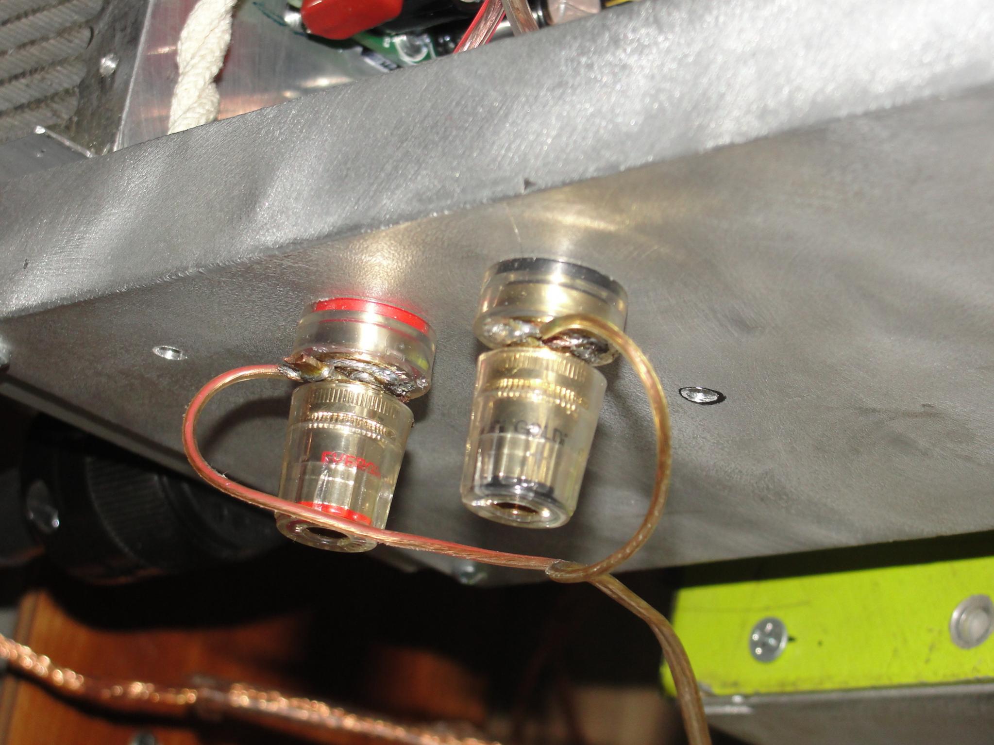

Hi. Of course the best but impractical solution is soldering cables everywhere.
I do the following mod on speakers binding posts, which is very easy on speakers wood enclosures as you don't have to pass through the binding post itself. It looks ugly but the benefit soundwise is significant. 😎
Pictures from the inside and the outside of the case.
M.

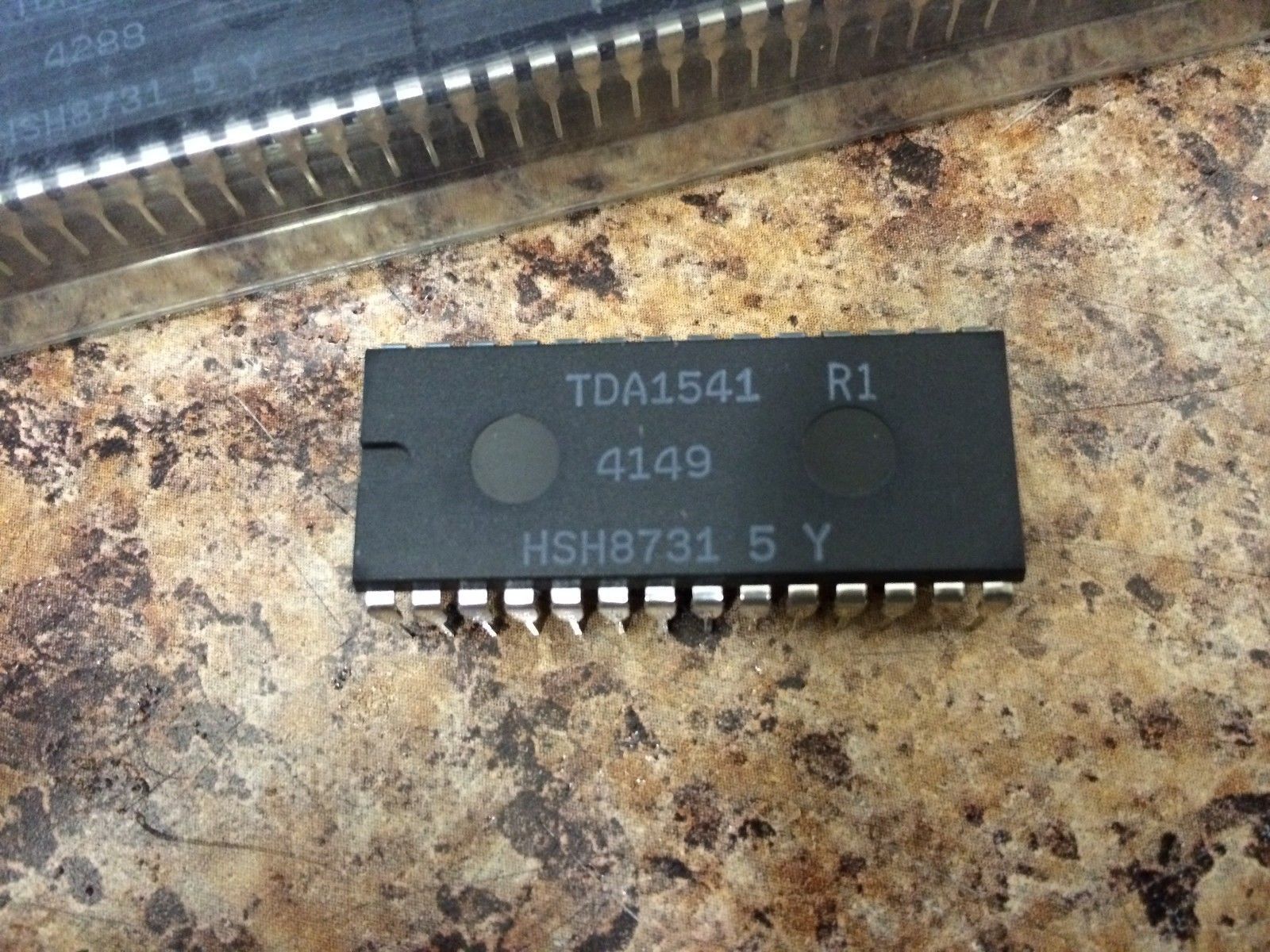

Hi!
I just built Rogic's dac AYA II, but with different amp stage, so no op-amps and I have TDA1541 chip (non A), R1 grade.
I read and also EC told me that with non-A chip I don't need oscilator cap on 16/17 and DEM clock uprade wont work for me, because this cap is already built in. But in my case it didn't work without this cap. Actually it worked, but with a lot of noise, not hum, there was "shshshshs" etc. So when I asked my friend to see what oscilloscope says, we saw that sine wave was somehow broken, there were small gaps... We checked everything and the only thing left was that capacitor, so when I add it, noise dissapeared and sine wave was normal...
I just want to know if someone had similar situation and if maybe fDEM mod would also work for me? Maybe those "R1" grade chips are different or maybe I have a fake one, but I doubt it, because it's from Pedja directly.

The R1 is TDA1541A graded. so its need the cap.
What grades does the TDA1541A have?The TDA1541A has 4 grades: standard, The R1, the S1 single crown and the S2 double (or gold) crown.
What does the grades mean?The (standard) TDA1541A is specified at THD+N of 0.8% (-42 dB). The TDA1541A S1 and TDA1541A S2 grades are specified at THD+N of 0.45% (-47 dB) at -60 dBFS. In addition, S2 is specified for THD+N of 0.0014 % (-97 dB) at full level, as opposed to 0.0018% claimed for non S2 grade. The S versions are guaranteed by Philips for this performance, but that does not mean that non S grades can not match the same performance level. Apart from S grades there is also R1 grade. However Philips documentation is a little confusing about it – sometimes it is slightly better specified than unmarked TDA1541A, sometimes it is inferior."Philips TDA1541A d/a converter - DutchAudioClassics.nl
Maybe It will be truer to say P. Rogic is only providing TDA1541A from the end of the 90s' made in Taiwan, and only with the populated AYA II 2014 & 2014 DS edition made by Audial, and of course the flag ship Model S.
They are said to be the best one near the double crown specification as T. Loesch already testimonied; although never checked myself. No fake stuffs at Audial !🙂 . What I can confirm to have several TDA1541A non-A all génuine (desoldered from old CD player) and a S1 as well from few days : there are important difference in sound if the layout and design is good... I can hear the difference easily on my own AYA II 2014.
Maybe you speak about the little dozen of R1 P. Rogic gave free at the asking of this personn who have too much of it and didn't want to sell them for money ? He gave one per personn at the condition you had no TDA and the first on the list whom asked ! (Read the Audial blog).
Anyway, as said, if it works with the cap and not without, it's a non-A whatever the marking !

So, no fake from Pedja imo: he is a serious guy ! And he is not making, designing DAC with TDA1541 non-A chip, you had the prove in the pudding yourself : it works only with the cap 🙂
If doubt drop a photograph of the chip, there is a thread about "is it a true TDA1541 chip", there is the date on it, sometimes the place : Taiwan, etc ! If you find one marked S2... keep it 😀
M.
Hi, that is not right exactly /IMHO/ since you have a solder there - I prefer a mechanically pressed cables wherever possible.
There is a guy in US selling hundreds of them on Ebay for a long time/still there
