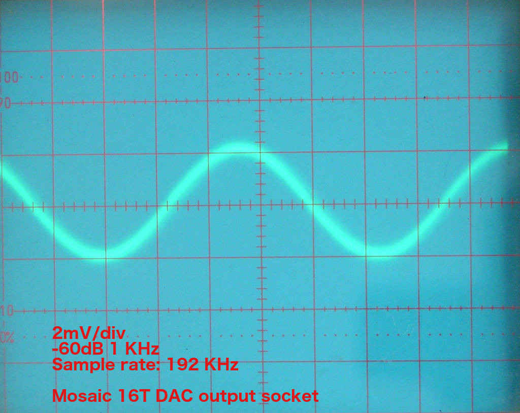

I attached an oscillogram of a -60dB test signal generated by the Mosaic T DAC. This is the raw output of the resistor matrix, no filtering. This should say enough about Mosaic T DAC noise levels.

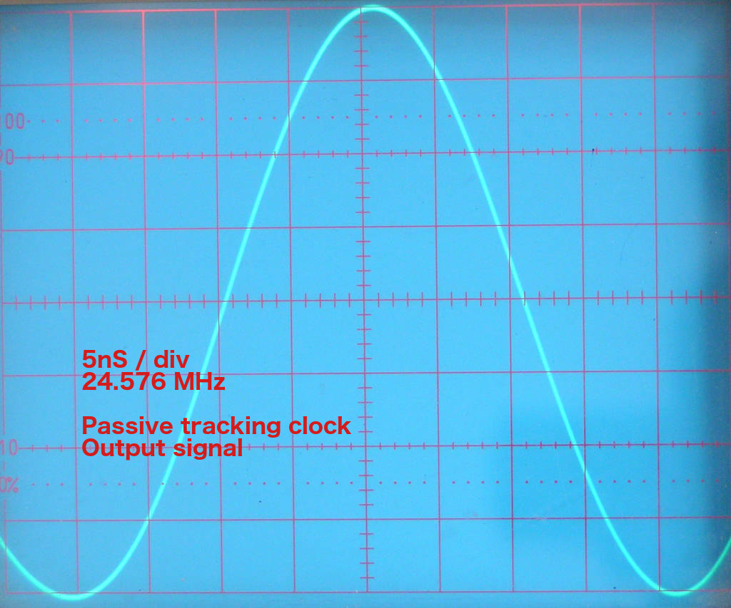

The second problem (jitter) is tackled by high performance PLLs and a passive tracking clock based on 16 crystals. This recovered clock is much cleaner than a local low phase noise crystal oscillator because it has no power supply induced phase noise and no semiconductor induced phase noise. Its output spectrum is heavily filtered so we end up with a sine wave with very high spectral purity.
I attached a second oscillogram showing the passive tracking clock output
So despite a noisy source and Toslink we get a cleaner clock signal and a cleaner audio signal compared to the previous Mosaic SD-player and Mosaic USB DAC.
Because the output signal is so clean, the masking effect is also greatly reduced and a lot more information comes through. However, this also means that a very small amount of source interference that still manages to leak through the circuits becomes audible again. This interference was also present in the Mosaic SD-player and Mosaic USB DAC but it was masked.
The Mosaic D/A converter core has no active output circuits that introduce non-linear distortion or cause masking. So we have a very clean, ultra linear output signal that will reveal every last bit of micro detail.

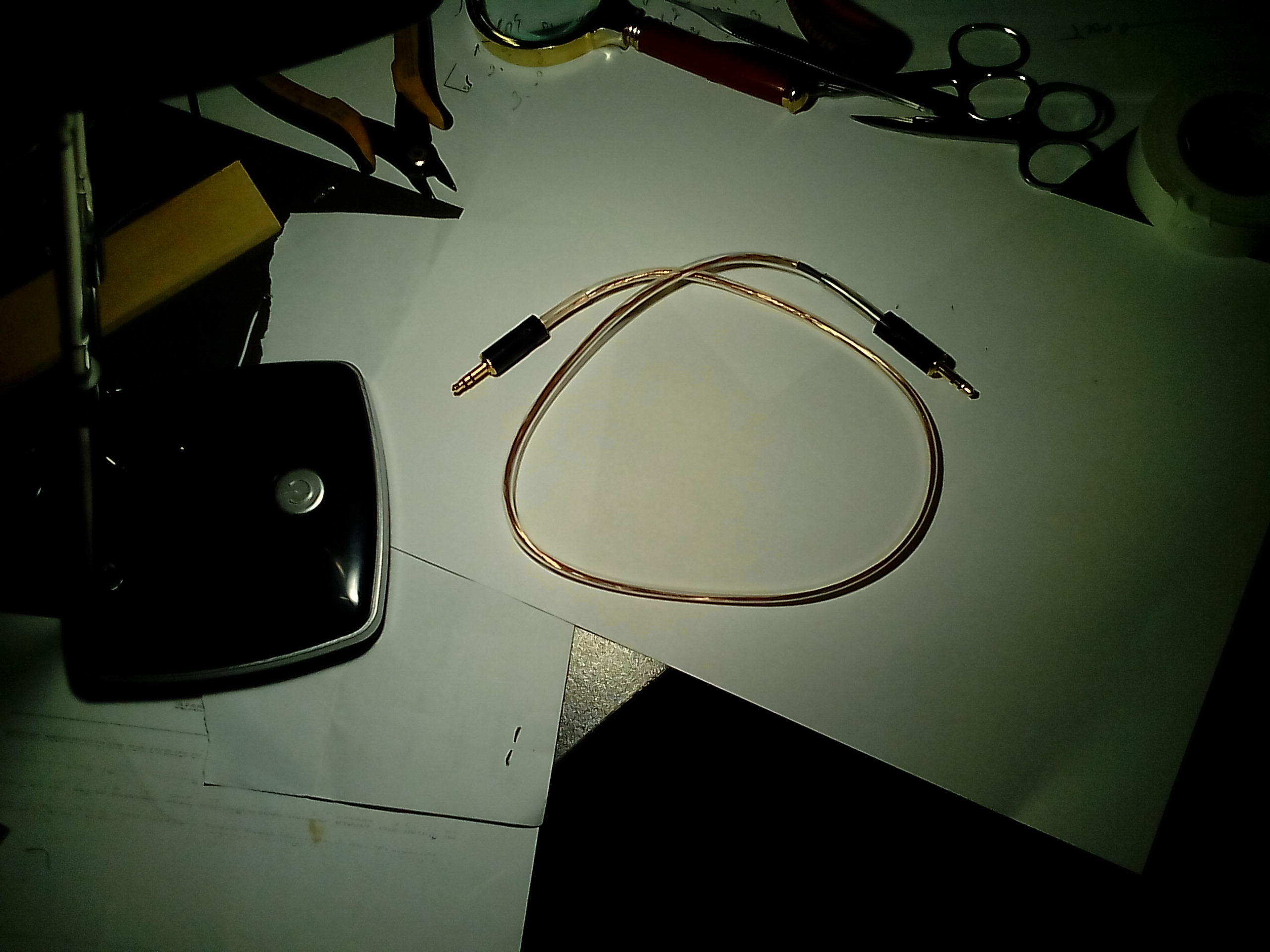

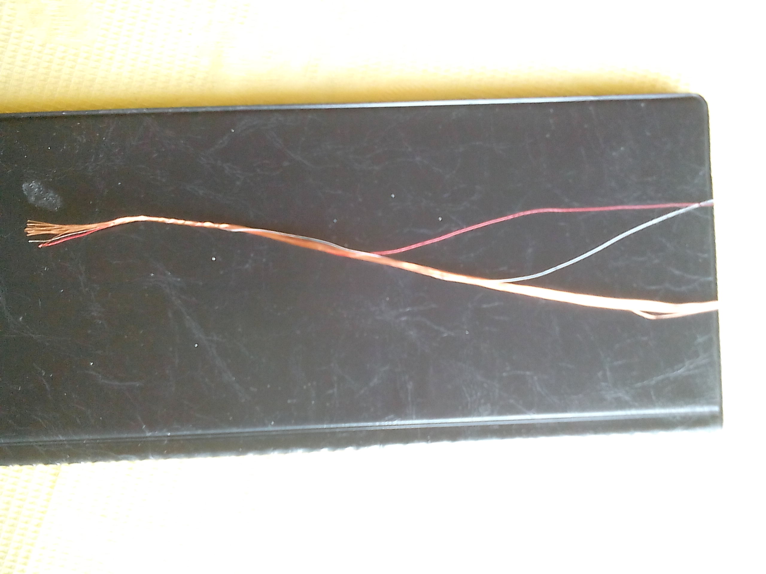

Hi John,
Sorry bothering but could be helpful to other guys - will it be OK to try 17 wires- left and right signal plus earth together in one stereo jack ?
Thanks,
Hi John,
Since there was no comment on my question I have made the stereo cable as above - so far so good, the highs became more readable at their top end /considered as drawback of the 1541/ but still I have some suspicions there could be some interference between the two channels so close each to other in the cable. There will be no problem to prepare a new cable 15 + 1 and separate the two channels and try if you suggest so - please comment
