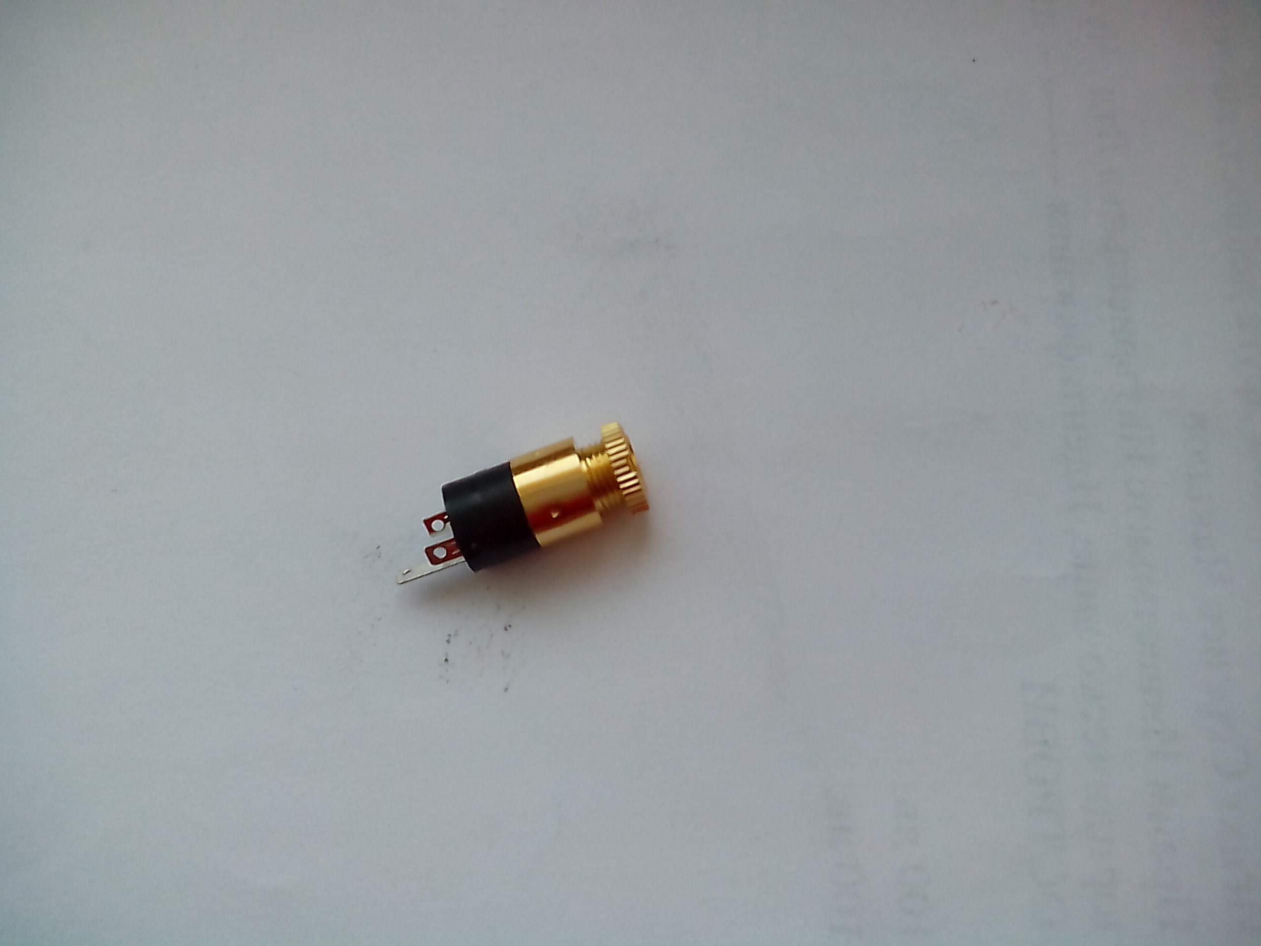

Based on them will try cable 20+1 /20 strands are twisted already as bought/. Neutrik jack is here, the sockets not clear whether have spring inside - attached pic.,ordered cotton shoe laces. Two separate cables - left and right ??

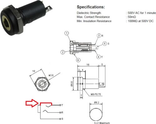

Hi Niamex,
When the supplier includes a mechanical drawing, this can usually be verified. Otherwise you have to break open a socket and check for yourself.

This socket has gold plated contacts. When studying the mechanical drawing you can see the GND spring.

Your contact resistance: 50 mOhm
Lemo: 5 mOhm
Thanks, you may be right - I am not very good at it so will wait for comments.Your contact resistance: 50 mOhm
Lemo: 5 mOhm

Yep, the ground contact issue, that’s why I use a version with GND contact spring as I already mentioned.
From the Lumberg datasheet:
http://www.farnell.com/datasheets/71579.pdf
Contact resistance <= 30 mOhm, not 50 mOhm.
With 5.65Vpp (2V rms) and 10K load we have a peak current of only 565uA and a voltage drop of only 16.95uV. The currents are very low, so we don’t need bulky connectors with very low contact resistance. What we need is lowest possible dynamic distortion and highest possible resolution at these low signal current levels.
Contact reliability, => 5000 mating cycles.
If you disconnect and reconnect these 3.5mm interlinks every day for whatever reason, these connectors will last at least 13 years. Similar connectors are also used in smartphones and pads, if these connectors are as unreliable as you claim, we would have heard about this for sure.
