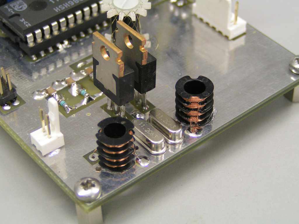

John, what are the chokes in the master clock generator? I am not familiar with the symbol even...
They are custom made screened 4-segment 100uH air chokes (attached photograph). The reason for using multiple segments is to minimize stray capacitance.
I had to improvise in order to support 2 different types of chokes (footprint) and a screen that has 2 more contacts. The CAD package requires one unique pin number for each pin, so I had to use 6 contacts in the schematics.

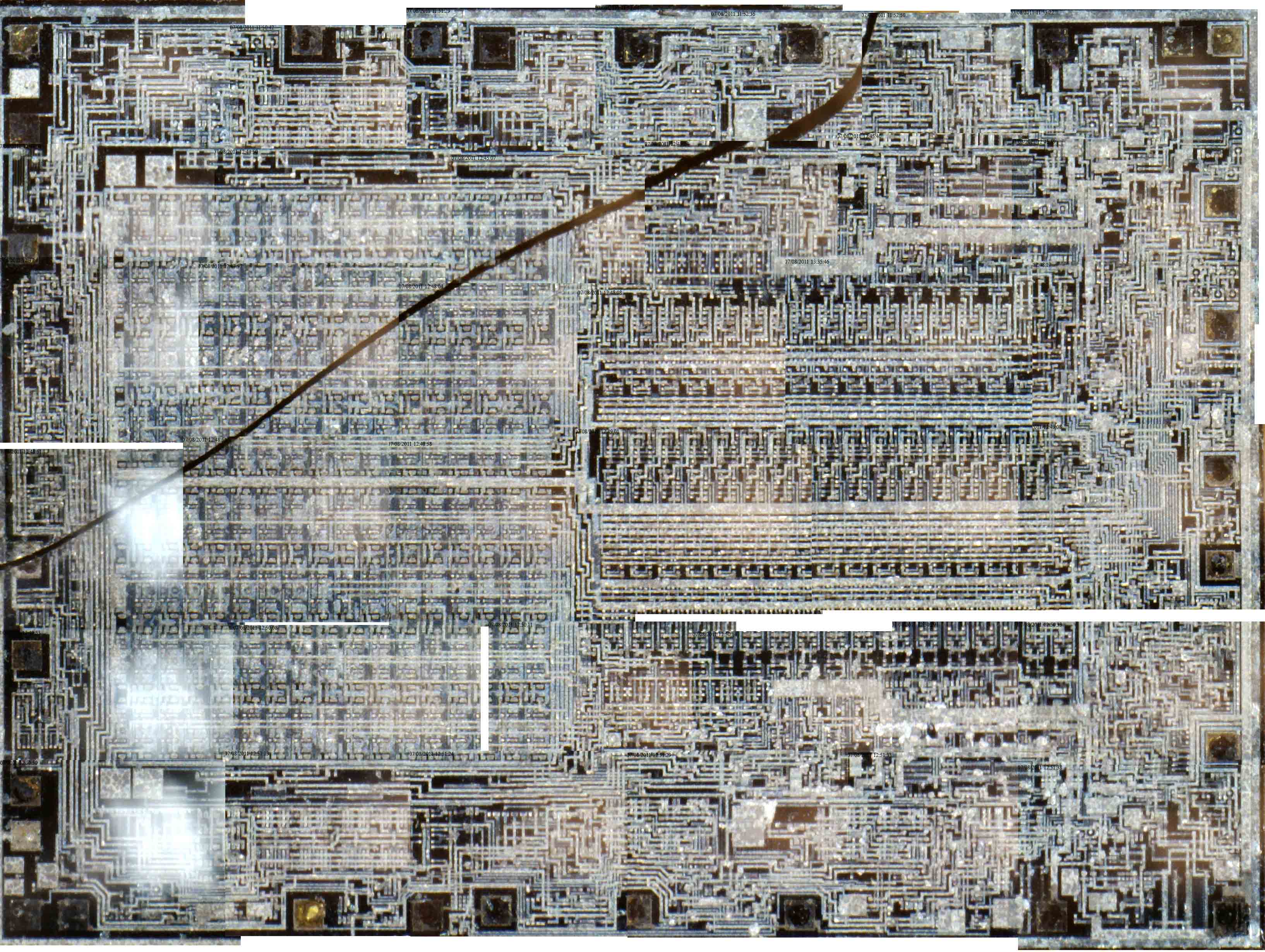

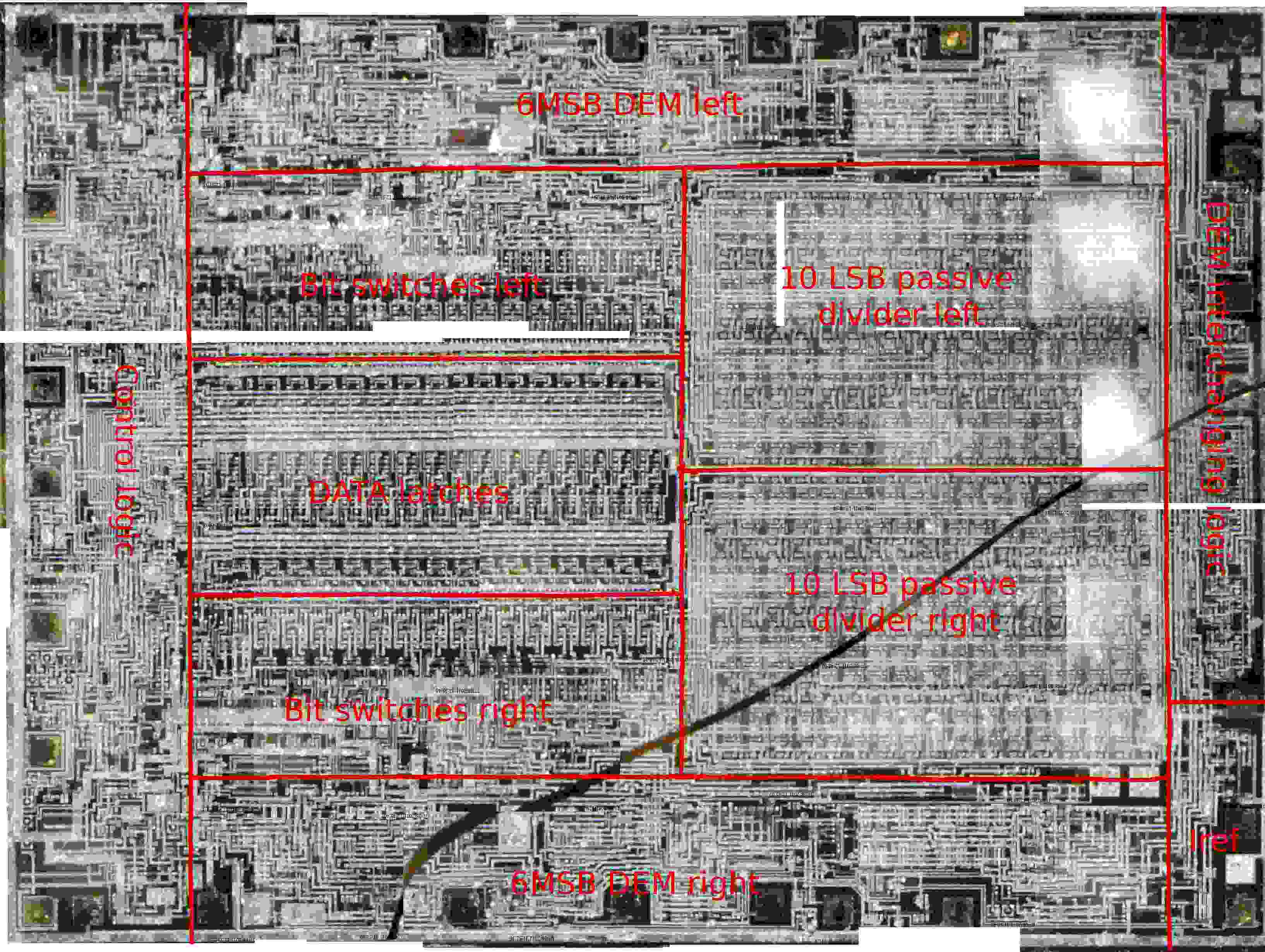

USB microscope capture (38 photos in one)
I've made some photos of a damaged TDA1541A with an USB microscope, at 400x. It is not a quality one, but now, we can get an idea of ​​the magnificent work done by the engineers at Philips.
Enjoy it........
TDA1541A photos
I've opened it using heat, I do this since I have 14 years old, now I'm 38. I've opened hundreds, since watches, intel 286, 386, math coprocessor, 486 and amd too, Wolfson 8741, PCM1704K, PCM63K, many and more, until celular phones ones.
Yes, it's the entire chip, a broken one. You can count the 28 pins all along the perimeter.
I'm happy you like the photo.
Hi galeb,
You mean you toast the chip with a blow torch?
Chip toasting....

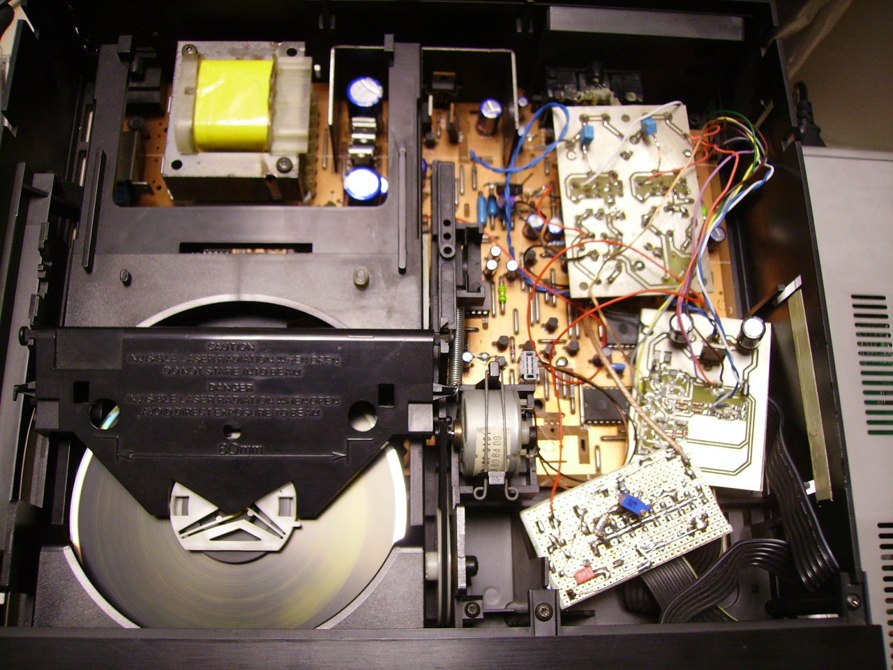

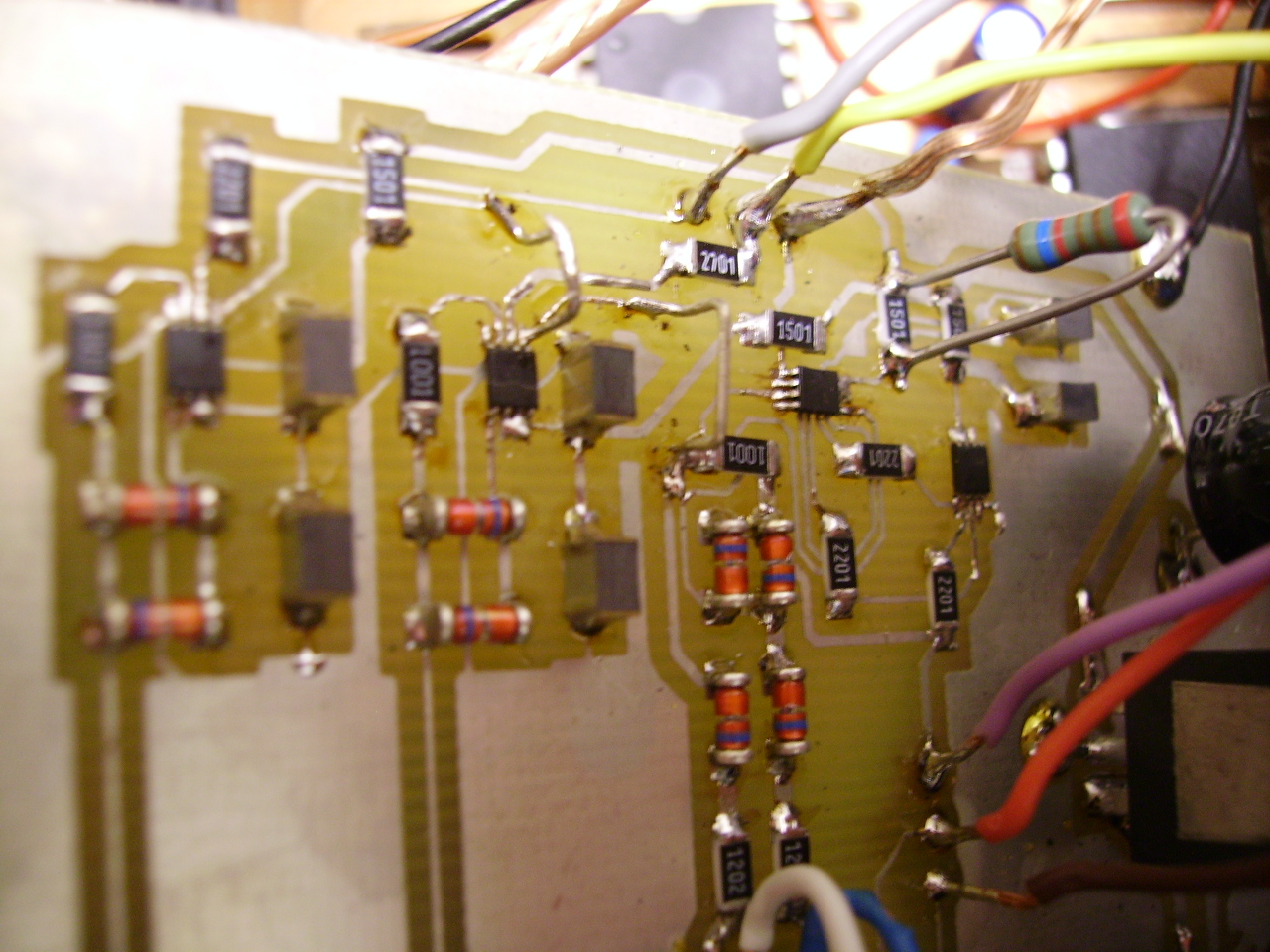

Hi QSerra Tico Tico, not this exactly. I use a gas kitchen fire. I take the chip or the device of my interest with an universal plier, and I put the chip very very near the fire, touching it, for some seconds, even some minutes, and with the extractor fan on, and I wait until the chip plastic becomes a little "white". Then I let it on a plate and wait some minutes until it cools, and then, with my fingers, under running water, very carefully I remove the plastic until I can see the chip. I clean the rests of plastic and I finish extracting the rest of plastic and clean it with water. Maybe the first pieces you try don't work, but with a little practice you finally can do it without problem. It's like solder. Last day I've solded the 4 flip flop smd for the TDA1541A signal treatment of John's design. Because I have more than 21 years in soldering I can do it without problems and quickly. See enclosed photo of my Philps CD player of the 85'. Yes, I now it's a dirty job, but it's sound is incredible now. You can see from top to down: audio out, signal tratment, and my clock, not the last version, but a good one (-171dbc/hz). And respect to the treatmen signal pcb, you can see near the 1206 resistors the chips. Yes I now the resistors are big, but I hadn't at hand other components.
PD: John, thank you very much for your knowledge and for sharing it with us.
Now the CD player sounds with a silence level that remains me a turntable. The detail level, tonal precision, naturality and soundstage is now as real as real music.
