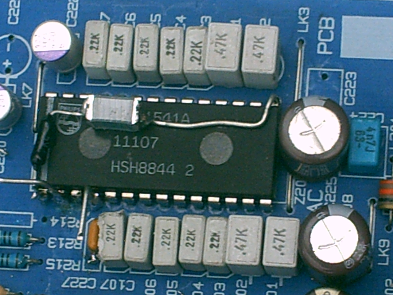

John,
Are these FCN6040E105K-S Cornell Dubilier SMD Film Capacitors
the decoupling caps you use? Are you not worried about the high tolerance (10%) ?

Hi studiostevevus,
No, I used these:
CORNELL DUBILIER|FCA1210C105M-G2|CAPACITOR ACRYLIC FILM 1UF, 16V | Farnell Nederland
From the datasheet:
"Type FCA acrylic film capacitors offer high capacitance values in standard surface mount case sizes. They excel in attenuating DC power bus noise, and as ripple filters in dc to dc power conversion circuits."
The capacitor tolerance is not a problem for this application as it is used for decoupling and is heavily over-dimensioned.
Datasheet app with approx. 200 … 300 KHz DEM clock indicates 100nF decoupling caps.
2.8224 MHz DEM clock and 100nF decoupling caps will give similar performance as when using 1uF decoupling caps @ 200 … 300 KHz, provided the caps are suitable for RF decoupling.
By using 1uF decoupling caps plus the factor 10 higher DEM clock rate I get similar performance as using 10uF RF decoupling caps.
Performance can be further boosted by soldering / hard wiring these caps directly to the TDA1541A pins, very close to the chip housing, and not connecting these pins to the PCB. GND reference can be routed to pin 5 using wires. This way wiring is even shorter and leakage current is reduced to minimum.

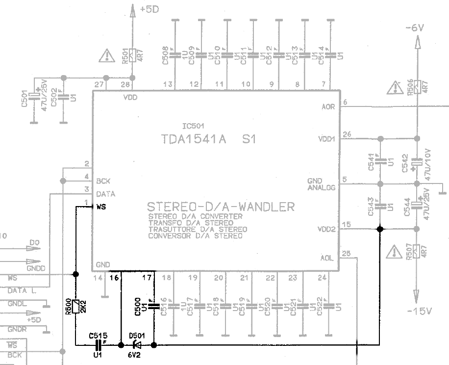

Hi AndrewGM,
One could use a 220pF 2 ... 10% film cap in parallel with a 47pF film trimmer. This way the trimmer can be adjusted until the DEM clock locks on an exact multiple of the bit clock, this can be verified with a frequency counter or oscilloscope. The free running DEM clock can still lock to the bit clock because of on-chip crosstalk between both clock signals.

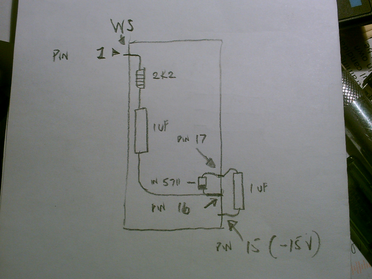

Thank you very much for the reply - The 250pf worked nicely thanks.
I want to do DEM properly though but am absolutely baffled as to which way to do it tbh.
I have a spare 2.8 mhz clock signal I can take from my master clock but still working out what goes to 16 and to 17.
I saw your 4 resistor method but need to understand in better before I chance my machine - which is now too nice to ruin ( i've ruined loads already hence my caution 😱 )
I've already got what you describe as advanced clocking so this will be the icing on the cake eventually.
There's no point in me experimenting with 220pf + 47 now I've heard what 250pf did.
It's DEM next or nothing !!
I'm learning from your very informative posts - don't stop !!
Andrew

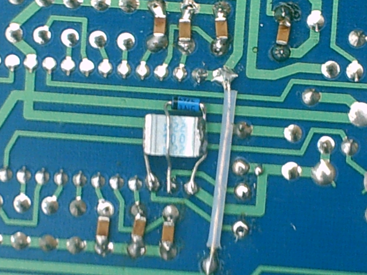

DEM - just once more....
So you don't suggest flip flop for DEM reclocking ?
I am gong to do DEM re clock using the Grundig method on Monday hopefully when the diodes arrive - based on the attached.
Can you confirm this will work satisfactorily or is there a better and easier way you can suggest ?
Sorry if this is off topic
Andrew
Andrew
Can confirm that Grundig works extremely well as per the diagram and drawing
posted earlier.
Fantastic improvement.
That's in conjunction with pins 2 and 4 directly clocked at 5.6 ad 11.289
Very pleased - thanks for all the help - Erin and Thorsten !
posted earlier.
Andrew,
I will try the Grundig DEM clock solution, but it is not clear what are the capacitor values: 0.1 uF or 1 uF? Also your sketch is different from the Grundig diagram around pin 17. Do you use WS or BCK for DEM clock?
If this works, there is no need to use flip-flops. But the BCK needs to be reclocked in this case...
Correct .1 uf - and that's what I used once I got some help.
It's now warming up very nicely and has changed the sound in a very positive way.
