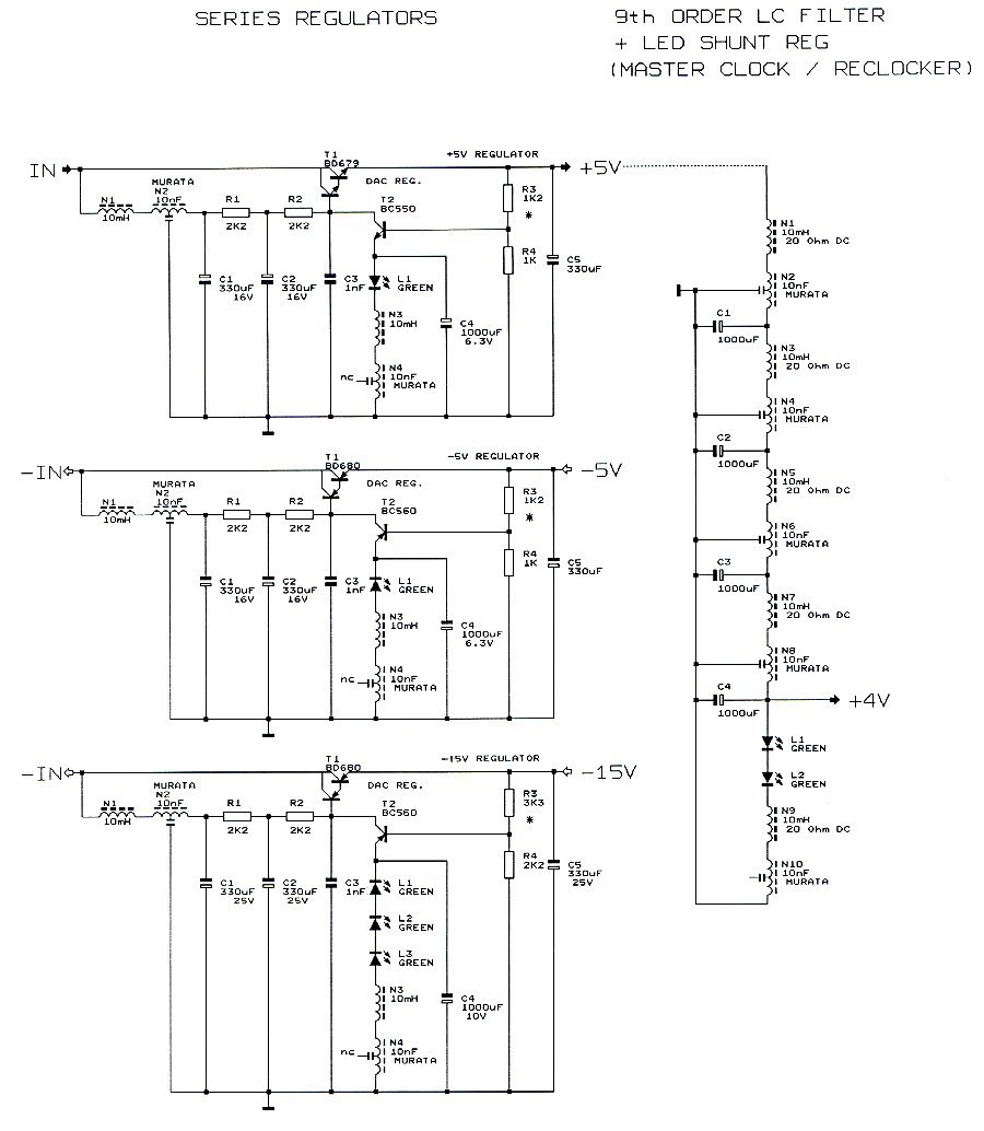

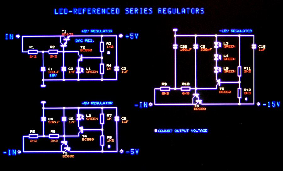

Here are the schematics of +5V, -5V and -15V LED-referenced series regulators with integrated capacitance multiplier for the TDA1541A. Exact output voltage can be set with R3, R8, and R12 (higher value increases output voltage, lower value decreases it).
The circuit works as follows (using +5V schematic as reference):
R1 and C1 form a low-pass filter that attenuates ripple voltage. R2 feeds the cleaned-up DC voltage to Darlington T1, driving it into saturation. C2 provides frequency compensation.
The output voltage is divided by R3 and R4, and connected to the base of T2. T2 emitter is connected to a green LED (approx. 2V).
As soon as the voltage across R4 exceeds 2V + 0.6V (V-BE), T2 starts conducting, reducing the current flow through T1. This way the regulator settles around the required output voltage.
If R4 was removed from the circuit, output voltage would settle around V LED (2V) + V-BE (0.6V) = 2.6V.
The circuit responds very fast (minimum delays), and noise levels are low enough for audio applications.
The LED could be replaced by suitable low-noise zener diodes, but do carefully check effects on sound quality.
Keep in mind that the noise produced by the reference diode is amplified by the attenuation factor of the voltage divider. With the 5V regulator, the LED noise is amplified approx. 1.9 times.
With the -15V regulator LED noise is amplified by approx. 2.7 times.
So try to find an optimum between reference diode noise and voltage divider properties.
The voltage drop across LEDs with different color are slightly different:
Current = 20mA.
Infra-Red LED, approx. 1.3V
Red / Orange LED, approx. 1.9V
Yellow LED, approx. 2V
Green LED, approx. 2.1V
Use plain LEDs (no low current LEDs) for lowest noise. Don't use blue or white LEDs.
I used green LEDs for these voltage regulators as they provide highest voltage drop (2V).
