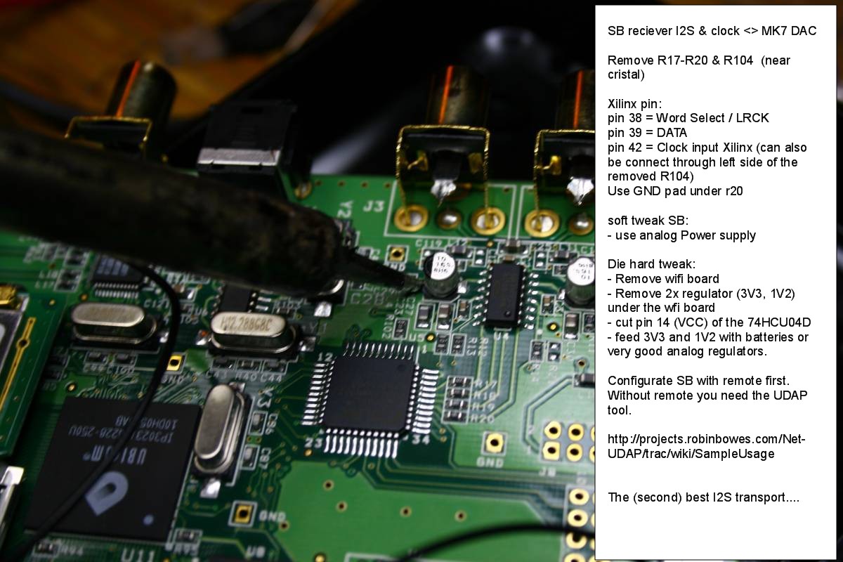

Fully agree. A PC is dirty, even batterie feeded. I went from PC-based I2S to (a modded) squeezebox reciever. Still using that to drive the DAC. Works excellent with Mk7, because the DAC's masterclock only drives the Xilinx processor to sync the WS en DATA lines with the bitclock. So only 4 wires are needed between DAC en SB. I didn't had the change to compare the sound against the SD-card. But i will next time i visit ECdesigns.
Could you give more details on the modded squeezebox? any links to the mod you did to feed the clock from the MK7 and take the I2S signal?
Any links in general to mod a squeezebox for I2S? I am new to this
What about direct fed i2s from Pace-Car reclocker?
I am doing something similar, using a Squeezebox to an Empirical Audio reclocker and then feeding i2s directly to the TDA1541A, with resistors in the path. The results seem very good to me. Is this a possible viable alternate solution?

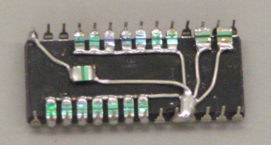

Latest development on the MK7 DAC, improved decoupling for the TDA1541A.
In order to optimize TDA1541A decoupling I soldered all decoupling caps directly to the pins of the chip as close to the IC housing as possible.
This way the added extra length of IC socket pins can be eliminated. The active divider decoupling pins no longer need to be connected to IC socket nor PCB. This further reduces leakage currents.
Isolators aren't perfect, so even a IC socket or PCB adds some leakage current. Problem is that with the TDA1541A the leakage current must stay well below 61nA. With average voltage of approx. 10V on the active divider decoupling pins this translates to approx. 164 Mega Ohms.
I attached a picture of the decoupling caps soldered to a S2 chip. Pin #1 is at bottom right.

Funny, when I made my first TDA1541 DAC around 12 Years ago, it looked a lot like your picture, except I wrapped the TDA 1541 into copper foil and used that as local ground-plane, as this reduced parasitic inductance... One could also use silver foil.
Ciao T

I don't doubt for a second that it's not an improvement but what intrigues me is how the hell you managed to do it without frying the chip :confused:
Hat's off to you for having the soldering skills....astonishing
I'll leave that one ' off ' the list of things to do
Andrew

Nice work! At one point in this journey, I believe the thought was to keep ground lines from each bank of decoupling caps separate, and have nothing else on them. Do you now see an advantage to grounding directly to pin 5, or is it of no consequence to sound quality?
Wlowes
