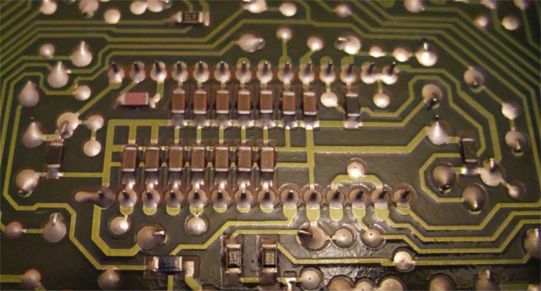

With the recent discussion regarding SMT caps for the active current dividers I thought people might be interested in the pcb layout Philips used in the CD630. Pin1 is bottom right.

Hi JonHarrison,
It only looks better.
Power supply decoupling cap(s) ground share active divider decoupling cap ground. This results in power supply crosstalk on the 6 MSB currents.
Similar left and right channel active divider decoupling cap ground is also shared. This results in increased crosstalk between the 6 MSBs of left and right channel.
Finally digital ground > analogue ground current runs along the ground of all active divider decoupling caps. This ensures maximum interference on the active divider outputs.
The PCB GND traces are rather thin and are likely to have relatively high impedance (poor decoupling), this ensures even higher levels of unwanted crosstalk.
It's better to use separate GND returns for left channel decoupling caps, right channel decoupling caps and power supply decoupling caps. Both analogue and digital GND are best connected separately using a ground plane.
One has to pay very close attention to the GND return currents, making sure to keep all GND return currents well separated so crosstalk is minimized.
Theoretically a ground plane should also work here, but now all GND return currents still share one conductor and would introduce similar problems as with the Philips lay-out.
Keep in mind that PCB copper traces and planes are extremely thin, so resistance is much higher than expected.

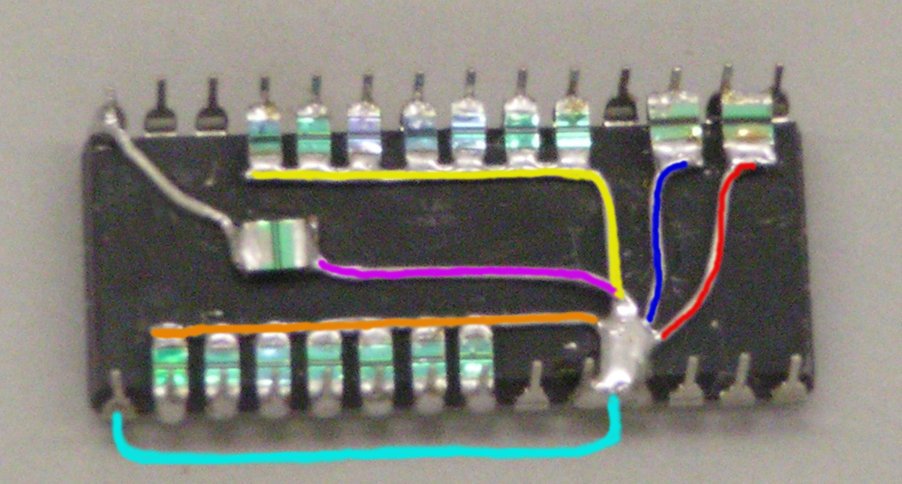

I attached a photograph of TDA1541A hardwired decoupling.
Red indicates +5V decoupling to AGND (pin 5)
Blue indicates -5V decoupling to AGND (pin5)
Purple indicates -15V decoupling to AGND (pin 5)
Yellow indicates left channel active divider decoupling to AGND (pin 5)
Orange indicates right channel active divider decoupling to AGND (pin 5)
Pins 4 and 5 are connected for convenience (pin 4 is nc on the TDA1541A).
Light blue indicates GND plane connection between DGND (pin 14) and AGND (pin5).
I performed some experiments connecting only the -5V (digital supply) decoupling to DGND, but listening tests showed a preference for decoupling to AGND.
With this wiring method, a local star ground is created at pin 4 / 5. This minimizes crosstalk between all connected GND wires as shared GND return paths are avoided.
