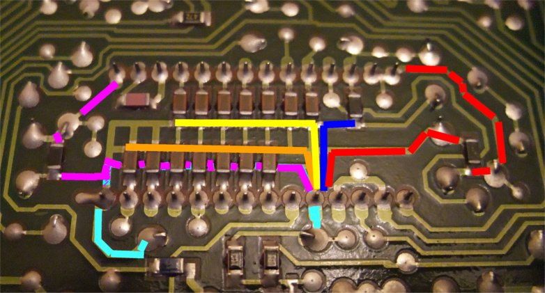

Hi John,
Thanks, as ever, for your guidance and advice.
I have coloured the CD630 pcb with the same colour scheme that you have used.
I think the CD630 would benefit from the following mods :-
1) Cutting the tracks joining the L and R active divider returns.
2) the +5V (red) would be better with a shorter return to pin 5 by moving the cap onto the round pad below the pin and then straight down to join back to the existing red track.
3) The -15V (purple) could be re-routed straight down from pin 15 with the cap joining the ladder at the top left corner and then down and across to the right (having separated off the L and R returns).
An alternative perhaps would to relocate the SMT caps so that one end is directly on the DAC pin and then join it to the existing pin side pad and join them together to make a new return path. The -15V could then use the R return path instead.
Jon

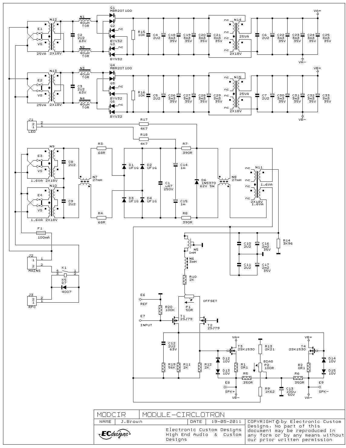

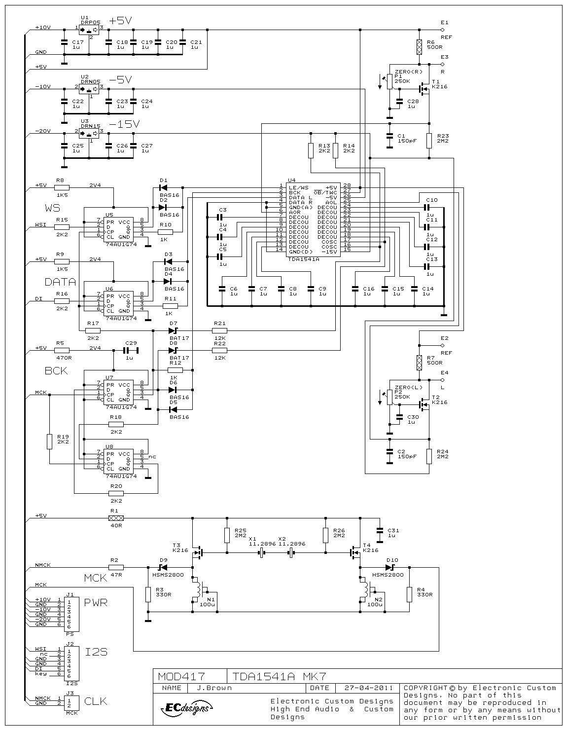

Hi Krokotam_,
I really can'¨t find any scheme in this 382 pages theme , can someone help me ? I believe that this should be the first thing you need to see in this thread !
This thread documents a DAC design process. Multiple schematics were puplished as improvements were made to the design.
The latest design that has proven its performance for quite some time now is the TDA1541A MK7 DAC. The power supply for the MK7 DAC is not final yet, the current prototype with common-mode suppressors is able to equal battery power supply performance while running on a highly polluted mains voltage. Interference / ripple suppression of this prototype equals approx. 280 million on each of the 4 isolated output voltages. Other version is being developed offering interference / ripple suppression factor of 163 billion. I hope to get some marginal improvements in relaxation in the sound using this concept.
The final volume control is the binary stepped shunt volume control, based on non-inductive wire wound resistors for lowest noise and maximum resolution. It uses selected steps from a total of 256 steps to approximate logarithmic response using only 8 bits / switchable resistors. Multiple selected resistors are in parallel, there is only 1 fixed series resistor that is soldered directly between input and output.
The power amplifiers are Circlotron monoblocks with total of 4 MOSFETs / monoblock and passive common mode filters on all power supplies.
With the current setup, the audio set gets "out of the way" leaving only the music. The set is also able to get the very best out of each CD, regardless of CD recording quality. So instead of only enjoying few high quality recordings, I can now enjoy all my CDs. This is probably a result of systematic interference reduction, leaving only the information stored on the CD.
I attached latest MK7 and Circlotron schematics for convenience. Note that all 1uF decoupling caps are now soldered directly to the TDA1541A pins (photograph published few posts ago) and that L and R output pins are also soldered directly to the PCB.
The DRN05, DRP05, and DRN15 are discrete voltage regulators (attached schematics). R4 and R9 set the output voltage.
The only thing that's not on the schematics is the variable reference voltage for DC-coupled DAC output. It consists of a 1K trimmer connected between +5V and GND with a 1uF SMD film cap between wiper and GND. One of these circuits is required for each channel. The pot is adjusted until there is zero volts DC between wiper and DAC output. The wipers serve as "GND" reference for connected equipment.

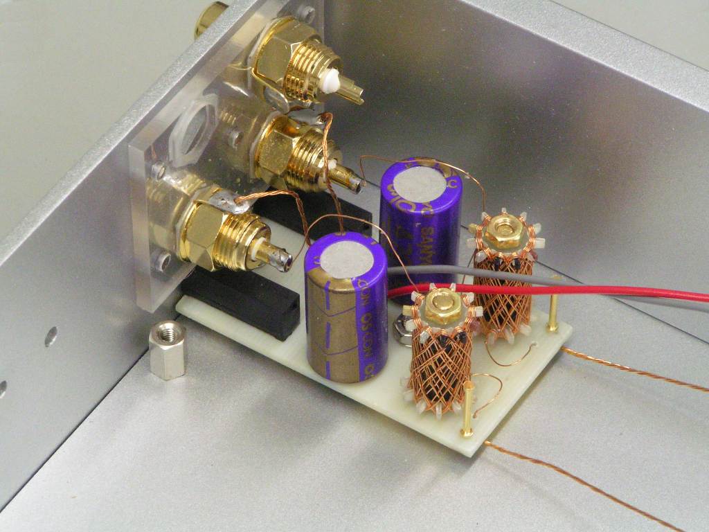

My mistake, I use 470uF Oscon caps here (attached picture). The DC bias circuit contains of a 1K (bulk metal foil) multiturn trimmer, a 470uF / 16V Oscon decoupling cap and a Honeycomb Mobius loop for each channel.
The 1uF SMD film caps are used on the wipers of the DC-offset pot on the MK7 board that is used for achieving 0V DC on the DAC chip output pins.

Hi studiostevus,
John, why have you chosen not to decouple the power supply for each individual flipflop?
I left out local decoupling for U5 (WS synchronous reclocker) and U6 (DATA synchronous reclocker) only. These signals are being sampled by BCK so transient rise time is not very important as long reliable sampling is still possible. The transients however do introduce interference, the faster the transients, the more interference. This is especially problematic with the DATA signal that can easily swamp the connected DAC chip with interference.
CMOS logic draws maximum (surge) current at signal transients. With effective local decoupling these surge currents are boosted. This in turn increases interference and risk of triggering resonance circuits (ringing). So decoupling isn't always a guarantee for less interference, in some cases it can make matters worse.
One way of reducing transient surge current is reducing available current for the circuit (current limiter). I used 1K5 resistors in series with the flip-flop power supply rail to achieve this. Using a local decoupling cap would create a reservoir that enables surge currents again, so I had to leave it out.
The 1K5 series resistor also places a high impedance between reclocker flip flop and 5V power supply. The resistor value was chosen to get around 2.4V power supply on the flip flop when processing I2S DATA / WS signals.
The flip-flops are required to attenuate source jitter (synchronous reclocking) and driving the I2S attenuators that require a balanced drive signal.
Also you have removed the ferrite beads in the latest mk7. What has been your experience in using/removing them?
Ferrite beads only operate in a specific frequency range. So they basically filter only part of the interference spectrum. This leads to unwanted coloration of the sound. I experienced distortion / coloration in the upper audio frequency range as result of using ferrite beads.
In the MK7 I use RC filters and extremely clean power supplies instead. In order to maintain some degree of control over feedback loops, I started using fast local feedback loops, also in the voltage regulators.
The latest development in the MK7 power supply is a common mode ripple filter followed by a common mode filtered buffered zener reference. The voltage regulators on the MK7 board were removed / bypassed for this experiment.
I still have to perform direct comparison with common-mode ripple filter plus MK7 discrete voltage regulators. First impressions are increased sound stage, very natural sound (timbres) and the impression of attending a true live performance.
