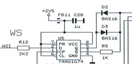

Hi EC,
Could you please explain about this circuit? I'm thinking of for days but don't understand how it work and its effect. I used 74HC175 for reclocking in my TDA1541A DAC so far and would try apply your circuit on. But I don't understand it well.
Thx and Rdgs,
Art.

Hi Art,
The circuit attenuates I2S signals to low level signals that can still reliably drive the I2S inputs of the TDA154x. TDA154x has current mode I2S inputs that are compatible with 5V TTL signals.
By minimizing signal amplitude, less RF energy is dumped into the chip internal circuits (reduced ground-bounce). This in turn helps to reduce related on-chip jitter levels.
In the MK7, BCK attenuator is driven by a divide-by-4 circuit and DATA / WS are driven by synchronous reclockers.
The I2S attenuator circuit is driven by an ultra high speed flip-flop running at approx. 2.4V power supply. Fast logic runs on lower power supply voltages in order to reduce losses / interference.
The voltage drop across the diodes equals 0.6V typical.

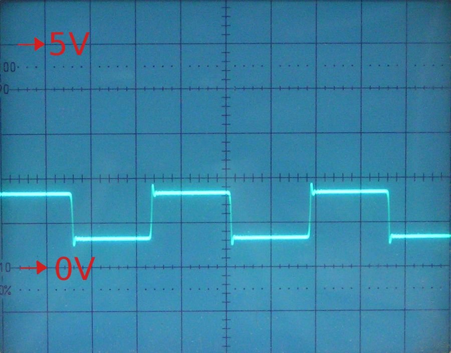

Output is logical zero, Q = 0, /Q = 1:
/Q tries to put 2.4V on the output through R5 (1K), but Q pulls this voltage down to 0.6V (D2 conducts). The output voltage for logical zero now becomes 0.6V.
Output is logical one, Q = 1, /Q = 0:
/Q tries to pull the output to 0V, but Q pulls it high (D3 conducts). However, the voltage drop across D3 will limit output voltage to 2.4 - 0.6 = 1.8V.
So the attenuator output will swing between 0.6V (logical zero) and 1.8V (logical one). The output signal amplitude equals 1.8 - 0.6 = 1.2Vpp. I attached a picture showing the BCK output signal.
I use these I2S attenuators on all I2S signals, BCK, WS and DATA.
