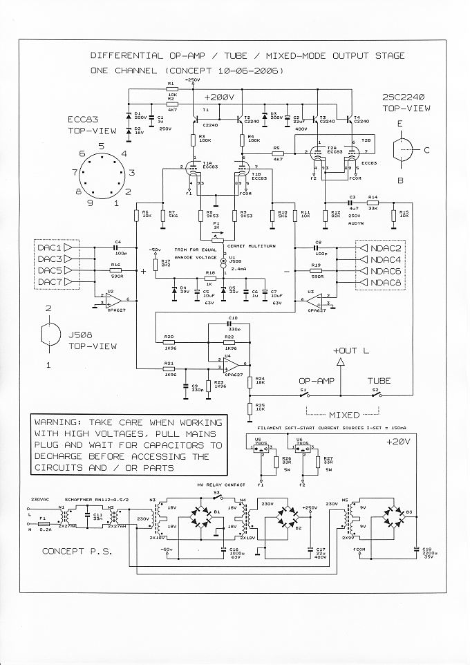

Current output stage schematics
Hi tubee,
That's bad luck,
similar things happened to me after modifications or repairs. Have you already checked if perhaps you dropped some soldering tin on the circuit board that causes short circuit?, or accidently interrupted a track during component replacement. A thourough visual inspection might help locating the fault. Also check if all connectors are placed in the right locations, and also check for bad soldering joints, especially the connector pin's. These tend to interrupt after working on single-sided circuit boards. You can also remove the kwak 7 clock and restore the original setup, to see if it's causing problems. Try to elliminate errors step, by step. Another good tip with modding is to do one modification at a time and then recheck, so when something goes wrong you know exactly what modification caused it. It's also good practice to visually inspect the entire board after a modification has been made, before switching-on. When something doesn't work, switch-off immediately to avoid damage.
I also added a schematic diagram of the current octal D-I DAC op-amp / tube output stage, I am using right now, but it's still a concept.
This shows how both OP-amp and tube output can be switched in the mixed mode. The tube stage is optimized, it now uses ECC83 double triodes. Gain has been corrected, cascaded zener diodes reduce ripple current to very low values. I used a FET-based current source (J508), noise is very low now. Two cathode followers have been connected in parallell for lower output impedance, since I don't need a differential output. T1...T4 are used for power supply stabilization for each separate triode, they fully eliminate hum. Note that pin 9 of T1a is connected to ground, also to reduce hum. The I/V stage and differential OP-amp stage are added for illustration.
S1 closed: OP-amp mode, S2 closed: Tube mode, both S1 and S2 closed: mixed mode. output attenuators: R14,R15 and R24,R25
I also designed a different soft-start filament supply. It uses a 7805 voltage regulator together with a 33 Ohm resistor to form a 150mA current source (I=5/R). The filaments start-up beautifully without any current surge, because the current cannot exeed 150mA. The current sources also provide very low ripple current at the filaments.
I generated the +250V HV supply by using 2 standard transformers, When using 110V mains voltage, N3 has both 115V windings in parallel, N4 has both 115V windings in series. The 18V windings also provide the negative 50V supply.
I am using 2 cascaded schaffner mains filters and a 33nF capacitor for mains filtering. S3 switches-on the HV supply when the filaments have heated-up, and switches it off again before filament supply is switched-off.

output stage schematics, second attempt
Hi weegs,
Thanks for your compliments,
> The octal D-I DAC design is taking shape now, currently I am making last modifications to the tube output stage, then I will start with the circuit board for it. Again 2 separate compact modules for L and R channels will be used.
This design stage is quite complicated as these modules have to be "merged" with the housing I am planning to use.
Next on the agenda is the digital mainboard containing the already completed SPDIF interface, USB to I2S module, system control module and the digital input selection module. I will post a block diagram later.
There will also be a small attenuator module for Tube / OP-amp and 1 external analog source selection, so you will still be able to route a analog channel.
After all modules are ready and fuctioning, I will start designing the main power supply. Problem here is the high-quality DC converter for the tube output stage that is necessary for battery operation only. Yes, I will try to provide a connection for supplying this Octal D-I DAC, tube output included, on 4 X 12V batteries too. Power consumption is approximately 30 Watts at the moment, including the differential tube output stages, so battery operation must be possible.
> At the moment I don't sleep much, remember I also have to run my small electronics company and this project is a "hobby" project along the side. But as they say, "hobby" projects are most important 😀.
> Yes, electronics is my passion, as I indicated before. When I build something I put my heart and soul into it, always striving for perfection, and that's about the best one can do.
> When the octal D-I DAC design is finished, I plan to get professional boards manufactured, I will start with a small batch, then re-order as desired.

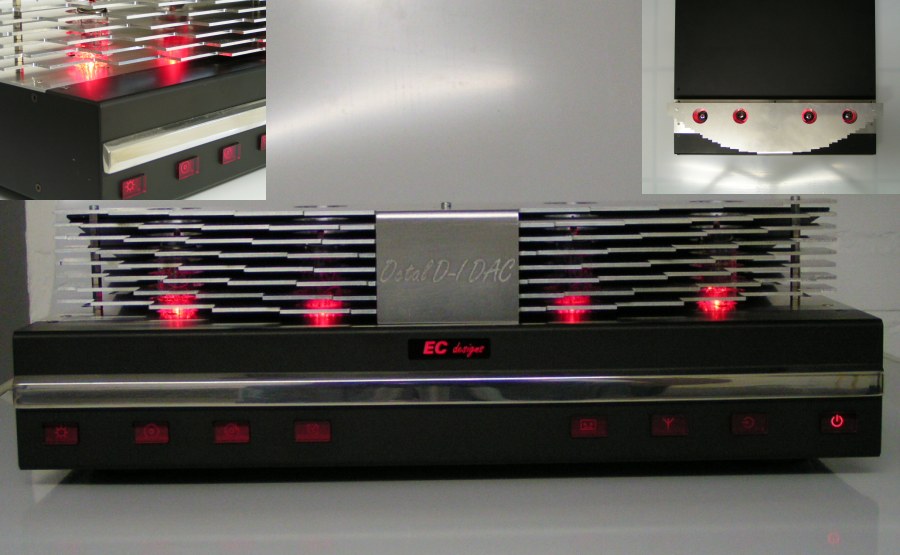

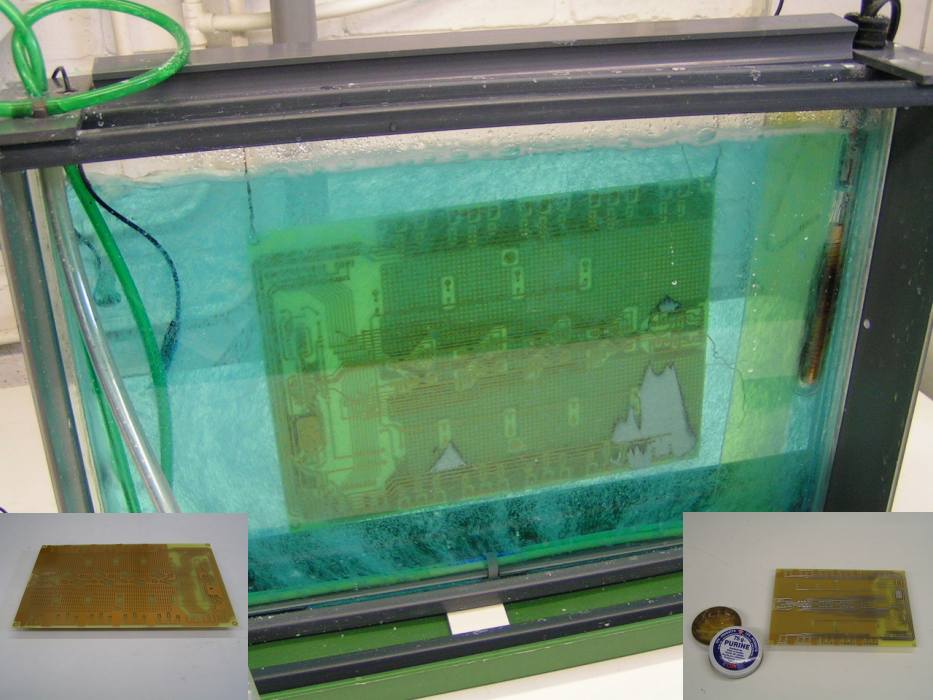

glowing tubes
Hi a333bt,
Thanks for your compliments [post#325],
Thanks for the tips, but the file was OK, I already used the GIMP to edit both photographs and scans when I started this thread. Seemed there was a problem with attachments, this was also indicated in the anouncements. But I am very pleased that you offered your help.
You indicated that you like the design, well I got a little surprise. I just couldn't wait any longer as I wanted to get an overall impression of how the octal D-I DAC could look like. So I mounted the sinewave shaped protection grid on a existing switchbox housing with a tube chassis plate I milled today, and mounted the tubes with status indicator LED's.
Enjoy!

Hi EC,
This dac looks very nice, well done.... very impressive indeed 🙂
Have you thought about including Guido's XO DAC PLL so spdif IP
can be used and still get low jitter performance. It would be a
shame for such a nice design to have compromised jitter
performance.
The DEM reclocking is also a great idea.
However I think the OP stage maybe can be improved to use the
excellent design to it's fullest potential.
My thoughts are that if you have 4 DACs, each outputting +-2mA for
a total of +-8mA then this is a lot of OP drive to work with, so use it
to your advantage, don't just stuff it into an opamp to deal with.
If a zero FB current conveyor type is used then the load R needs
only be 350R for a full 2V rms / phase. This means a single stage
OP that has very high OP drive and no follower or opamps. Refer
to John Curls comments on the Blowtorch preamp thread WRT OP
stage without follower.
With the above circuit approach running into such low value load
(350R) a huge dynamic range can be had for the I-V. >120dB is
easily possible.
Also, the I-V should be ideally direct coupled without caps in
signal path.
I think this would consitiute the ultimate OP stage for what looks
like maybe an ultimate dac.
Any thoughts?

Ecdesigns: i like the current sources above the ECC83's
How does the 6.3 voltage get to the tube? I saw f-f runs on 20V.
I have a filament in the headphone amp which terribly lights up after switch-on.
Btw, still busy with the 304, cannot find the problem
Thing is, as the dacs are firing sequentially, you don't have 8ma.
hi tubee,
thanks for your reply [post#328, #332]
[post#328]
> Yes, this thread has already passed 22,000 views, I am very gratefull for for the interest and support you all have shown for this project
. Therefore I will take this opportunity to thank you all .
[post#332]
> The transistors in the ECC83 annodes (above the ECC83) are no current sources, but stabilize the annode voltage at 200V, very close to the annodes, they also provide a isolated supply for each triode. This way hum is greatly reduced.
> The filament current sources, connected to 20V, provide a constant current of 150mA, this way the filament is current driven and automatically settles around 12.6V (2 X 6.3V filaments in series, pin 4 and 5 used). Of course this current has to match the tube's filament specifications. Major advantage is low hum and a perfect "cold start" , limiting surge current when the cold filament has a low resistance. I plan to put these current sources in the main power supply.

[post#332]
