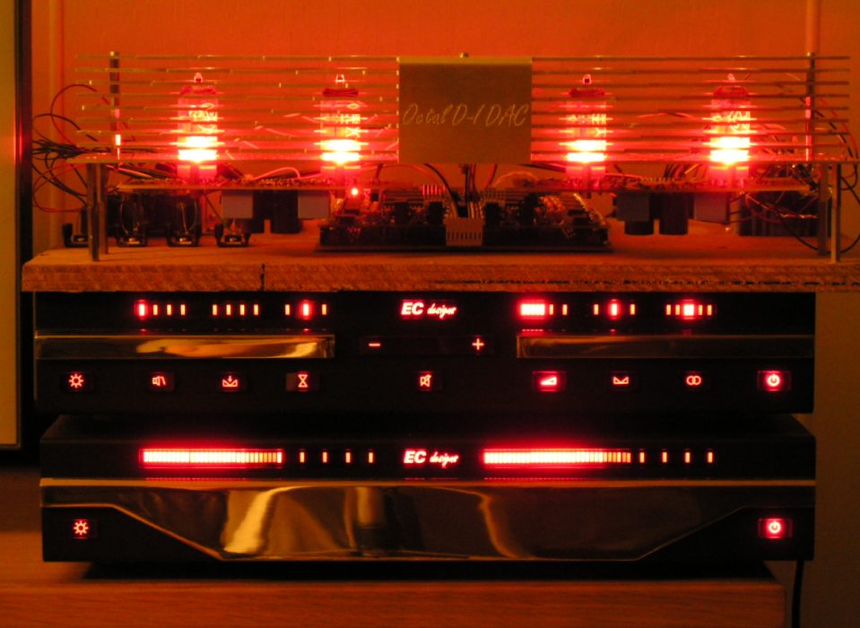

new prototype in action
Hi all,
I have mounted the tube module / frame on the prototype board, using a new setup. I arranged components the way I plan to place them in the housing. Connections are kept as short as possible. Taking dddac's advice I added frequency compensation on the attenuators / interlinks as I couldn't lower impedance much more due to the tube output stage. Now both attenuators and interlink capacitance are compensated.
The tube stages seem to function beyond expectation on the PCB's, they are stable, output signal is clean (I was afraid of both, crosstalk and oscillations). The protective grid does a marvelous screening job when earthed.
I listened to this setup till deep in the night, seems the compact setup with shorter connections made some improvements in clarity and interference reduction.
I added a night photograph of the new prototype setup in action

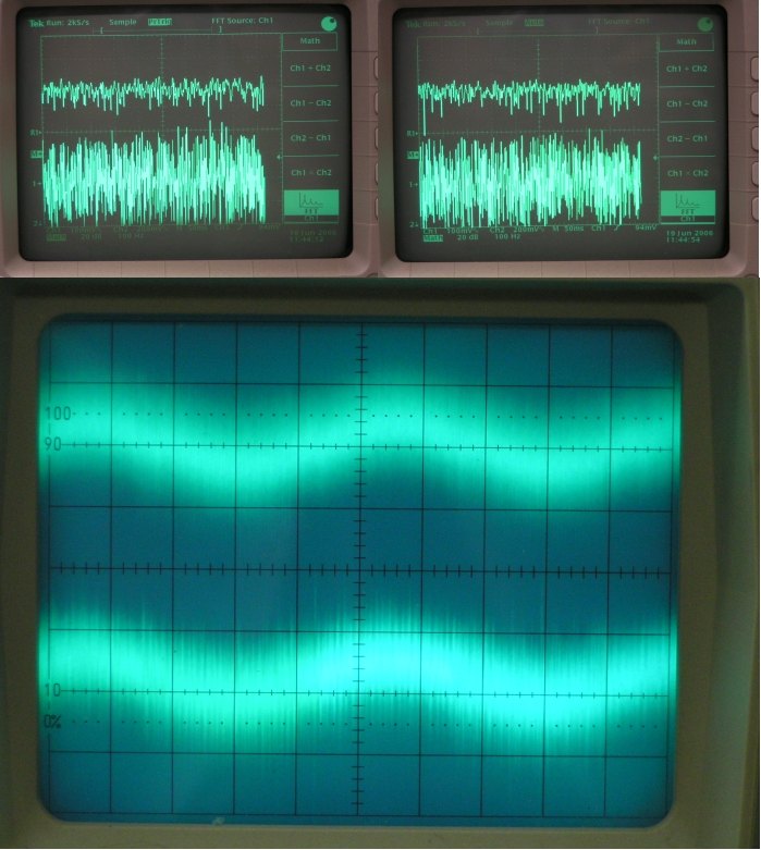

Hi Bernhard,
Thanks for your reply [post#359 / #365],
Here are the FFT scans of the -60dB dithered 1KHz sinewave, as promised. Top left, octal D-I DAC, Top right CD player with digital filter and oversampling. I can't see much difference, note that the displayed spectrum keeps moving. Probably limitations of the tektronics digital oscilloscope. I also added a oscillogram, perhaps this shows a little more. Upper track, octal D-I DAC, lower track CD player with digital filter and oversampling. Note the octal D-I DAC is unfiltered, the CD player with digital filter and oversampling is.
-ecdesigns- said:Hi Bernhard,
EC, try some BW limiting above 100k or so. The scope traces will
probably reveal a lot more. The scope is just showing ultra wide
BW noise. Since the peak to rms of noise is very high (up to 6 x)
the traces get flooded.
Even so, the D-I dac trace looks good.
If you play the -60dB signal, it is quite audible, makes you
realise how much we can hear down there, especially if a CD
has not been squashed (compressed) too much.
Terry
EC,
Is there any chance you can get a scope shot of the non D-I 0 x OS
dac at same -60dB OP for comparison?
Terry

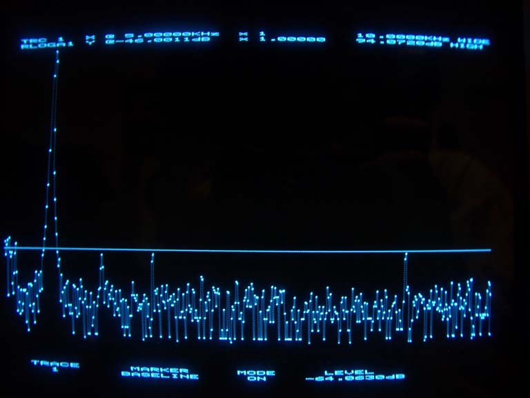

Dear EC,
I believe linearity is very important, and the problem is in the low level.
@ 0 dB all DACs are good.
Some people say you can't hear it but it is not true. A DAC with good low level linearity sounds more pure and smooth and has better resolution, no matter os or non-os.
If one hears a more black background which means less noise, usually from a high bit DAC, one also must hear the distortion because the harmonics are far above the noise floor especially in DACs > 16bit.
The distortion gets more noticable with more bits = less noise.
On your FFT unfortunately there is nothing to see, not even the fundamental 1 kHz.
I made another -60dB measurement of a selected PCM56, about one out of 30 is that good with careful made MSB adjust.
The PCM56 is in a Yamaha player that fakes 18bit from the 16bit chip, just like the CD304 fakes 16 bit from the TDA1540, which also reduces noise.
This graph is with 16 x averaging to cancel the noise and see what happens under the noise floor.
The horizontal cursor line marks the level of the worst harmonic which is -64dB relative to the input signal.
And this is without averaging, the noise floor is -60dB, so there is nothing to see, harmonics are 4 dB down under and would be even more hidden in a standard 16 bit player.
Did you think about adding MSB adjust to the TDA ?
A normal TDA1541A usually produces a strong dominant K5 that will be somewhere between -50dB and -55dB.
Unfortunately I have no TDA1541A graph to show and no chip to measure either, here are both channels of a plain 1541 with 4 x os in a Philips CD960, the even order harmonics usually are less in other players, that is a general flaw of the 960.
But the values for K3 on the cursor line are realistic.
-51,3dB and -58,8 dB.
As you also can see, left and right channel look different and will sound different which can disturb sound stage.
With 1541A in standard non-os ( skipping the SAA7220 ), the dominant K5 turns into something like shown in the graph, more evenly distributed harmonics which means all K2 up to K9 around -50dB.
