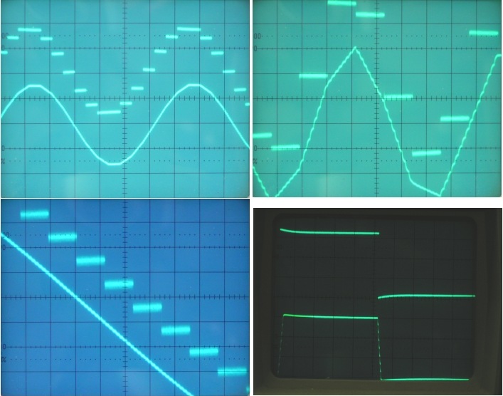

Some octal D-I DAC oscillograms
Hi all,
I added some oscillograms that show comparison between signals generated by a standard NOS-DAC and octal D-I DAC, both DAC's get the same SPDIF input signal, this might put things in perspective. Oscillograms also show both DAC output signals run nicely in phase.
Photo top left, shows how the octal D-I DAC smoothes a course stepped sinewave
Photo top right, shows what is still recovered with very few steps.
Photo bottom left, shows a 500Hz sinewave greatly magnified, notice the gained resolution
Photo bottom right, shows a 1 KHz squarewave, notice the flat responce and the steps on the transient
So the squarewave shaped signals with mainly odd harmonics, are converted to a more sawtooth / triangle shaped signal with more even harmonics. Soundwise even harmonic distortion has a less negative effect on sound quality then odd harmonic distortion.
The major harmonics are caused by the difference between a pure sinewave and the stepped approximation. The harmonics amplitude is in relation with the amplitude of the error signal. By generating smoother stepped sinewave signals, the amplitude of the error signal drops accordingly. The harmonics are still there, but their amplitude has been lowered. By the higher virtual sample frequency, harmonics are shifted up the spectrum, so interference in the audio spectrum is reduced
One could use a (Bessel) filter to attenuate these residual harmonics, if desired, they are already attenuated by bandwith limiting in the amplifier

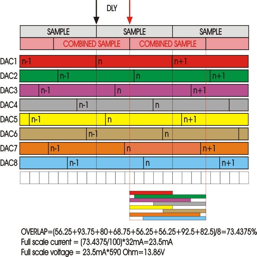

DAC combined outputs
Hi all,
I tried to draw a graphical representation of what happens with the 8 combined DAC outputs. If I am correct, overlap in the combined sample is about 73.4375%. Note that the combined sample has a delay of approx. 43.75% when compared to the main sample. One complete sample time = 100%. Full scale current is 23.5mA, full scale voltage is 13.86V when using 590 Ohm in the I/V stages.
Each DAC is represented in a different color for clarity. Combined graphic representation is in diagram below. Current sample = n, previous sample = n-1, next sample = n+1. Scale below is 8 BCK/division.
Hope this will clear things up a bit

Re: DAC combined outputs
Drawn that way, it looks like the samples overlap but add in the timing and WS and a different picture emerges. Look as WS the signal that triggers conversion. Each negative going edge of WS is separated by 8 BCK cycles when 8 TDA's are used. 8 BCK cycles amounts to 2.84us. The converted output appears at the first positive going edge of BCK after a negative edge of WS i.e half of a BCK cycle or 0.178us include setling time and the output is stable after 0.678us. The output stage does not see another sample for more than another 2us. This is the same as a single dac connected to a 8x oversampling filter where every sample appears at an interval of (22.7/8)us.

EC, don't want to waste your precious time
but you could clarify it by measurement 😀, give each output an individual passive I/V resistor and show as many DAC outputs on your scope as it has got channels.
So we will see what is the matter with overlap and parallel.

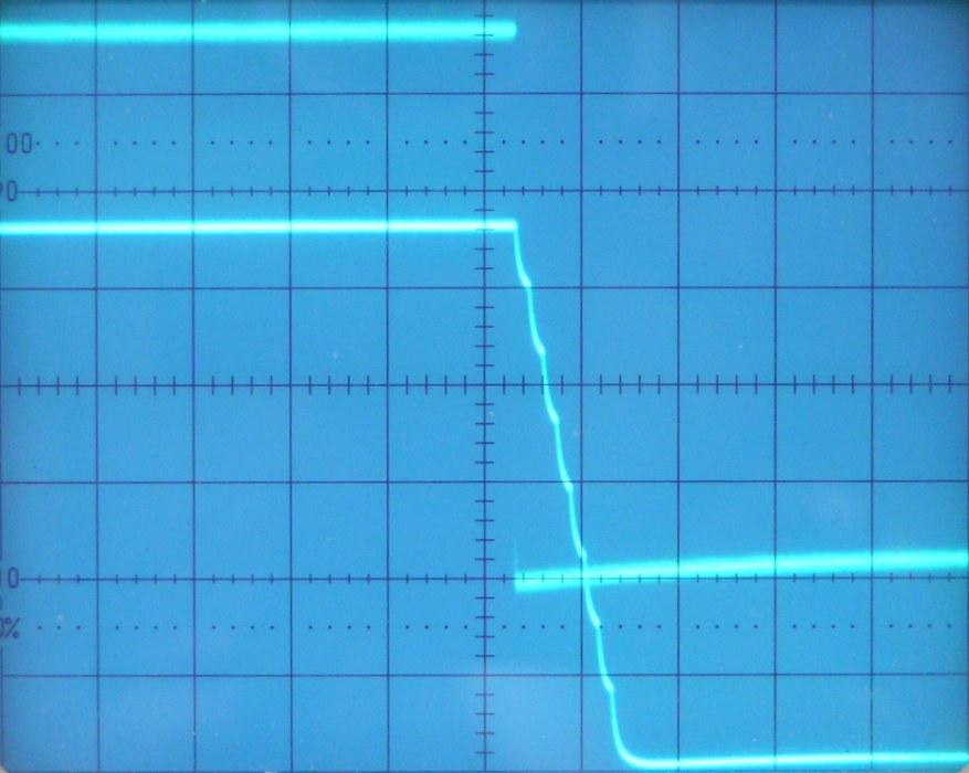

2 sample response
Hi rfbrw,
Thanks for your reply [post#418]
Yes you are right, there is a delay of DAC outputs 2...8, being 0.5 * BCK (177nS), typical settling time of the TDA1541A is 500nS. So a total delay of 677nS after WS negative going edge. But the same applies for DAC1 as well as it is also triggered after 0.5 * BCK. So relatively, there is only approx. 2.83uS between samples (BCK/8). Both DATA and WS are delayed by the synchronous serial shiftregister timing chain before applying them to each individual DAC2...8. At a given time all 8 DAC's have (part of) sample n at the output, as 8 individually controlled DAC's are used. This is the overlap of sample n. I used the difference between zero delay (DAC1) and max delay (DAC6) 56BCK and divided this by 2 (28BCK), being the centre point of the combined sample. Then I calculated the overlap with this point as reference.
I added a oscillogram of a squarewave transient, to illustrate this. Upper trace is the output of a a standard NOS-DAC, lower trace is the octal D-I DAC. So now we have only 2 different sample values, and can observe how the samples appear at the output. The 8 steps seen are created by sequential switch-off, of the DAC output currents. The average delay can also be seen.
