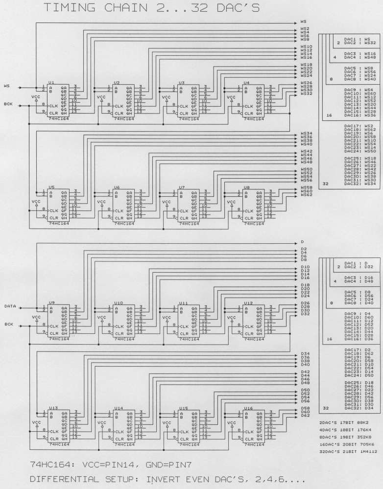

I set up a schematic diagram for a universal timing chain that supports 2,4,6,8,16 and 32 DAC chips. It uses 16 X SN74HC164 or HCT64, highest resolution is 2BCK. It can be used for experimenting with higher virtual sample rates for addittional harmonics amplitude reduction.
I also did some experimenting with high speed optocouplers (HPCL2630) to replace the isolation transformer in the SPDIF audio interface. This opto-coupler has very low capacitance between input and output, this reduces crosstalk quite a bit. I still use the differential RS422 driver DS8922 in the CD player. The HPCL2630 contains a dual opto-coupler, series resistor (LED) at 5V : 220 Ohms, open collector pull-up resistor : 390 OHm. This opto-coupler could also be used for isolating a I2S interface (2 X HPCL2630 needed) avoiding ground loops.

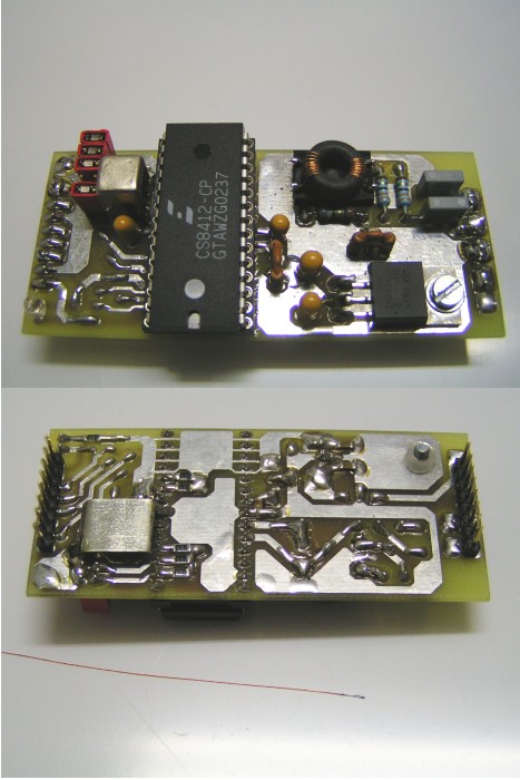

Optimizing the CS8412 audio receiver circuit:
I made a new low capacitance 1.4pF 1:1 pulse transformer using a small 10mm diameter ringcore. Using self-made enamelled stranded wire (12 very thin insulated strands twisted together). Then I lowered the impedance of the loop filter (270 Ohm with 680nF), 270 Ohm is a metal film 1206 size SMD resistor. Finally I put a screen from a old MF transformer around the 680nF BC foil capacitor and connected it to ground. I also put a screen plate on the solder side covering the area above the CS8412 loop filter PIN's. Now when observing BCK transients on maximun oscilloscope setting and X10 enhanced timebase, they look very clean, no haze at all. So the circuitry around the loop filter is very important to obtain low jitter, as any picked-up (HF) interference will increase PLL jitter.
The sound quality confirms jitter must be lower then before now, I am quite happy with the result. I will post a photograph of the modifications made.

Photograps of modified SPDIF module
Hi all,
Operation I2S failed,
Seems there is a firmware error in the CX2587Q (things like that always happen to me). WS = 44.1KHz (ok), BCK = 2.11677MHz ? DATA is in sync with BCK, the frequency is way too low. Result: very weak extremely distorted sound. Data for both CX2587Q and TDA1541A is 2's complement MSB first. Good news is, the CD player still works.
I also added a photograph of the modified SPDIF interface. Description [post#455]
Upper photograph: screening of the loop filter film capacitor (metal square close to the red jumpers), on the right, the new 1:1 ringcore pulse transformer.
Lower photograph, solder side with the loop filter screening on the left. Below the circuit board is a piece of stranded wire I used for the transformer. This stranded wire has good high frequency properties.
Hi all,
