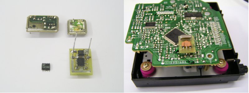

mini clock upgrade
Hi tubee,
Thanks for your tip [post#463]
> No I didn't have enough space for a KC7 upgrade, I had to use a mini clock upgrade. Here is what I did, I gave a 20MHz crystal module (from an old network card) the EC designs demolition treatment. Inside the metal case was a small circuit board with a 8 pin WF10192 programmable SMD clock oscillator chip. So I designed a small circuit board, took the 16.9341MHz crystal from the sony and put everything together. Then I soldered the PCB very close to the CX2587Q Xtal input pin. I added some photographs. The sound quality has improved indeed, good tip.
WF10192 connections:
pin1: enable (leave open for normal operation), pin2: crystal, pin4: ground, pin5: output
pin7: crystal, pin8: +5V
only pin3 connected to ground: output divide by 2
only pin6 connected to ground: output divide by 8
both pin3 and pin6 connected to ground: output divide by 4
both pin3 and pin6 open: output equals crystal frequency.

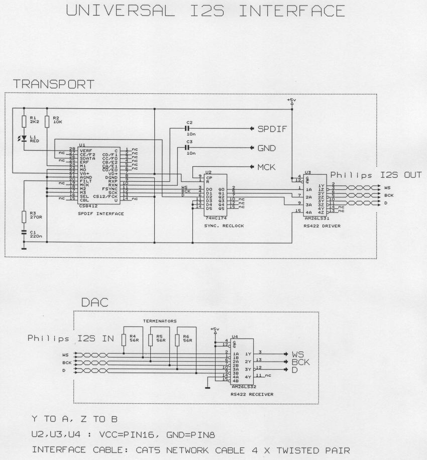

Universal I2S interface schematics
Hi all,
Problem1: SPDIF jitters
Problem2: I2S comes in different formats (compatibility)
Problem3: How to transport I2S to a external DAC
Solution: Universal Philips I2S interface (can be added to almost every transport).
Basically SPDIF jitter occurs because both data and clock signals are mixed using Biphase Mark Code and then transported to the DAC by a optical, coax or differential interface cable of a few meters, jitter is added to the integrated clock signal by the varying data content.
So let's forget about SPDIF and move on to I2S,
What signals are present in almost every transport? SPDIF and the master clock (low jitter guido tent or elso kwak clock).
Now suppose the the audio interface chip (CS8412) was placed in, or very close to the transport instead of the DAC. It could be directly driven by the SPDIF output signal of the digital processor chip without using long cables or transformers. It would also automatically convert to philips I2S format (jumper settings). Then the icing on the cake, BCK, DATA and WS can be synchronously reclocked by the (low jitter) master clock that has a fixed phase relation to both WS and BCK. D-flipflops can be used for reclocking.
Now we have a universal very low jitter philips I2S interface in the transport. The 3 signals WS, BCK and DATA can be transported by using 3 differential RS422 interface drivers (1 X AM26LS31). On the receiving side (DAC) we use RS422 interface receivers (1 X AM26LS32), the lines can be terminated at the DAC side (54 Ohm). And why not use a standard cable available for this purpose: (screened) cat5 (4 X twisted pair) network cable. I am sure this will significantly reduce jitter as the transported clock signal is a non-modulated squarewave of a constant frequency. It will also solve I2S compatibility problems.
Oh, yes I already added a rough concept schematic diagram of this universal I2S interface. I am sure lots of improvements can be made, but it's a start.
A sentence or two later.
Do you not see the contradiction here?
What can you possibly want to connect to, where the above would be an advantage?

I think rfbrw has a good point here.
The I2S generator you specify will work, but maybe isn't the best choice.
Although you have the SPDIF converter close to the source (so less chance of errors being introduced), you're still multiplexing three signals into a single, selfclocking one, and then changing back. That will surely introduce issues?.
Wouldn't it be simpler to convert the sony format into I2S? Or better still, find a Philips based CDP for a transport?

octal D-I DAC interface
Hi all,
Lots of discussions going on about interfaces and formats. I have been very busy with interface measurements and listening sessions, so I will reply to posts later. The following is very important.
Project news,
The clock upgrade and the universal I2S interface produced an improvement that really shocked me, I never expected such an improvement was even possible. The improvement was verified by other people that listened to this setup and could directly compare it with the "old" SPDIF setup. Also note that this interface outputs the PHILIPS FORMAT that is needed for the octal D-I DAC, so no further conversion is necessary. If your transport already outputs the philips format, the CS8412 is not necessary of course.
Here is what I personally can conclude from measurements and listening tests:
Never ever transport SPDIF over a longer cable (>20cm), it will have a very bad effect on sound quality. I am afraid, a similar effect would occur using USB, as this signal also carries both data and synchronization. In fact the PCM2706 datasheet already indicates a SpAct PLL circuit is used to recover a low jitter audio clock from the USB packet data.
The good news however is when the SPDIF / USB cable is kept very short and no transformers are used, things look quite different. So it's of paramount importance to put the SPDIF / USB receiver as close to the source as possible, then transport the generated I2S signal by using the differential interface. When reclocking can be applied as well, I2S performance can be obtained.
I am 100% convinced now transporting I2S using the differential interface, outperforms SPDIF by far.
Using a stable low jitter clock in the transport is a must.
Octal D-I DAC setup:
So this will have quite a impact on the octal D-I DAC setup. Now it will accept I2S with a differential interface exclusively, putting any other audio receiver in the DAC housing is useless when optimal sound quality has to be achieved, as the audio receiver now has to be placed close to the source, not close to or in the DAC.
During testing I used standard 3 meters long unshielded network cable, I also cascaded D-flipflops in the universal I2S interface (there were 3 unused). I also inverted MCK. I will post a new diagram soon, no optical isolation was used, only RS422 drivers and receivers. The DS8922 (4X) was used with 100 Ohm termination as the other chips didn't arrive today.
