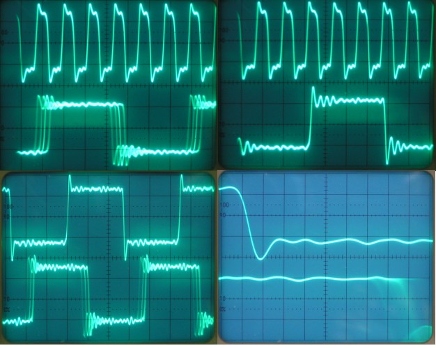

USB and jitter
Hi MGH,
Thanks for your tip [post#529]
Yes as this article indicates, jitter problems can be expected from USB. Just like I already noted [post#500].
Back to the CS8412 connected close to the transport, it has jitter on BCK, I reclocked BCK, DATA and WS with the 16MHz master clock from the transport (using 2 cascaded D-flipflop for each signal) This works perfectly, when triggering the oscilloscope on the masterclock (reference), the reclocked BCK is rock solid, BCK from the CS8412 already shows jitter. So this way very low jitter I2S signals can be dereived from a jittery SPDIF interface on the transport side.
Now let's tackle the USB interface, the PCM2706 generates the jittery I2S signals just like the CS8412 did in the transport. So all that is needed is reclocking it with the "USB masterclock". To be on the safe side, a cheap USB interface add-on card is used. I got one right here from Lacie, it uses a 48MHz crystal to clock the USB host controller chip (D720101J from NEC). So we are going to do a clock mod on this card, the crystal oscillator module from this card is removed and connected to a clean 5V supply, the output signal (48MHz) is fed back to the D720101J. It is also used to drive the D-flipflops to reclock the I2S signals from the PCM2706, the USB interface can be placed very close to this USB card. Now we have a I2S low jitter signal from the USB bus.
Now for the proof, reclocking can actually work, I added some oscillograms to show the effect of reclocking, I created a worst case situation with an abundance of jitter, to show it also works in extreme situations. The signals can be reclocked synchronously in this particular setup because both SPDIF and masterclock run in sync,(SPDIF signal is generated using the master clock).
Oscillogram top left: upper trace, master clock (16MC) from the mini clock upgrade, lower trace the jittery BCK. Oscilloscope is triggered on the master clock.
Oscillogram top right: Upper trace, same master clock, lower trace BCK after reclocking, spot the difference with the previous oscillogram.
Oscillogram bottom left, the oscilloscope is now EXTERNALLY triggered by the master clock, upper trace, you guessed, the reclocked BCK, lower trace, no comment needed.
Oscillogram bottom right, same signals but zoomed in using the X10 setting, still triggering externally to the master clock. In a more practical situation jitter is far less, more in the region of 300...600pS. Now a low jitter master clock is needed to further reduce jitter. To obtain very low jitter values, circuitry layout becomes very important. It's also good practice to separate both data and synchronization signals (separate chips) to avoid crosstalk were possible.
Clearly noticable is the phase shift of the reclocked BCK signal with the jittery one, this could cause sync problems, so both DATA and WS are reclocked the same way to restore phase relation, not because there were some unused D-flipflops left.
