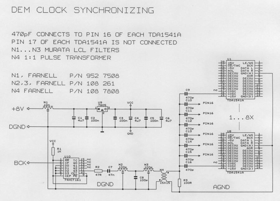

-ecdesigns- said:Hi Terry Demol,
Thanks for your compliments [post#329],

The octal D-I DAC design is constantly veryfied by measurements (shown on this thread), many listening sessions, and by comparing it with my NOS reference DAC. Circuits have been modified / optimized many times to get optimal verifyable results.
> I use a differential SPDIF input signal, and have modified my CD player by adding a differential RS422 output stage [post#268]. So jitter is very low, as the CS8412 PLL runs very stable due to the stable SPDIF input signal. Guido's XO DAC PLL seems to be used often to upgrade a standard oversampling CD player containing a digital filter. I can imagine that a jittery clock can affect digital filter operation, and adding a XO DAC PLL can significantly improve sound quality.

Have you compared I2S to SPDIF IP, and found little difference?
> Yes DEM clock synchronizing with BCK has made a big improvement, especially in improved clarity and detail.
I havent tried this yet and it's on the 'to do' list. However everyone
so far has been very positive about this mod.

DEM synchronizing schematics (new)

> So I specially made a schematic diagram of the DEM clock synchronizing circuit used in the octal D-I DAC analog mainboard, this should answer your questions about this circuit. Only pin 16 is connected to the DEM clock trough a 470pF capacitor, pin 17 is not connected. You only need one circuit for all DAC's. If both the LCL filters and pulse transformer should be difficult to obtain, R2 can be directly connected to R3 (bypassing the filter), but this slightly increases noise levels.
> Have you also considered differential RS422 interfaces for the I2S signals? separate fibre optics can cause phase problems (toslink).
John

Hi John,
Thanks for the schematic, that's completely cleared the confusion.
I can now go off and understand it properly, now that I have a frame of reference.
I did consider doing a differential driver for I2S, perhaps using a 9pin D connector and a bundle of shielded twisted pairs, but I thought it might be quicker and easier to just get 3 optical drivers (at the moment, I just want to get playing with DACs relatively quickly).
I didn't think there'd be a phase issue, but I guess it is plausible with low end optical fibre.
Thanks again for the diagram.
Phil
Phil

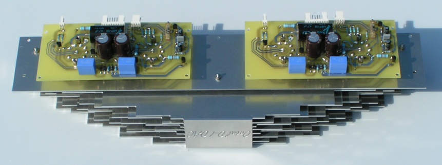

Project update
Hi tubee,
Thanks for your reply [post#358]
Glad to hear the DEM clock synchronizing caused improvements. If you don't use the last schematic diagram, some noise may be added to the signal. If you are looking for a affordable replacement for the NE5532, why not try a OPA2132 (dual), I tested those earlier and they are not bad. Specs: FET input unity gain stable, typical distortion 0.00008%, noise 8nV, bandwith 8MHz, slewrate 20V/uS. Single version is the OPA132
I have a project update as well,
The printed circuit boards for the tube output stage are ready and tested, I seem to make a lot of mistakes lately, looks like a definately need a rest. I managed to reverse polarity 2 zener diodes and 2 capacitors. Same error is in the last schematic diagram of the tube output stage I posted, D4, D5, C5 and C7 are polarity reversed. This resulted in a lot of extra work taking everything apart again and correcting this error. Due to the 2K2 current limiting resistor nothing went up in smoke. I added a photograph of both tube output stage modules mounted on the grille.
Hi tubee,
