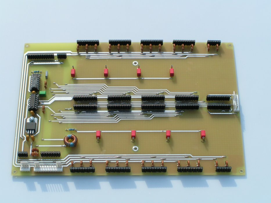

Finally ready, the analog mainboard
Hi,all
Look what I found,
Mainbordus analogus maximus, a rare species of the octal D-I DAC family
Sorry about that 🙂,
but I'm in a good mood since the octal D-I DAC core is ready and is finally working now. The added photograph shows the Analog mainboard with all modules added. I will post some more photographs of the analog mainboard without modules, and the solder side.
Did it work the first time? no actually it didn't 🙁. After checking all power supply voltages and I2S signals, I placed the remaining modules on the analog mainboard and switched-on. Nothing, checked voltages again, they were ok, checked the I2S signals, all there. Then I removed the differential OP-amp modules and connected a resistor on the DAC outputs, still nothing. Then I had another quick look at what was left of the prototype board, it couldn't be, or could it? yes I swapped DATA and BCK signals on the analog mainboard
. After some thoughts about how to fix this in an elegant way 😕 , I decided to swap the signals on both Quad-DAC modules. Put everything together, and switched-on, it finally worked like a charm.
I will run some more tests to see if things can be optimized. PCB's will need some minor modifications, then this major part of the octal D-I DAC project is finally ready

Analog mainboard without modules
Hi, MGH
Thanks for your replies [post#280,#284]
> Circuit boards: I am planning to use glass epoxy boards with thick gold-plated copper tracks and a blue laquer anti-solder mask.
> The octal D-I DAC is a fully balanced design, starting with the differential SPDIF input to prevent jitter. Then a differential DAC arrangement (4 non-inverted DAC outputs and 4 inverted DAC outputs) to cancel out some more interference AND cancel-out DC offset, so a grounded grid and DC coupled signal (OP-amp) can be used. The differential OP-amp and Tube amplifiers are necessary to combine the inverted and non-inverted signals into a non inverted signal with twice the amplitude.
The tube stage in addittion has a differential output setup (2 cathode followers) for a fully equal balanced "load" on the differential amplifier, this significantly increases stability and symmetry, reducing distortion and increases CMMR.
Don't worry about the single ended RCA connections, my set is also single ended. So I am not going to use a balanced output either.
I have added another photograph of the analog mainboard without modules placed.

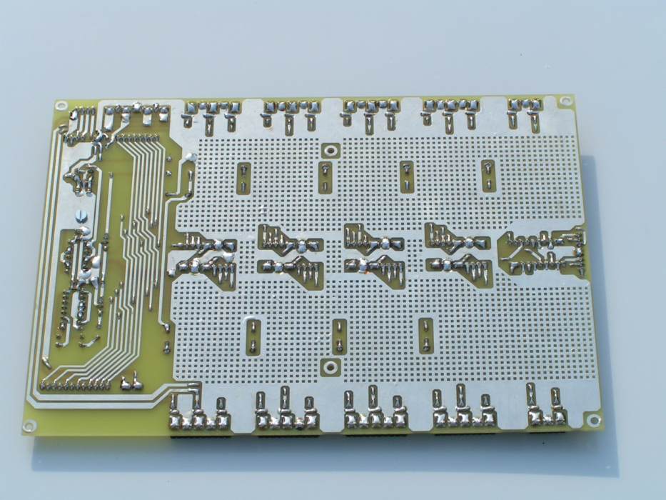

Analog mainboard solder side
Hi, tubee
Thanks for your reply [post#283]
> New DEM clock schematics will be posted soon, it's no pitty you bought the 74HCT14, if you put 2 schmitt trigger inverters between the SAA7220 and the DS8922 (so the signal is not inverted) you can increase slew rate.
> I am curious about the Kwak 7 oscillator. I had a look at the schematics, what frequency does it generate and how is it connected? I have seen some spectrum analysis of the Kwak 7 oscillator on the internet, that showed a strange continuously varying spectrum.
> I will do some testing with the DIR1703, specifications look good
I added another photograph of the analog mainboard (solder side)

> The two small diff-amp modules on the photograph contain this complete circuit. So this analog mainboard including modules is already a fully functional DAC. I/V converter outputs are also routed to the analog output connector.
If you only want to use the OP-amp output, just add a attenuator (R/R) to obtain the correct output voltage, and route it to the RCA socket. But if you want to add the differential tube output stage as well, this tube output stage can be connected to the I/V outputs. So both OP-amp and tube output stage work simultaneously. Then you can select OP-amp, tube or mixed mode (schematics of attenuator / mode selector will follow).
New timing-chain module / power metal film resistors

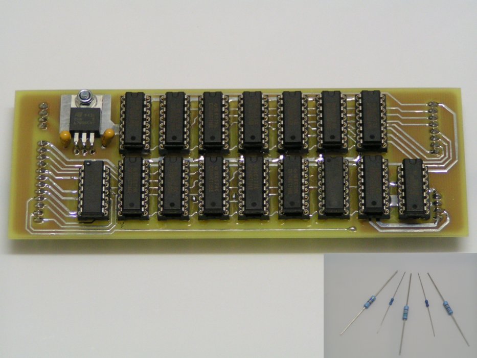

Hi, tubee
Thanks for your compliments [post#291]
> The analog mainboard dimensions are 172mm X 242mm X 30mm (6.77" X 9.35" X 1.18"), OPA627 heatsinks included.
Today I redesigned the timing-chain module (improved ground plane and added a 74HC08 local buffer for both WS and DATA). And I corrected the DAC module layout (swapped DATA and BCK lines).
I also tested a ringcore based pulse transformer from Farnell (SPDIF), and it seems to work very well. So now I can proceed with the first audio interface module (CS8412).
I also received very nice 1% power metal film resistors from Conrad electronics today, these are intended for the differential tube output stage. I plan to compare these with the carbon composite resistors (Riken-Ohm) that maxlorenz preferred. I am very interested in how these Riken-Ohm resistors influence sound and noise level.
I also added a photograph of the new timing-chain module and the power metal film resistors, the small resistors are common 0.6W metal film resistors for comparison.
Hi, tubee

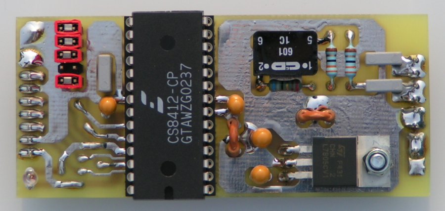

Digital Audio Interface module #1, listening tests
Hi all,
Another project update, The first digital audio interface module using the CS8412 / CS8414 (adapter socket needed) is ready. I added a photograph. The module has it's own power supply regulator and is double filtered using 10nF muRata LCL filters. Decoupling cap's are placed directly next to the IC's powersupply pin's, SMD decoupling cap's and some more SMD resistors on the solder side. It runs on approx. 8V DC.
PLL loop filter resistor (SMD) and cap are placed very close to the chip, minimizing jitter.
It has a rincore based 1:1 pulse transformer on-board (Farnell part nr. 108-8707), so it can be directly connected to both a differential or single ended socket.
Modes can be selected with 5 jumpers, an on-board indicator LED lights when the SPDIF signal is received correctly.
Outputs are: WS, BCK, DATA, ERF (Error Flag) and +5V.
The module is compact, and layout is optimized for best performance.

Hi all,

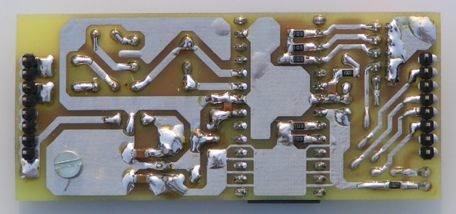

SPDIF module #1 solder side
Hi, tubee
Thanks for your reply [post#295]
Currently I am using a modified Sony CDP-CX355. It can hold 300CD's, so I can swap quickly between (test) CD's for comparison.
But I also use a mac computer with CD's stored on a high capacity external harddisk, using lossless compression. Since the USB to I2S interface is not ready yet, I use a USB to SPDIF converter for the moment.
I have added a photograph of the SPDIF interface module #1 solder side
Hi, tubee
