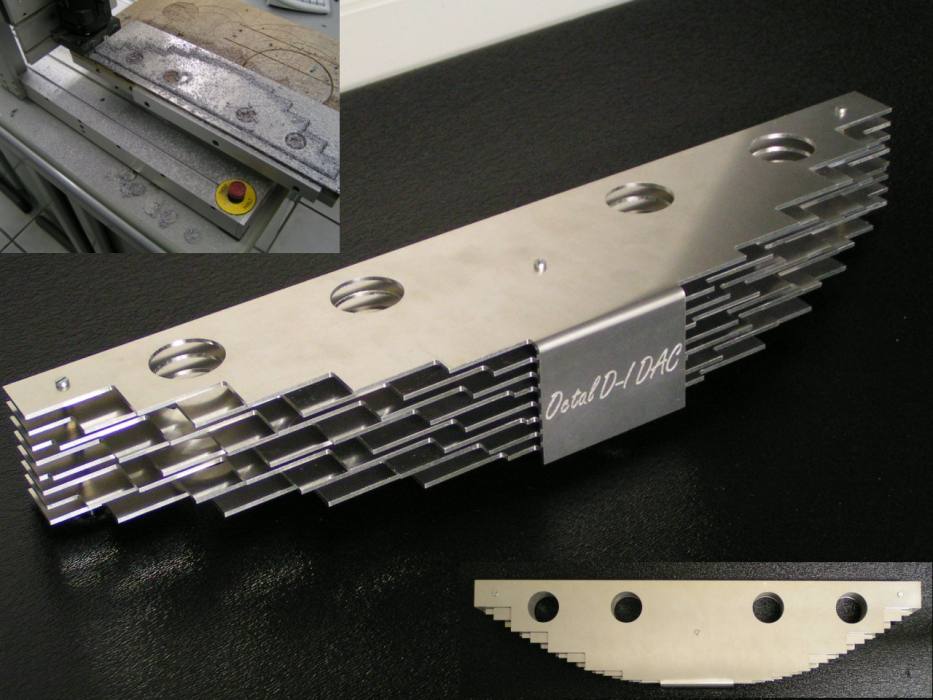

Project progress
Hi all,
Thanks for your advice about the tube output stage. Now I will show you what I have been doing the past days, beside tube output modifications. I did some serious CNC milling, as I need to complete the basic housing first, in order to continue with the design of the main boards.
Attached photograph shows some "artwork". It's the part of the octal D-I DAC housing that reflects it's operation principle also have a look at post #220. I'ts other function is to protect / screen the tubes.
Top of the photo, CNC milling of one of the 8 tube protection plates.
Photo shows a side view of the complete tube protection assembly. Each plate represents a DAC output from the octal D-I DAC, starting with DAC1 output at the top. The DAC name is engraved in the aluminum.
Bottom of the photo, top view shows the "smooth" octal D-I DAC output reflected in the positioning of the 8 individual plates.
I did some experiments with the status indication, as mentioned in post #220. I used a lighting trick to enhance the tubes glow using 3mm high brightness LED's mounted at the centre of the tube socket. It will illuminate each tube in a spectacular way, the glow will spread among the 8 plates, you really must see this. I will make a photograph of it when the tube support plate is ready. The status indication will show you wether semiconductor or tube mode is selected, it indicates when the tube stage is warming-up, is ready for use, or is shutting down.

Simply beautiful. There is many layers, both physically and symbolically, to the design of the housing. I love it, and I can't wait until you finish the housing with the tubes glowing.
Ecdesigns: is that your day time job: CNC milling ? I did that a long time ago too, worked on a Deckel CNC
