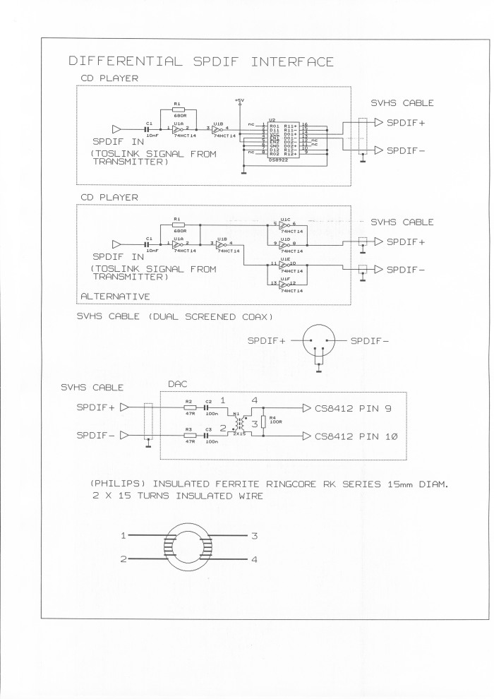

Differential SPDIF interface schematics
Hi, tubee,
> In post [246] you asked information about the differential SPDIF interface I am using.
Well, I attached a schematic diagram (concept) for a differential SPDIF interface. This differential interface cancels-out interference and prevents ground-loops. It increases slewrate and reduces jitter at the source.
I connected the SPDIF input to the SPDIF output of the CD player, you can connect it to the signal pin of the TOSLINK transmitter or to the coax output. The circuit runs on 5V.
The interface increases slewrate, and creates a normal (+) and a inverted (-) SPDIF output signal, by using a RS422 transceiver chip (DS8922N). But any other RS422 chip will do. If you can't find a suitable RS422 transceiver chip, you can experiment with the alternative diagram.
I used standard SVHS cable and connectors (dual screened coax cable). with chassis connectors from Farnell.
The coil was made using an insulated philips ferrite ringcore (15mm diameter blue color coding, RK series), but you can experiment with other types. I used thin insulated equipment wire with 2 different colors, but you can also use enamelled copper wire. Both primary and secondary windings consist of 15 turns each. Make sure there is sufficient gap between primary and secondary winding to minimize interference. The transformer prevents ground loops.
Impedance is around 100R, you can reduce this by using 33R for R1 and R2 and 68R for R3.

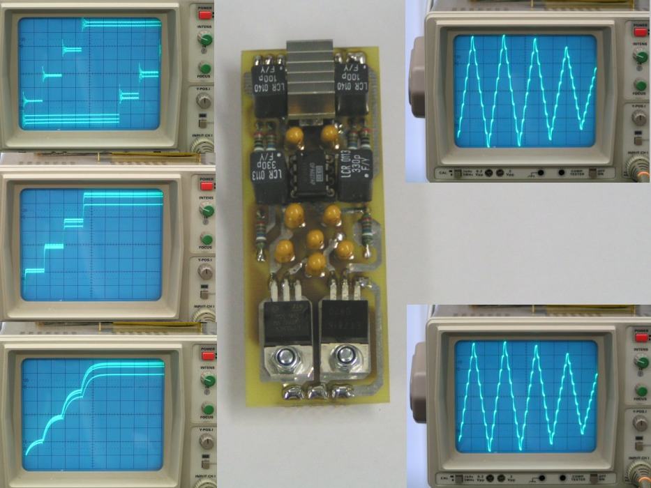

Feedback optimalization / project progress
Hi, all
I have done some interesting experiments with feedback optimalization. I started with the I/V stage, trying to get perfect squarewave steps without "ringing" or "sagging". I used a 21 KHz test signal in order to see steps on the oscilloscope, then I zoomed in on a few steps to show the tuning effect more clearly..
Upper left oscillogram, only a 590 Ohm resistor, "feedback servo" is to fast, ringing occurs. Harmonics are added to the sound, sound get's a bit noisy and harsh.
Center left oscillogram, 590 Ohm resistor with 100 pF capacitor in parallell, "feedback servo is optimal, no "ringing" or "sagging", sound is neutral, without anything added or filtered out.
Bottom left oscillogram, 590 Ohm resistor with 1nF capacitor in parallell, "feedback servo is too slow, "sagging" occurs, sound looses "speed" and detail.
Photo center, the I/V / differential amplifier module (one channel). It uses a OPA627 in DIP package, and 2 X OPA627 on a self-made adapter socket (SMD OPA627's get quite hot, so I mounted a Heatsink construction, just in case...). Tantalium and 100nF X7R SMD bypass cap's are used. Each module holds one channel, so each channel has it's own power supply.
Then I tried to get the same response from the OPA627 diff amp, as with the differential tube output stage by "feedback servo" tuning. After a lot of measuring and testing, I use 4 resistors of 1.96K, and 2 capacitors of 330pF (diagram is same as schematiciv1.jpg post#50). Now both output signals (cathode of the CF) and OPA627 output looked virtually identical,
Upper right oscillogram, differential OPA627 output stage signal
Bottom right oscillogram, differential tube output stage signal
As both oscillograms already indicate, the tuned OPA627 diff amp sound now comes very close to the differential triode diff amp sound, really impressive how sound quality can improve by simply changing some resistor and capacitor values.
I started routing the analog main board. When this PCB is ready and functions properly, the "core" of the octal D-I DAC is ready.

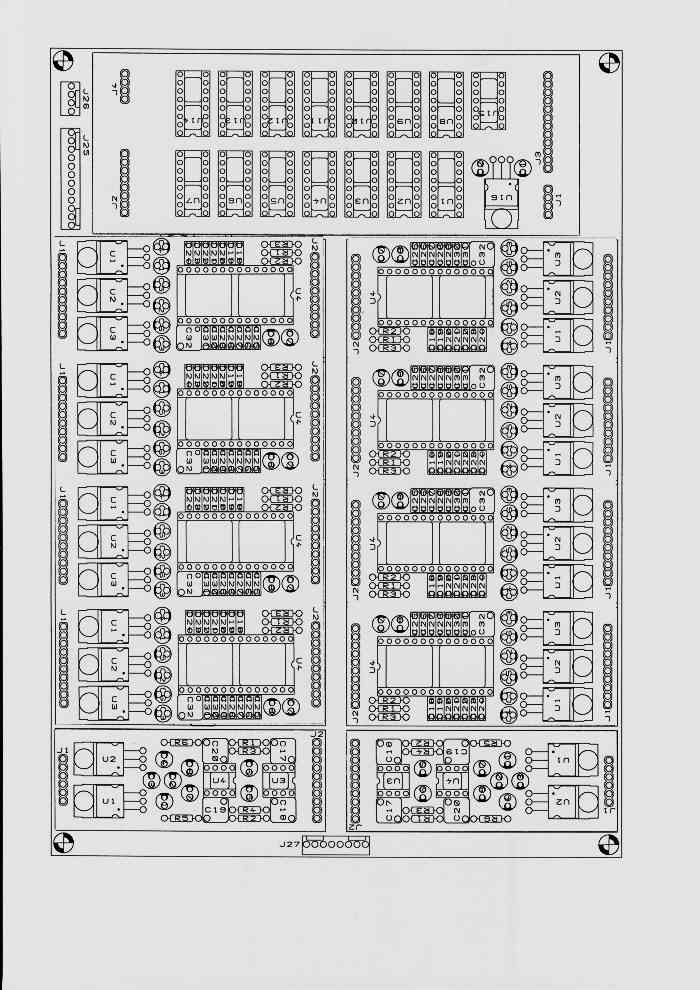

Mixed mode "magic" / analog mainboard
Hi, all
Yesterday, I redesigned the DEM clock synchronizing circuit [post#90]. This circuit makes sure that all D/A conversions start simultaneously and are synchronized with BCK. The aim of DEM clock synchronizing is to make sure all 8 TDA1541A's put their sample on their output simultaneously. When using 8 free running DEM clocks that are also not in sync with BCK, there will be varying delays. Again these delays are rather small, but in High-end equipment they can make quite a difference.
Basically I reduced the amplitude of the 176.4 KHz clock (BCK/16), and filtered it using 2 Murata filters. The TDA1541A datasheet indicates DEM (Dynamic Element Matching) clock of minimal 150 KHz, typical 200 KHz and maximal 250 KHz. So 176.4 KHz is within range. The lowered amplitude was then routed to a tiny ringcore transformer (similar as the one in post #268]. This transformer is used to isolate the digital GND noise from analog GND. The secondary winding is loaded with a 100 Ohm resistor and connected to analog ground. Then all 8 DAC pin's 16 were connected to the transformers output using 470pF capacitors.
After all modifications made to the prototype it was time for some more listening sessions on the main set (in the workshop I have smaller sonic resonators and a different control amplifier)
Modifications are: I/V optimizing, OPA627 diff amp optimizing and adding the DEM clock synchronizing circuit.
After switching-on, the sound of the OP-amp stage seemed a lot clearer, more open and more natural. Then I switched to the tube output stage, expecting not much difference, wrong! the tube stage still had it's characteristic sound, but was also significantly improved. The DEM clock synchronizing and tuning sure made a difference. Then I switched to mixed mode because I was curious about the sound, since the OP-amp stage was tuned to closely match the tube output stage waveform. This was something else, almost magic, it seemed both OP-amp stage and tube output stage completely "merged" producing a sound quality I never heared before during testing. The sound was crystal clear / pure, and increadibly "harmonic", instruments and voices sounded ever so realistic.
I also added the module lay-out of the analog mainboard. The analog mainboard is routed and I can start optimizing the tracks and adding ground planes. I will post some more information about the analog mainboard soon.

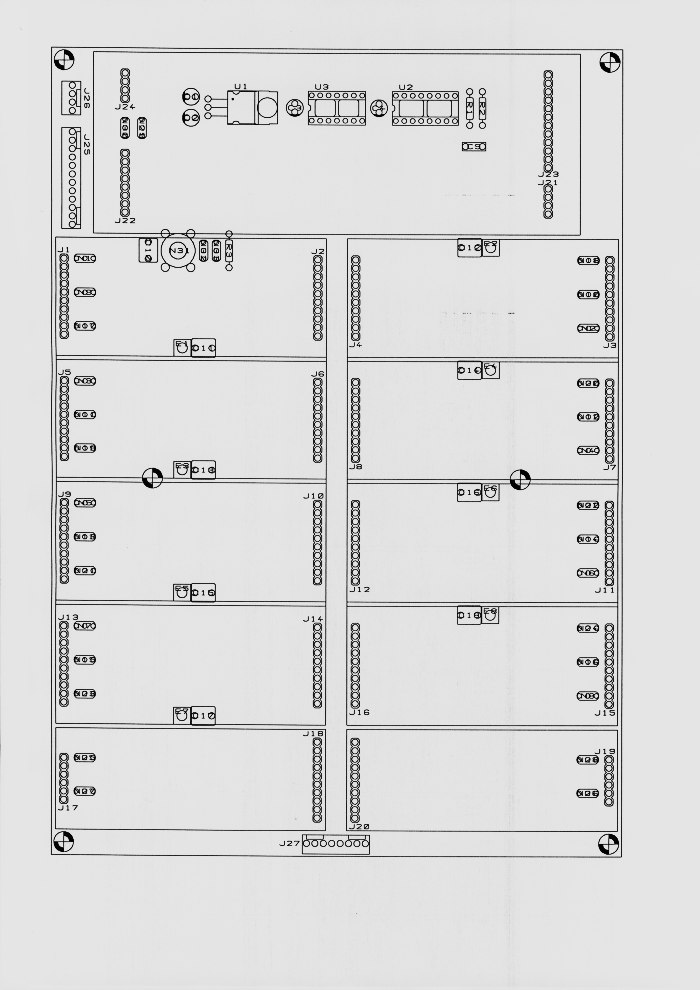

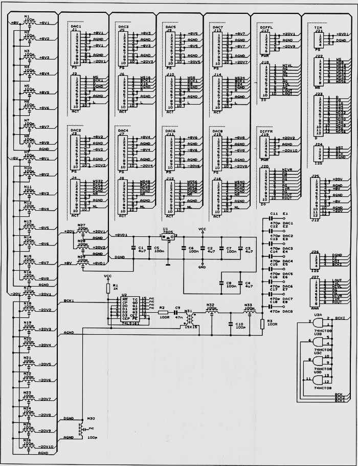

Analog mainboard schematics
Hi, MGH
Thanks for your reply [post#274]
I use high-quality turned pin IC sockets (Harwin, Augat or Aries). The low cost IC sockets with wipe contacts often make bad connection and can degrade the signal. I primarily use IC sockets to simplify updates, repairs and test the assembled board without the IC's (voltages) as each board has it's own power supply regulators, so a fault can be detected before destroying a IC. The module sockets are similar high-quality turned pin versions, power supply connections and output signals use 2 pin's in parallell, just in case...
I have added the schematic diagram of the analog mainboard. I use Murata LCL filters on every power supply input of every module (28 X). The diagram indicates 100pF for these, but I am planning tu use much higher values for the power supply lines. Digital and analog ground noise is separated by using the 2 ferrite beads of one of these filters (N29). The BCK signal is buffered using a 74HCT08, since it gave the cleanest signal, 74HCT244 buffer caused to much interference and "ringing" on BCK. The DEM clock circuitry uses a synchronous devider 74HCT161 and a small transformer to isolate the DEM clock signal. Filters N32, N33 and C10 filter the DEM clock signal. R2 and R3 attenuate the signal. The analog mainboard has it's own digital power supply for the BCK buffer and the DEM clock circuit. I used labels to indicate the interconnections (labels with the same name are interconnected).
J25 is the power supply connection, J26 the I2S input and J27 is the analog output (audio + I/V outputs)
Routing was quite a challenge, since I had to use manual routing. Today I plan to optimize the tracks and add ground planes. Can't wait to assemble

Hi ecdesigns,
You said you use a SVHS cable for the (differential) digital signal. SVHS cable is twin coax, not suitable for differential signals (rather 2 single ended signals). You should change this to a proper (shielded) twisted pair cable instead.
Chris.
Chris.
SVHS cable
Hi, real
Thanks for your reply,
> Yes, of course you're right. A shielded twisted pair (networking) cable would be better, especially when using long cables. In fact, the red "SVHS" cable on the prototype pictures is self made and uses high quality "van damme" balanced studio cable and Professional gold plated Nakamichi SVHS connectors (order code 804-1326) from Farnell.
However, tests with standard SVHS cables showed these work fine as well, provided high quality cable is used. The cable length of approx. 2m is also less critical.

*Will you pcb-design be as shown? Then its easy to pick the wanted sub-pcb's, someone can cut his sub pcb's off, or it could kept as one big pcb for who wants to build the D-I dac complete.
*What input receiver CS8412, or is CS8414 possible too?
