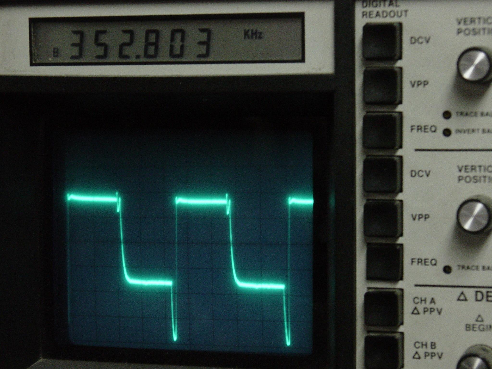

I changed the latest to this,
Removed D2, R4, R5. U1 pin3 to U3 pin1,2.
Removed R1, D1. U3 power supply pins (7 and 14) to 5V.
TDA1541s
pin 16
pin 17
U3 pin6 non-inverting clock > 10K Ohm > pin 16 > 2K2 resistor > -15V
U3 pin3,4,5,inverting clock > 10K Ohm > pin 17 > 2K2 resistor > -15V
Attached a picture of waveform, freq and voltage at pin16.
I got great sound from this, please tell me if this circuit is ok?

Hi fastvideo,
The signals measured on both pin 16 and 17 don't guarantee that the on-chip DEM clock circuits "follow" the external clock signal.
Easiest way to check is disconnecting one of the decoupling caps (100nF) and measure the signal on this now non-decoupled active divider output (set the scope to 10mV AC). You can use pin 12 for example.
The signal should look like a kind of staircase signal with up to 4 different levels. The steps are a result of tolerances in the passive divider that feeds 4 almost equal currents in the DEM averaging logic.

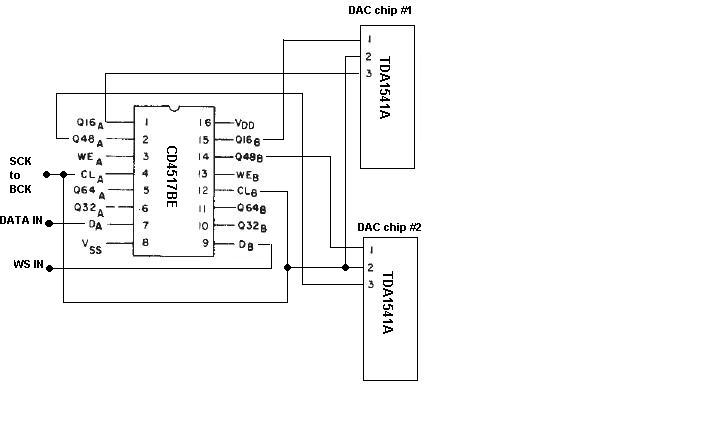

Hi gaetan8888,
For 2x and 4x interpolation only a single CD4517 is required. Not all brands are fast enough @5V power supply, TI works fine.
The propagation delay of the CD4000 series doesn't require to invert BCK when running @ 44.1 KHz.
Bit clock will remain low for 177ns, CD4517 propagation delay (TI) equals approx. 200ns typical, so this is similar to inverting BCK.
This timing is important as it determines the exact moment the DATA or WS signal is stable. The TDA154x latches both WS and DATA on the positive going edge of BCK, the 4517 does the same, and without propagation delay or bit clock inversion, both DATA and WS could change on the exact moment BCK goes high. This would cause data corruption.
But because of the propagation delay, both data and ws signals appear on the shiftregister outputs approx. 200ns later. This means that both DATA and WS from the shift-registers are stable when the bit clock goes high, so the TDA154x chip will clock-in valid data.
The CD4571 has 2 separate 64-bit shift registers with taps on every 16th output (16, 32, 48, and 64).
In order to latch all connected DAC chips on the positive going edge of BCK, a pre-delay of 16 pulses can be used.
2x interpolation (2x TDA1543 / TDA1541A)
Register #1, data input to DATA, DAC chip #1 data input to output16, DAC chip #2 data input to output48
Register #2, data input to WS, DAC chip #1 WS input to output16, DAC chip #2 WS input to output48.
4x interpolation (2x TDA1543 / TDA1541A)
Register #1, data input to DATA, DAC chip #1 data input to output16, DAC chip #2 data input to output48, DAC chip #3 data input to output 32, DAC chip #4 data input to output64.
Register #2, data input to WS, DAC chip #1 WS input to output16, DAC chip #2 WS input to output48, DAC chip #3 WS input to output 32, DAC chip #4 WS input to output64.
Note that the bit clock / WS frequency are limited due to CD4517 specifications. TI specifies minimum 3MHz, and typical 6MHz @5V, so 44.1/16 operation is guaranteed (2.8224 MHz).

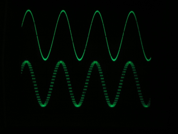

Hi gaetan8888
For the 2x interpolation circuit, how can I check, with an oscilloscope, if the sampling frequency and propagation delay of my circuit are ok, to check if I've made any error and that my circuit work correctly ?
First you need a suitable 1 KHz 0dB sine wave test signal (test CD).
Next check if step interval matches theoretical frequency, for example with 44.1 KHz source, 2 x interpolation should result in 88.2 KHz (11.338us), and 176.4 KHz (5.669us).
When interpolation functions correctly you should notice an increase in resolution, and a proportional increase in volume level with each added DAC chip. I attached an oscillogram that shows correct operation of the interpolator (upper trace) and 44.1/16 NOS (lower trace).

Hi gaetan8888
Hello John
Where did you pick-up, in the circuit, the interpolator signal ?
Why the 44.1/16 NOS (lower trace) signal look harsh on your scope image ?
I include an image of the schematic of the circuit that I've used.
Thank you
