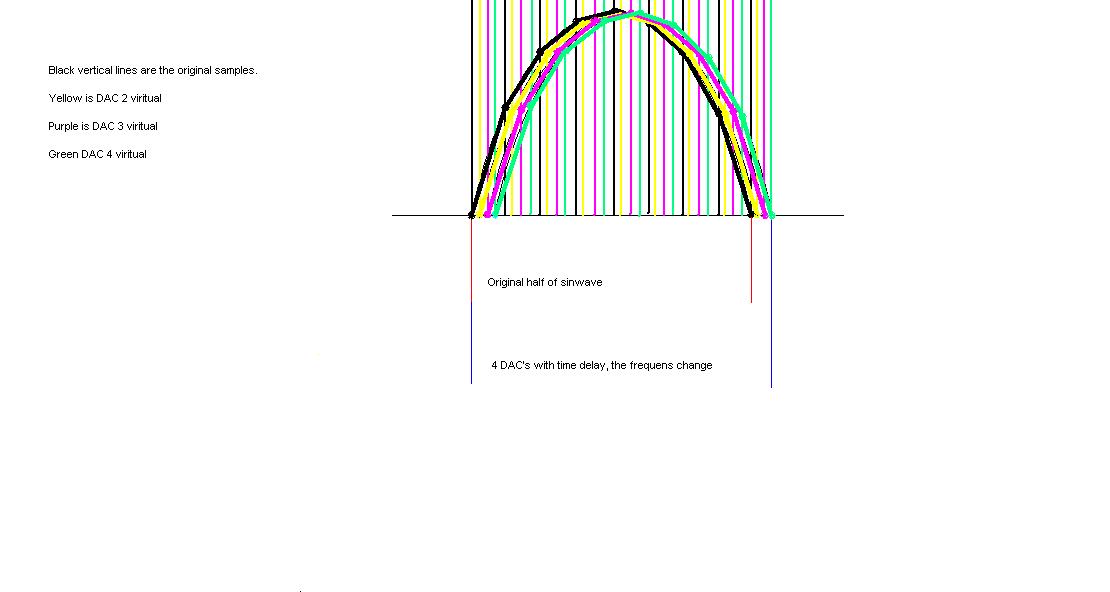

If i get this right, this makes every sinewave longer !? Infact this reduce the frequens, and make the sound "false" from the original signal. Of course no existing person in the world can hear this.
I hope that wasn't a comment about my statement? I did not talk about changed frequency. Just the amplitude of the output signal gone trough a resistor. Your interpolation discussing doesn't apply to what I told you above.
It's the available voltage who sets the maximum roof where the DAC clips the signal. If you raise output so you push more current then you have to half the resistor for every doubling of DAC. You must not go in to that voltage roof which corresponds to max 80 - 90mV RMS.
But that You may allready know I hope 🙄
I'm only refering to practical tests which shows that this DAC distorts the audio signal if you have to large resistor.

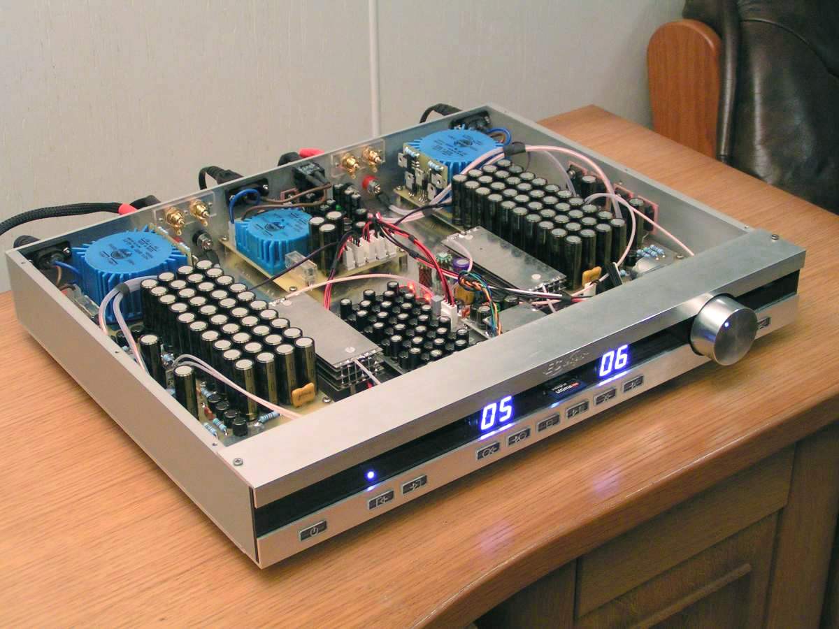

I attached a photograph of this Integrated SD Player. It's a complete super-tuned audio set in one compact box, SD-memory card in (up to 52 lossless CDs on a single 32Gb card), speaker out.
This is the result of 2 years of intensive research and endless listening tests. It's loaded with tricks and innovations. It merges both NOS DAC and SD-player projects.
Starting at the source, this is a solid-state player, tuned for minimum noise and interference levels, outputting 32 bits / frame I2S, providing lowest possible bit clock (lowest DAC on-chip ground-bounce levels, lowest on-chip timing jitter). Display consists of two large white 7-segments displays that offer excellent readability.
The source drives the TDA1543 DAC module, this is no ordinary TDA1543 application, this is a super-tuned application with separate Vref voltages for L and R channels, using 20th order LC filters. I had to make the I/V resistors myself as I couldn't find a suitable audiophile resistor for this application. The TDA1543 has I2S attenuators (200mVpp signal level) and a unique dynamic jitter attenuator circuit for BCK.
Both source and DAC chip are driven from a 11.2896 MHz superclock with integrated synchronous reclocker. This is the only clock in this system. The superclock power supply is also filtered by a 20th order LC filter for achieving extreme performance levels. The synchronous reclocker is driven through a capacitive node, providing galvanic insulation between clock and reclocker. The recloker receives a filtered clock signal (has passed a 3-crystal filter) offering high spectral purity.
Since I wasn't able to find suitable audiophile coupling caps yet, I also had to make these myself (modules left and right from the DAC module). These are very high speed hybrid caps.
The signal is then attenuated (pot) and passed to the only active part in the signal path (bridge power amps). These amps have balanced inputs, and outputs. I tap the GND reference straight from the I/V resistor.
The bridge power amps (left and right) are fully DC-coupled, have no global feedback, and super tuned for maximum dynamic resolution.
They use two dual JFETs and 4 power MOSFETs, that's all. They have large on-board reservoir caps (60,000uF) that can provide instant peak currents. The power amps have on-board mains power supplies using unique stepped rectifiers, offering better refinement when running on mains voltage. These amps were designed to remain completely stable, far into the MHz range (ISD player uses large bandwidth signal processing in order to achieve highest possible dynamic resolution).
The main power supply (center rear) consists of a transformer, 3-stage stepped rectifiers, 2 discrete series-cascaded regulators (filtered LED reference for lowest noise levels), and 4th order LC filters on each output. All voltages track, so minor (LF) fluctuations are common for all connected loads. One single transformer also injects far less mains noise compared to multiple-transformer power supplies.
The ISD player can be operated locally (keys, volume knob) or by remote control.
Since one SD(HC) card can hold up to 52 CDs at the moment, the ISD player is basically a 52 CD changer as well. It also has random disc / track function, so you can listen to your favorite music (play lists) all day without touching the unit. SD(HC) card of 32Gb capacity offers approx. 52 hours of non-stop high-performance digital audio playback.
Since this is a solid-state player, it's dead quiet (no moving parts). It's also far less sensitive to external mechanical vibration.
How to get your favorite music on a SD-card? I offer a free application for mac, linux and windows that reads play lists, converts them into WAV (if required) and writes them to the SD-card using correct directory and file names at the push of a key. leaflets with (for reference) can be printed too.
The ISD player modules are available separately for use in other projects, or to build an ISD player step by step.
Since the concept is fully modular, different DAC modules could be used in the future. TDA1541A DAC module is already planned, but first I need to be able to outperform super-tuned TDA1543 application, not an easy task as the TDA1541A probably requires an active output circuit.
The TDA1543 DAC module has fully passive output, so active output stage distortion is completely eliminated.

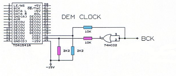

I attached latest DEM clock and I2S attenuator schematics. The I2S attenuators can also be used for the TDA1543.
The DEM clock circuit consists of two resistive attenuators that perform biasing, level-shifting and attenuation. The DEM clock frequency has been increased to 2.8224 MHz (bit clock).

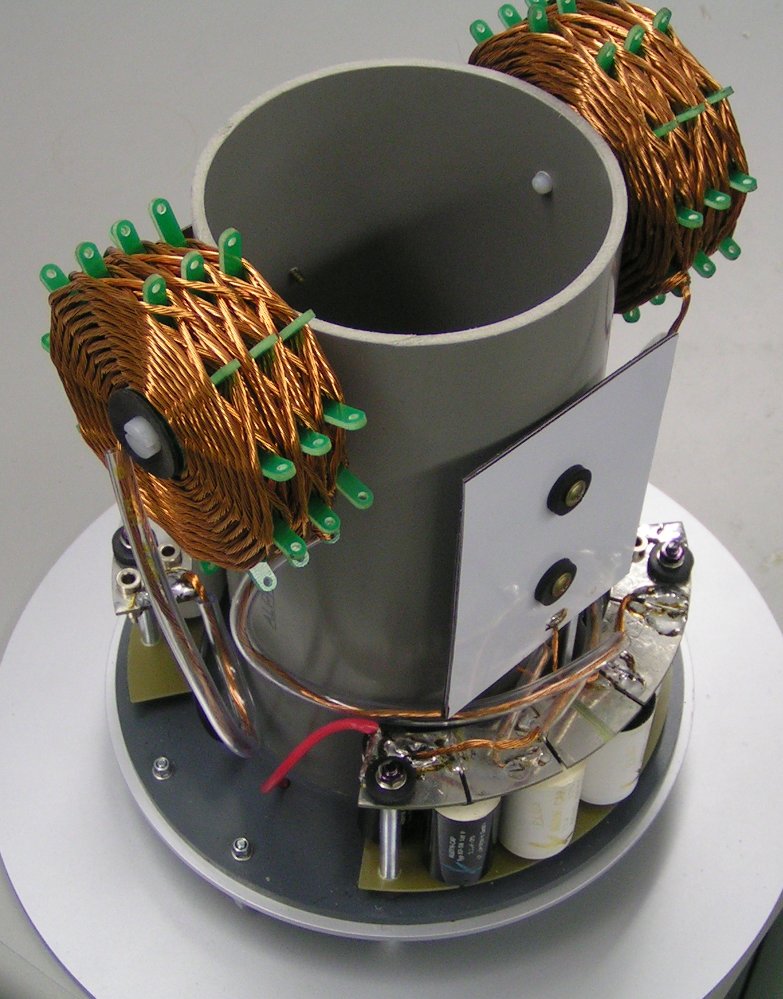

John those caps are very interesting... Do you plan to sell them? How can I build them? Any URLs?
It's basically a Monacor 3.3uF MKT capacitor with a bypass cap made from a euro sized (100 x 160mm) double-sided 0.5mm thick PCB (epoxy) material. because the PCB was rather large, I cut it into 4 pieces and milled / drilled them to form a compact capacitor.
The Monacor cap is inside the packet, mounted on a single-sided PCB with a slot for the capacitor. The PCB material was arranged so I have "outer foil" on top and bottom for screening. The parts aren't very expensive (approx $8 for one cap), but I spent over an hour milling, tinning and assembling these hybrid caps.
It's also very important to check for short circuits and use fine sandpaper to smoothen the PCB edges, removing possible short circuits. If the package has been assembled and you measure a short circuit you have a big problem.
Why on earth use a double-sided PCB as bypass cap?
The copper foils are fused to the epoxy base material (no air pockets). The PCB (enforced with glass fiber) is way more stable than any foil. In other words, this cap has less mechanical resonance compared to a very thin flexible foil.
Bypass caps only work effectively if they have very low self resonance, otherwise you simply add resonances from both, main and bypass cap, making matters worse. This is the main reason why bypass caps usually aren't very effective.
The bypass cap value does not have to be that big, the PCB bypass cap value equals approx. 1.5nF, this is sufficient for a 3.3uF main cap.
The idea is to dampen the main cap resonances, creating better specs than when using only a single (flawed) cap. This $8 coupling cap was directly compared with a V-cap TFTF (switch), and all people who listened to both caps preferred the $8 cap without knowing what cap was selected. The V-cap TFTF is regarded as one of the better audiophile caps and a single 3uF version cost around $699. The V-cap TFTF performance didn't improve significantly when bypassed with a PCB.
