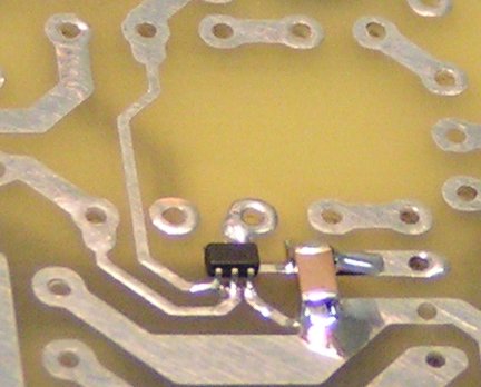

From a mechanical point of view I think it is highly possible to do it!
use a piece of printed circuit board and create some isolated pads using a fine saw. Then solder the SOT-23 part on these pads, this way its much easier to experiment with these devices. The flip-flop in the SD-player is even smaller size (I added a photograph), the capacitor next to it is 1206 size).
If I understood correctly your explanation, I must use the inverting Q flip flop for BCK and the non inverting for DATA and WS, right?[/quote]
yes you could do that, BCK then connects to the D inputs of both flip flops. the master clock connects to both flip-flop clock inputs. The flip-flop outputs would then provide both inverted and non-inverted BCK signals while maintaining low jitter. But make sure to connect the D flip-flops to very clean power supplies, you could use the posted SD-player schematics as reference for this.

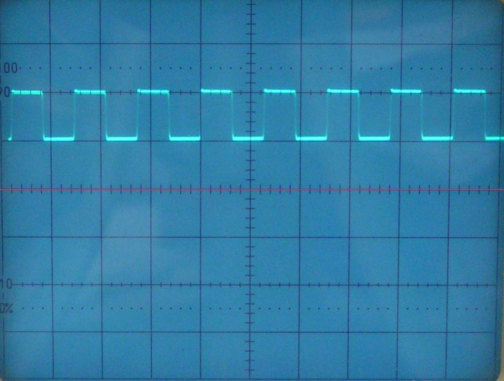

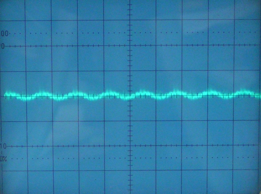

I attached some oscillograms, first one shows the remaining ripple voltage across the capacitor after tuning. Setting: 10mV / div (using 1:10 probe), time div, 0.5uS / div (ripple voltage frequency equals 1.4112 MHz).
I also attached an oscillogram of the clock output signal of the DJA, 1V/div, red line marks 0V DC.

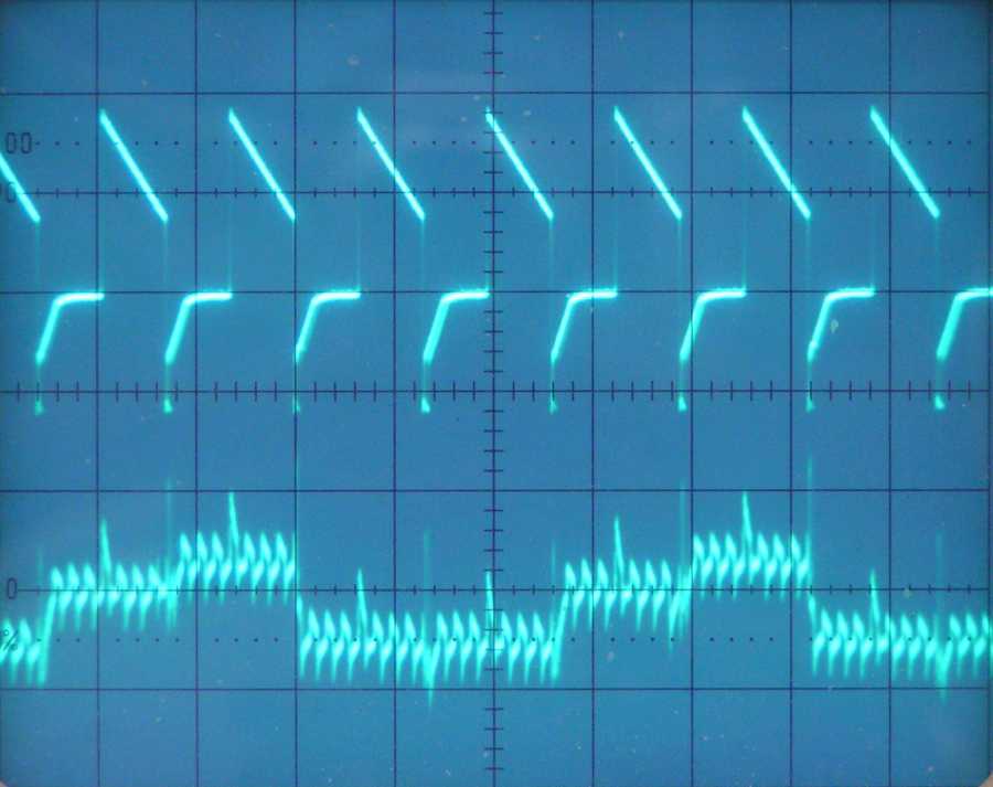

Hi fastvideo,
Is this normal that the clock doubles up at pin 16 and 17 from your test cicuit?
This is probably caused by the waveform at these pins (frequency counter doesn't trigger correctly).
The exact on-chip DEM clock frequency, and correct operation of the on-chip DEM circuits can be measured at one of the decoupling pins (active divider output) with the 100nF decoupling cap removed.
The frequency can be determined by observing the intervals between the small amplitude changes. I attached an oscillogram showing both the external DEM clock signal and the resulting signal on one of the decoupling pins with the 100nF decoupling cap removed (lower trace). The active divider averaging circuit switches at the negative going edge of the external DEM clock. The step-shaped signal at the decoupling pin (active divider output) is caused by tolerances in the preceding passive divider that's based on emitter scaling.
The bit clock interference (2.8224 MHz in this case) is also clearly visible. That's why it's so important to sync the DEM clock with the bit clock. If the DEM clock is not synced with the bit clock (data sheet application) both bit clock and free running DEM oscillator frequency will inter modulate on the chip.
It's also important to make sure the active divider changes state on the negative going edge of the BCK signal since the TDA1541A output latch latches on the first positive going edge of BCK after WS has gone low.
Since both DEM clock and bit clock are directly coupled to the averaging circuits that are part of the active dividers, these will pollute DAC output current, degrading sound quality.
The unfiltered signal on the active divider output shows a lot of higher harmonics (2.8224 Mhz and up). This means that performance will greatly depend on decoupling capacitor properties. The decoupling cap needs to be connected with shortest possible wiring (few millimeters max) in order to minimize inductance. The capacitors must be as small as possible, have low leakage current and low stray inductance.
This also means that increased bit clock frequency (oversampling) also increases the fundamental interference frequency, this in turn will cause more severe on-chip crosstalk / ground-bounce and puts even higher demands on the external decoupling caps and wiring.
In general, it's advised to keep the highest on-chip clock frequencies as low as possible, this will reduce the effects of on-chip ground-bounce and crosstalk, and external decoupling is more effective as the fundamental frequency (and higher harmonics) will be reduced. The lowest possible clock frequency for the TDA1541A (while processing 44.1/16) equals 705.6 KHz in simultaneous mode.
When using huge audiophile (polypropylene) decoupling caps with long wires, effective filtering is very poor, and the audio signal will contain unwanted higher harmonics, preventing high performance playback. The resulting sound will now be "colored" by the remaining harmonics spectrum after filtering. I suggest to use multiple SMD film caps in parallel to create a single 100nF cap, this way stray inductance can be kept very low. The decoupling caps are best mounted under the TDA1541A chip in order to achieve shortest possible connections. for optimal performance, the SMD decoupling caps can be located very close to each decoupling pin, this reduces the risk of picking-up external EM interference. It's also best to screen the decoupling pins.
The routing of the decoupling capacitor wiring is also highly critical. If a decoupling cap ground trace shares other (power supply) currents, inter-modulation occurs. It's best to route all decoupling cap ground connections straight to pin 5 (AGND).
The correct operation of the DEM clock can best be tested using low level signals (-30 ... -60dB), it's very difficult to check with 0dB signals. When the DEM circuit fails, music with -30 ... -60dB level will sound heavily distorted.

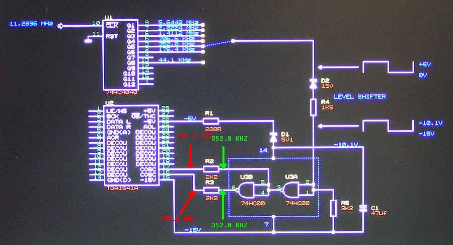

Hi EC,
Pin 16 connects to pin 3,4,5, through the 2K2 series resistor and pin 17 connects to pin 6 through the 2K2 series resistor.
This is not the same as the drawing, which is right?
If I experiment with the 5V power supply for U3, the voltage across U3 power supply pins (7 and 14) must be around 5V, the freq at tda pin 16,17 is the same as U3 pin 3 and 6, no double up. I don't understand here!!
I am using the 11.2896Mhz from pin 10 of SAA7220P/B.
I tested with Dem clock freq between 176.4khz, 352.8khz and 705.6khz measure from pin 16 or 17 using the same ciruit as your drawing, no difference in sound. Which freq should be the most ideal?
I think the dissipation of the chip is related to the clock frequency. Probably the higher is the DEM clock frequency is the better, but what is the maximum permissible frequency?
I noticed that the chip is running rather hot, so I glued a small copper heatsink on top of it, and connected it to ground. The sound is different 🙂
EC, do you have similar experiences?
Hi EC,
I change R1 from 220 ohm to 22 ohm, no freq double problem.
Then I tried changing R1 to U3 pin 14 and D1 pin 14 to pin 7, no freq double problem.
Is this explain anything?
