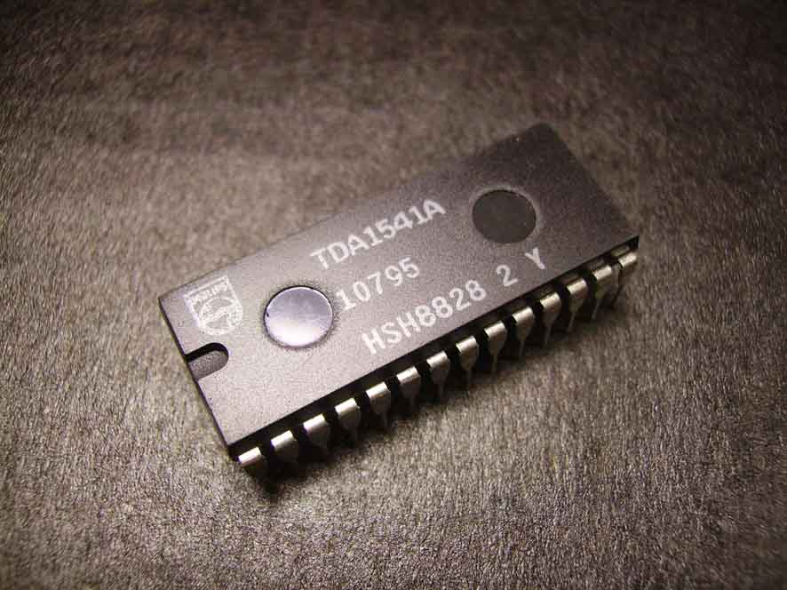

Fake TDA's
Hi all,
Be aware with fake TDA's. Do not buy on Fersay nor in ETCO. They will only supply ******* chinese copies. I bought some units, and now I have to reutrn them.
Best regards for all.

Its funny how so many chips can have that same date code the one you show..... over and over and over ...... I will have to check my parts bin at home....
And the other funny thing... How do so many 22 year old chips look like they have never be installed.....

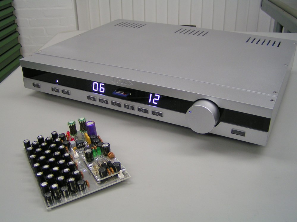

The sound quality of the single TDA1543 in the ISD player made a quantum leap compared to the early DI4MJ and DI4T designs that were driven by an iMac (AE module with Toslink output).

Everything I do is done for good reason, double and triple checked, verified by extensive listening tests. My aim is improving performance instead of degrading it. I started this project in 2006, the ISD player was completed last month. The unit sounds like almost 4 years of extensive research was put into its design.
After the first few seconds of listening to this beauty, it becomes clear what was wrong with the theoretically perfect digital audio playback equipment, it failed to provide the impression of listening to live music.
If someone told me that a Shaolin monk would be able to throw a single sewing needle through a glass plate I would say: impossible, this cannot be, theoretically the needle has too little mass and / or speed to penetrate the glass plate. The needle would probably bend. I could come up with all kinds of theories, tests and measurements why this cannot be done.
Then you see this:
YouTube - Shaolin Monk Throwing Sewing Needle Through a Piece of Glass 4
If someone told you a single TDA1543 can create the impression of listening to live sound quality, you would say: impossible, this cannot be, theoretically THD is too high, dynamic linearity errors are too high, it's a economy chip, not designed for these performance levels. You could come up with all kinds of theories and measurements why this cannot be done.
Then you hear this:
- attached picture -
Barriers are only in the mind, and it's all just a matter of technique.
