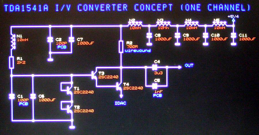

Do you really mean you can tap that amount of signal between the output and +5 V?
No, between external Darlington duplicate stage and +5V like I attempted to explain. Philips used almost exactly the same circuit inside the TDA1541A.
Do you care to share the inside schematics of TDA1541A? Where have you got that from?
Designed it this afternoon, took me 5 minutes or so.
I attached concept schematics (quick screen shot from my CAD system).
Both T1 and T2 form a 1.2V reference voltage that matches (and tracks) 2 x Vbe of Darlington made up of T3 and T4. This Darlington circuit connects to the DAC output and forms a new external reference circuit (without output compliance) to drive the passive I/V resistor R2 (700 Ohm) generating as much amplitude as the +5V power supply will allow (up to approx. 4Vpp).
This 5V power supply (passive I/V resistor only) can be boosted to whatever practical voltage required to further increase ac amplitude.
Since the power amp uses GND for reference, and the I/V resistor uses +5V as reference, +5V power supply needs to be as clean as possible (I used 8th order LC low pass). I used a PCB bypass cap for achieving very low impedance between +5V and GND. This greatly enhances performance.

I understand perhaps half the things you commented (I discovered that I have to read and re-read your old posts because "it is all there") but it is clear to me that you are achieving the DAC wizard status 😉

Use schematics (post #3142), requires 4 x 2SC2240 / channel.
6V rms equals 6 * sqrt(2) * 2 = 16.97Vpp.
I/V resistor value needs to be r = v / i, r = 17 / 0.004 = 4K25. I/V resistor power supply (not 5V TDA1541A power supply!) must then be increased to approx. 20V DC. You might use a JFET unity gain buffer (2SJ74 / 2SK170) to buffer voltage across passive 4k25 I/V resistor.
