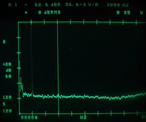

Below: TDA1543 @ -60 dB.
As can be seen, K3 is 41,5 dB below the fundamental. All odd order harmonics.
This poor performance is also expressed in the numbers found in the datasheet:
3 % - 8 % THD = -30 dB typical, -23 dB worst case @ -60 dB
Also found in the datasheet: Signal to noise ratio @ 0 dB is -96 dB which means noise is already very low.
Other than THD @ 0 dB which is very high: -70 dB to -75 dB.

For comparison, this is the multibit DAC that I use: Clean down below -60 dB

All we see here is a spectrum analysis of an unknown (TDA1543?) application. I would like to see TDA1543 production year, schematics and exact specifications of the application being tested here. This includes power supply specs, if the unit is battery or mains powered, I2S injection, I/V conversion method, and I2S timing jitter / spectrum. Is the spectrum analyzer battery or mains powered, and what bit depth / sample rate does it have?

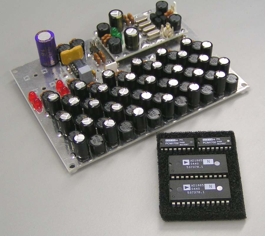

I not only experimented with TDA1543 and TDA1541A DAC chips, I also tested AD1865 and PCM1702 among many others.
I attached a photograph of my AD1865 and PCM1702 collection with TDA1543 module as proof.
I have the impression that you do not understand something that is very basic and important.
The low level distortion is determined by the chip linearity, more precisely: by the accuracy of the MSB and also a little by the next significant bit.
By nothing else
Why ?
PSU noise does not convert to THD. Jitter does not convert to THD. Any standard opamp I/V is capable of THD -90dB or better.
The -40 dB harmonics we talk about here, looking at the 1543 @ -60dB are by many magnitudes greater than the distortion contributed by the I/V and no I/V stage won't change that spectrum ever.
I explained that to you before but you seem to simply ignore it.
Wow ! You're kidding with me !
The first analyzer that I used for the 1543 and the DAC below had a resolution of 12 bit which translates to a dynamic range of 70 dB.
When you measure a 16 bit DAC @ -60dB, the best noise floor you will see after 16x averaging will be around -65 dB independent of the dynamic range of the analyzer. So if the ADC is spurious free within the dynamic range, to measure a 16 bit DAC you will not need more than 12 bit of resolution.
Such an instrument very easyly shows the differences between a very poor DAC like the 1543 and a very good DAC as you see in the pictures.
The second analyzer that I used for the 1541A, and still use today, has 16 bit resolution = 94 dB dynamic range, sampling rate of 1MHz and a max. of 64000 aquisition points.
For signal preconditioning I use a matching ( same company ) dual wideband programmable gain preamplifier with a max. total gain of +52 dB.
However, to measure the low level distortion , no more than 12 bit is needed.
