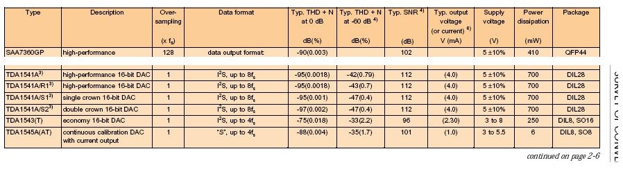

It is not THD, it is THD+N, TDA1541 -60db if properly cooked has THD(only 2nd and 3rd harmonics) less than -115...-118dbI have a file showing all TDA's thd at 0db and -60db out, here it is.
I think it is referenced to the -60dB signal as I do it too, would mean -60 + -47 for S1 or S2 = -107 dB as per datasheet.
yesI think it is referenced to the -60dB signal as I do it too
yes, but it is THD+N not THD, the noise floor of 1541 with 8x oversampling would be 6.02*16+1,76+9=107,08db-60 + -47 for S1 or S2 = -107 dB as per datasheet.
