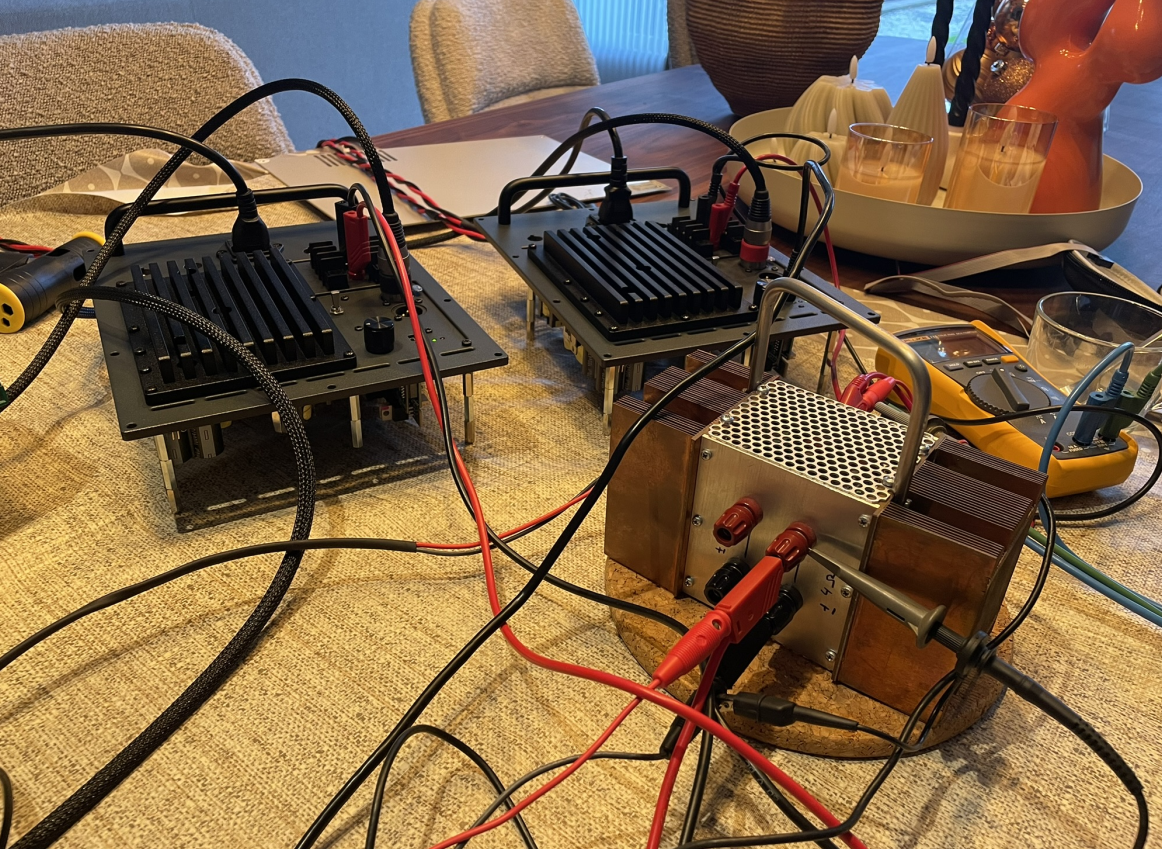

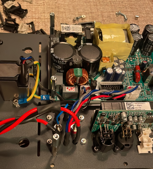

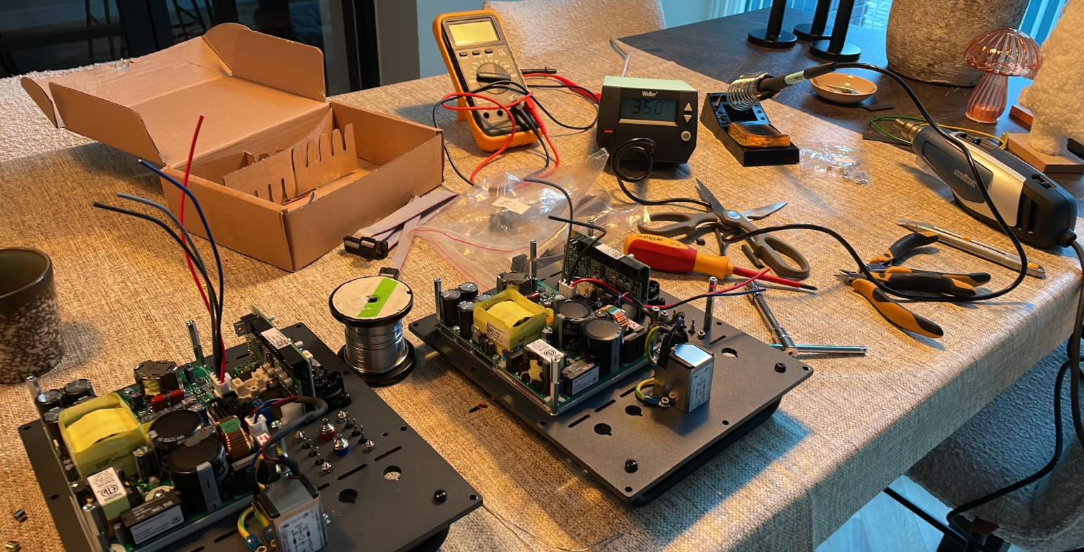

Hi Forum.
Happy new year to you all, and I hope 2025 will be an inspiring DIY speaker building year in good health.
A small update after 2 slow weeks.

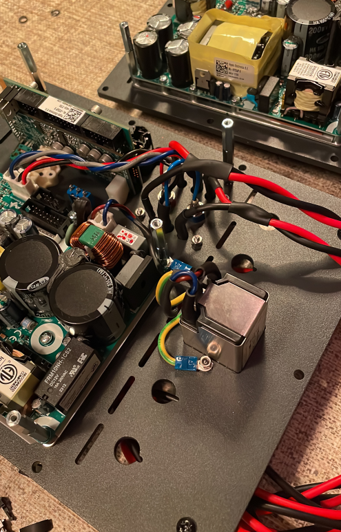

I have prepared the power amps, wired them, shortened the supplied ribbon cables as the DSP sits fairly close and tested the amps.
All works fine, 500W @ 4 Ohm. Also played with the DSP software that after some fiddling was quite straight forward and adding the LR4 Filter (24dB/oct) is easy. crossover frequency of course TBD.
The next weeks we will start to add the leather on the aluminium front and back, and adding the final 20mm layer of solid Walnut to the enclosure.
I hope to be done by the end of February and start listening and tweaking during Dutch Carnival 🙂
Cheers, Peter

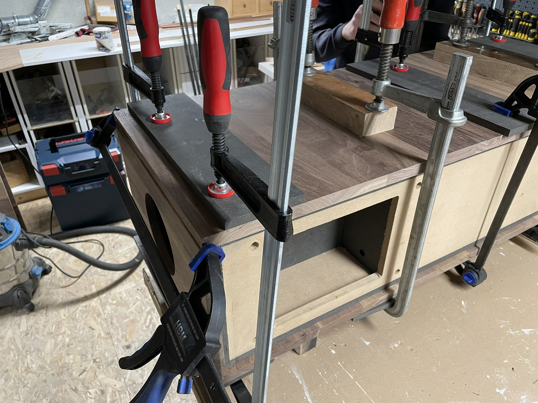

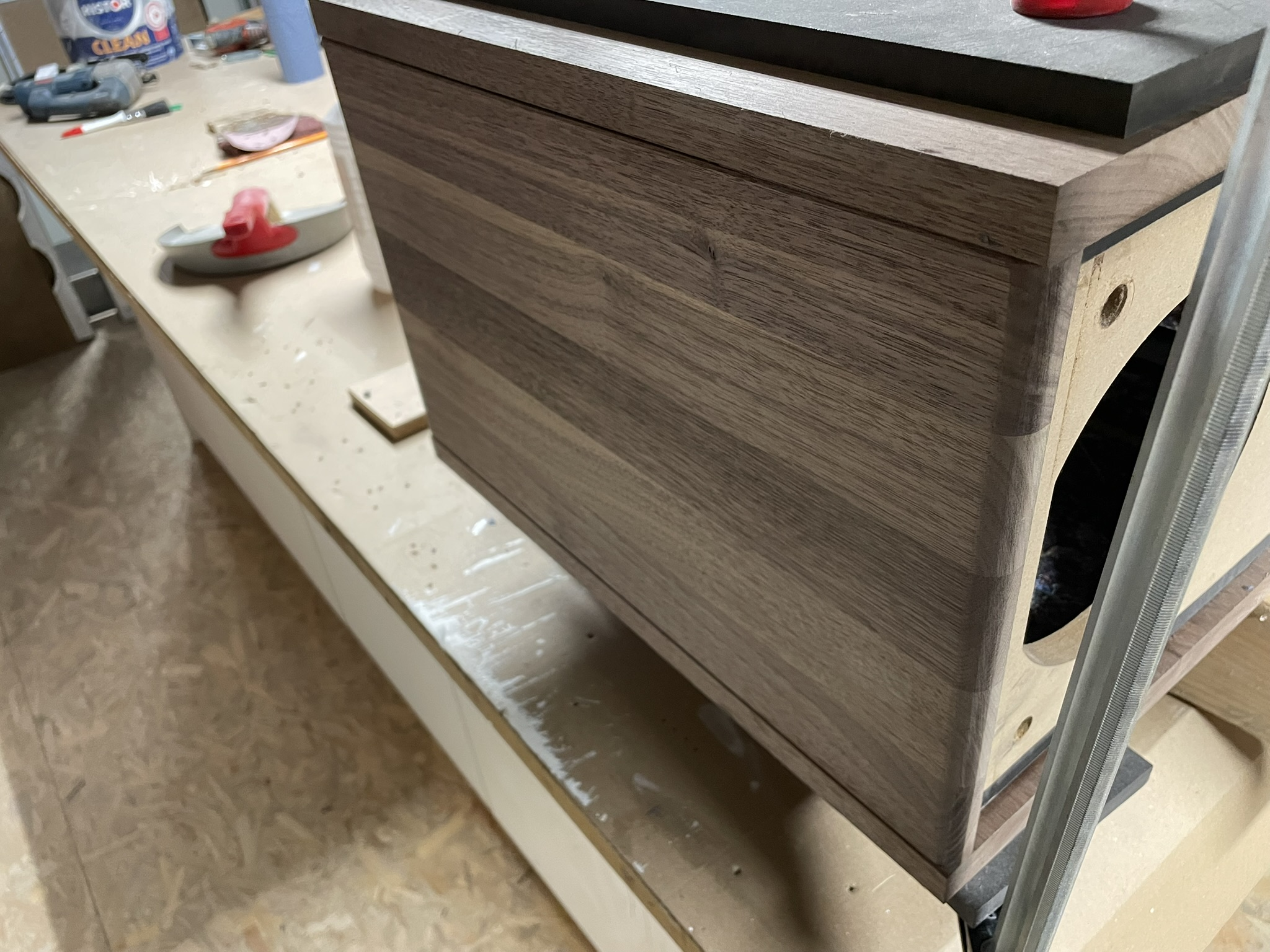

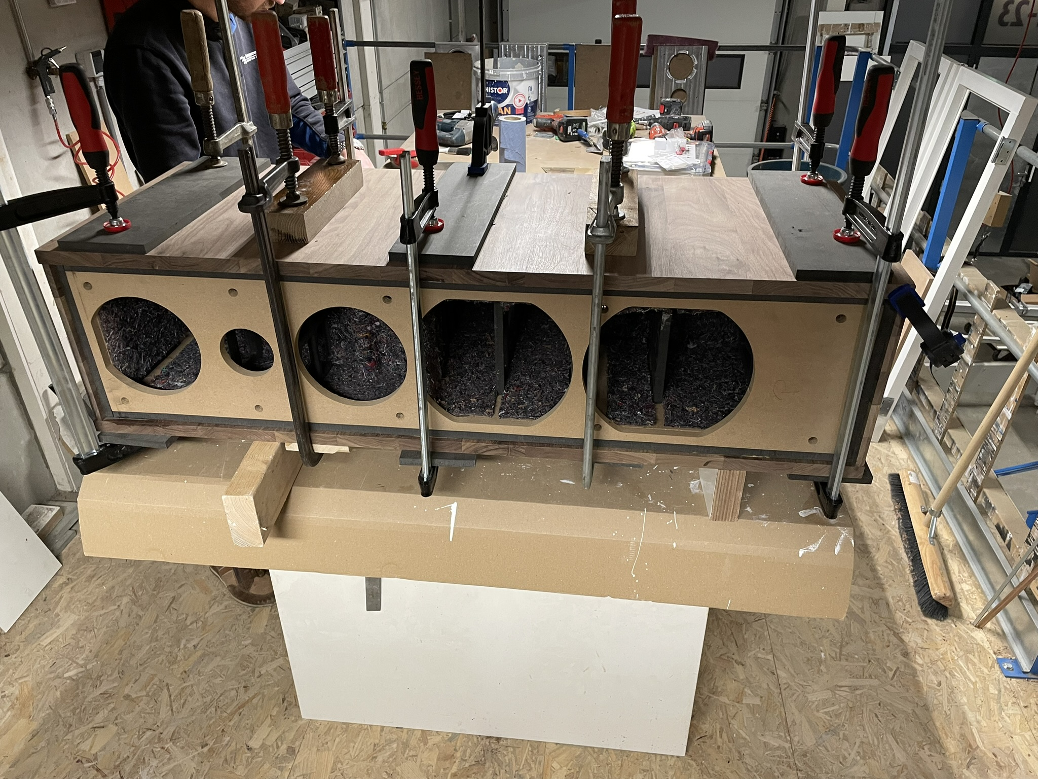

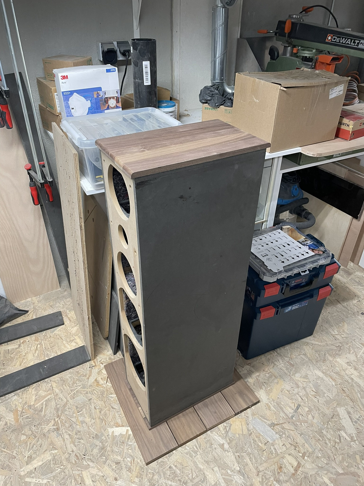

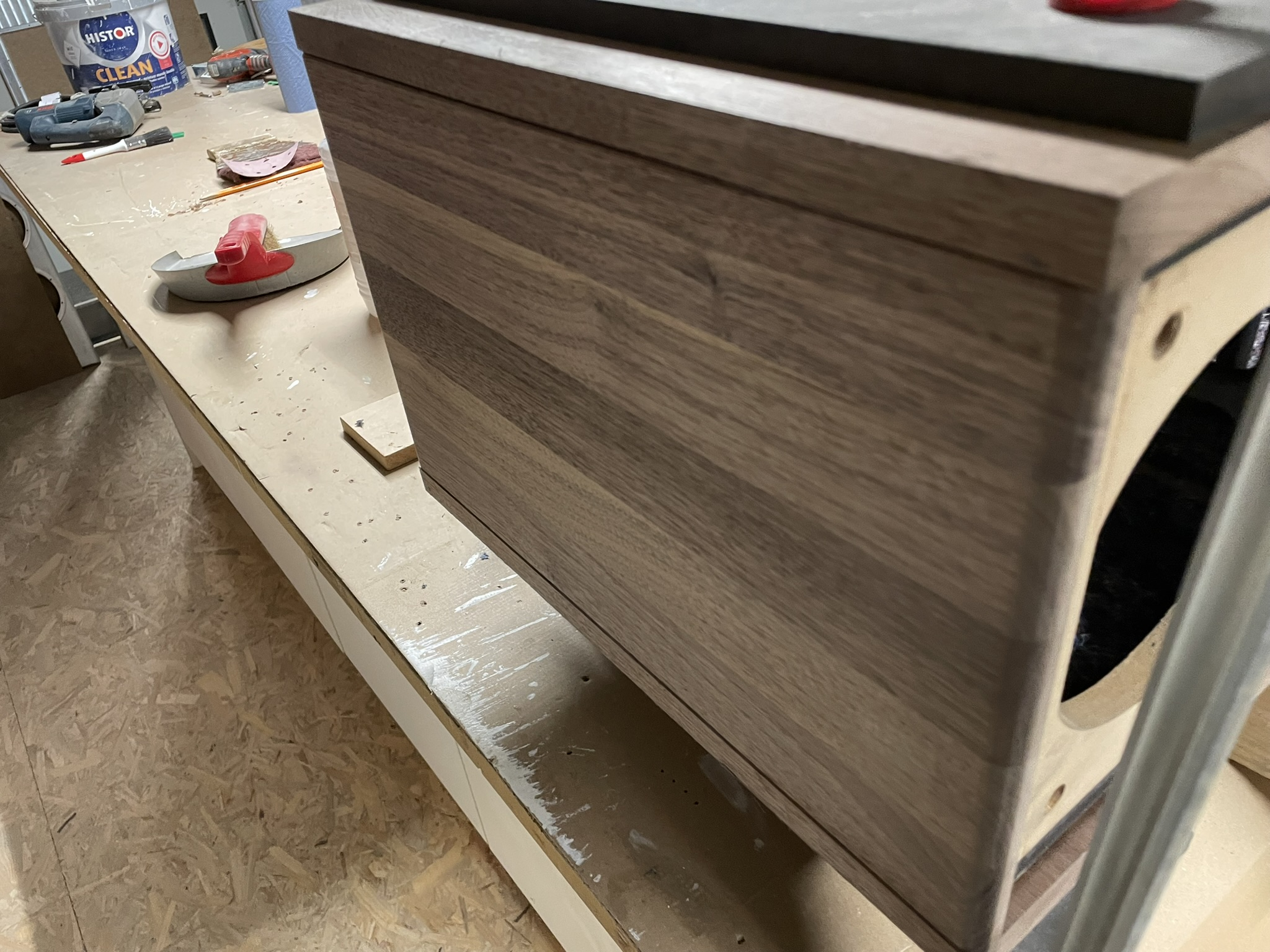

Some building pictures of adding the solid walnut layer.
Adding a small chamfer between top and sides as it wil hide small inaccuracies.

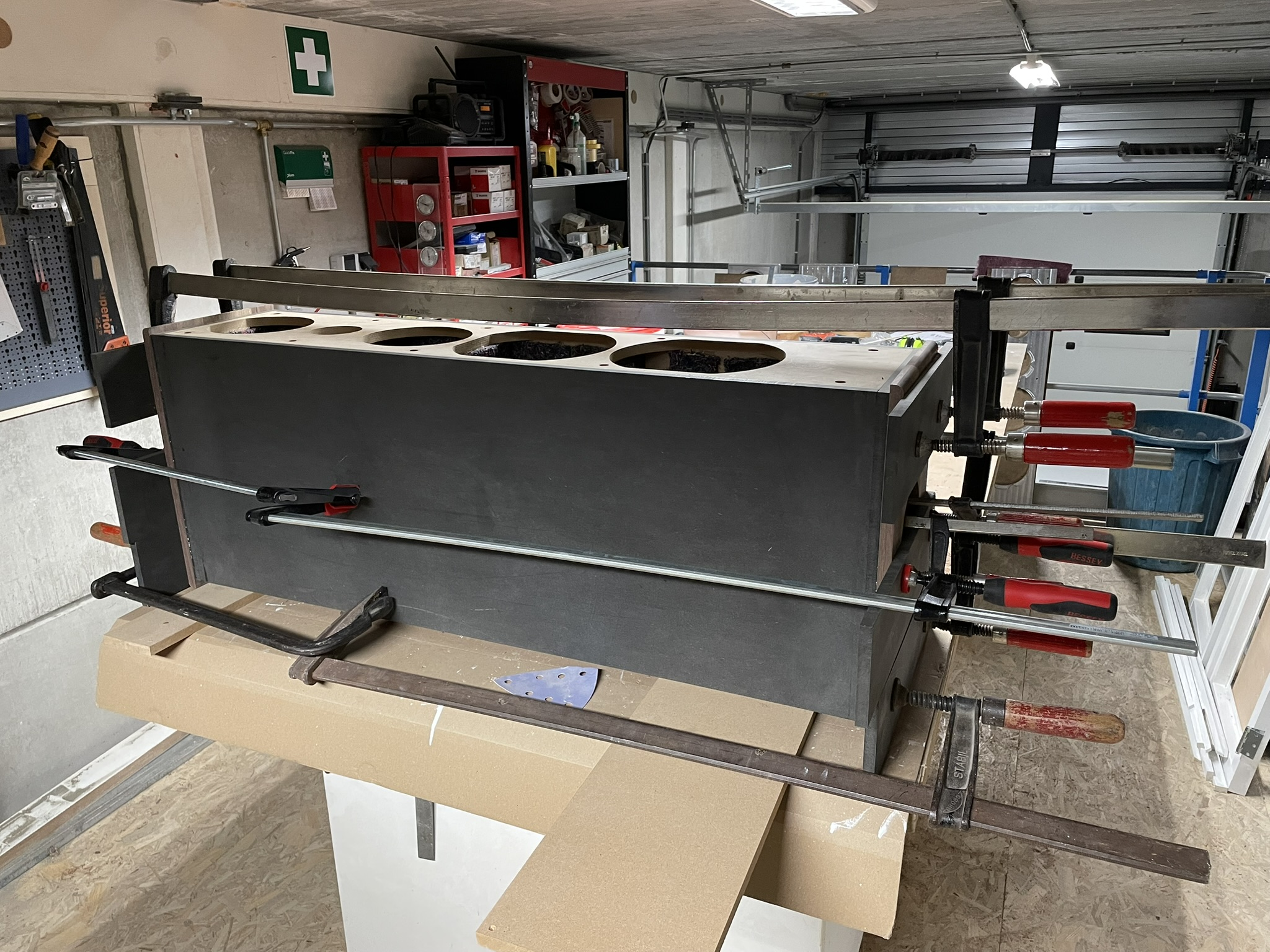

The next challenge is is to add a chamfer (more than 45 degrees) the the long sides of the side panels as my 3D render
