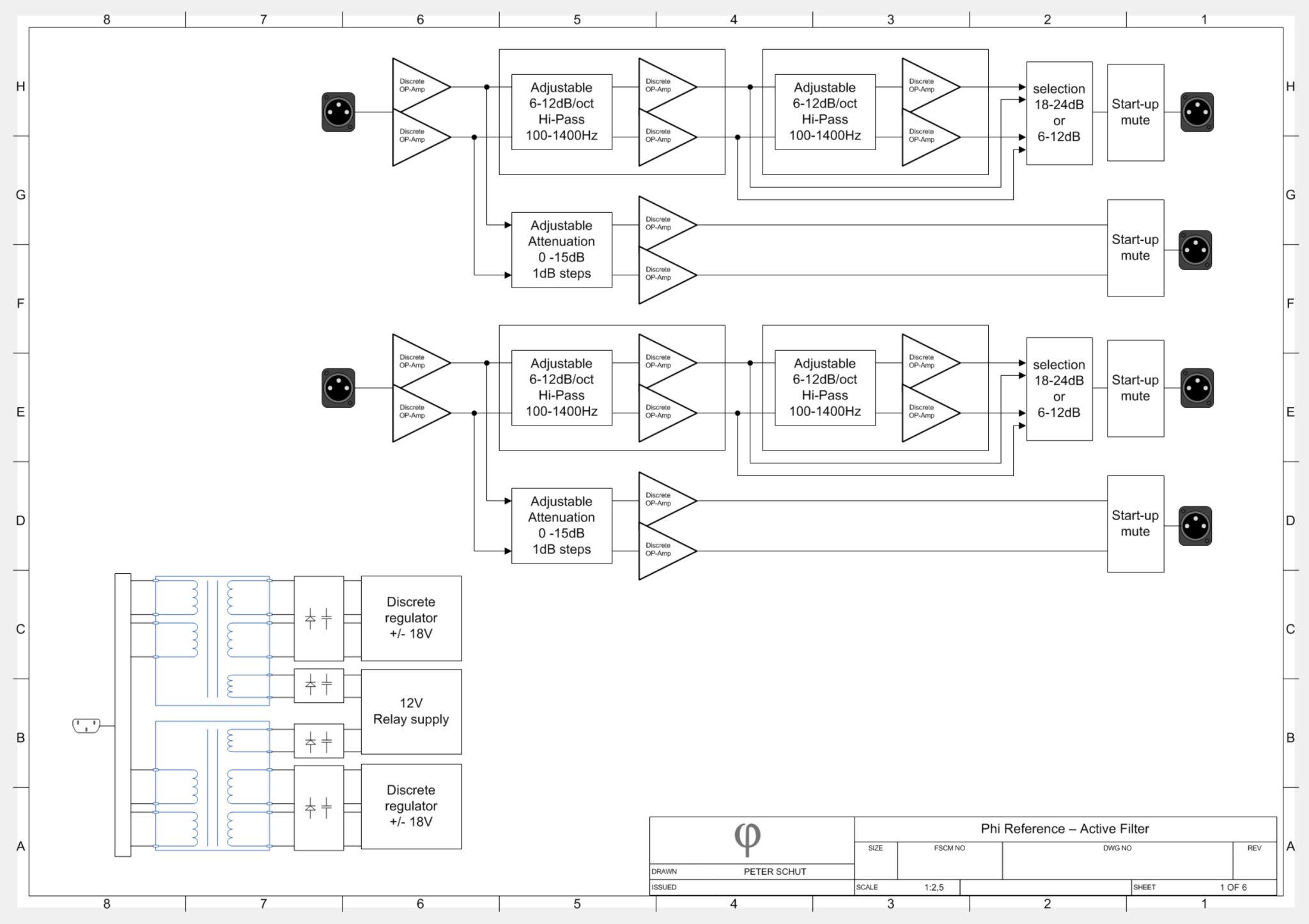

As mentioned before, we are going to add an external Hi-Pass filter that will sit in front of the poweramp driving mid/high section (that will have a passive low pass for mid, and high pass for high, with relatively small/less expensive components)
Why go to this elaborate external filter?
  • It removes the need for an expensive large (300µF) capacitor in front of the 2.8 Ohm midrange
  • It removes an LCR correction circuit that would remove the 80Hz resonance peak of the midrange
  • It will make tweaking much easier as this filter wil have an adjustable 6, 12, 18 or 24 dB/oct slope (like the DSP in front of LF with Hypex)
  • It will have a frequency adjustment from 100 to 1400 Hz in 50 steps
  • It will also have a buffered LF output with 15 steps of attenuation in exact 1dB increments.
This is the block schematic

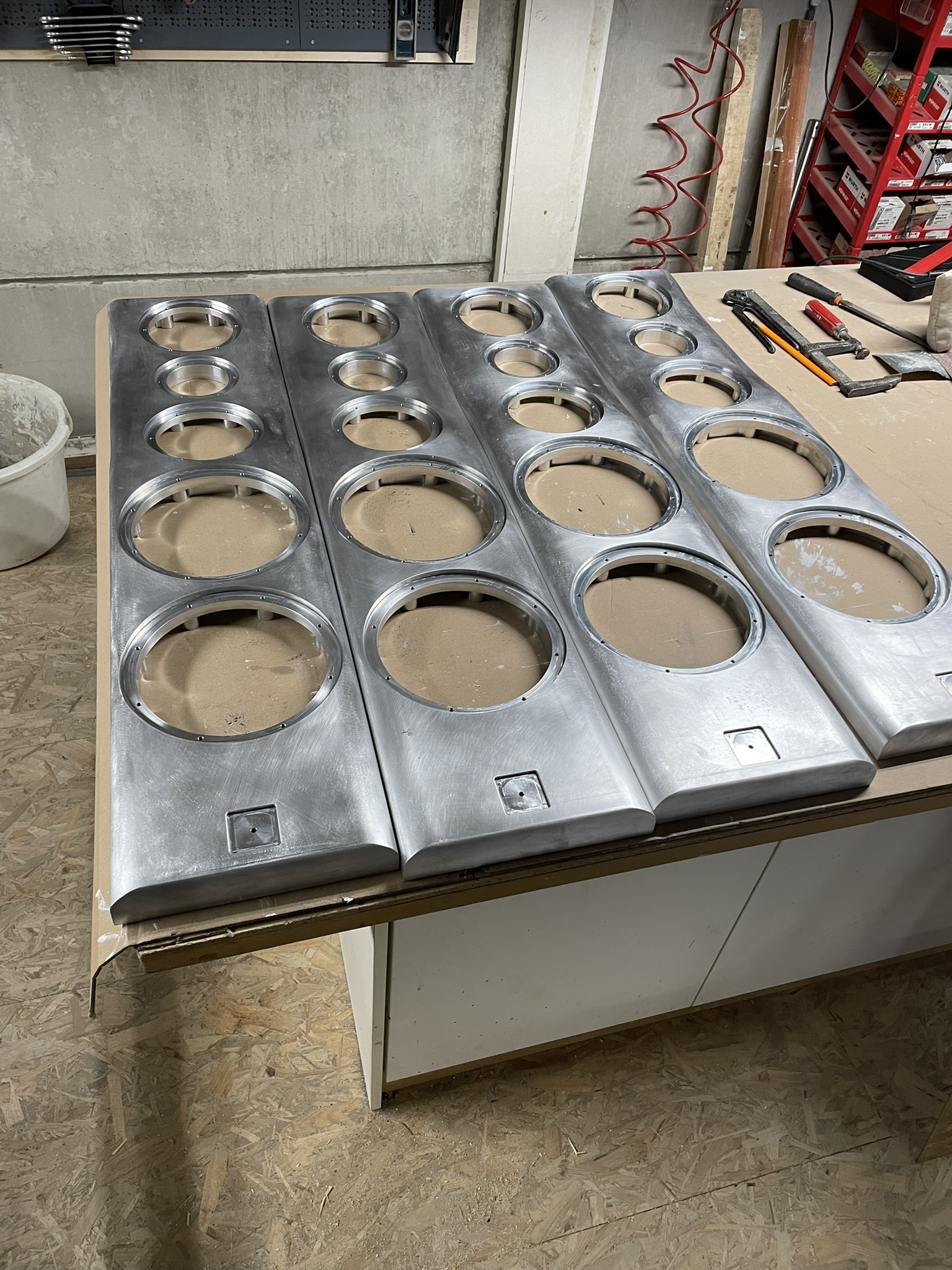

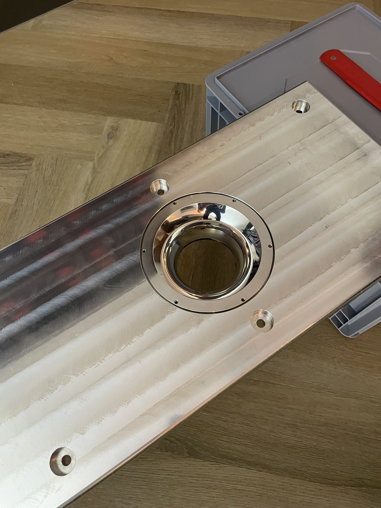

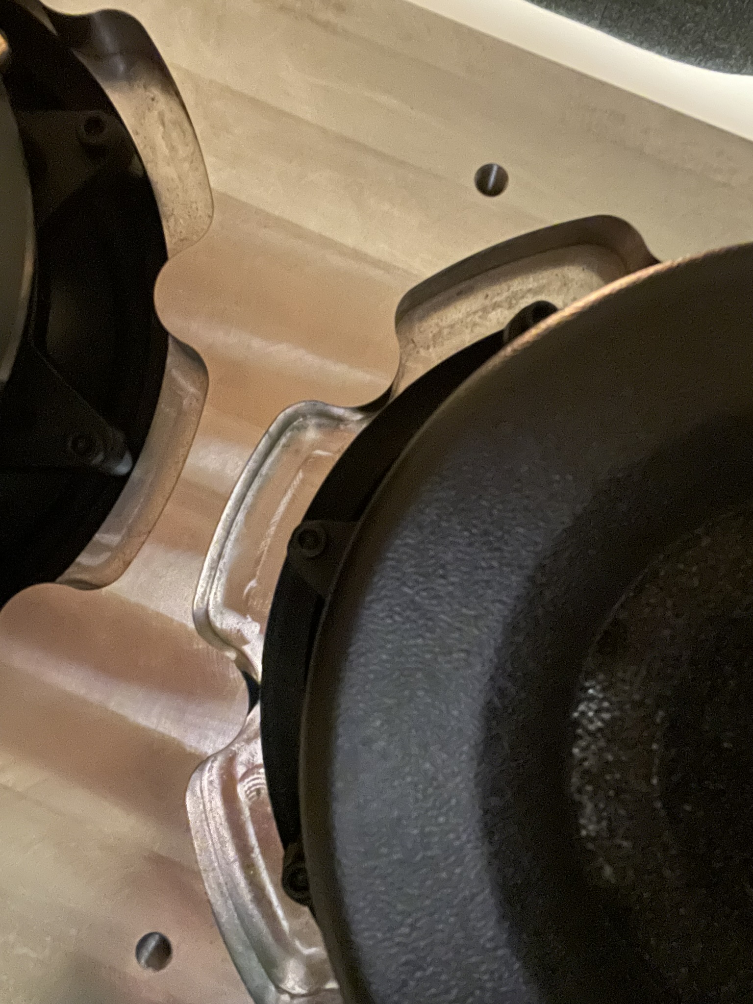

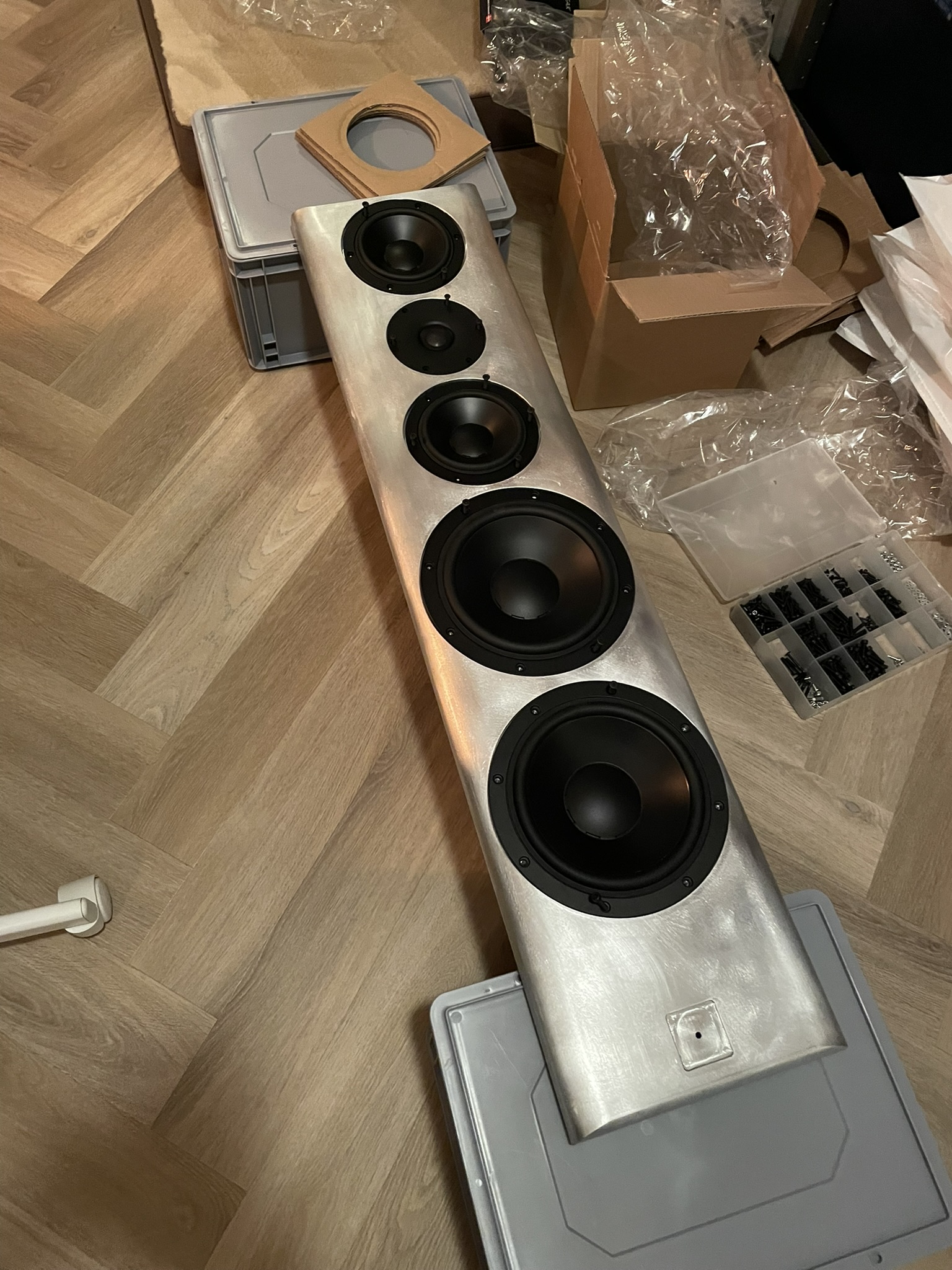

Here a few pictures of the front and back that came from the CNC.
The front panels had to go back as the space between the units and the aluminium was slightly too little and I was worried the units wouldn't go in well enough when the letherette was applied to the the front.
In the previous design i had the same problem making removing a driver very hard.
There is no reason that the margin is a big wider here.

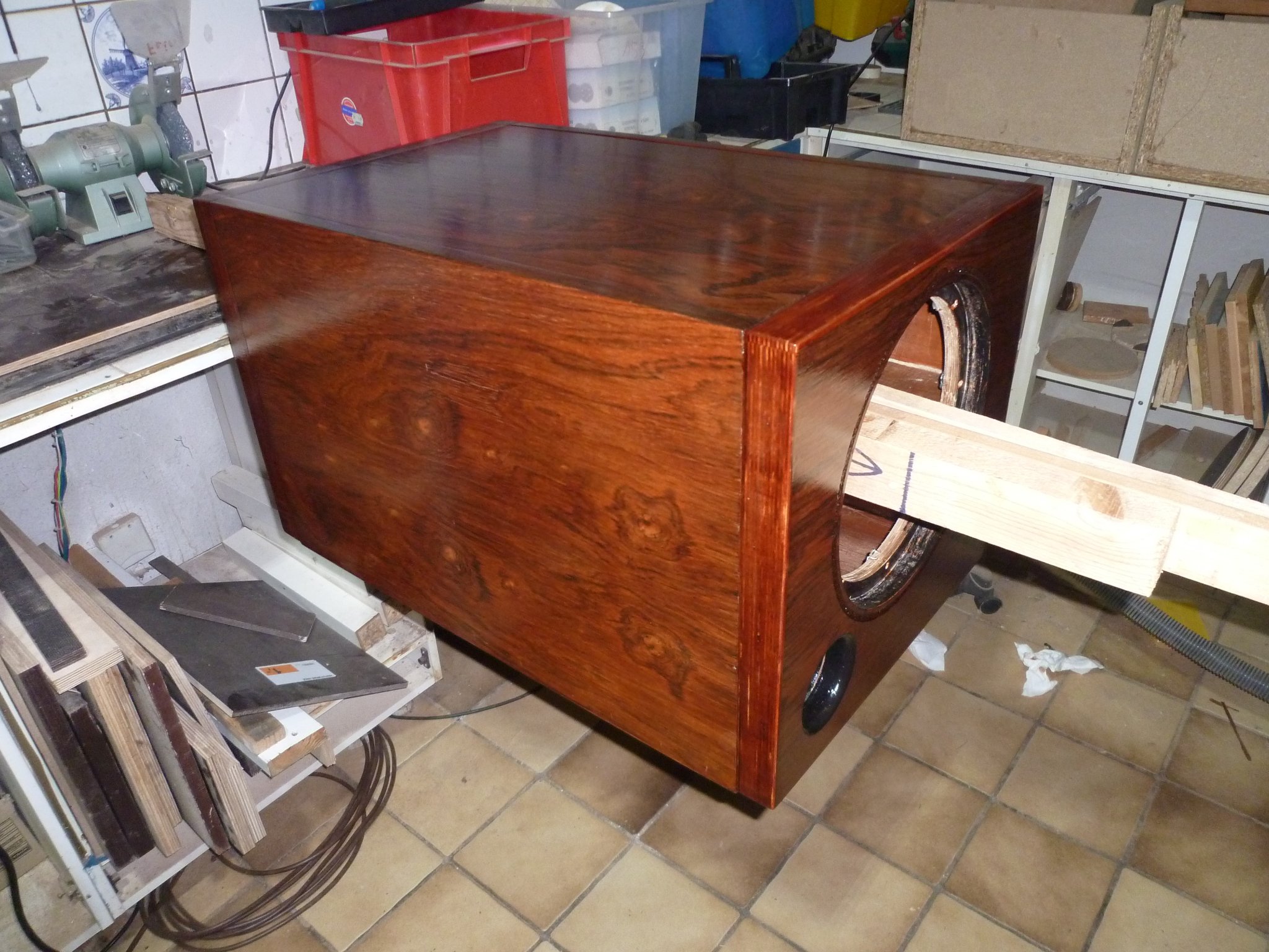

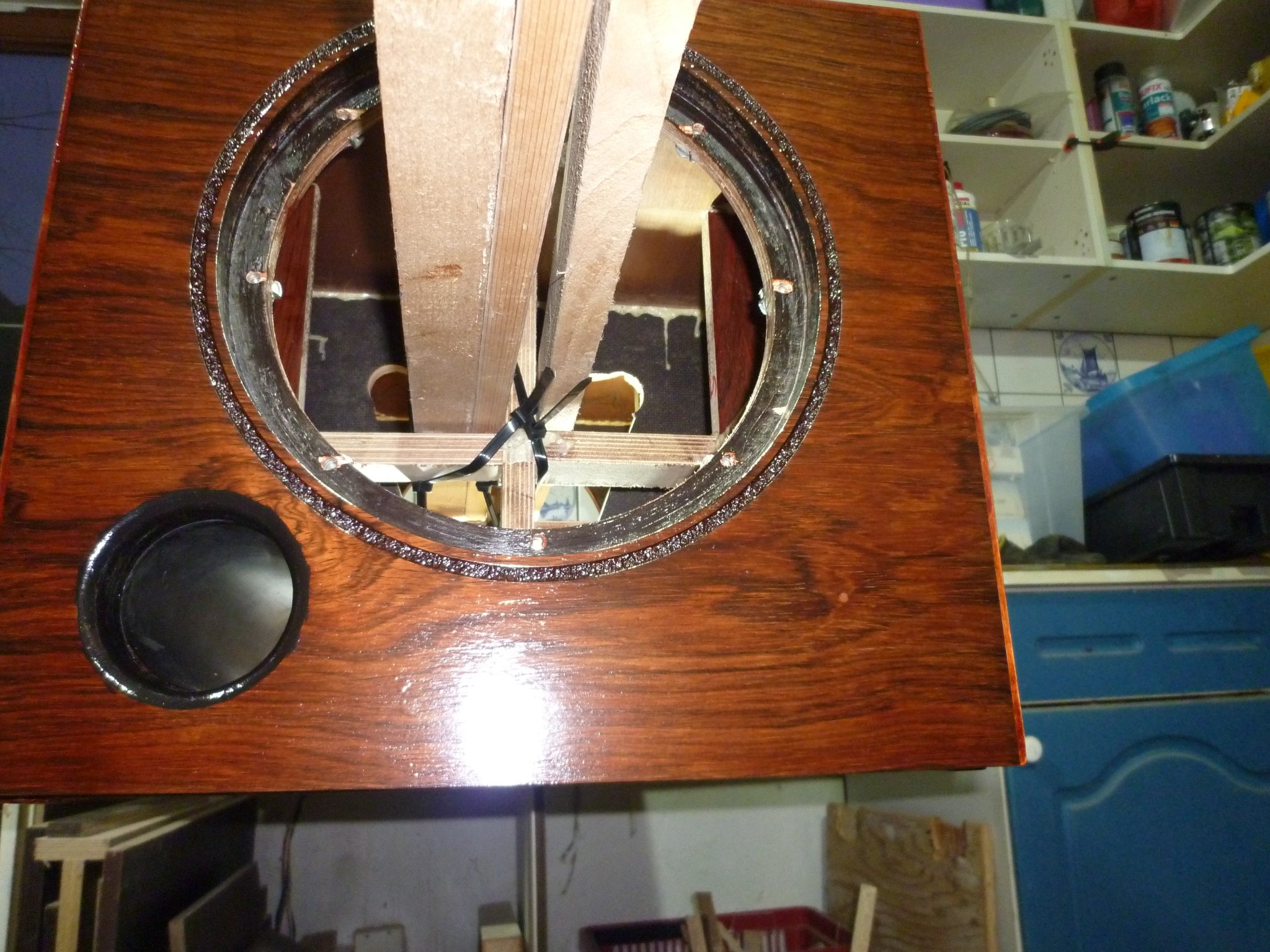

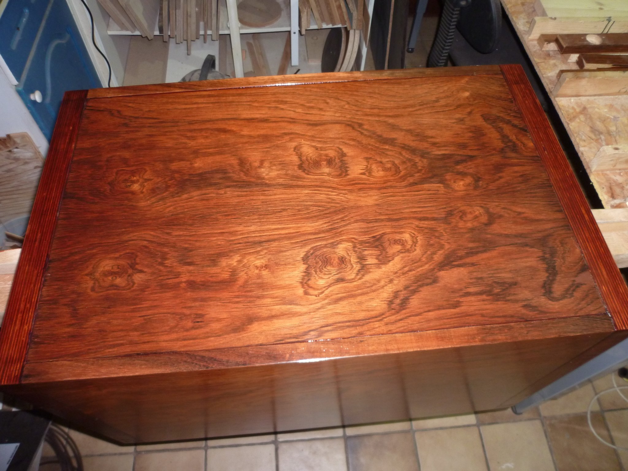

I may play devils advocate for a second. If you had used some kind of wood based particle or fiber board and integrated some concrete slabs and or sand filled cavity in the build, you would have had the same or even a better effect. There is nothing that qualifies aluminum for speaker building but the owners Ego. With amps you can point to the great heat dissipation, but cases cut from a massive chunk of aluminum are not the future of the world.
Compared to an electric car, that will be scraped after a few years with no working recycling in sight or even wanted by Elon, your build is quite "Green" of course. It is just not the way we all should build our speakers. All talk, no consequence? I may add a picture if you don't mind.

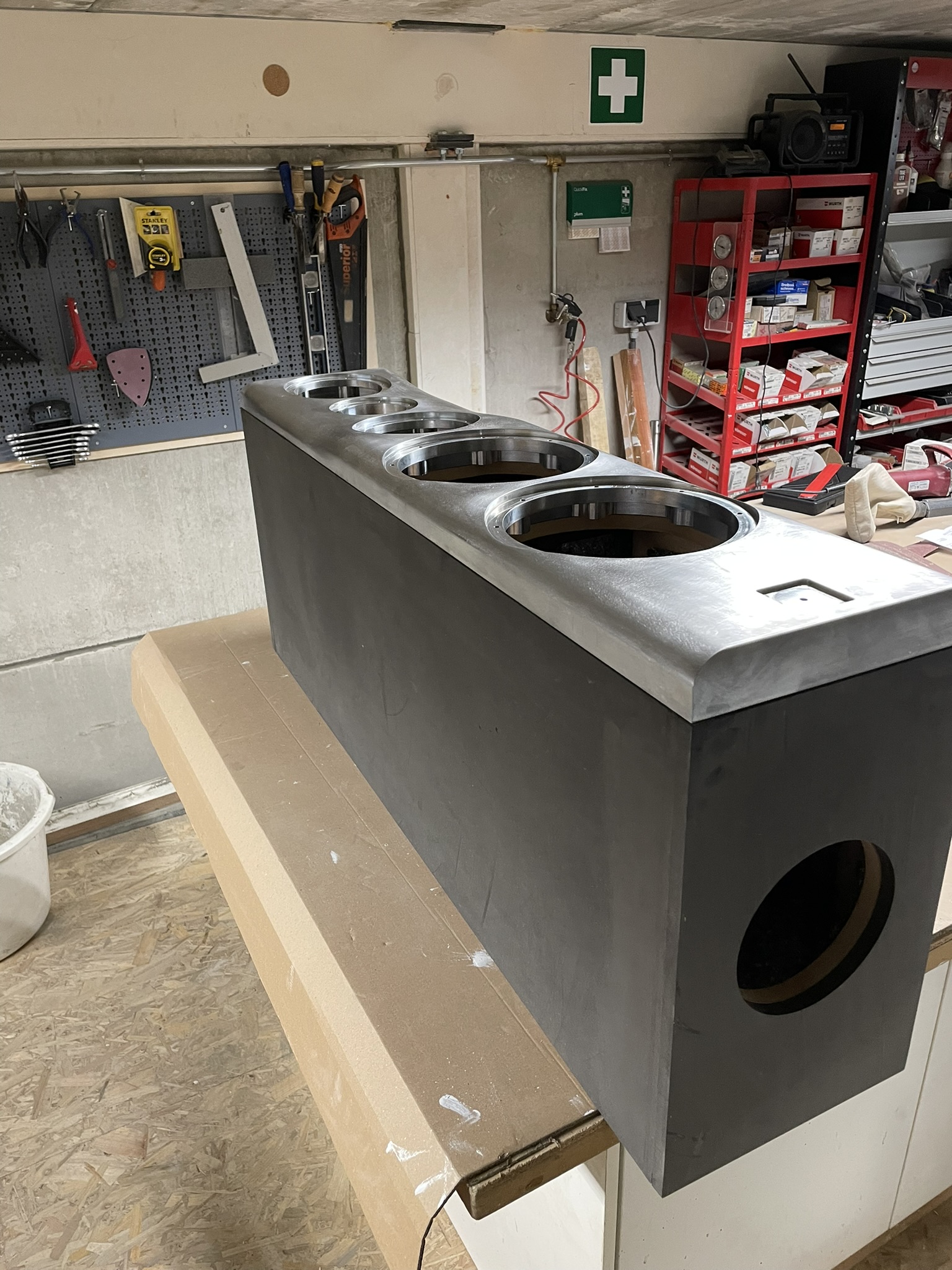

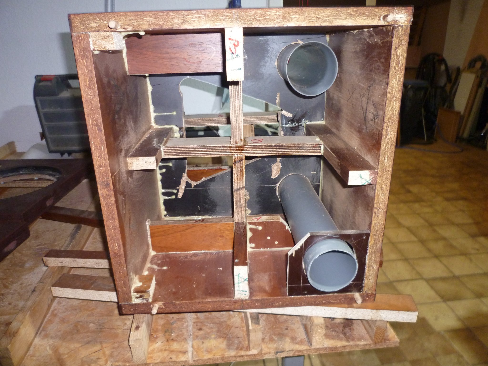

I'm just building a subwoofer that eliminates 100% of mass impulses in a very simple and consequent way by two opposing drivers. Guess what it is build from? The doors of a more than 55 years old wall unit (or Wandmeubel) and some cut off pieces of wood from the ijzerhandel's 1 Euro box.
The veneer is rose wood palisander or Cocobolo from a time no one cared about any rainforest.
Also, not the way for anyone, but a stark contrast in energy consumption and use of resources.
Did you know that the Netherlands will be under water decades before Germany? So I do a little compensation for you. on a very small scale...😉
Reactions: Rokytheman and svp

@ Turbowatch2. That is a serious enclosure. Dual 15"? The two opposite woofers will cancel out moving mass vibrations. I used for many years an Audio Physic Minos subwoofer (fantastic unit) that uses 2 opposite 12" Peerless woofers but I sold it this year as it just didn't fit the living room anymore and is now replaced by a smaller Dynaudio S18 (with opposite firing woofers as that is the best way to make a sub). It is only used for surround/Atmos movies and can keep up quite well and used below 38Hz
I would increase the internal bracing on your sub as the panels seem quite large, and although you cancel out vibrations induced by the cone mass, you will get vibrations induced by modulated pressure. I would use bracing not further separated than 10/15 cm.

Nice you asked about my sub. I didn't want to hijack your thread, just use it as an example for low cost. In fact it was build from materials already in my house. As I metioned, the verneered panels and massive edges were old cabinet doors. My parents bought them when I was 8 years old and had them rebuild and extended in two other houses. It is looking larger than it is, because it is pictured while getting (hand) painted with the beam inside, which makes it easy to rotate. It only is 2x36 liter net volume, 67x43x40cm and will get two 10" driver. Should be an f3 of 25 Hz. The particle board is 20mm strong. You are right with the bracing, I usualy preach exactly as you mention,10-15cm squares and this one is on the wide side. I verify the result by knocking on the outside. There are a few areas inside this build that could need more braces, but I choose to glue 2.5mm aluminum/ butyl on these audible resonating surfaces, to keep clear of the driver. Alubuthyl, in combination, works very good. Anyway, compared to expensive commercial subs, this one is just sounding dead as Dodo. With the cones 60cm apart, you still get an acoustic in room result near to +6dB optimum compared to one driver, one amp. It will run up to 80 Hz.
