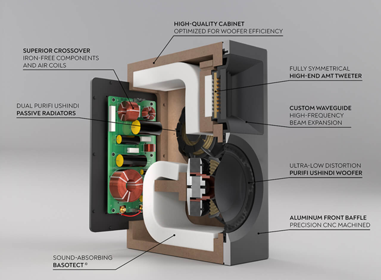

I found it remarkable that the new Radiant Acoustic Clarity 6.2 has some something where the magnet can rest against. You get a better view in their marketing video on YouTube. I attached a screenshot.
The marketing claim is to minimize distortion as much as possible (I guess at given price point).
They also use a sandwich of aluminum and MDF for the baffle but it looks like there is nothing in between.

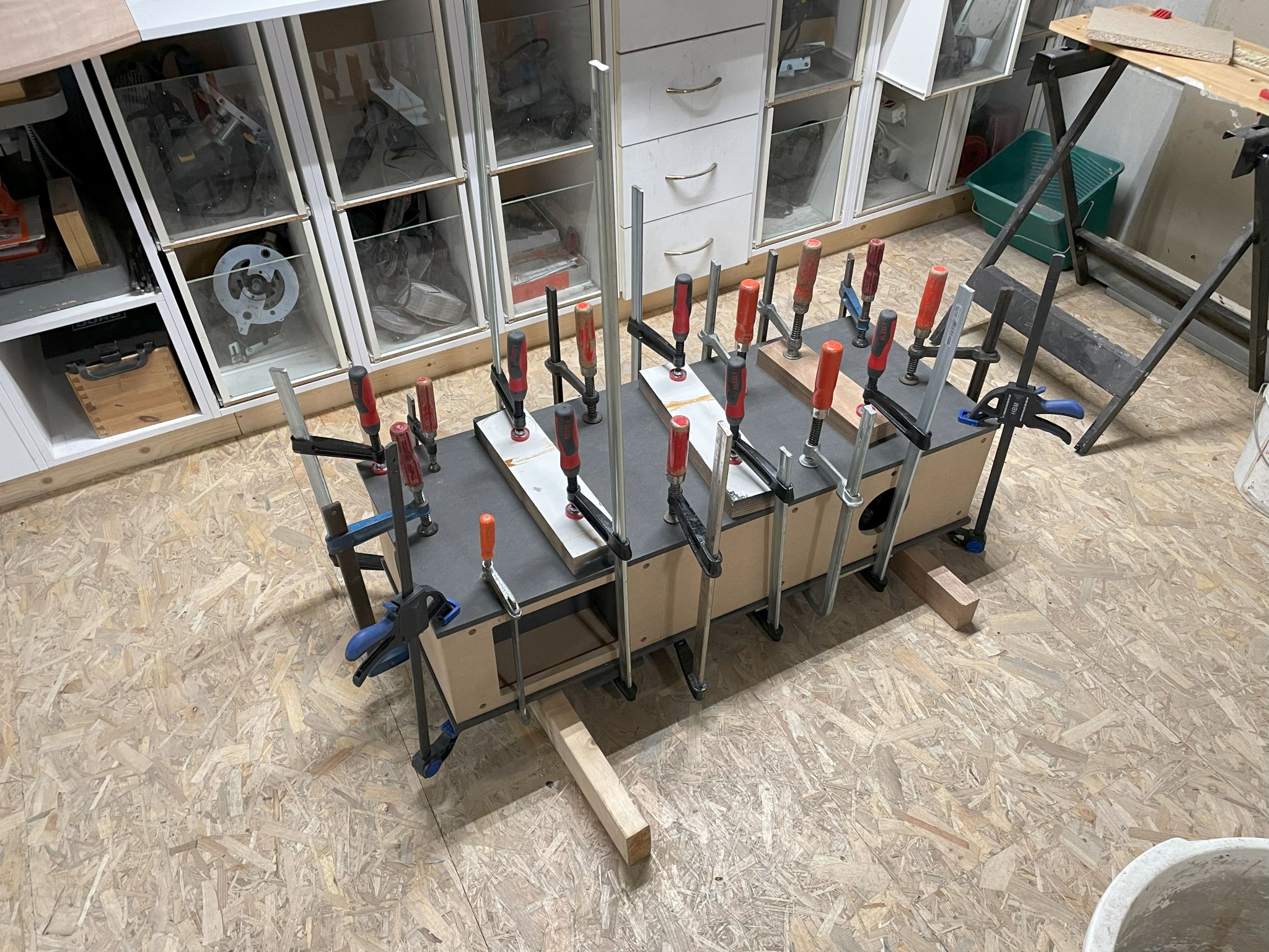

Hi again.
The last two weeks I had very limited time to work on the speakers.

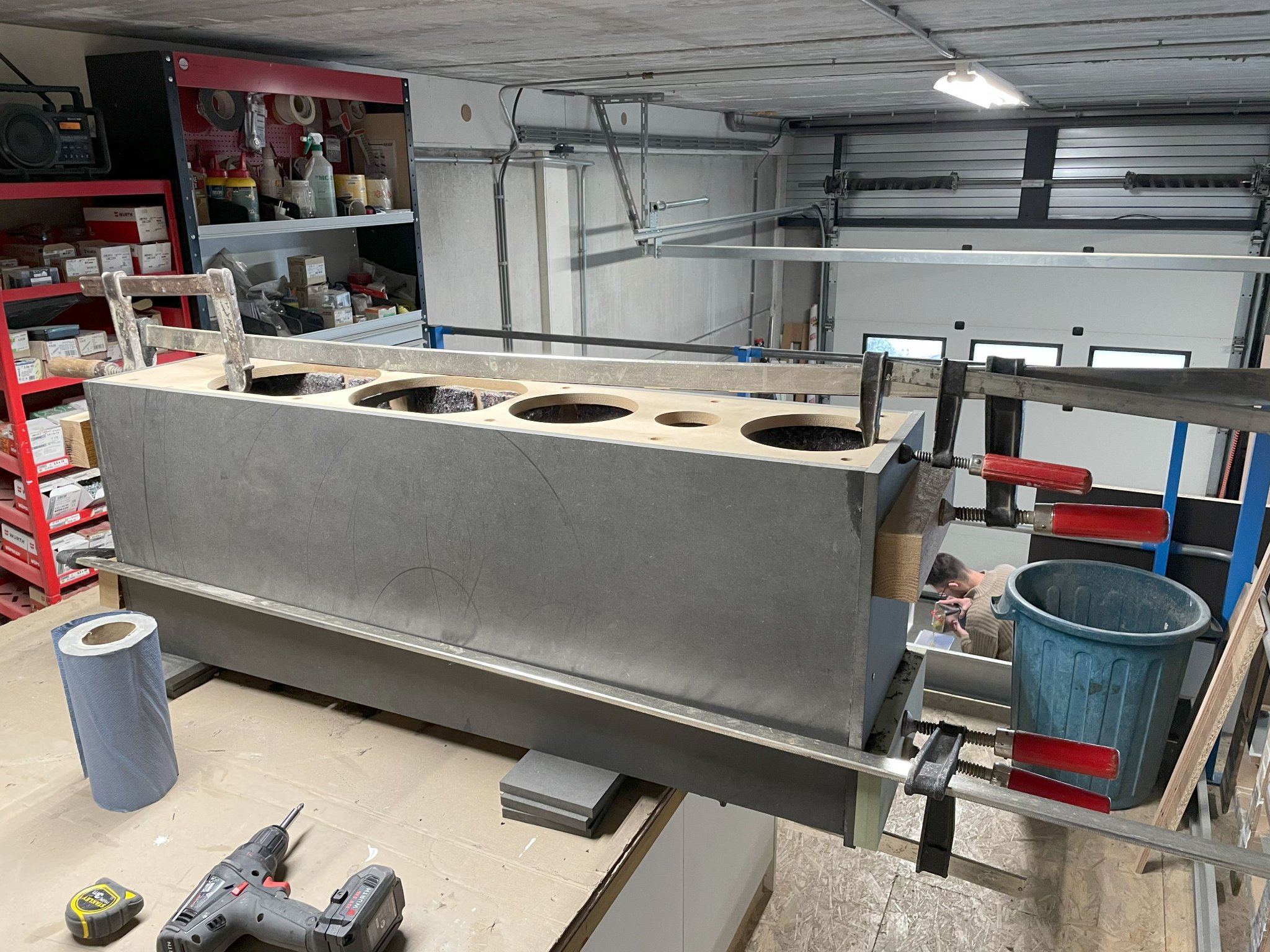

Following the felt placement and gluing the inner front panel we mounted the second layer of the enclosure; this is a layer of Finsa Compac Plus and will increase the mass and stability of the enclosure.
Where the original inner enclosure was easy to move by one person, it now becomes harder.
We glued this layer in a slightly larger size as these large panels tend to drift a bit, and the enclosure will be off half a millimeter here and there. Removing the oversize with a copier cutter is a fairly easy task.
The amount of clamps needed forced us to glue one speaker at the time (one per day, to ensure full drying of the glue)

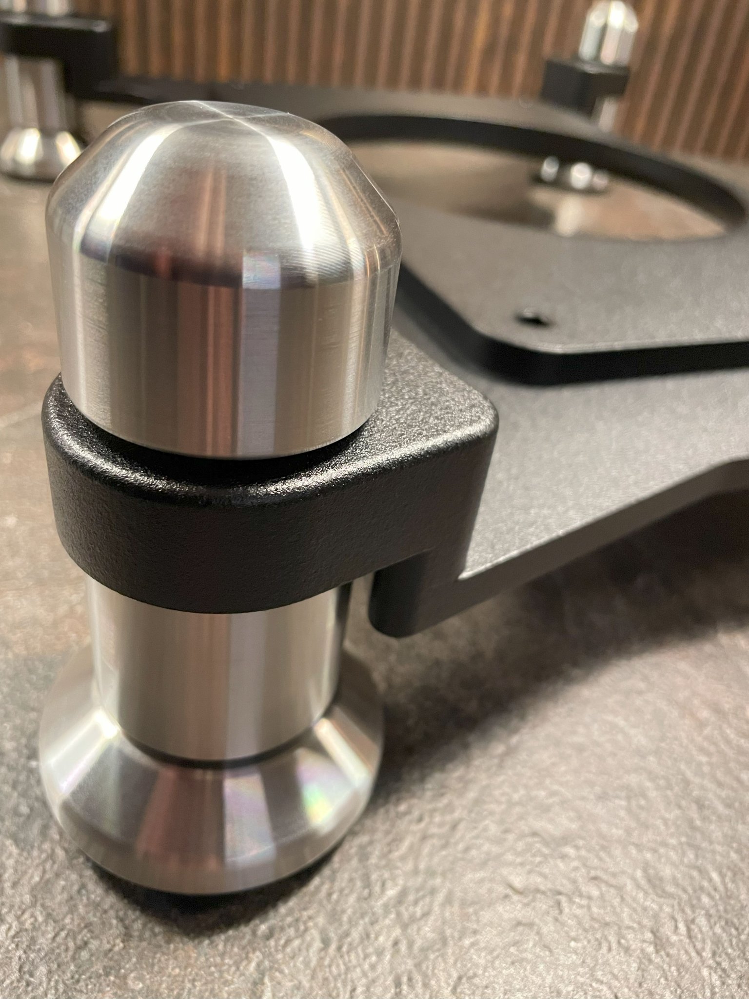

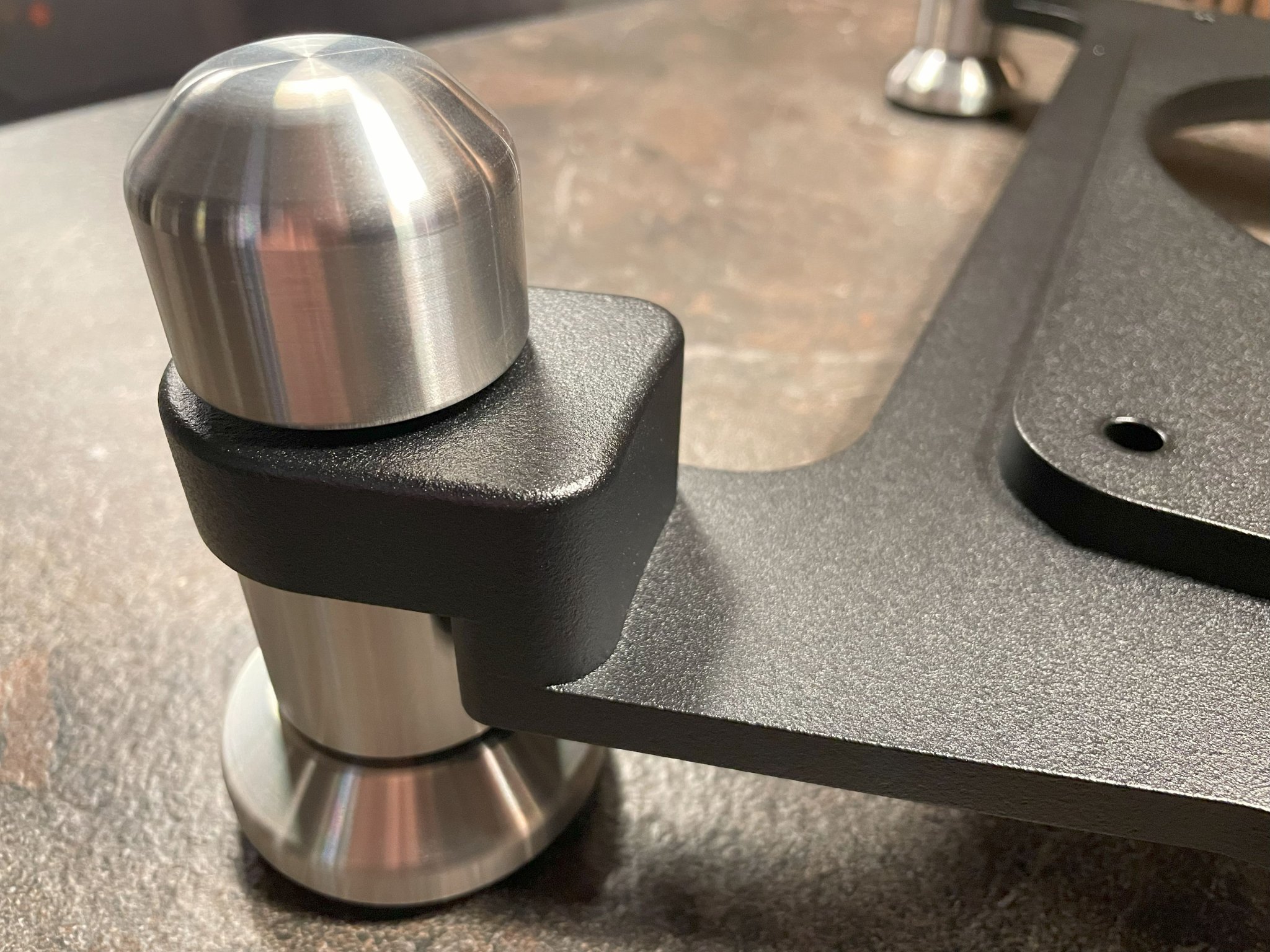

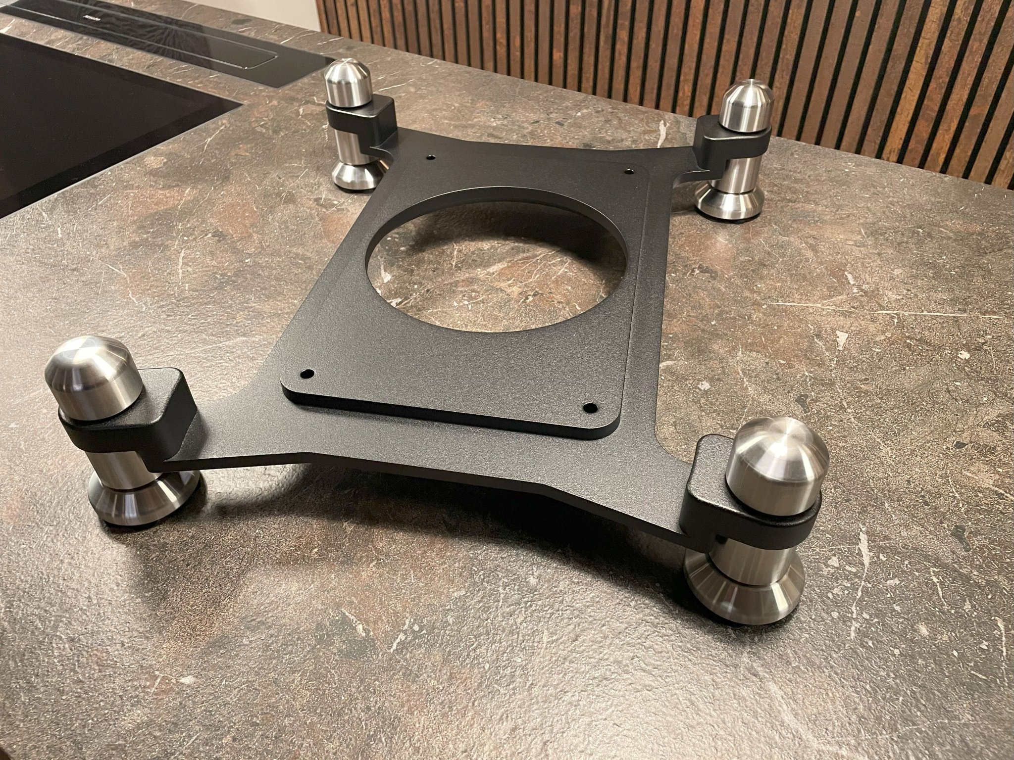

Hi Jan,
This is inspired by Finite Elemente from Germany called Cerabase. You can buy these kind of pucks also at AliExpress but none had the right specs like the M10 bolt in the top with matching top (that I added to lock the M10 bolt when you adjust the height). And many are made from aluminium that I think is less ideal.
The concept is based on a stainless steel base and cylinder that rest on 3 ceramic (bearing) balls.
The function is very comparable to spikes and should prevent resonances to be transported into the floor due to the very small contact area. (like a spike)
The rubber grommets are just there so that the base does not slip off when moving but will have no negative effect of accidentally transporting energy to the base.
Hope this makes sense.
Peter

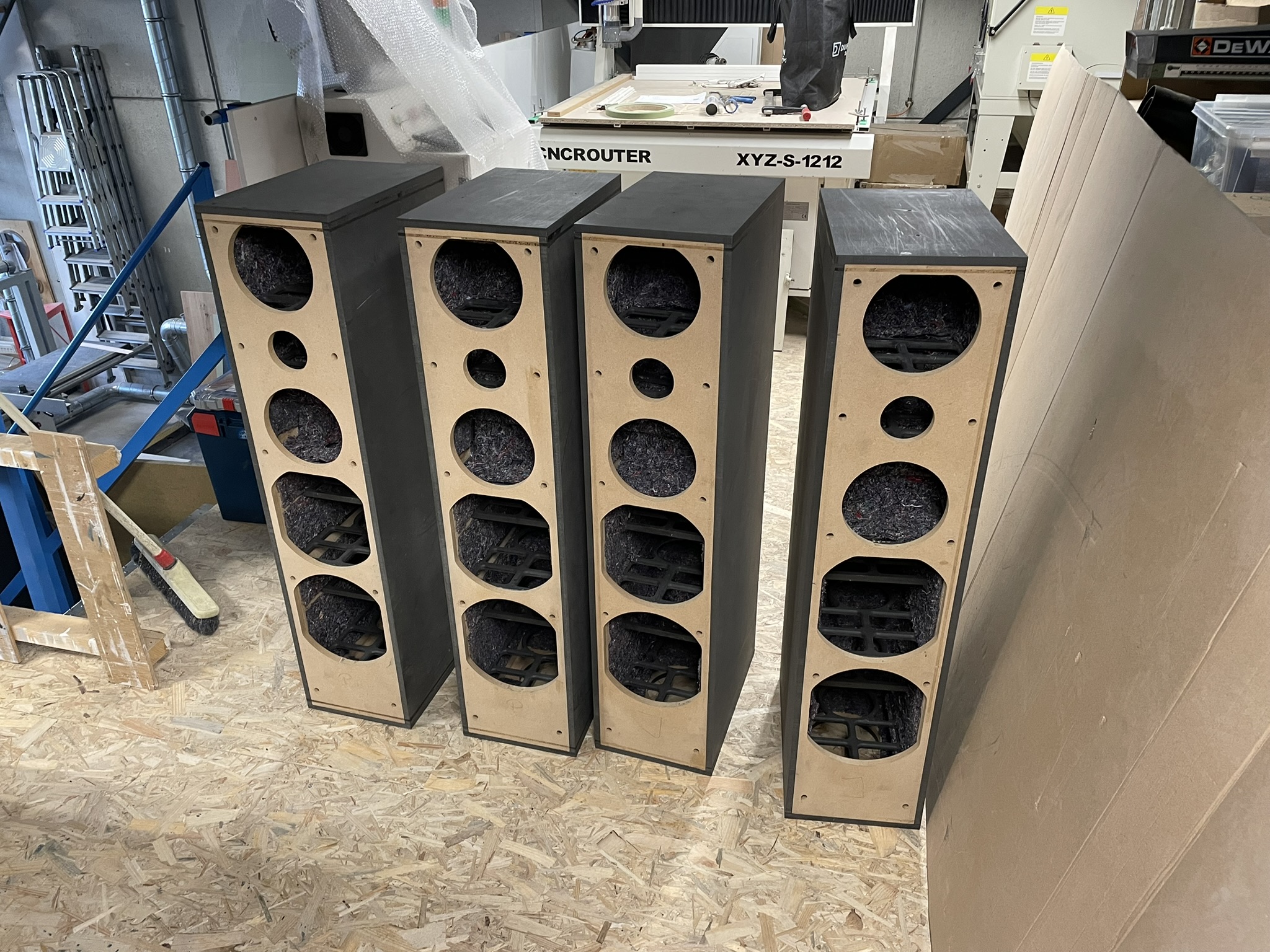

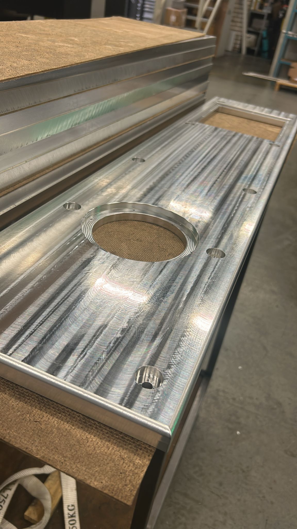

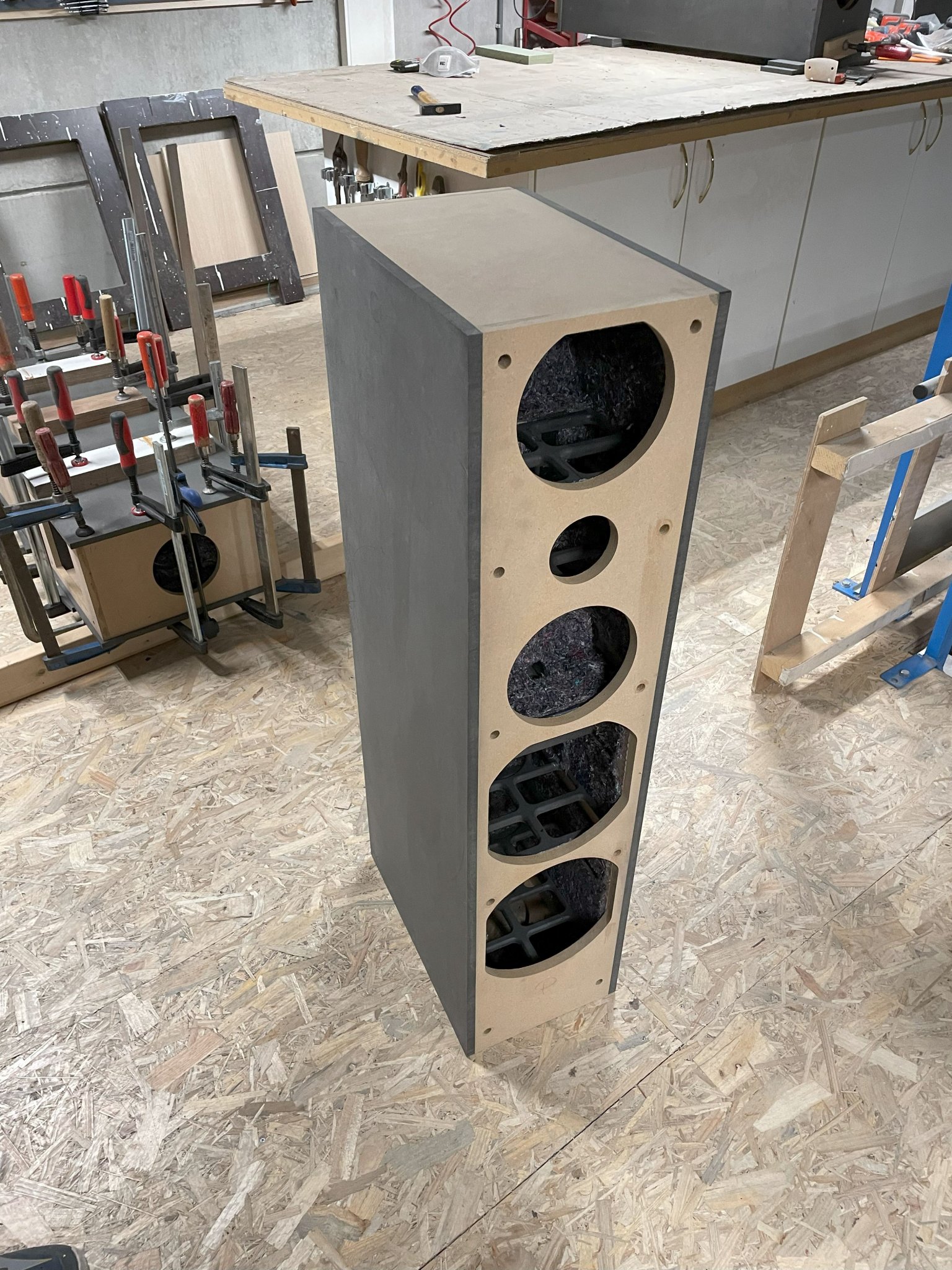

Hi Forum
The internal housing is finished
It is now waiting for the front and rear panel:

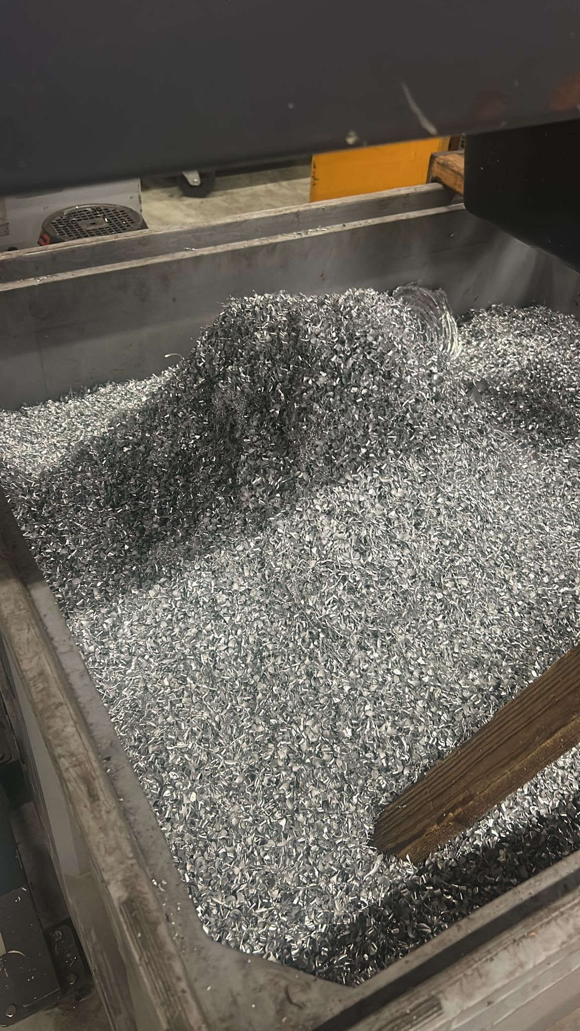

Work in Progres

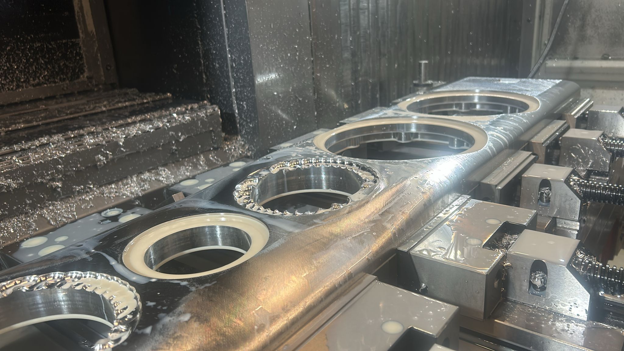

the two mid range positions are under an angle of 3,3 degrees and ar furst cut on a 30axis to remove most of the material and the will move to a 5-axis.
That is why these holes look a bit strange.
It produces quite some curls

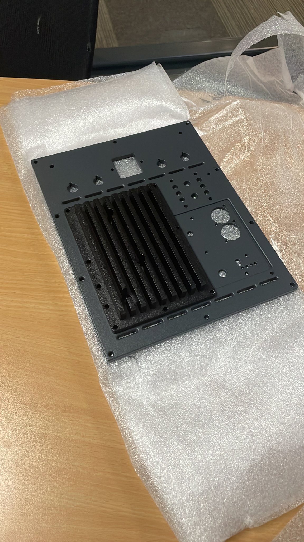

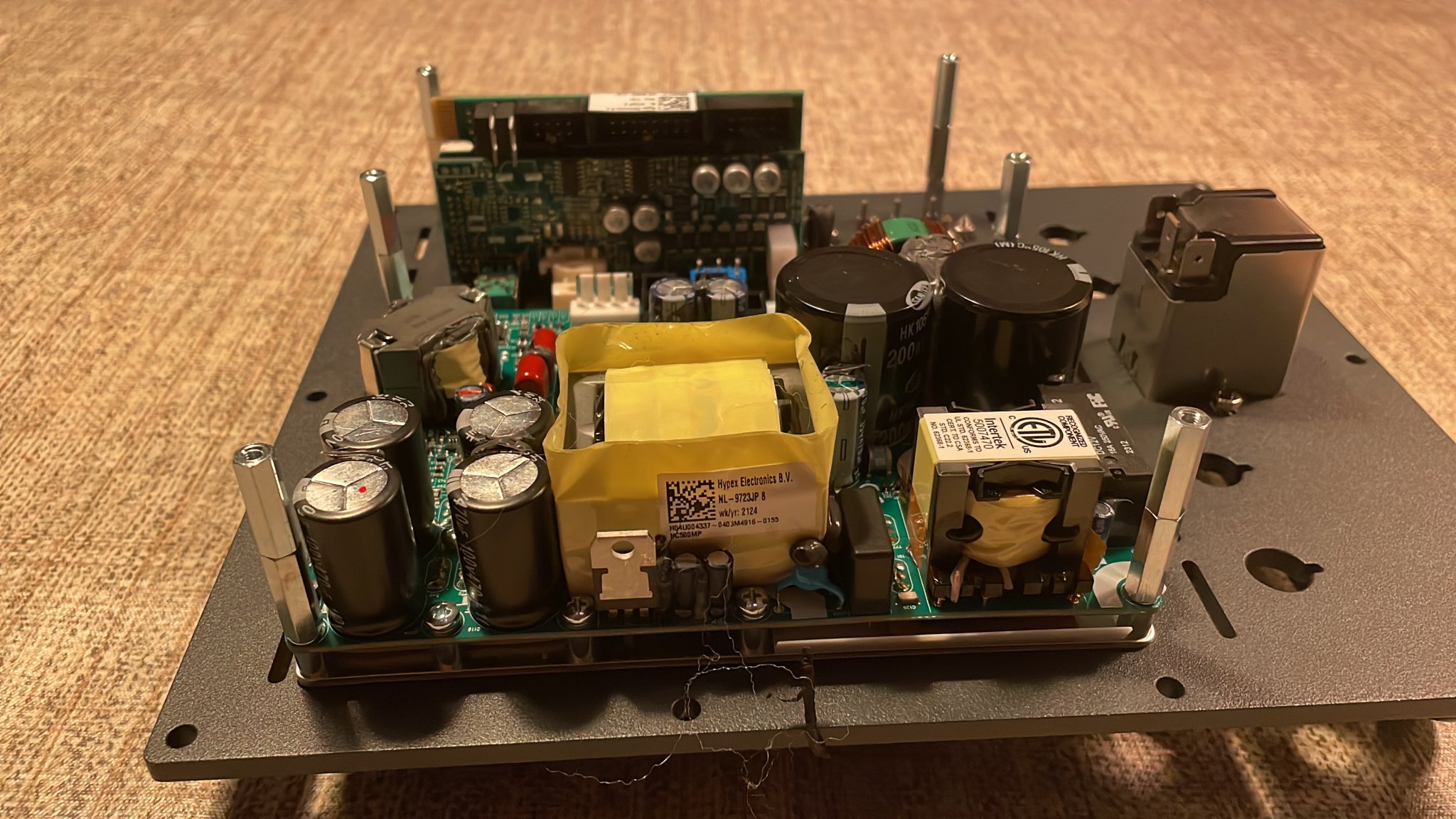

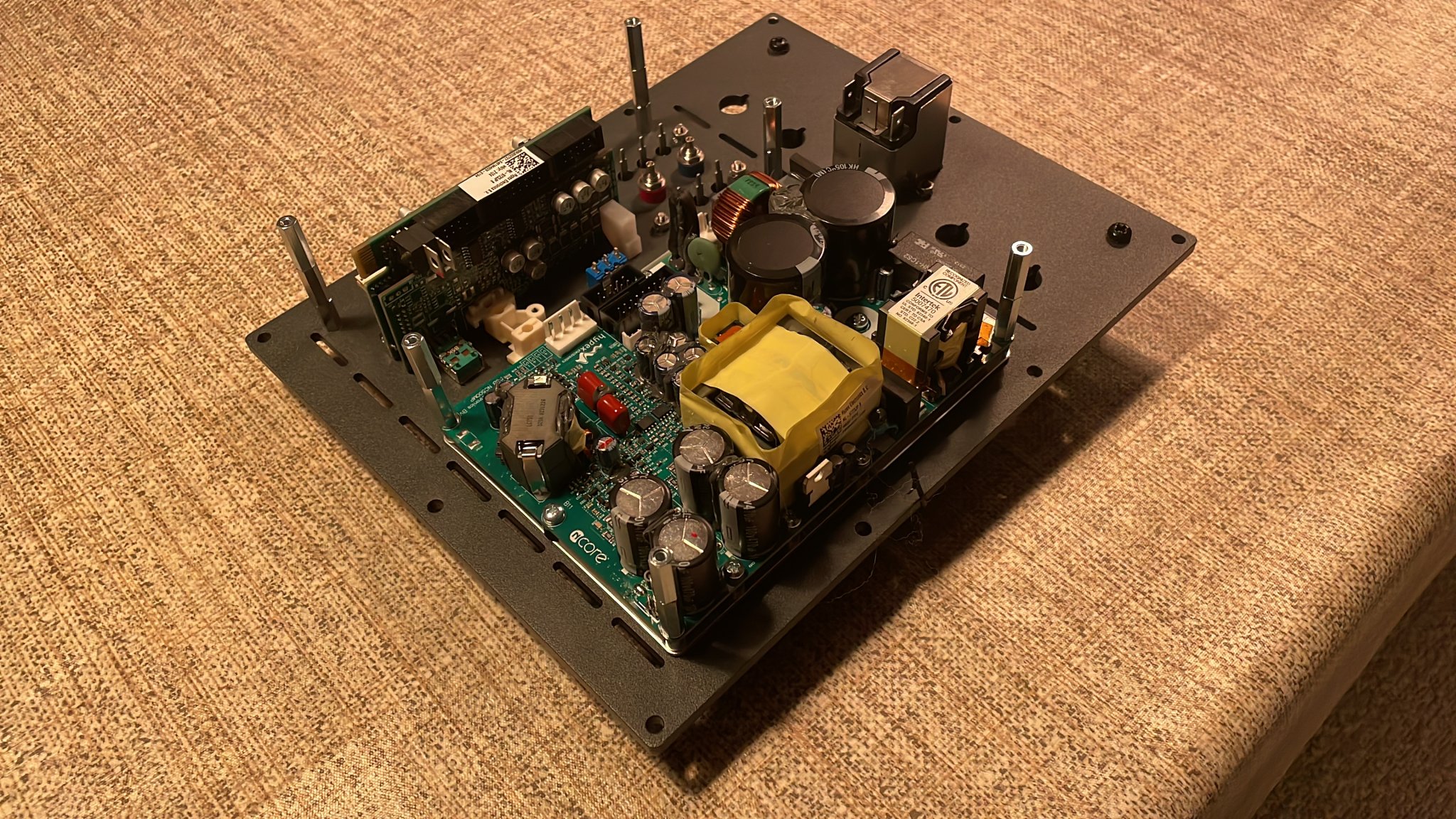

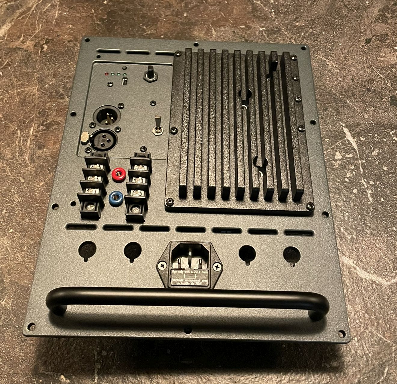

And these are the plate amps on a custom mounting, with stand-offs for maybe a shield
and view from the control/connect side
slowly moving in the right direction
