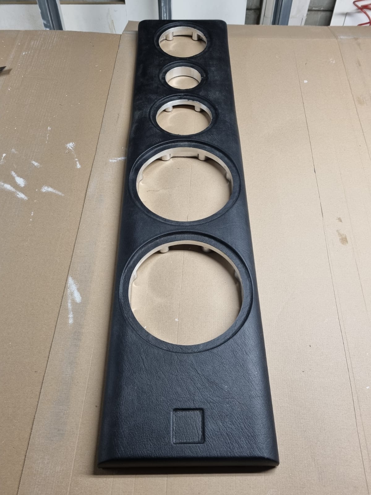

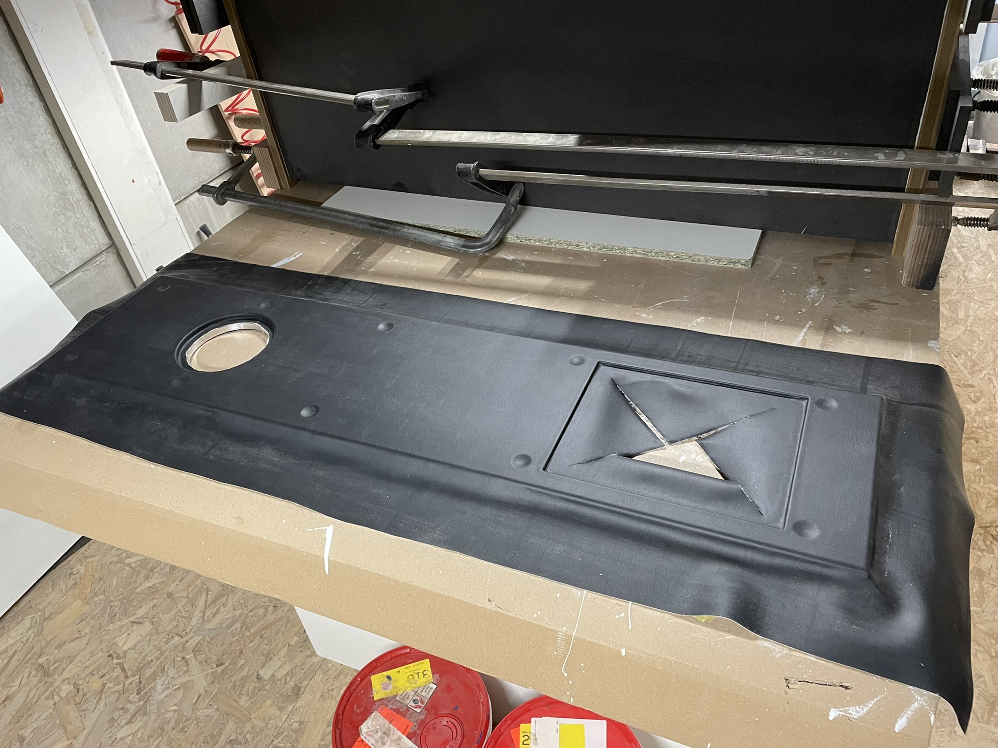

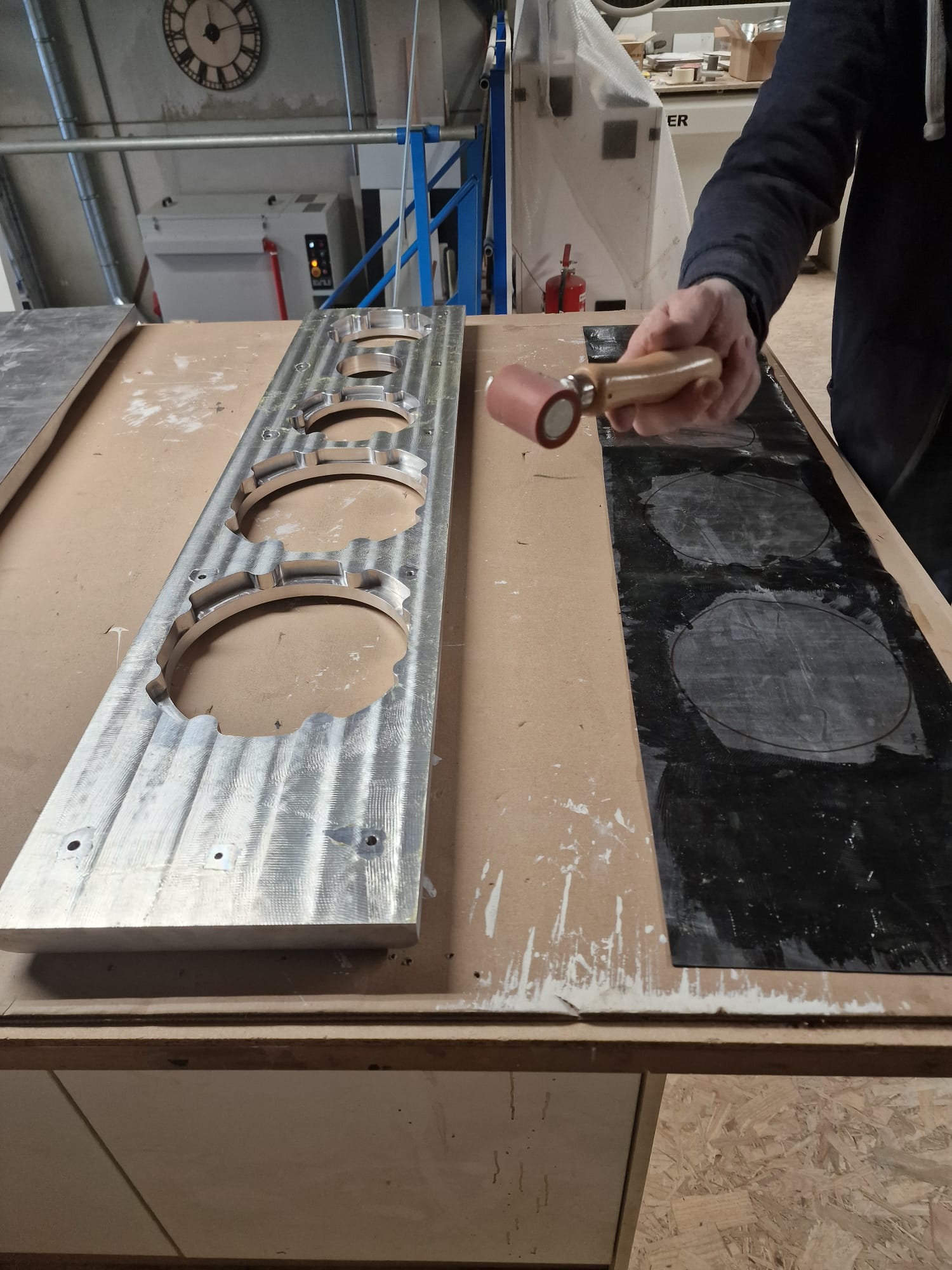

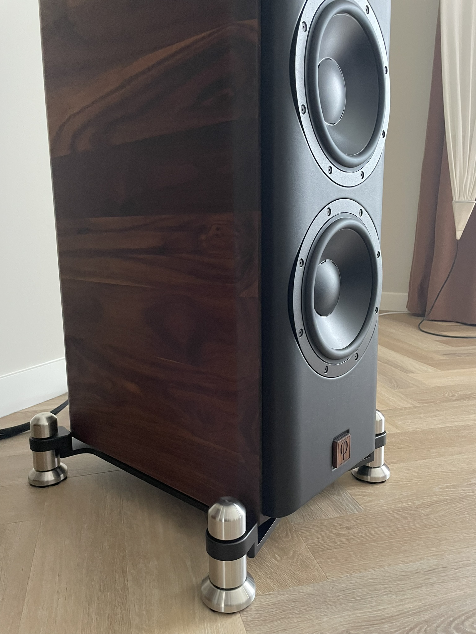

Well with unfortunate little time (I still need to work an help my son in his 1953 build house) we glued EPDM to the back of the aluminum panels and cut-out the holes. Not a very interesting job, but it needed to be done.
Next some work on the wood panels and put leather over the aluminum.

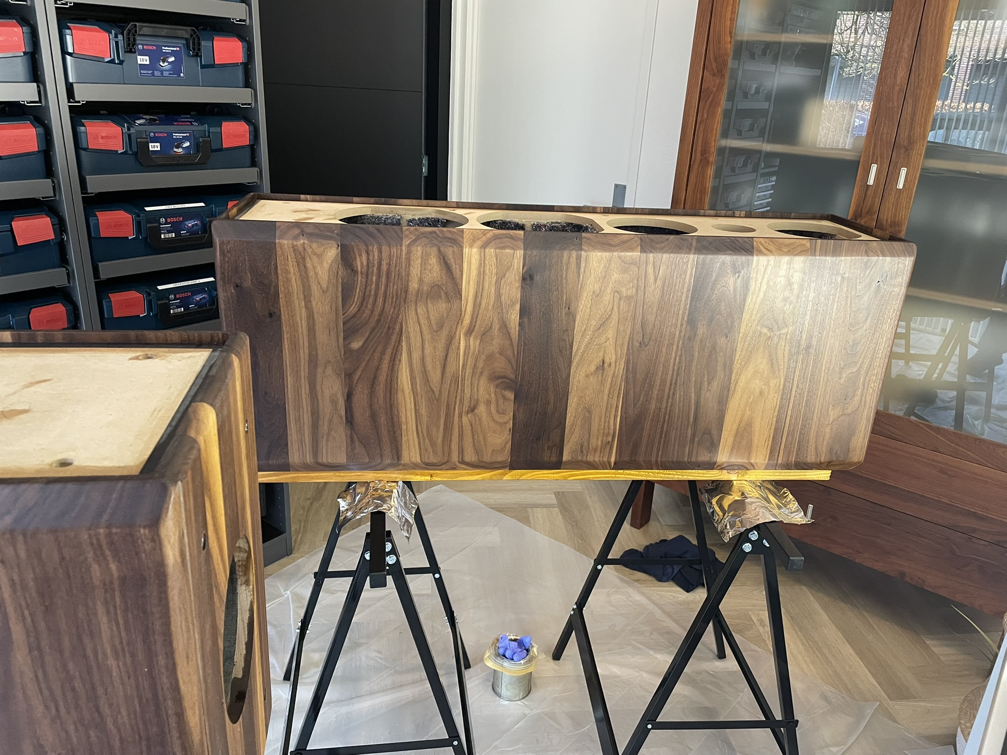

Time for an update, a lot of small things were done the last 2 weeks.

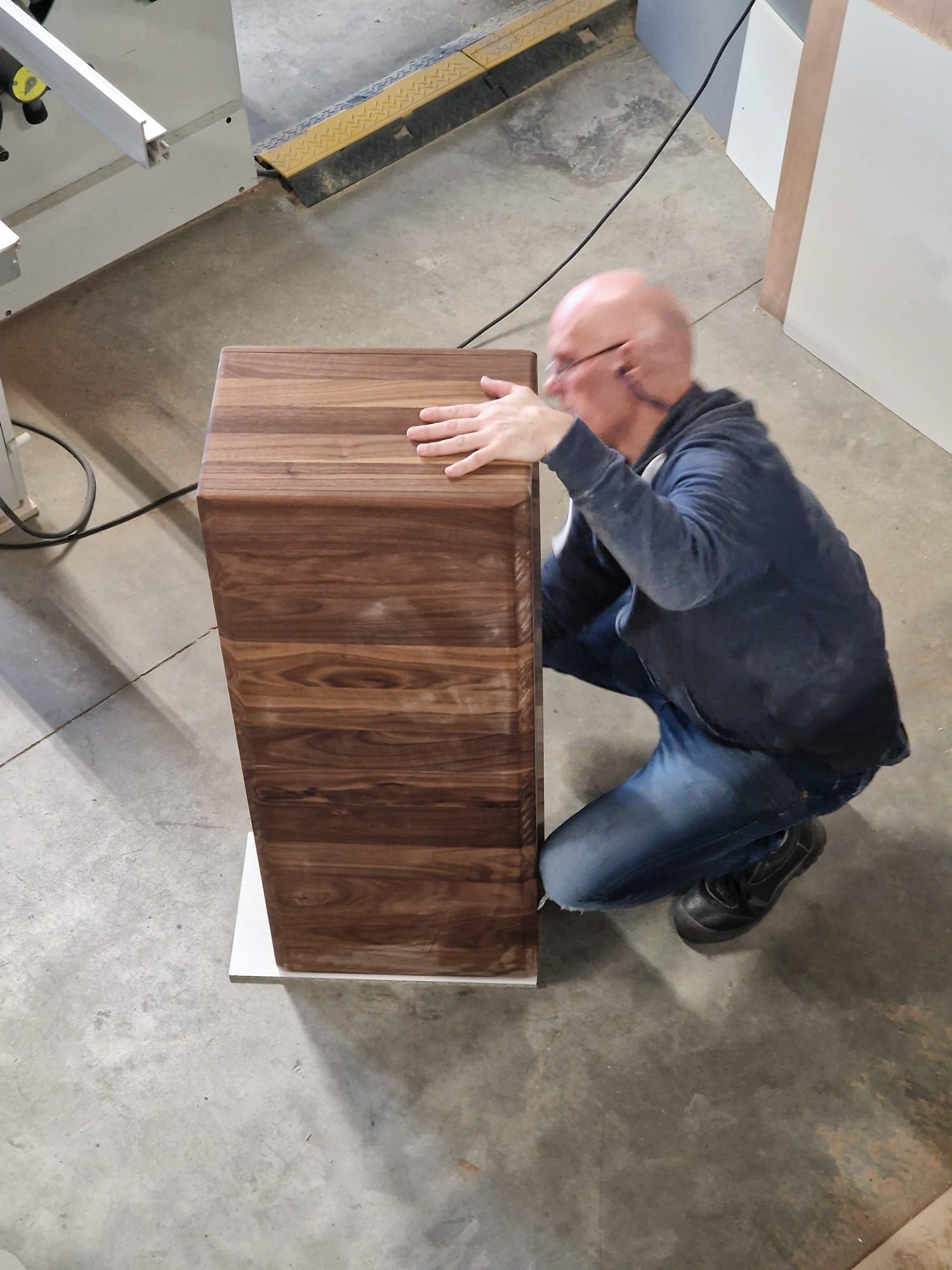

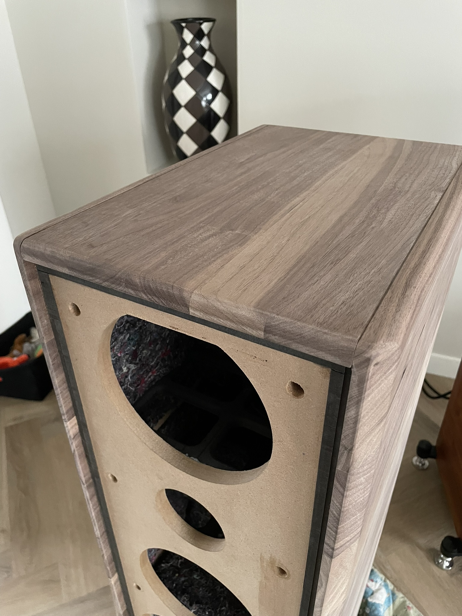

Adding a chamfer to the sides
wetting between sanding so the hairs pop out
After a few hour sanding very smooth surface ready for oil

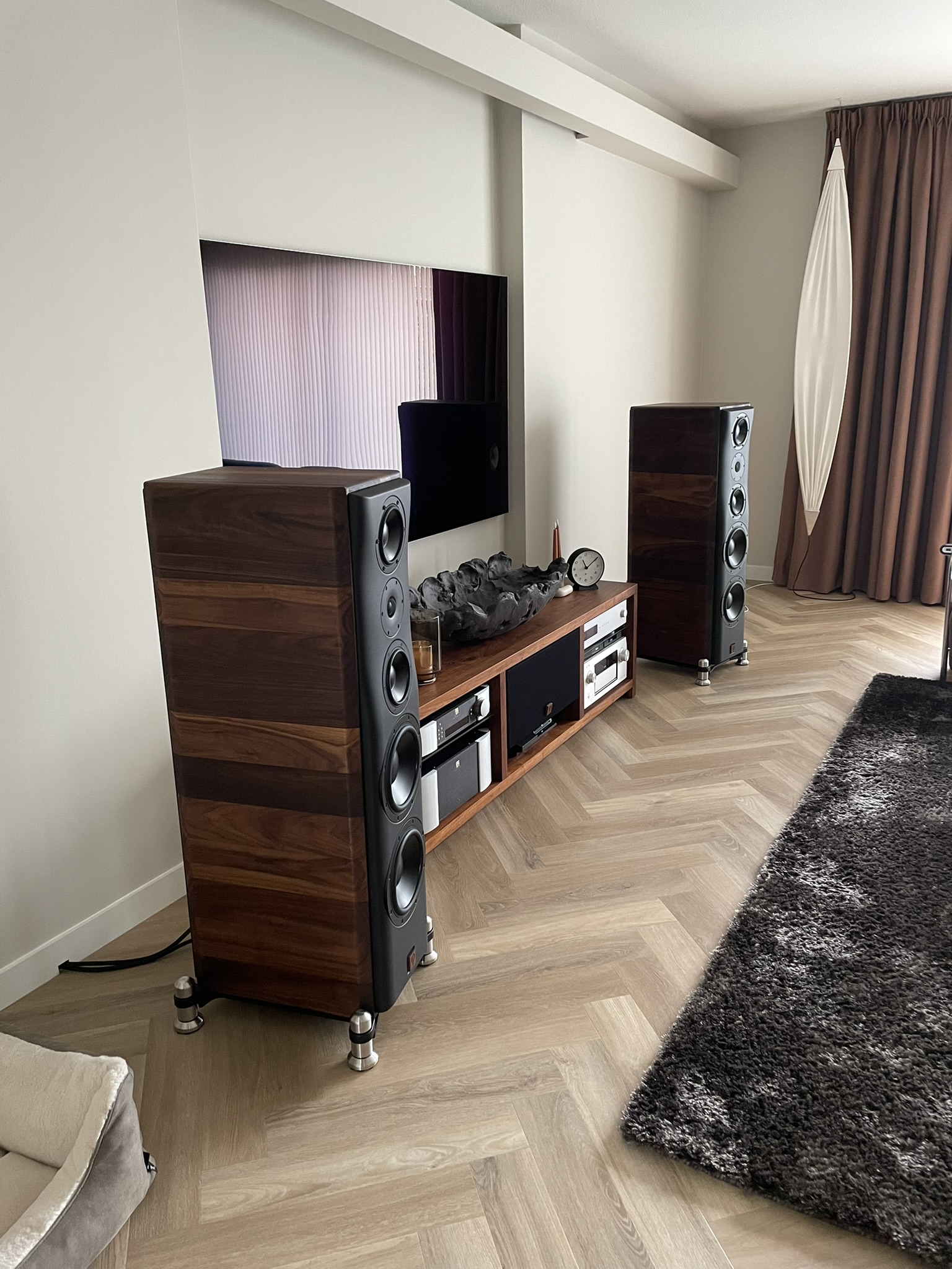

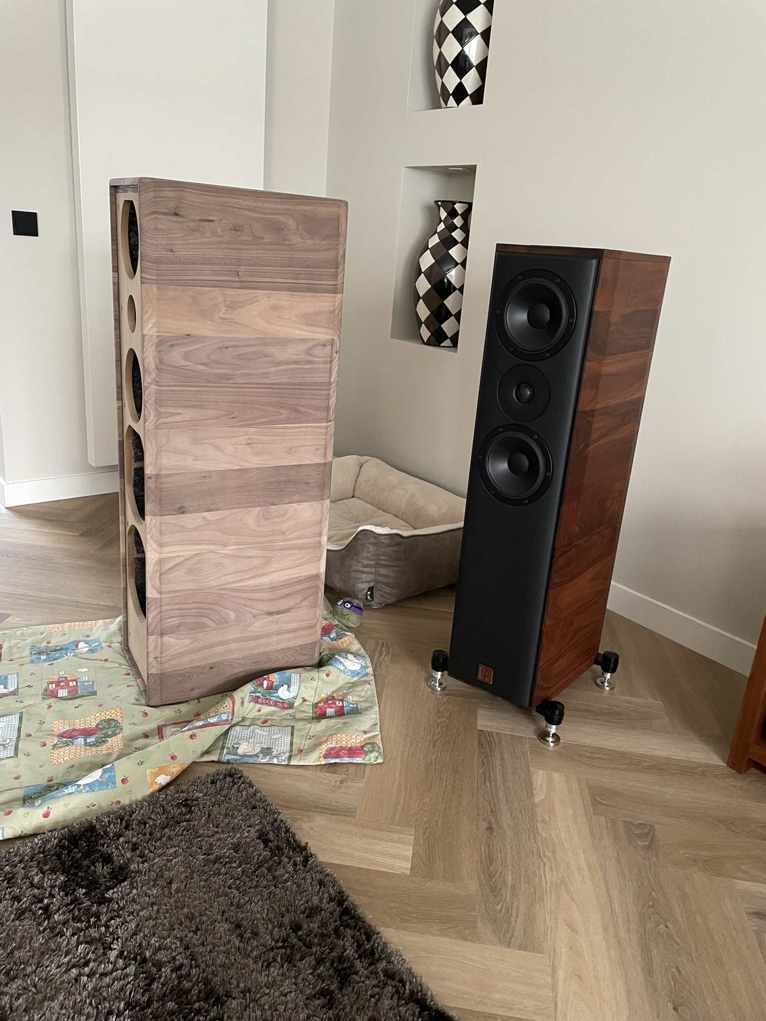

next to the "old" 2017 build surround speaker with upfiring Atmos section. My wife is quite happy with new size. The previous were quite big

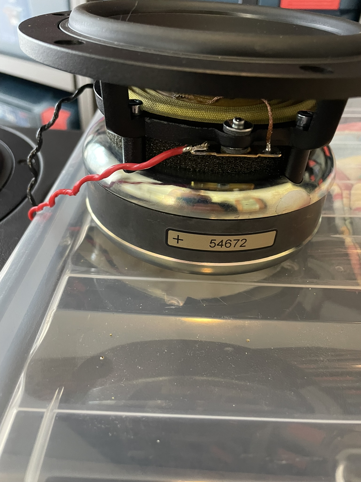

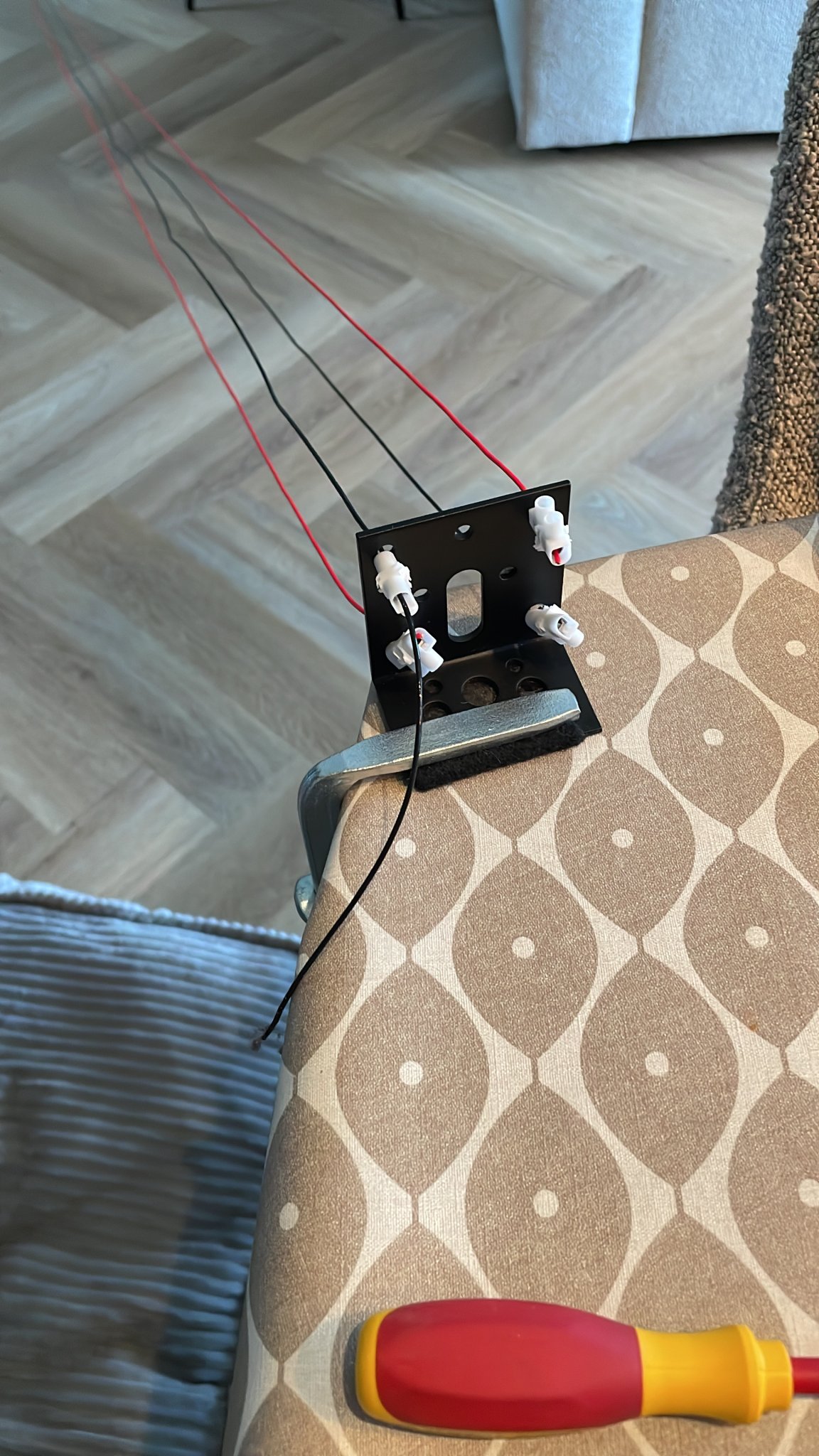

home made start-quad OFC cables for internal wiring dual 1,6mm2 for mid dual 0,5mm2 for high.

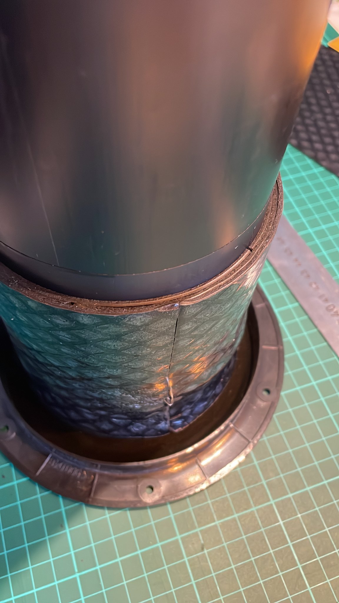

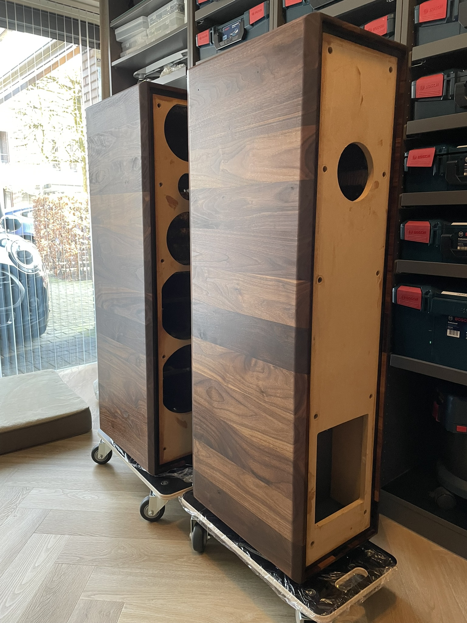

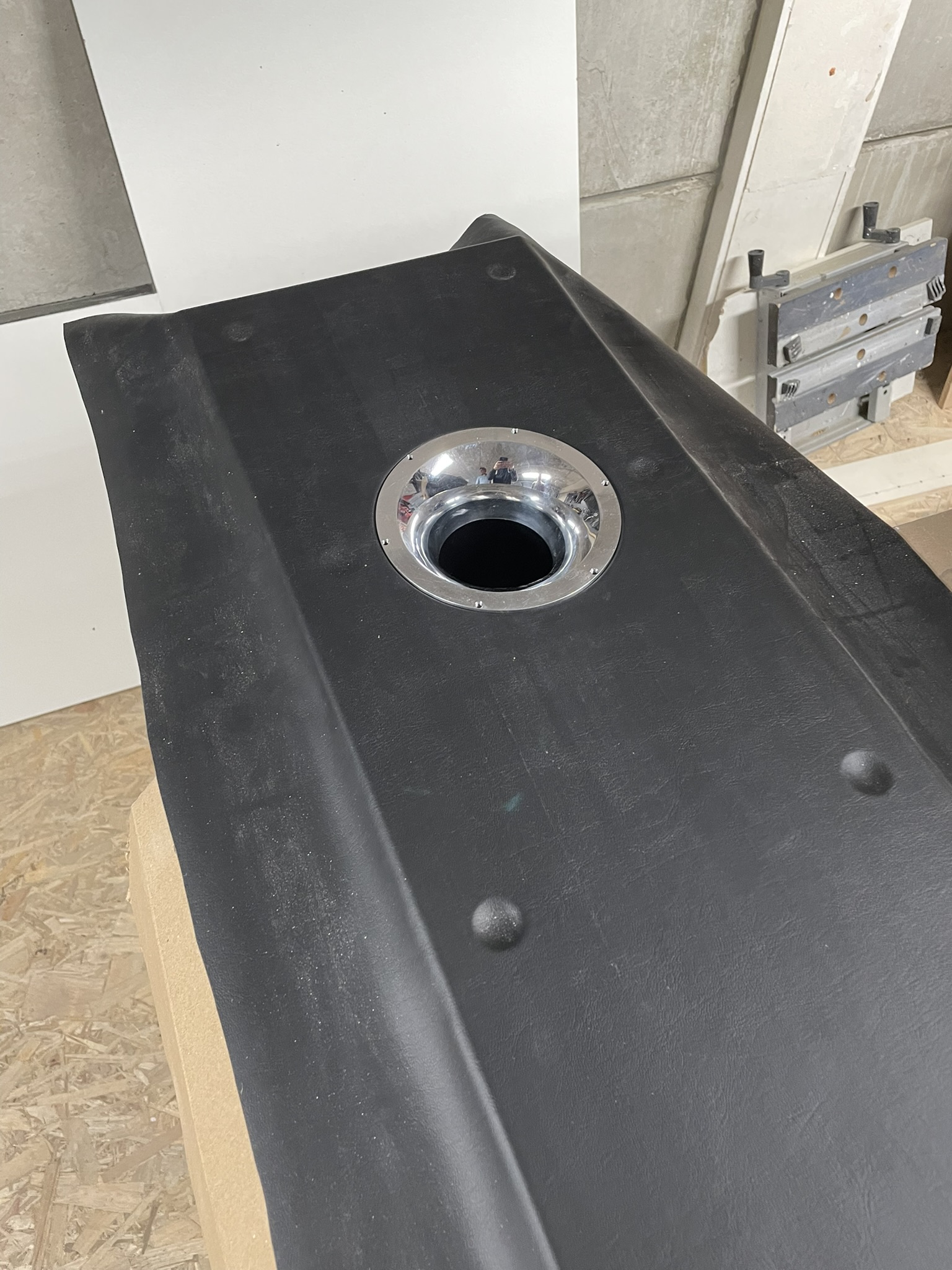

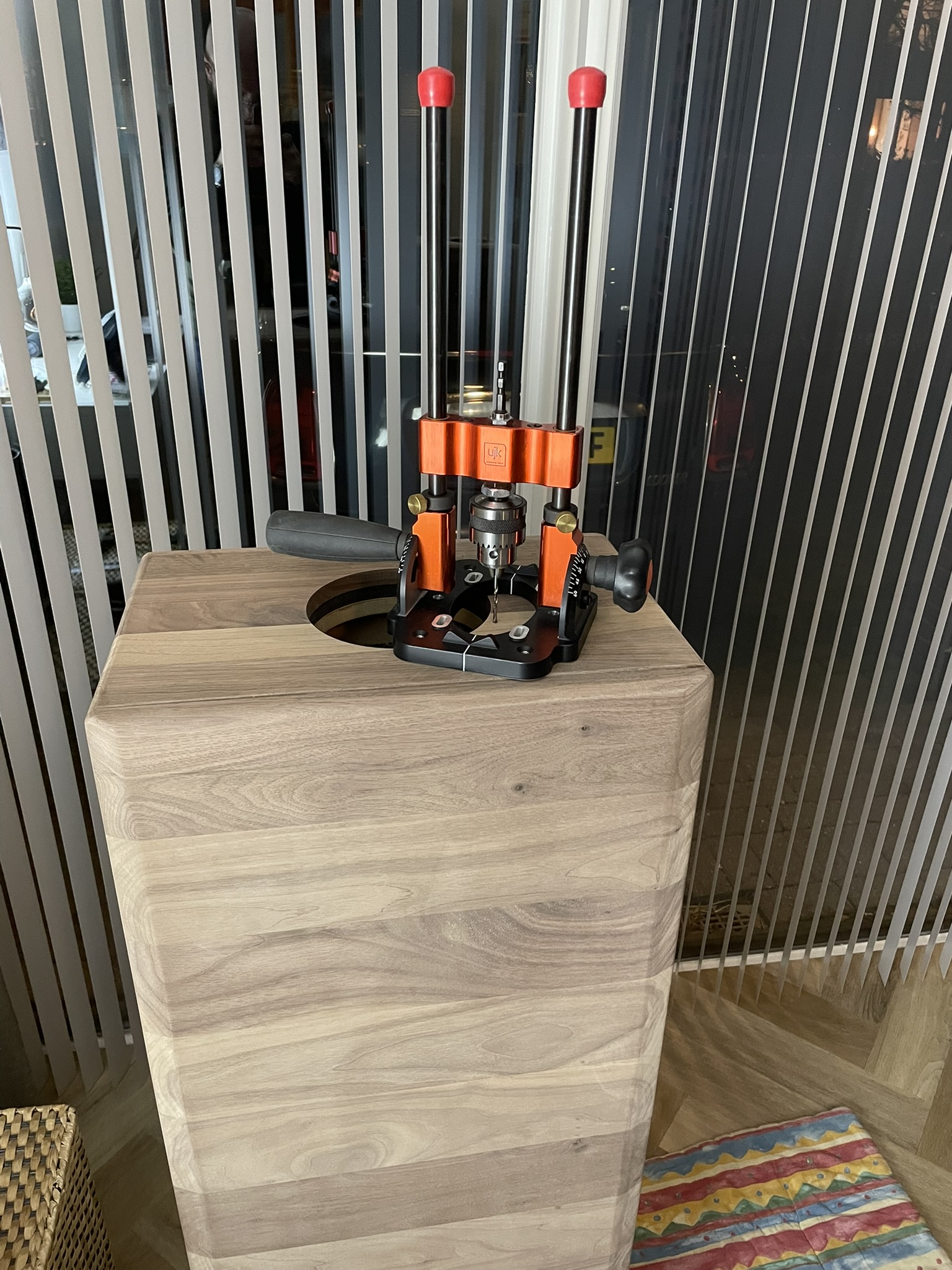

adding two layers of bituminous over the MID port

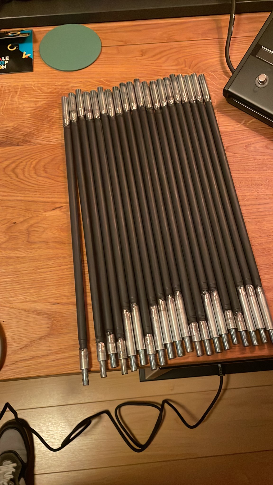

The tension rods welded and added 3 layers of heat-shrink tubing.

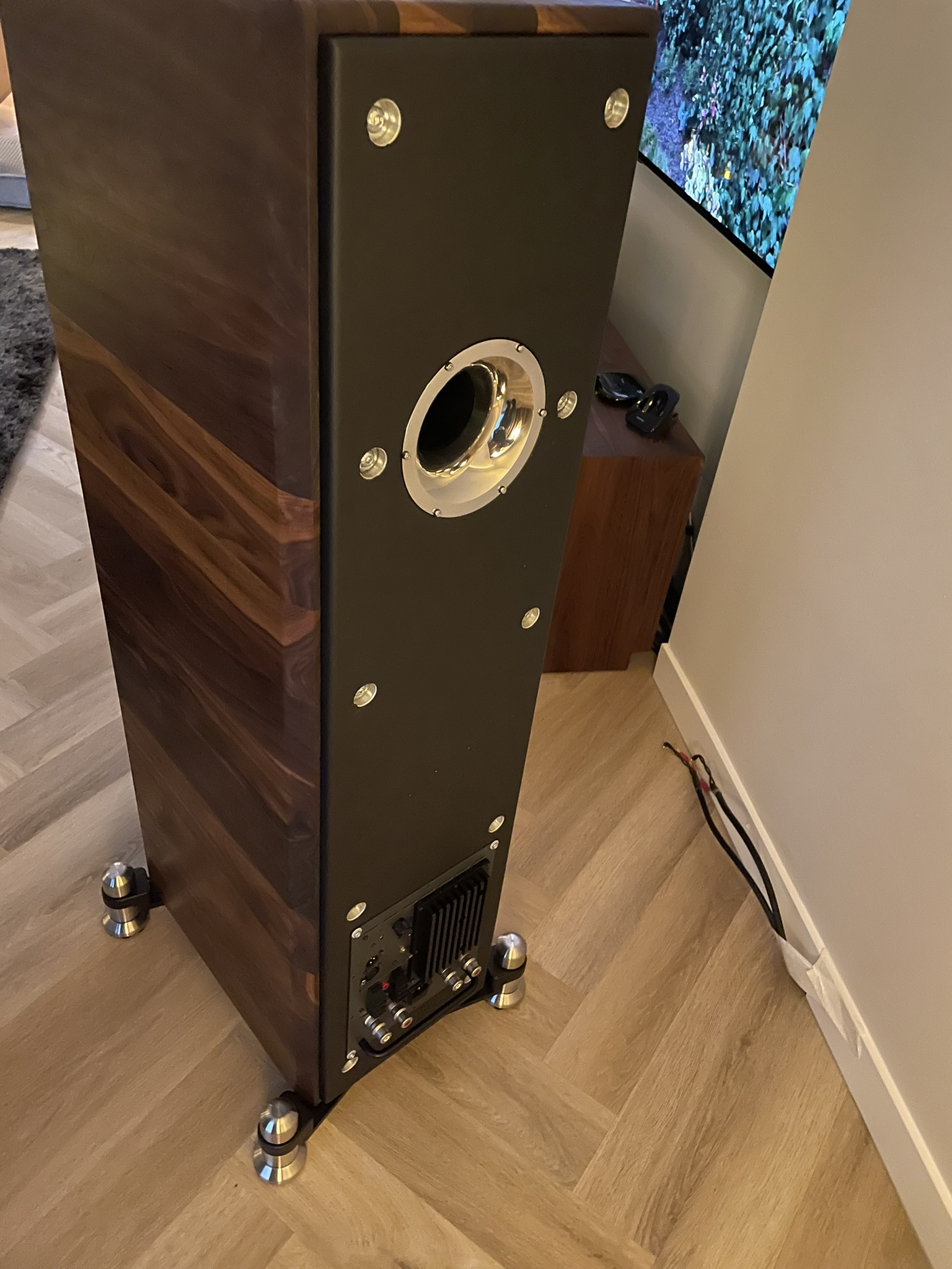

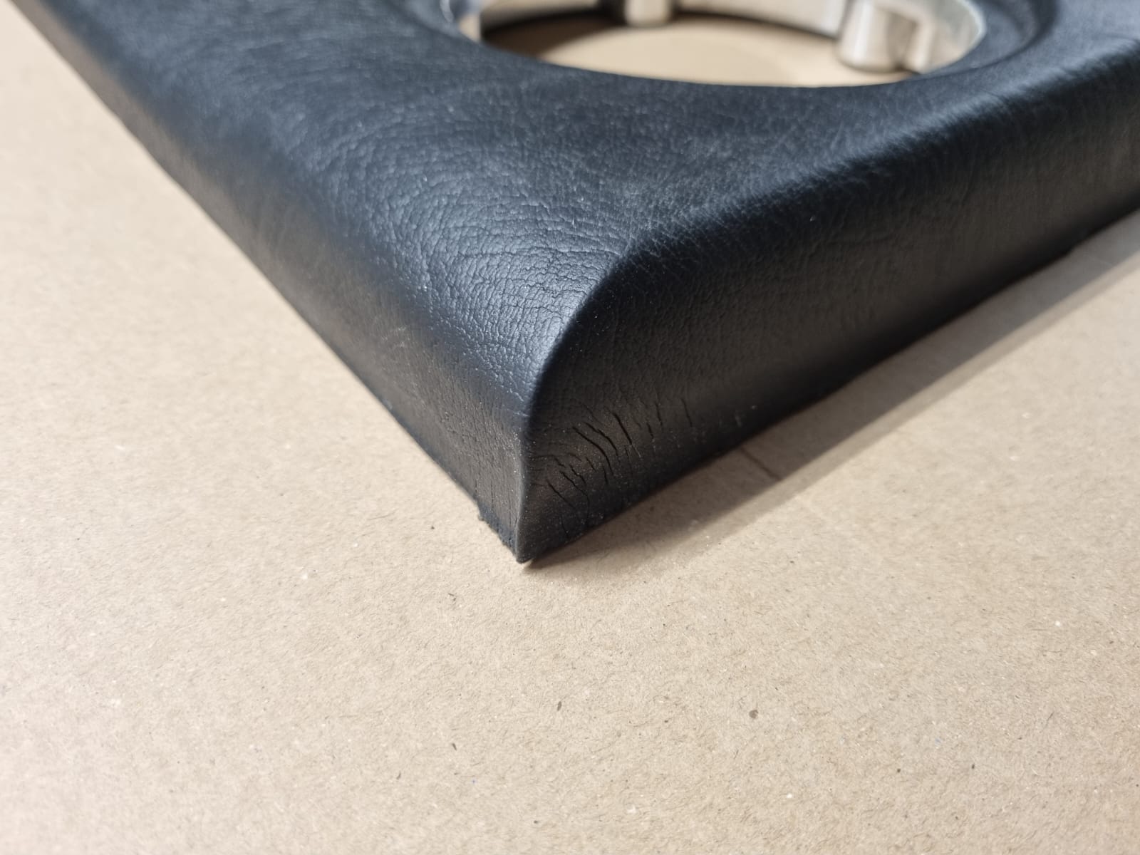

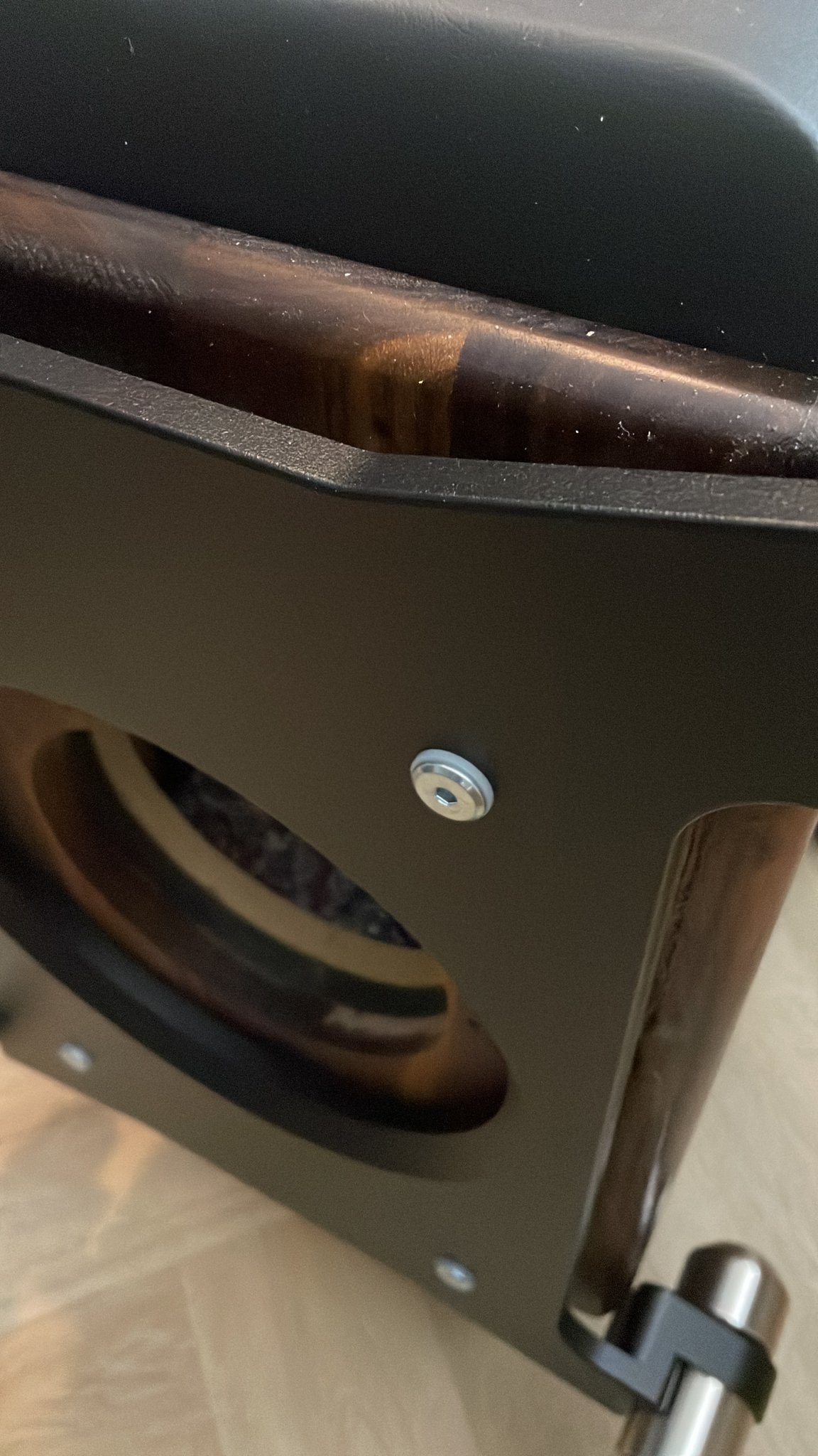

Adding letherette to the rear panel, and fitting the mid port flange.
So the last tasks are putting the speakers in a protective enhanced Tung-Oil and adding leatherette to the aluminium front panels.
And then start mounting it all together so the tuning can start
Take care
Peter

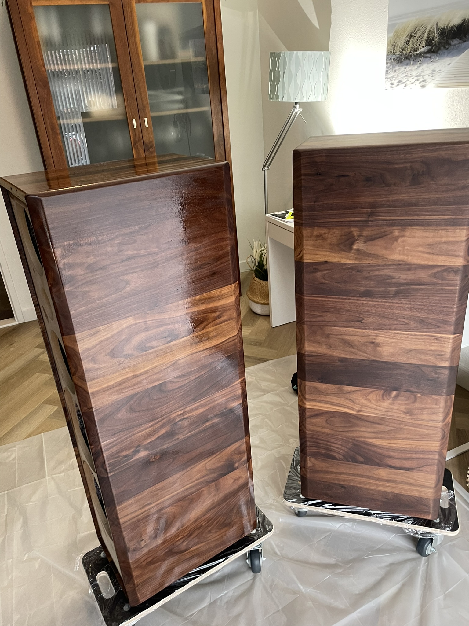

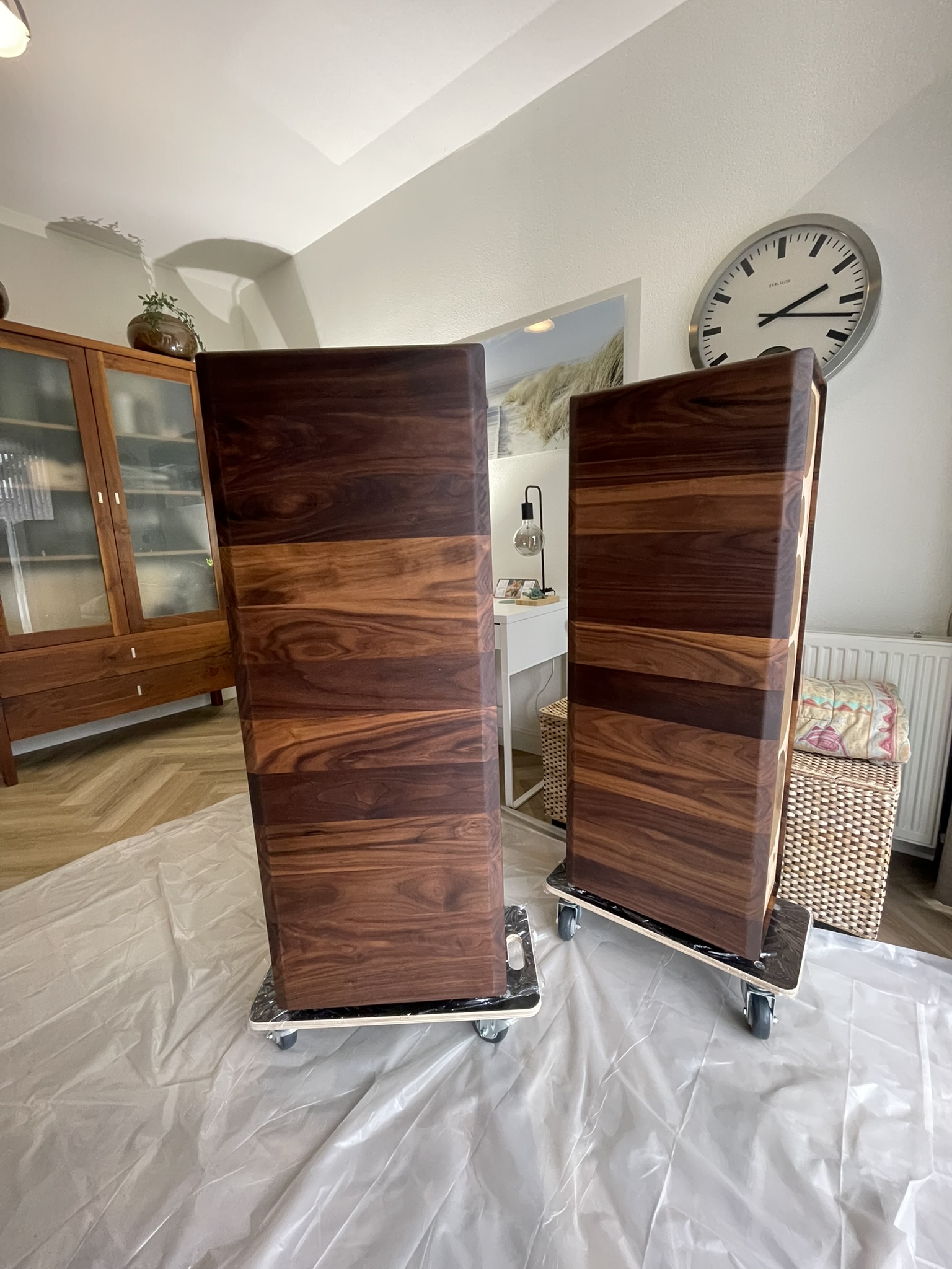

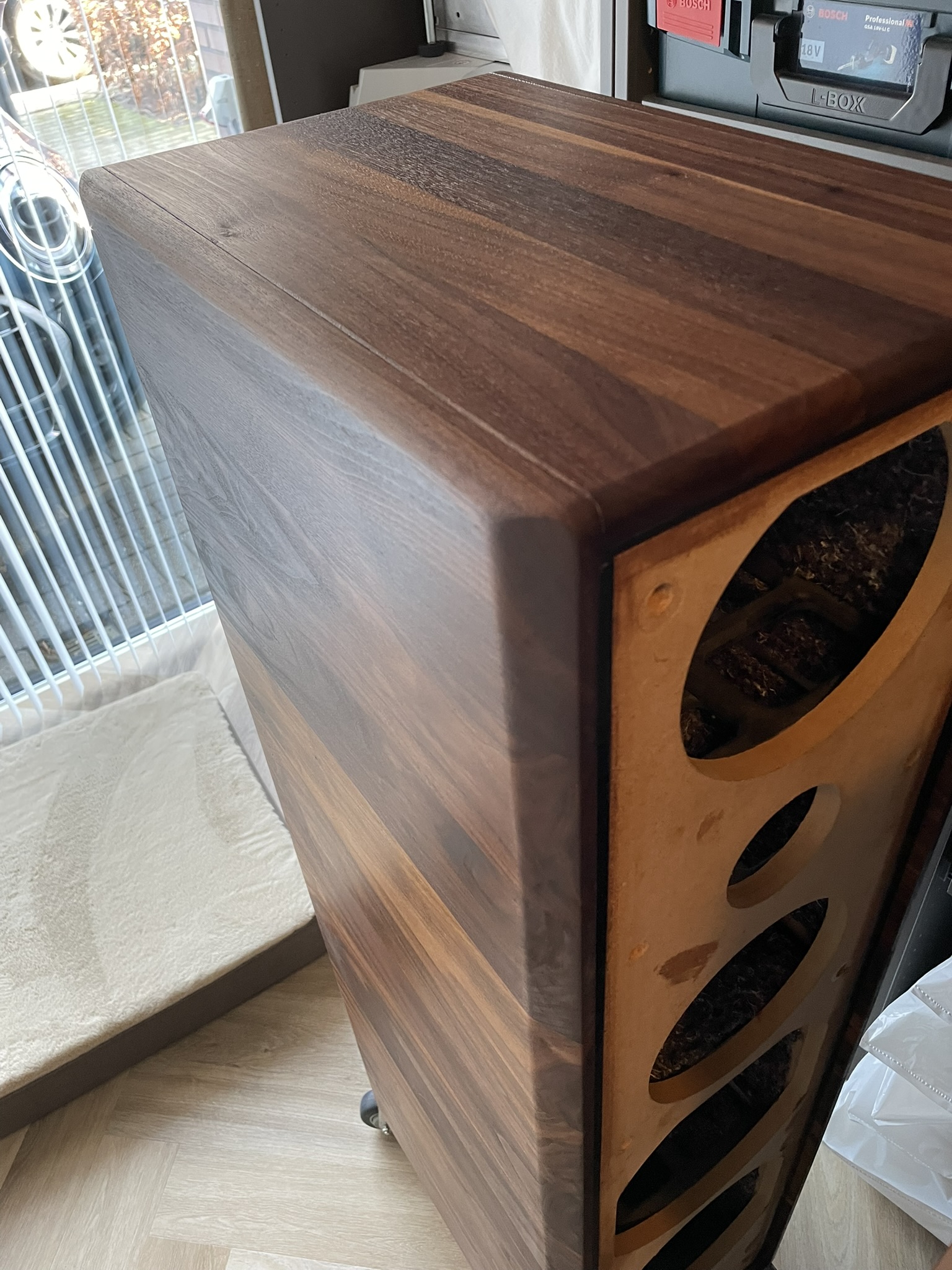

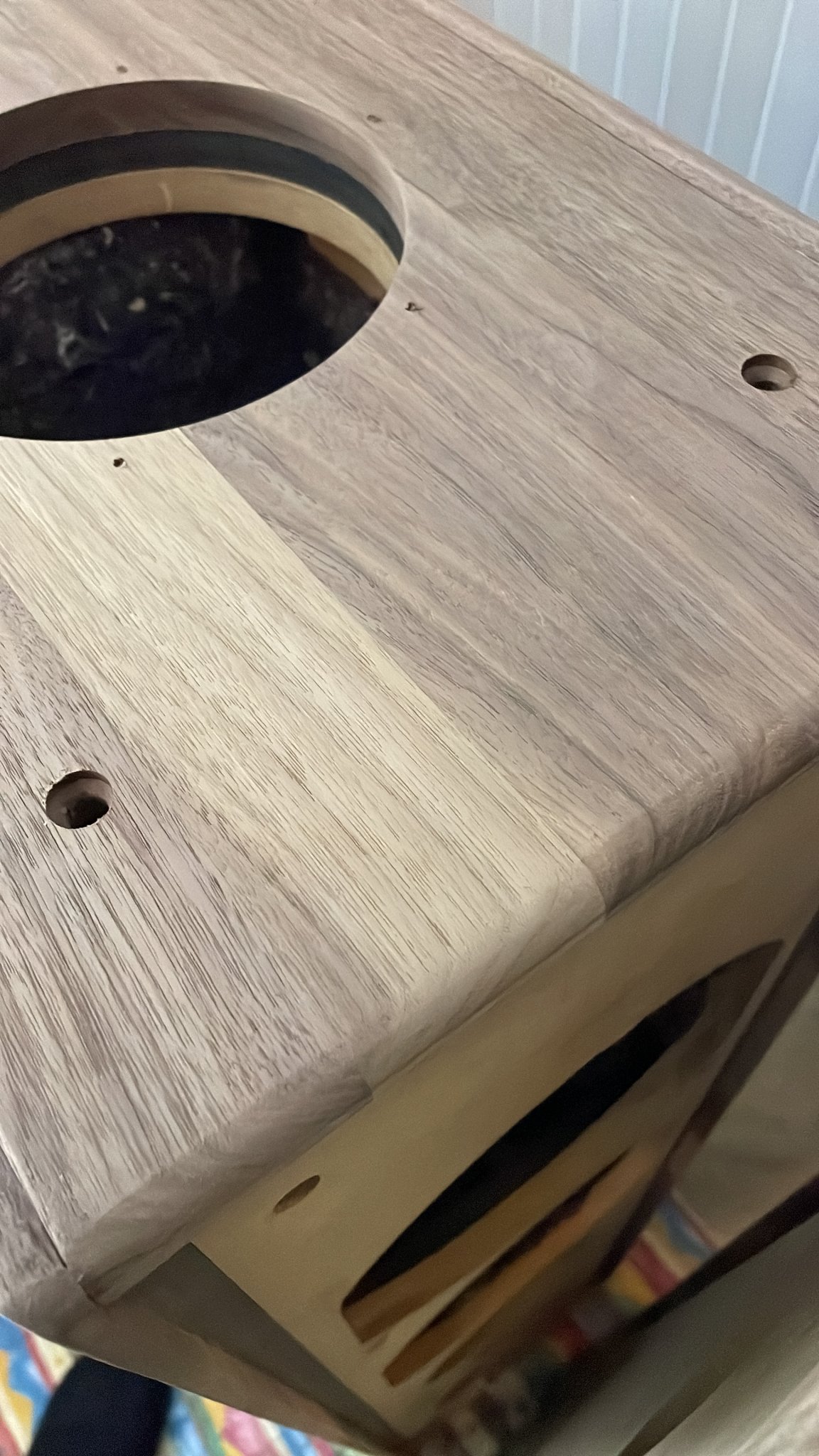

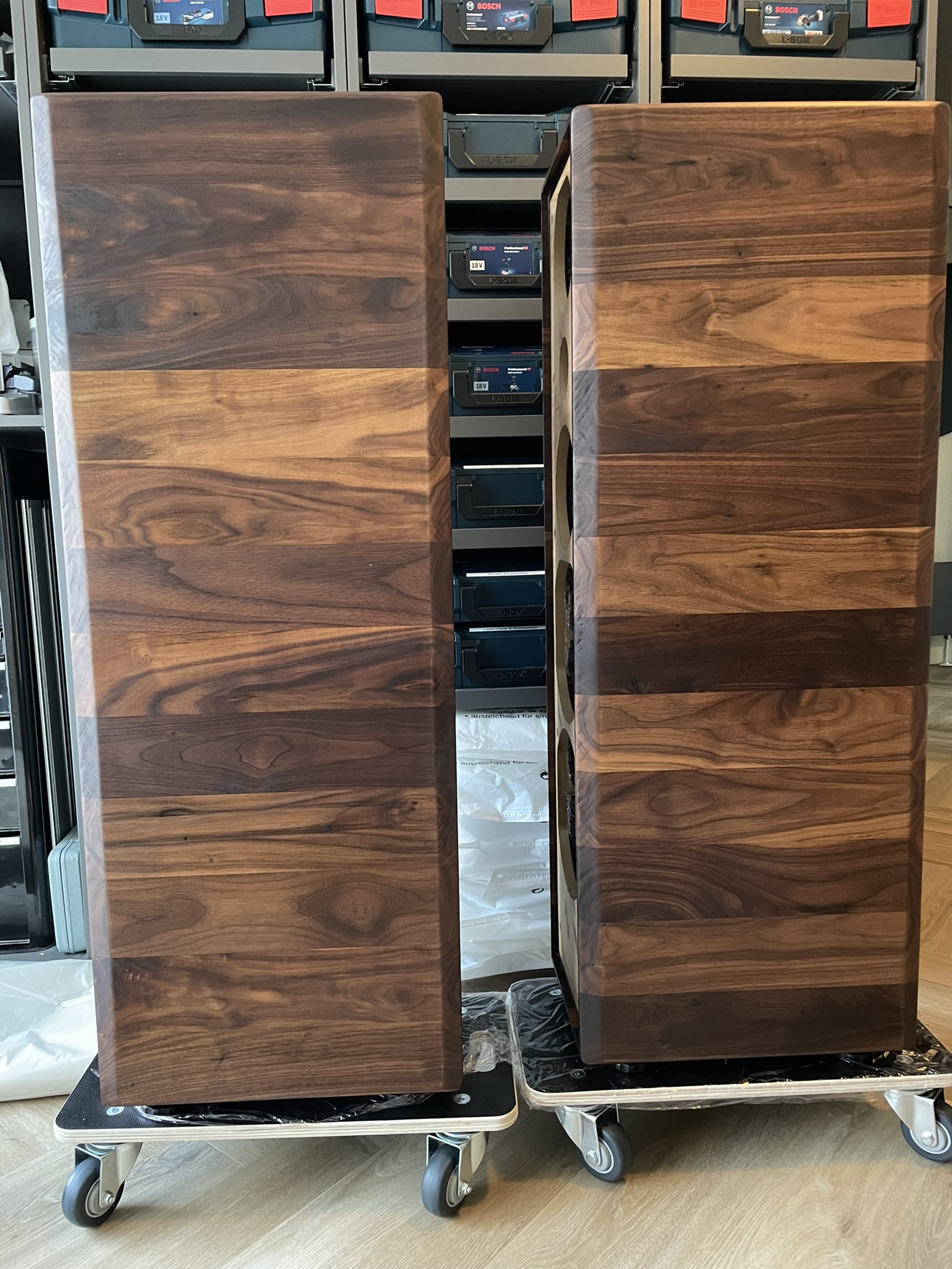

So after a thorough sanding up to 320 grid, another oil layer and another layer after using a scouring pad I think the enclosure is okay.
before left and after rubbing the excessive oil off ....
the second layer of oil

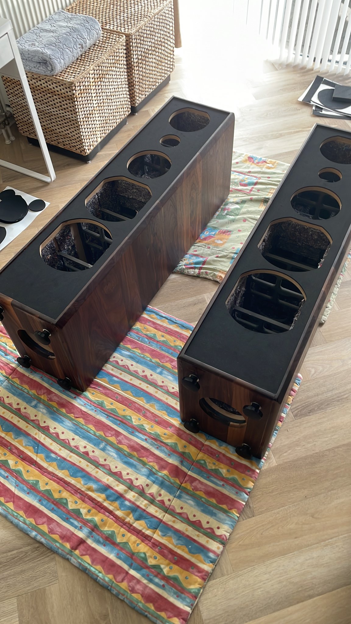

and the final layer of oil.
next is finishing the letherette cover of front and back, and mounting them with the ten M8 rods to the enclosure.
Cheers, Peter

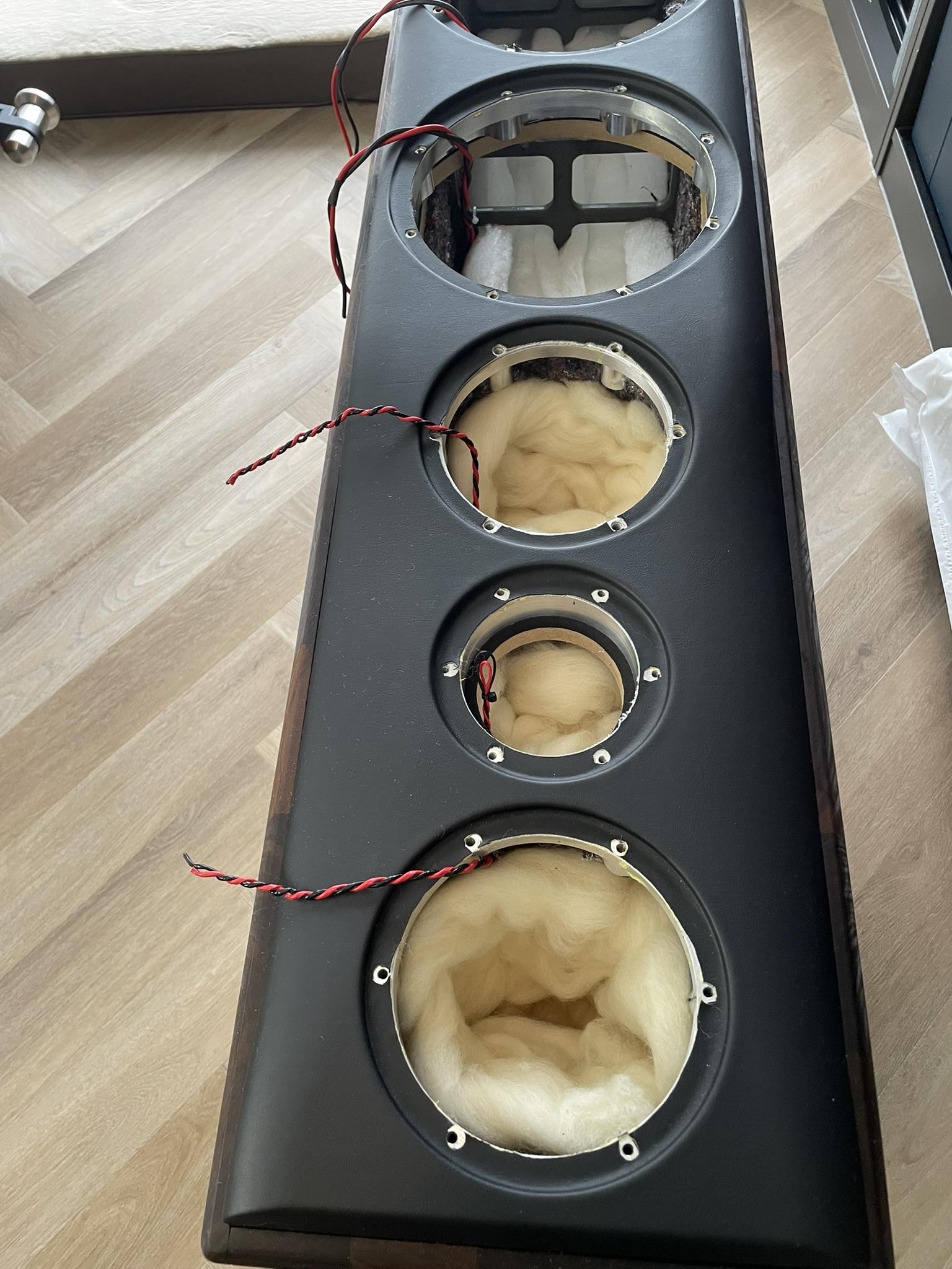

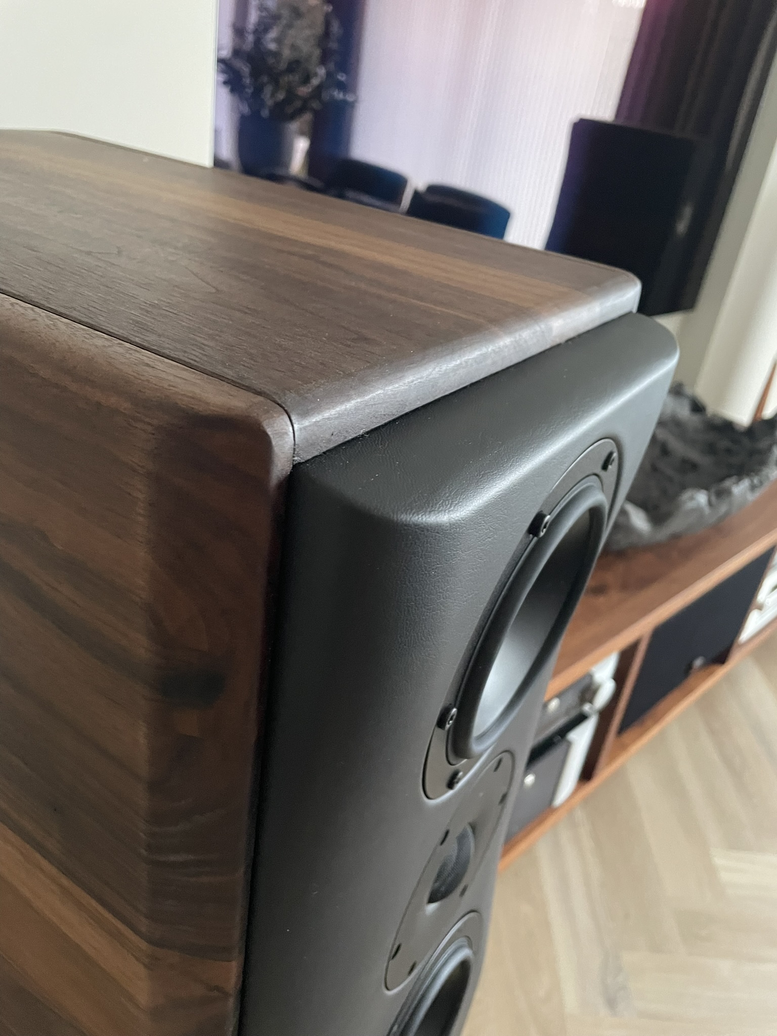

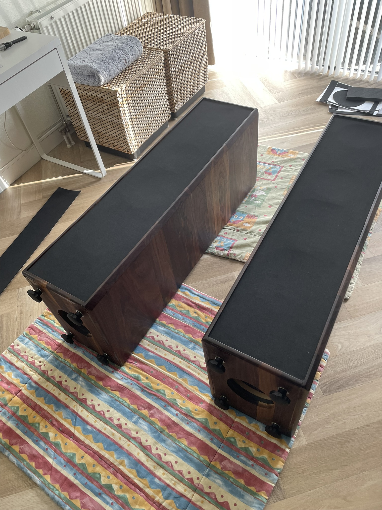

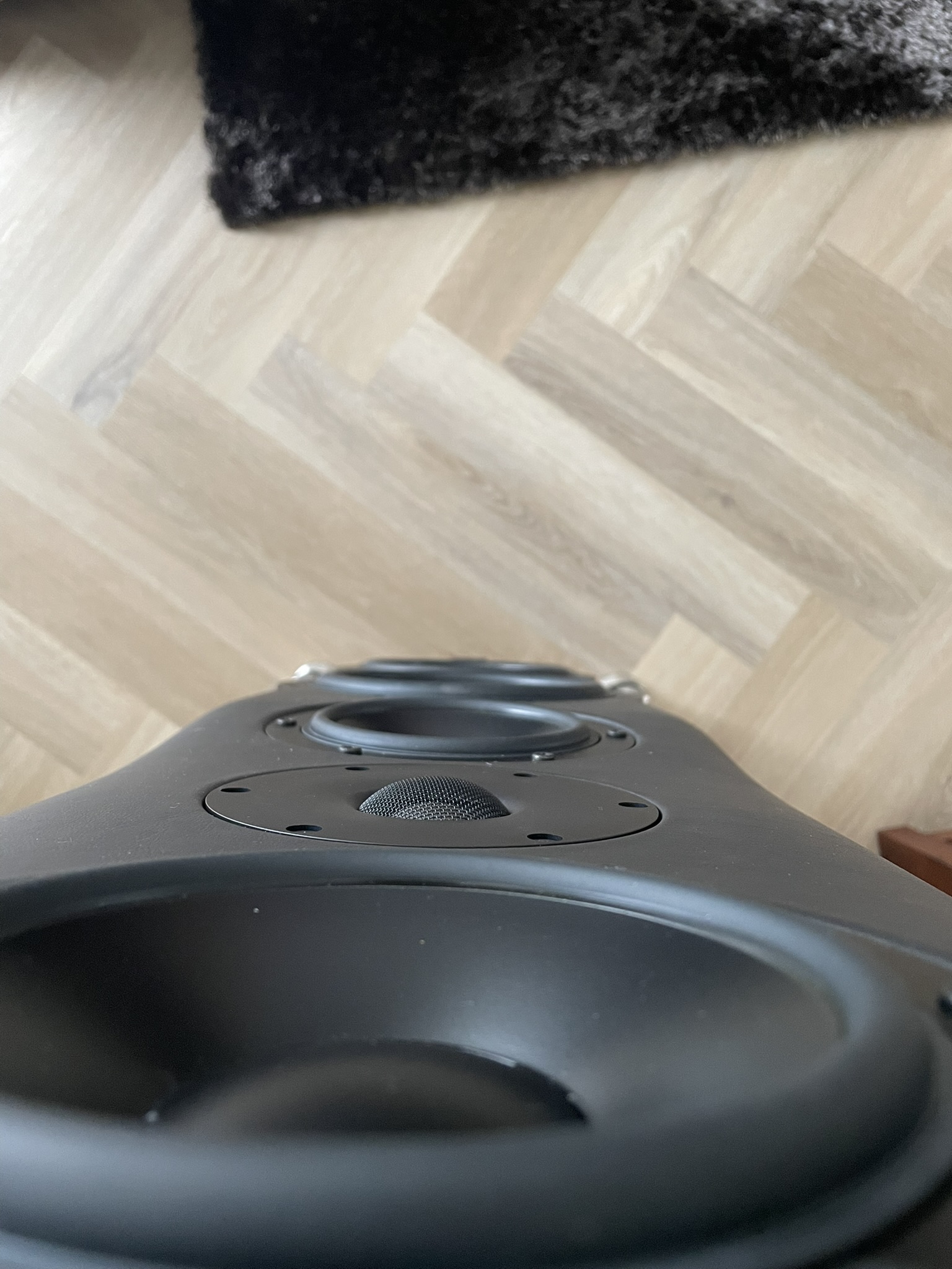

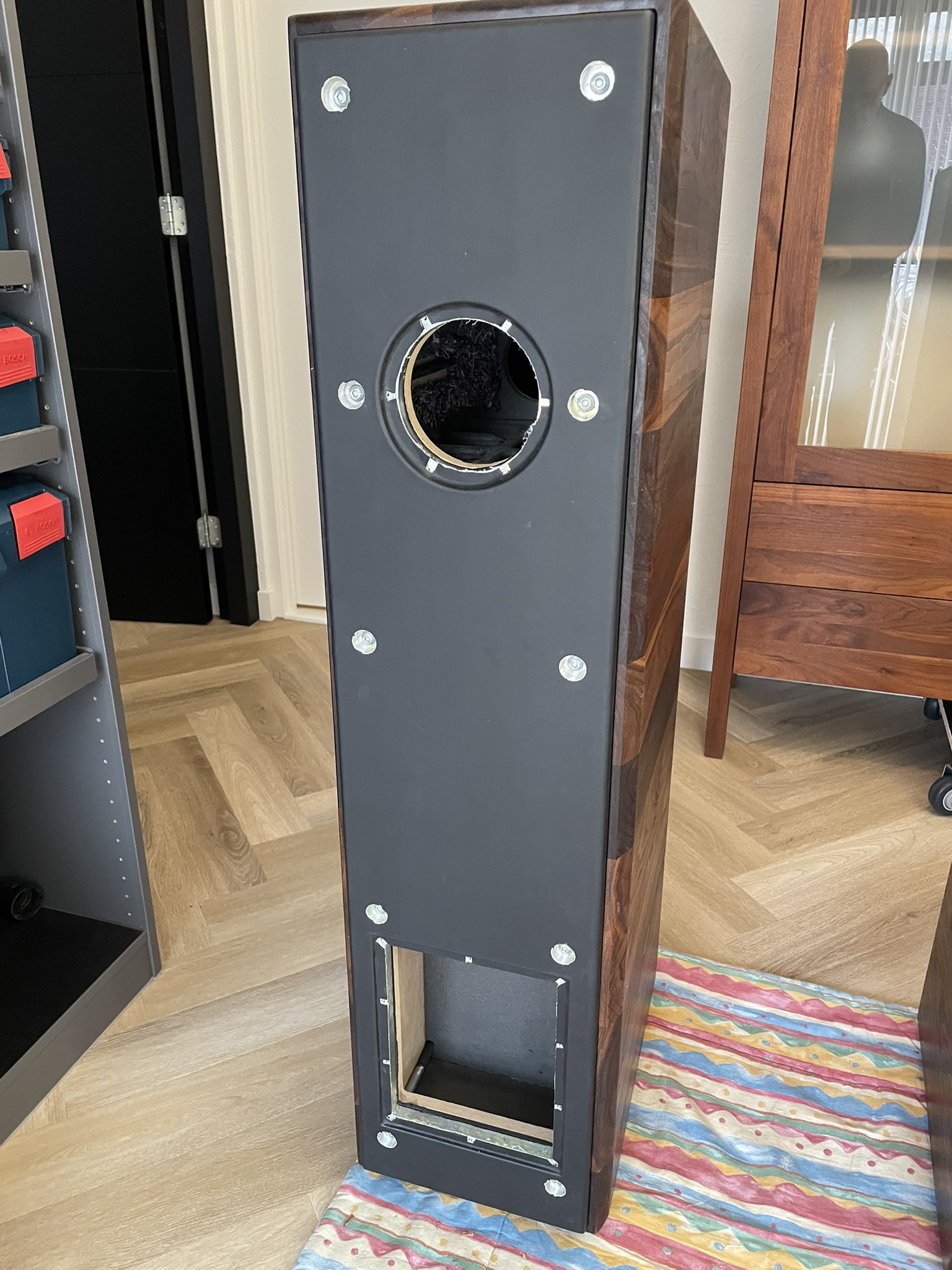

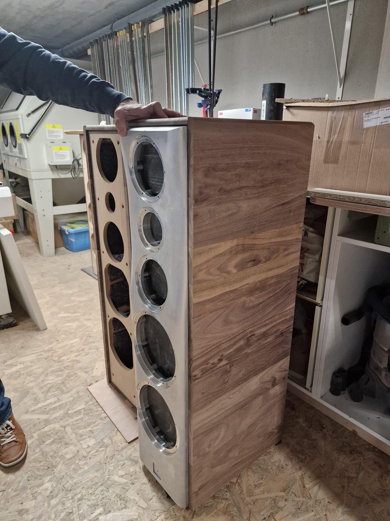

Hi Forum, some nice progress has been made this weekend.
The front and rear panels are covered in letherette and some assembling can be done.
We decided to go for an extra layer of open cell EPDM between front/rear and enclosure.
3mm layer of EPDM that can be compressed upto 1mm

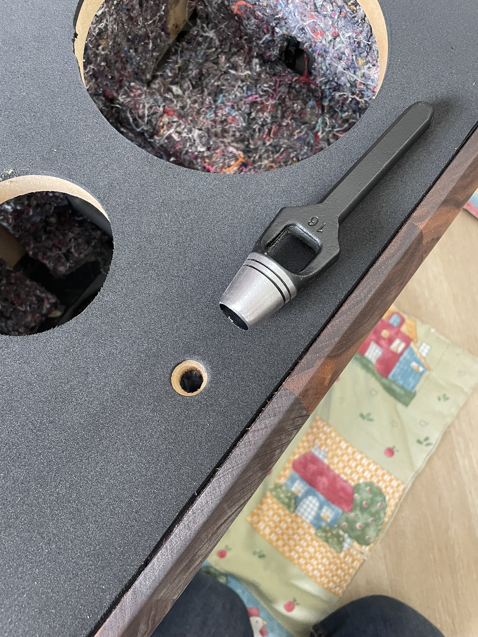

Cutout the holes

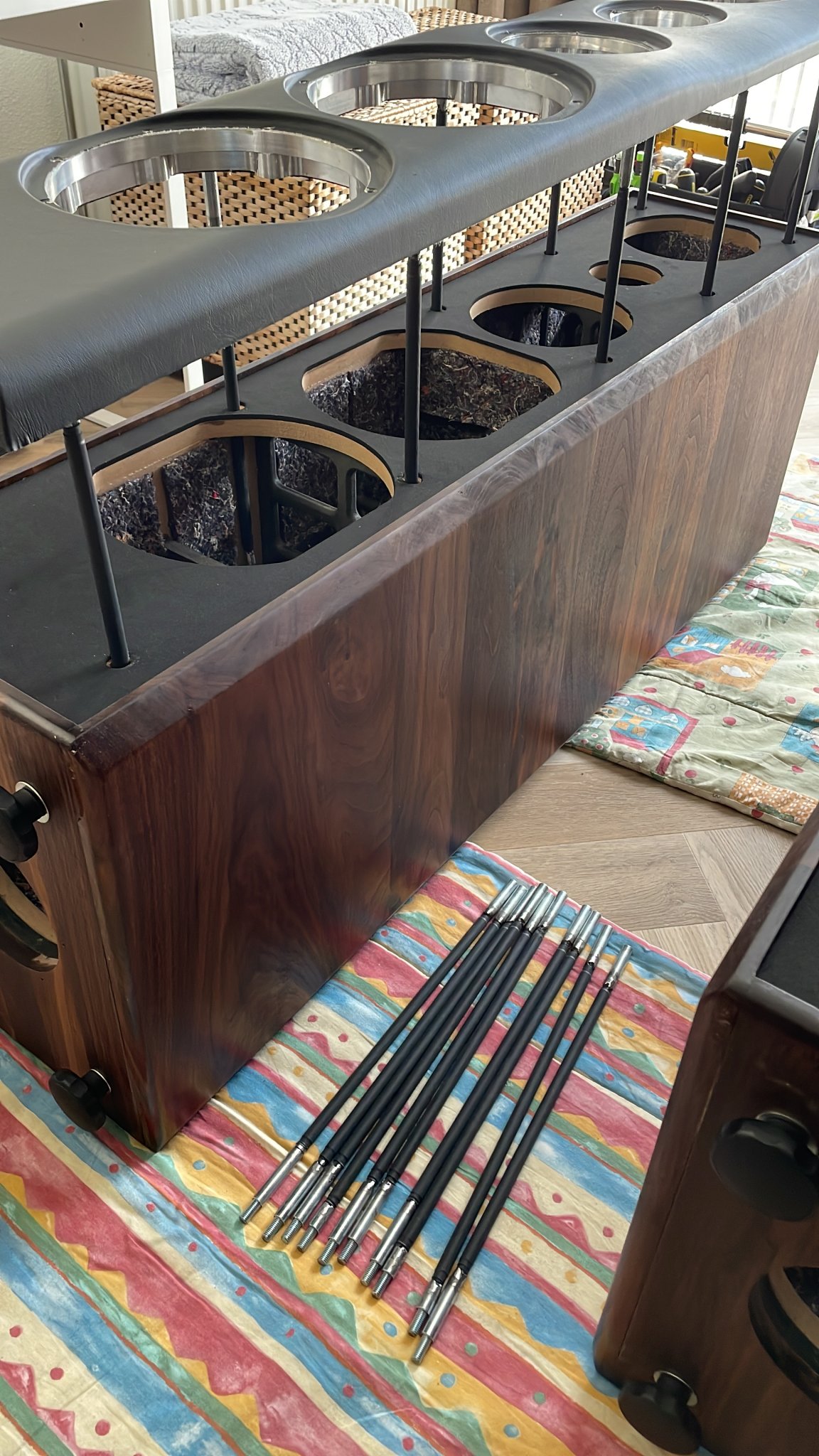

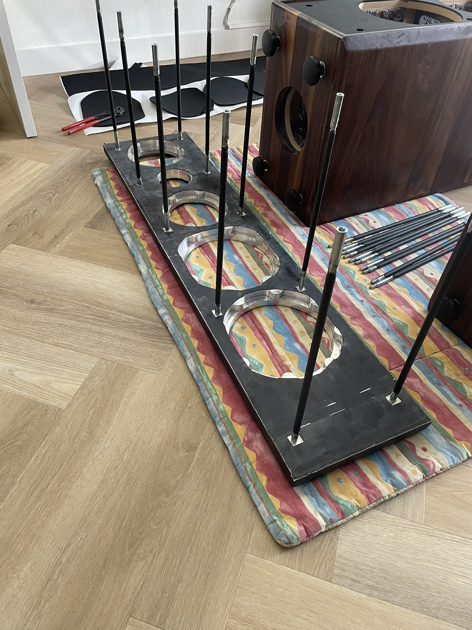

adding the metal rods to the front baffle
Wiggling the 10 rods trough all holes and compartments
Mounting the rear with M9 bolts
Close up of front, and all the layers

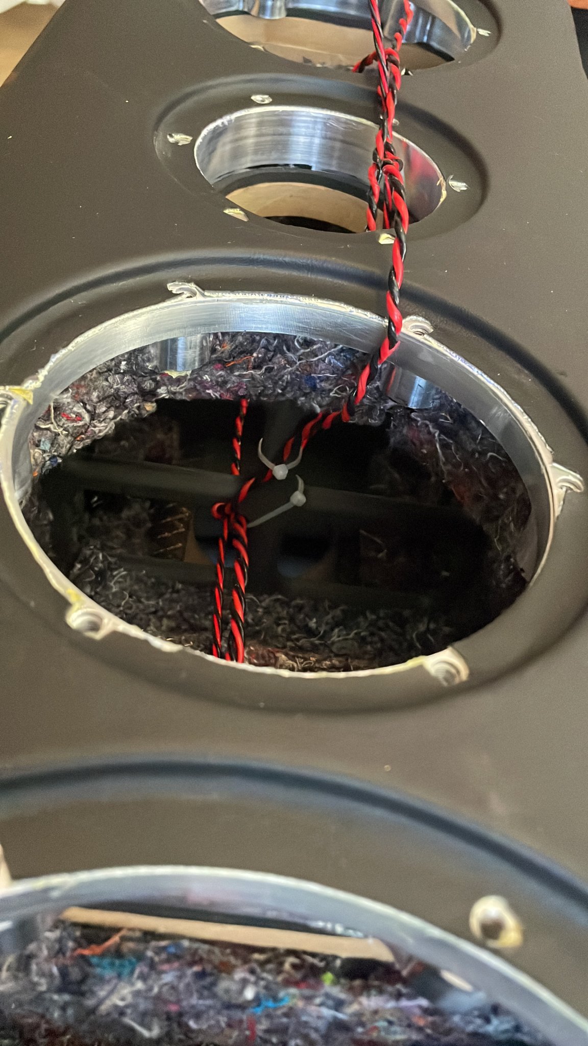

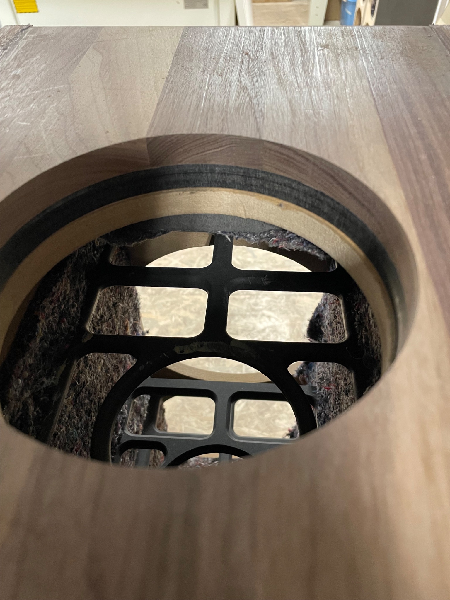

The inside of the midrange with added felt
The mid and HF cables are in, and I used some boat-kit to fill the holes where the rods pass the midrange part of the enclosure.
The weight is now around 80 kg. when de base and speakers are mounted I expect 100/105 kg.
Peter

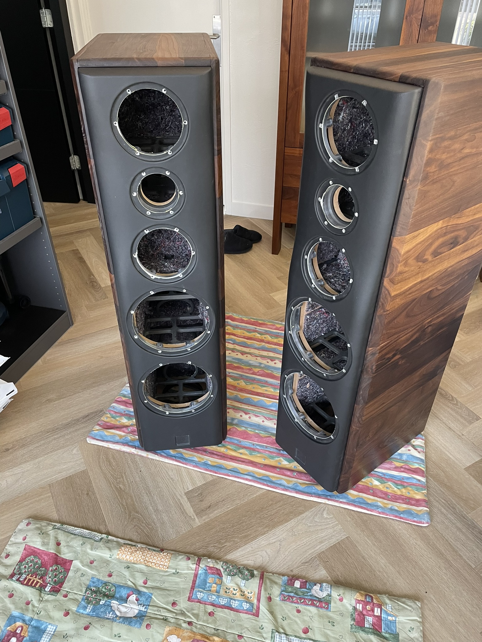

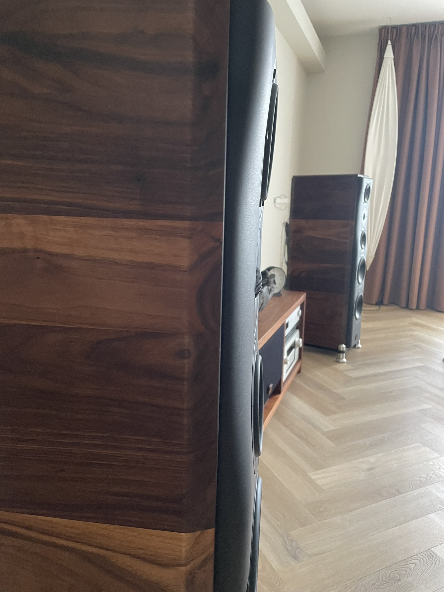

Dear forum, the speakers are finished, the tuning can start....
Latest building pics:

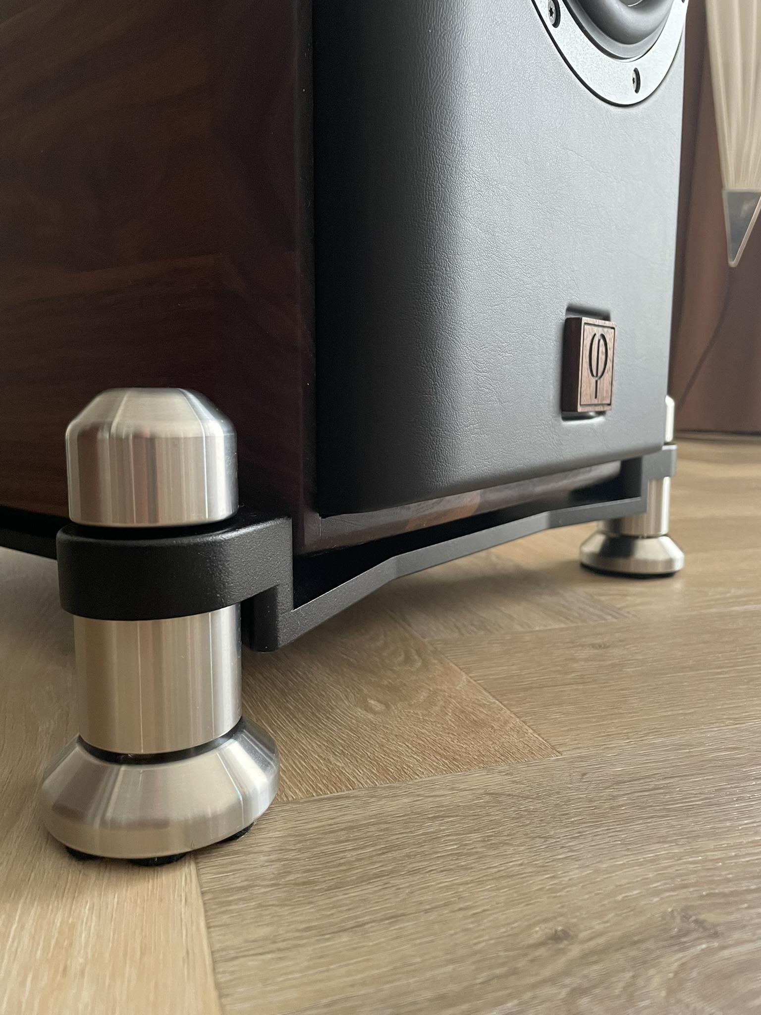

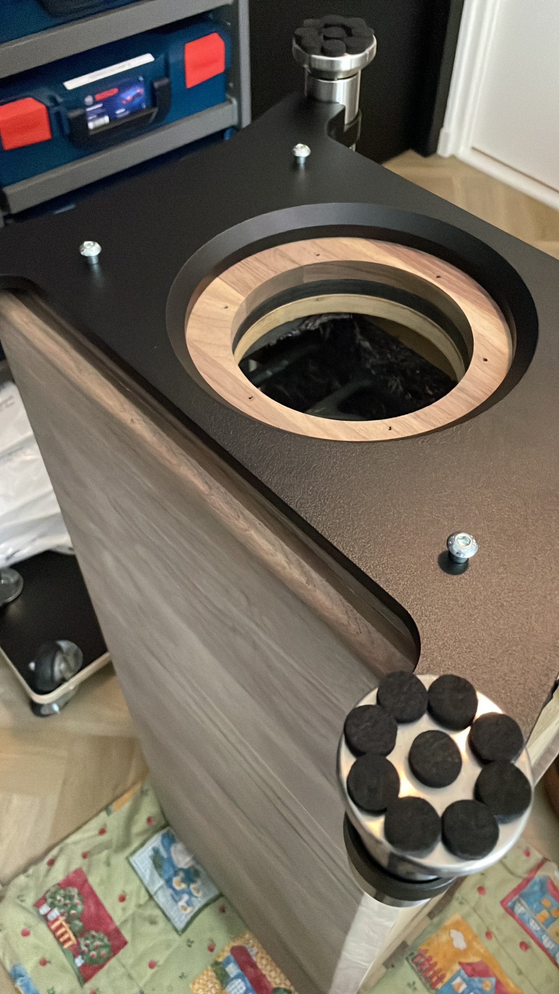

mounting the base
Adding a bitumen dampening to the underside of the port just touching the lowest brace so it can be removed for adjusting the length tuning
adding damping material

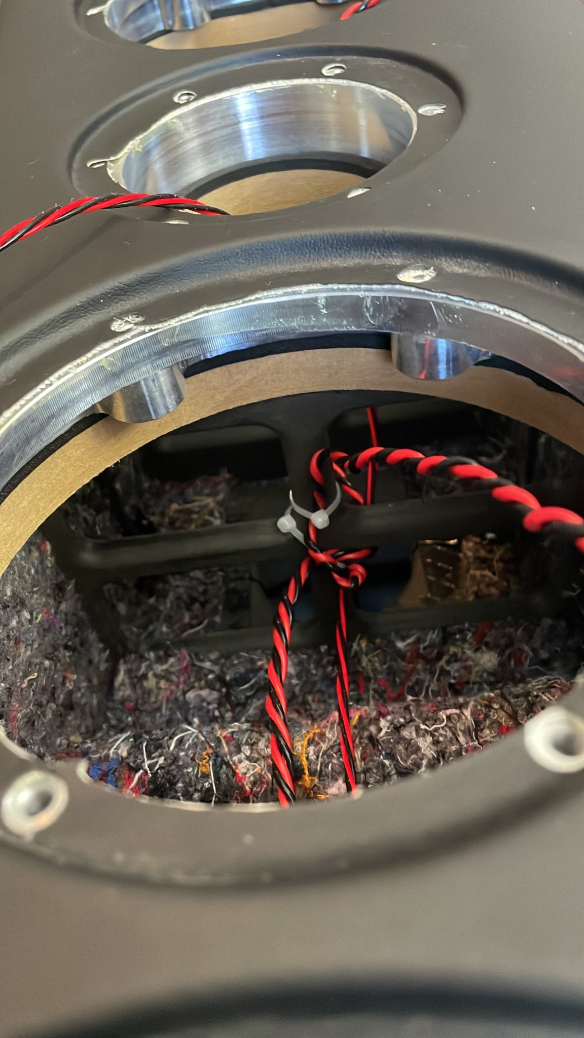

soldering speaker wires and fastening them with cable-binders

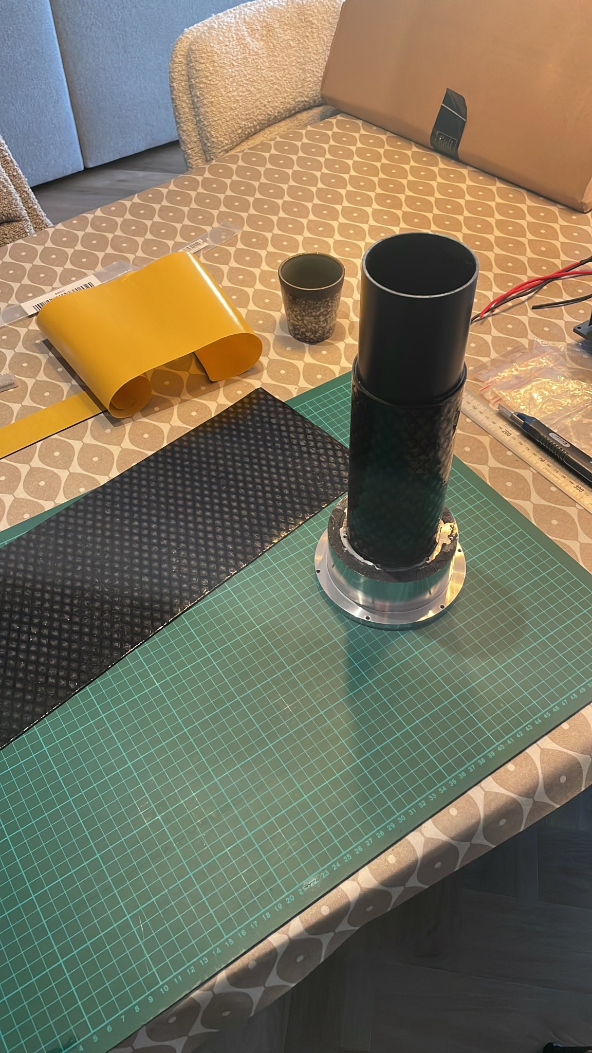

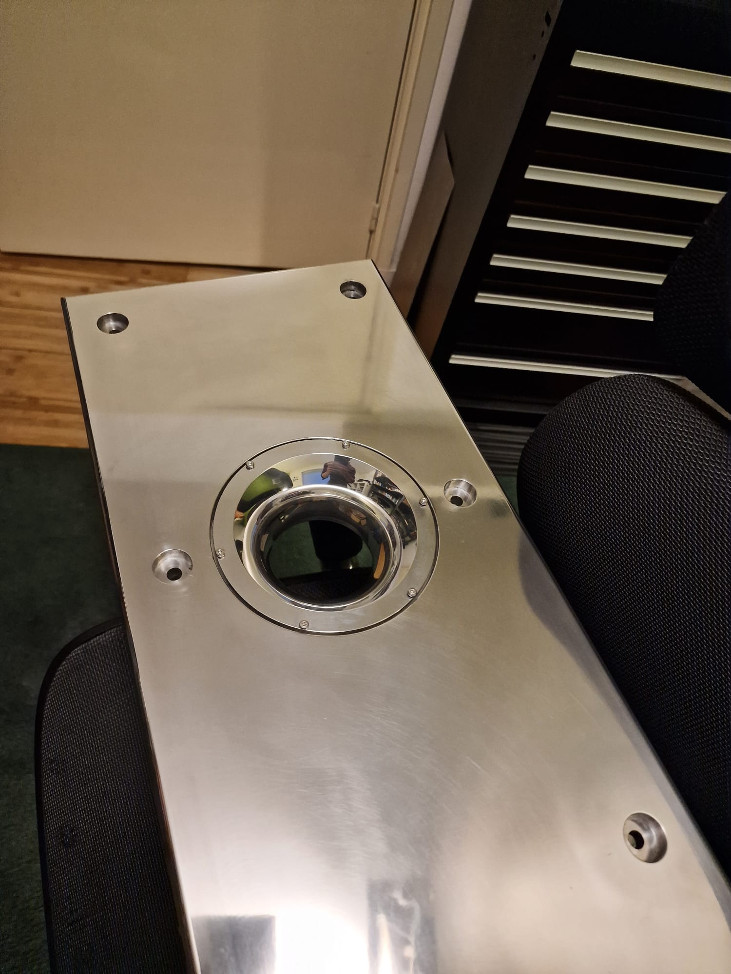

The midrange flange-port
