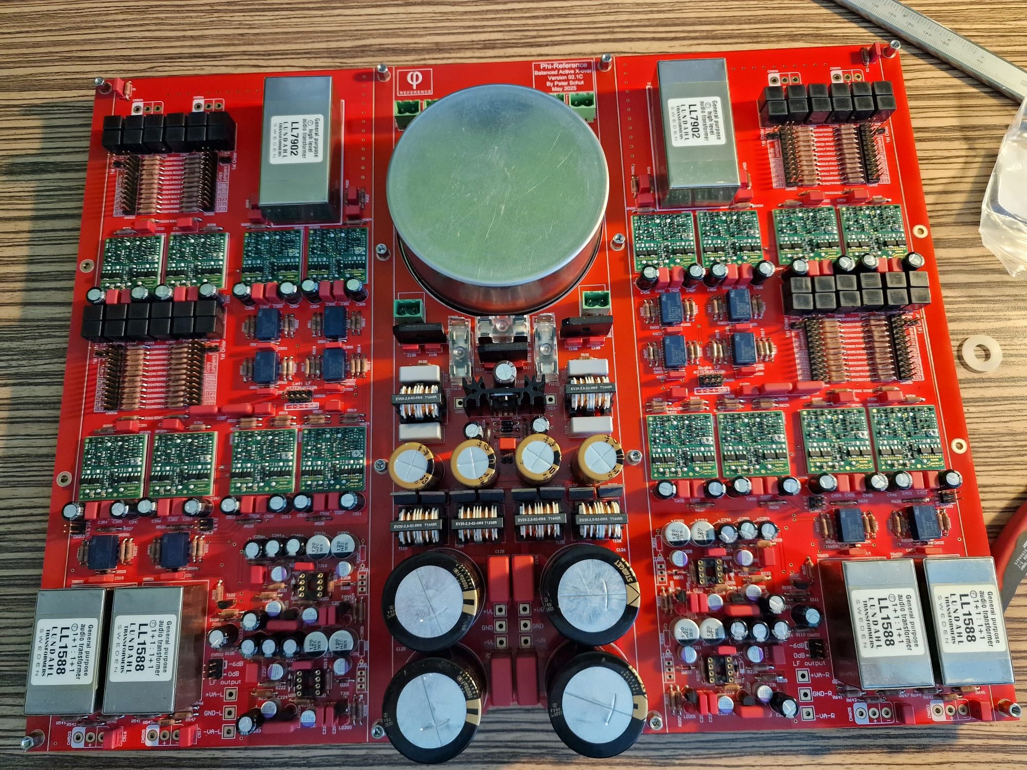

Back from a business trip (and still a -9 hour jet-lag) I changed the setup to use the Moon Audio W8 amp to power mid and high and relying only on the MiniDSP HP filter at 162 Hz and the temporarily passive MF/HF section. The Hypex DSP is set to 162Hz LR 4th order LP as well.
Again an improvement as the Moon has more control and is even more silent, and I can use balanced connections.
I modified the filter a bit to remove a small wide dip at between 3k and 8kHz and levelled the LF to MF/HF again as the Moon has a lower sensitivity than the 4 channel NAD.
the difference in gain between the Hypex and Moon is still 7dB. So I my new analog discrete HPF will have a 12dB higher gain in its LF (pass-through buffer section) output.
A 4 stage attenuator will allow for attenuating the LF output in 1 dB steps to -15dB so it can be adjusted to level for future amp gains.

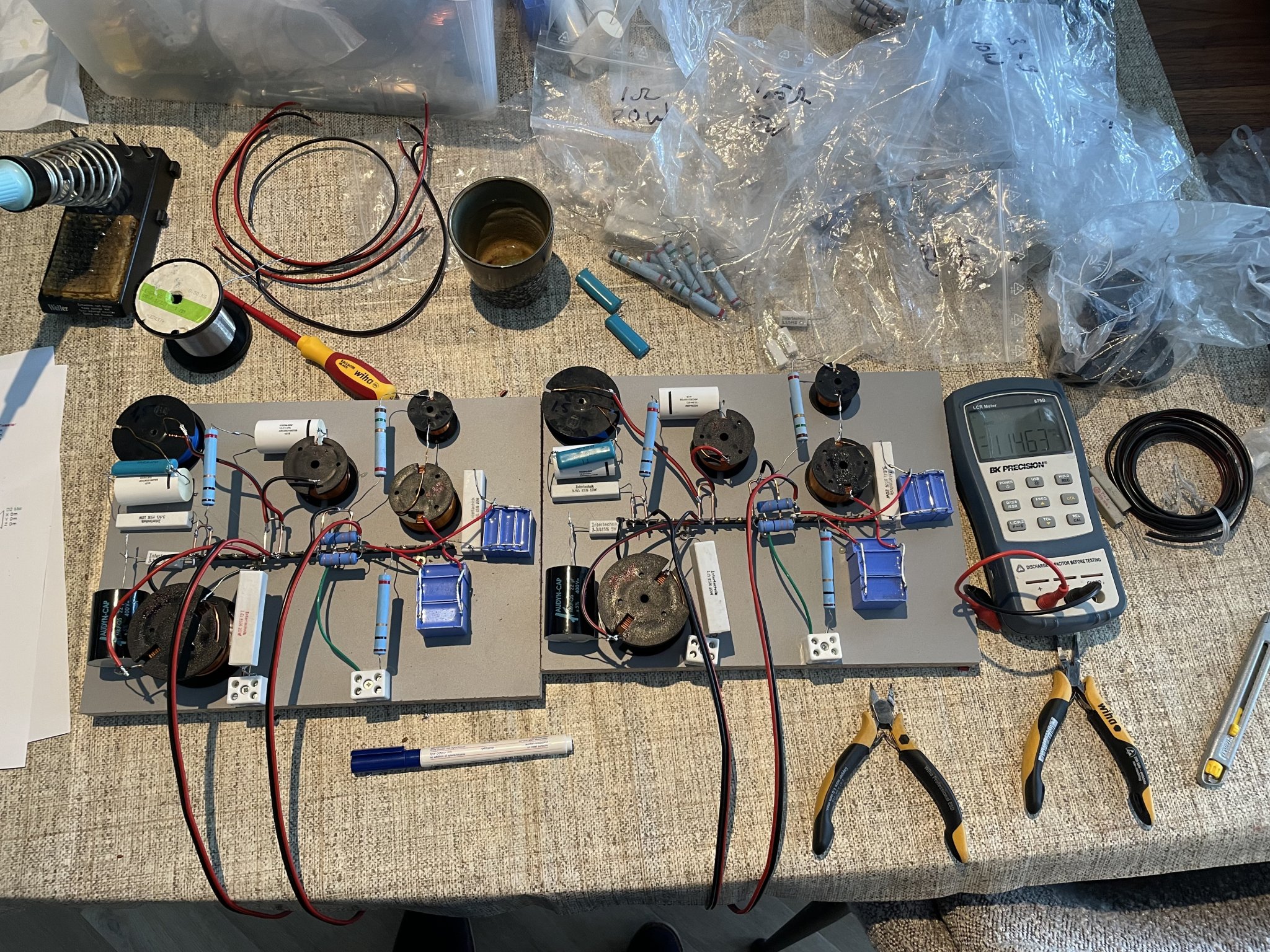

Still working on the filter.
My friend Joost and I still have a different inductor for the LPF of the midrange. But my temp filter gets the same results on his speaker as on my so something is different in his spiderweb version compared to mine.

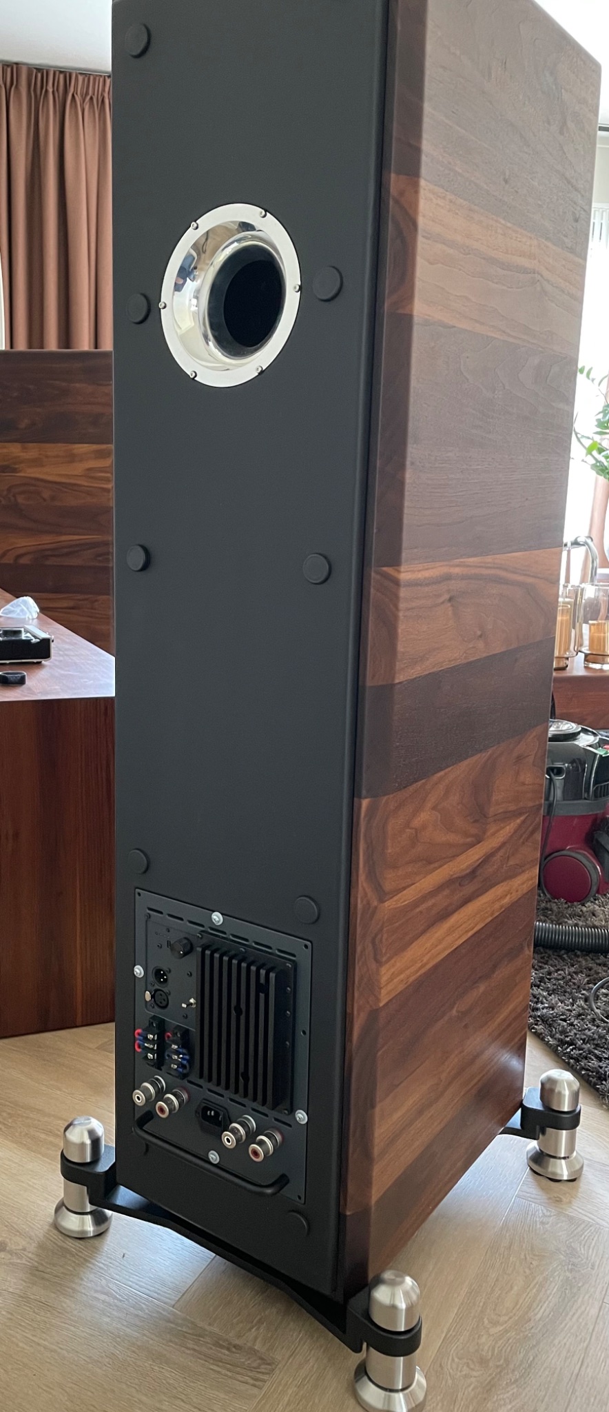

But I still owed you a picture of the back.
Here it is
Have a nice Easter Day

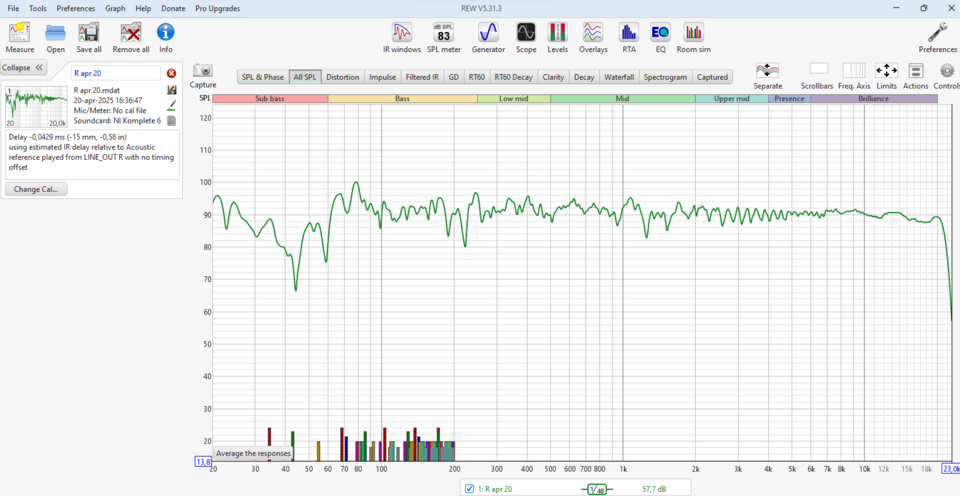

Oh and I bought a mic level calibration device that gives a reference tone of 94dB when you mount the microphone.
The system sits at about 91dB @ 2,83V

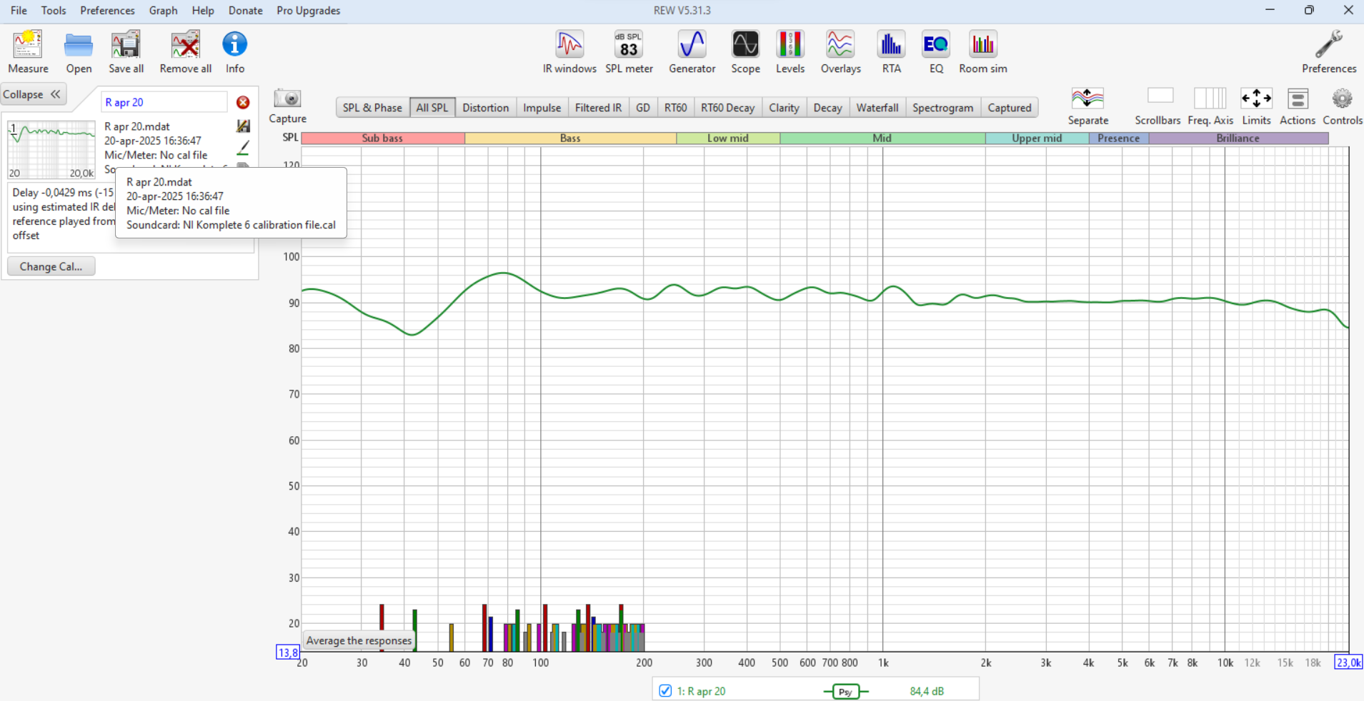

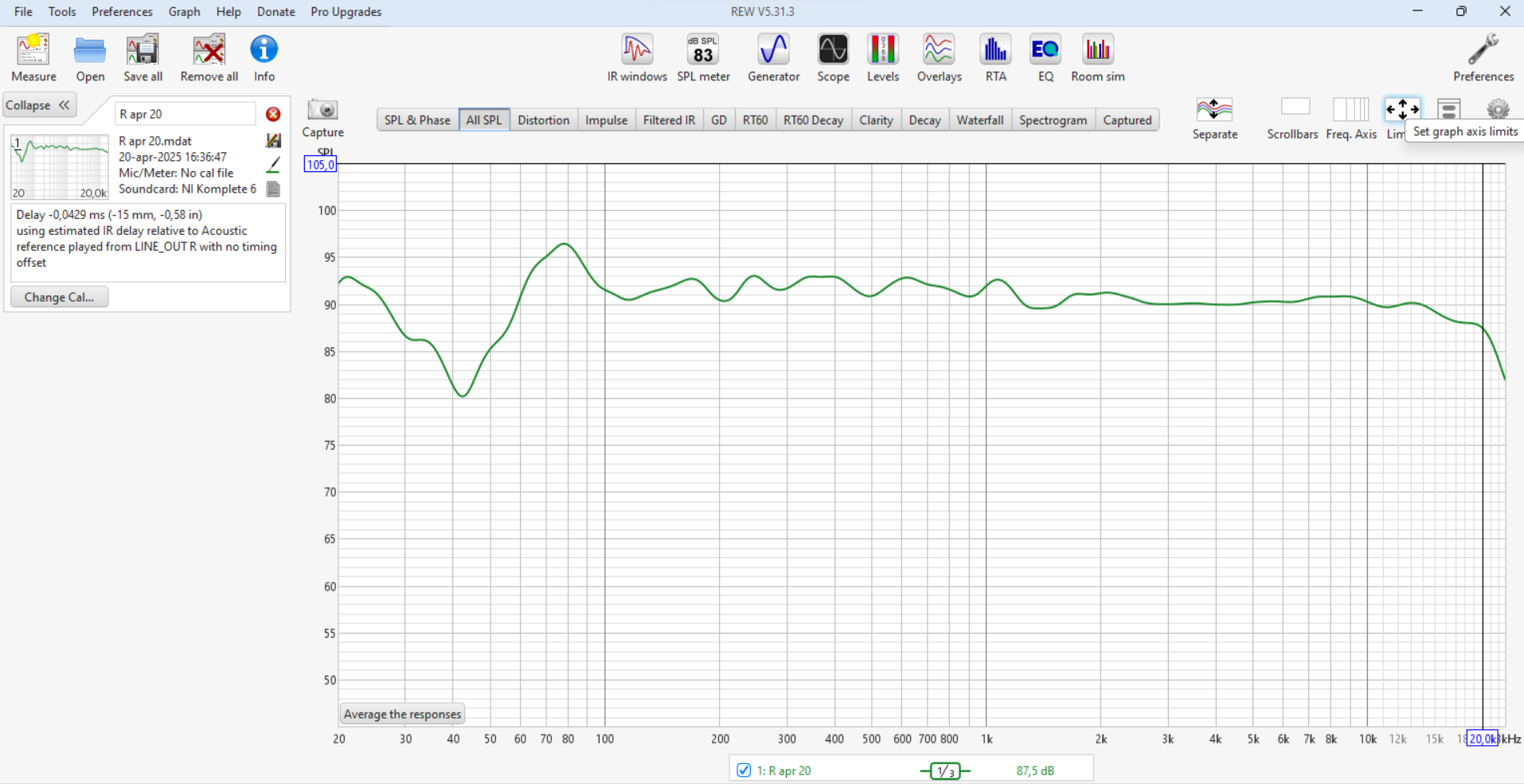

This the curve with the filter I made of left-over passive components.
The Hypex is an LPF of 24d/Oct at 162Hz, the Mini DSP is just a flat HPF 24dB/0ct at 162Hz both Linkwitz-Riley.
Measured at 1m at tweeter height. Below 200Hz this measurement is influenced by the room modes and do not say a lot.
I will try to combine it with a nearfield measurement,
Still need to play with room correction FIR filter as I mentioned before that added a fantastic improvement at my friend's Joost setup.
Stay tuned.......
Nice work! I wouldn’t average 1/3d on measurements though. While at mid frequencies the resolution probably is determined by the gate, at high frequencies you miss quite some details like interference or possible resonances.
Hi Markbakk,
see below
Psycho acoustic smoothing (how we perceive the sound)
1/48th smoothing
see below
1/48th smoothing
