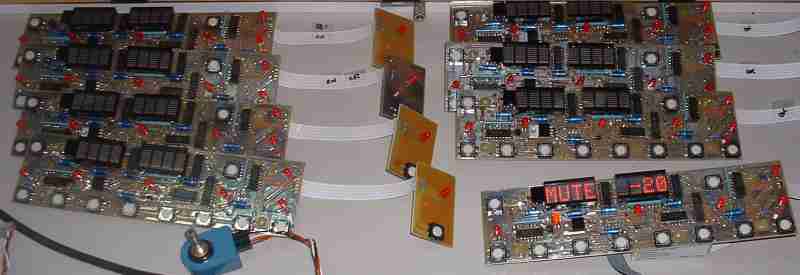

All kits tested ready to go

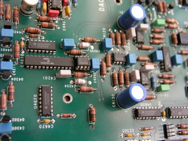

One of the upgrades to bring 380 status to this preamp is the change of I/V conertor chip. Originally OPA2604 was used and upgraded version use AD823. Madrigal claims that new chip is 12 times faster and has 6 times less current noise. They also add that the combination of speed and lower noise in this part is critically important, and a huge step forward in available technology.
This should translate in improved dynamics and improved manifestations: quiet spaces between notes are quieter, vocals are more full bodied and real, and the overall sense of realism is enhanced.
Well, after reading that I decided to replace the part and I had AD823 in my preamp. I also lowered the 4 surrounding resistors to 100ohm (as recommended).
Right from the start I knew it does not sound right. The vocals seemed indeed to have more presence, but also they were brighter, almost annoying) and the impression of space, acoustic was gone. Overall presentation seemed rather flat and artificial. I returned back to 1K resistors, and this improved things, but still nbot the point that it was even comparable what it sounded like with OPA2604. It just wasn't real enough, always leaving impression that one is listening to recorded music without anything that draws your attention. The magic was not there.
Today I placed OPA2604 back and things are good again: the 'magic' is back.
This makes me wonder if it makes any sence to replace other ICs. I already had dubts when I replaced input switch (BG411). I also thought that a previous part sounded better.
So my recommendation is use sockets and give your self a chance to listen to both chips, I installe dmine permamnently and had hard time with removing them back and forward.
I'm also interested if anybody else can confirm or have similar finding?
I will try it as well I just need to pick up these 100ohm resistors and I have sockets already in place. I was wondering why they were there :scratch: already installed but with OPA2604. I think that after Peter's comment everything is clear or so to say that someone has already made same conclusion as Peter.😀

Regarding 100 ohm resistors, untill you make up your mind what's better, don't remove the original 1K ones, but add 110ohms in parallel to those, so you can easily return to your previous setup.
The AD823 works well with 1k resistors so initially you don't even have to bother with replacing impedance.
Op275
