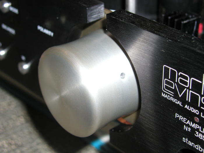

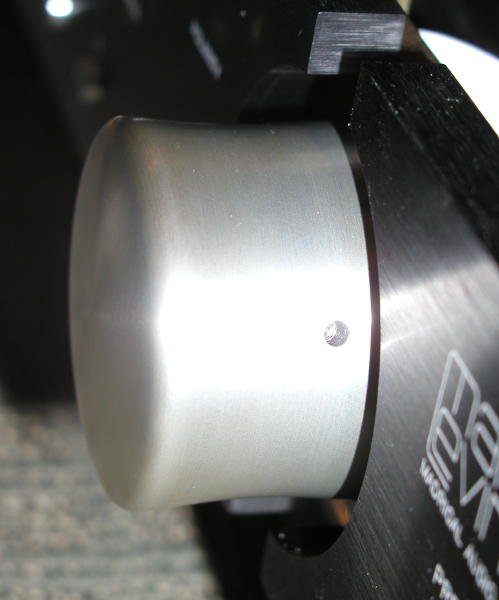

I was working on a knob today and here's what I came up with. The finish is brushing, etched a bit with alu cleaner and slightly anodized (not too much to still show whitish color, but enough for protection)
As this is true diy, I didn't look for help from machine people. I used 2" aluminum rod. Cut it to length first and drilled center hole (and screw mount) to be able to install 1/4" shaft.
First, I mounted the knob on hand drill and while rotating it, shaped on belt sander (80 grid belt). I made the side bevel, rounded the top face and created shamfering on the rim.
Later, I installed the knob on a drill press and while using maximum speed, proceded with further shaping by using air grinder and different grid, 2" abrasive pads. I started with 36 grid and finished with 240 and scotch brite fine grade pad.
The whole thing took me about 1 1/2 hr and later additional half hour for final polishing and etching.
Well, the accuracy is pretty good and I don't think it would be much easier to do it on lathe. This is pretty complicated shape and by slowly sanding it off, one is sure that desired shape is achieved.;)

karma said:
looks good are you going to make it white?
For now it's OK, it's pretty whitish anyway (after etching) and matches the buttons. When I'll have a chance I might give it to a shop for better finishing, but I'm not sure yet, have to see it in daylight.
However, the "feel" is much better with that heavy knob. The aluminum seemed pretty hard, it was T6511. Could it be because of that?

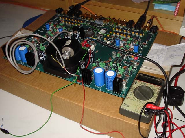

Hi guys! This is my humble version of the #38 board (not 38s) I bought. It is nowhere compared to the beautiful work by Peter Daniel here(wow!). It is a lot of work to get it working, but hey i didn't have a schematic <sigh> Can u guys point me to a right value or model for the HP encoder? Mine is 500 turns & seems to take forever to adjust volume. In time I would like to add a display and input switching too, maybe remote too :) Hope the picture shows up...
The best person to contact regarding encoder (I think it's either 100 or 200ppm) and display board is a forum member: Algar_emi. He designed, based on original schematic and photos, the fully functionalal display board, as well as remote control board and a small, Stand by board. I think the original HP encoders are still available from ebay, but they have to be modified, so even when they are pretty cheap (about $10, after modification the price is pretty close to the new ones from Newark).
markp said:
How much did it end up costing you? Did you save any money?
The regular ML38 board came up to about $200, including shipping from Singapore. ML38S was double that price.
