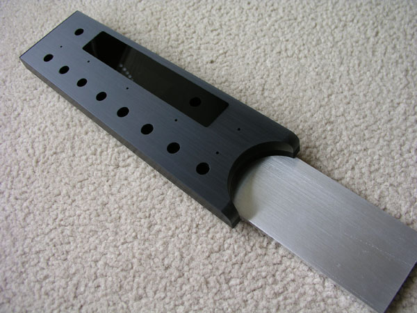

kasra said:trigon: what material is the front made of?
/kasra
It is the same brushed acrylic as Peter's front panel. I have only used double layer with black acrylic as bottom plate.

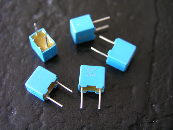

Peter, what do you think how it will sound with these MKP1837 Vishay-Roederstein

What type of acrylic?
Guys,
What type of acrylic are you using and where did you get it from? The panels look wonderful and I would love to experiment with this stuff. Any help is appreciated. Anyone have pictures of their step by step Mark-Levinson front panel construction process? Would be a great educational thread - superb basis for other DIY panels

It says "CYRO Acrylite GP" on acrylic sheets. It is tinted type (so it is dark, but still seethrough). We got them locally, from Plastc Warehouses. Cut offs are usually cheaper.
As you Trigon already improved on my original idea, as he added additional black piece behind the tinted piece for reduced transparency. Came out really nice.
It is very easy to work with. I do initial cuts on table saw, then use router to form final shape (with straight bit). After that the edges (or sides) are sanded on belt sander (with 100 grid belts).
Later all necessary holes are drilled ( this is a tricky part as the drill's tip is rather important to make proper hole, and not to break it: sharper angles are preferred).
After that a paper protective mask is taken off, a regular clear tape can be applied to define the winow (opening) and abrassive pads is used to make the brushing. I'm using those purple Scotch Brite pads available from home improvement stores.
The results are truly spectacular
