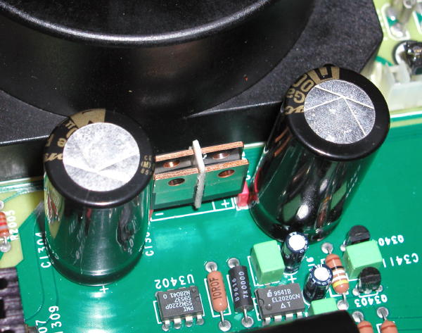

I did some mods today, and the change in a preamp is quite amazing.
First, I replaced stock bridges. In digital section I used MSR860 diodes and in analog section, MUR860. I also tried BYV28-100. Although the latter were not bad, they somehow presented more flat soundstage and were slightly bright. MUR860 provided more natureal sound, more 3D and more involvement.
I also replaced original regulators, 78xx type, for low dropout type (from National), used in 38 to 380 upgrade.
Those two mods made the preamp to open up, and the lack of highs extention wasn't as noticable as previously. It actually started to sound pretty good.
Next thing I did, was changing the caps. After the bridges, there are two caps in parallel: 2,200/35 and 6,800/35. I replaced the first one with BG F 1000/35 and the second one with Panasonic For Audio cap (3,300/63V). I removed those caps from Technics CD player (guess one of the better ones, as it was CAD $8,000 in 1991). I also replaced 68u/63V cap (located right after regulator) with 4.7BG N.
Well, changing those caps made the preamp to sound completely different. Dark character is gone, there is extention in the highs with lots of air, the pace and rhytm are very presentable and the detail is amazing. The sound is very fast and you can easily concentrate on any specific instrument without being distracted by other sounds.
I see lots of potential in this preamp now and I think it already improves the sound of the amp. The sound seems to be better with the preamp, than when using passive attenuator. And there are still so many mods to perform😉

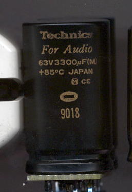

Here's a pic of the Panasonic cap. It is one of the few caps that comes originally without plastic sleeve, it is just painted black. I new right away that it may be good😉

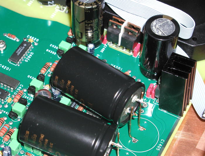

Hi Peter, thanks for the advice. Any pics of the modded pcb to show us? I never really liked the idea of op-amps over discrete circuits but seems your great work has fueled my enthusiasm again!

Peter, how about trying some standard panasonic FC instead of these fancy schmunzy audiocaps. I suspecy it was the smaller caps rather than the brand to do it for you, it would be good info to know whether it was so. Or maybe it was the way you attached the caps. 😉
It may be the smaller size, as I'm noticing it all the time that smaller caps just make it sound better: faster and better presence and detail.
But also BG N caps are in a totally different league altogether and they may be doing something here too.
But I would recommend to everybody, don't use more capacitance that is necessary😉
