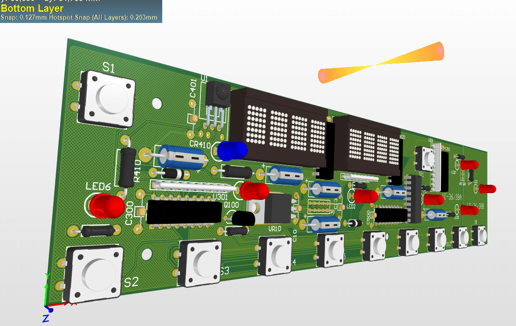

Hello, I found one Agilent HEDS-5701-C00(100cpr) from eBay. I found it working, but is too slow for my M38S. I found some pictures of M380S and it had C12. I think ML have changed the encoder and the chip in some point. I think ML38 and ML38S have G12 or other much faster type. I am planning to try HEDM-5500-G12. The ML380SL seems to have yet new type... this is very difficult part to find. Last night I ordered parts for front panel interface from Mouser. I hope this helps out.

- Building Mark Levinson 38 preamp chassis from scratch
