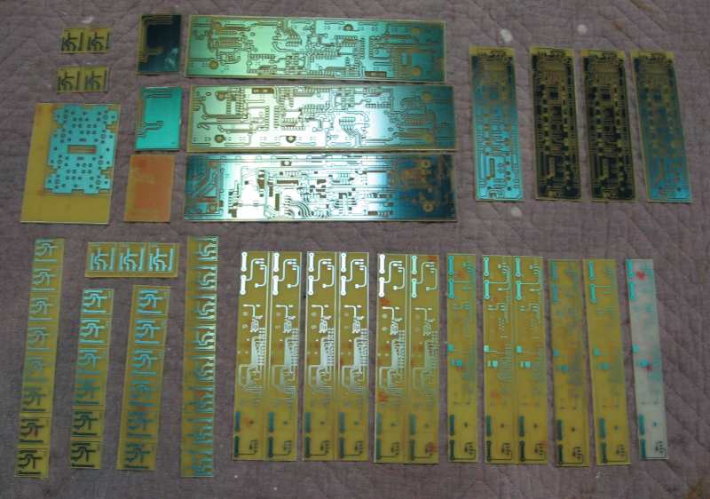

Hi. If you have a main PCB that you like to use, just to let you know that I built a few new sets of front control and remote PCB.
I will have two complete sets to sell, including the hard to find HP/Agilent optical encoder for the volume control
The kit includes:
-Main front PCB and small standby button PCB with needed cable to main PCB
-Remote PCB with battery holder and button caps that will match the upcoming remote plate.
-NEW This year: Rear remote PCB with 2 flat cables to connect to the REC OUT outputs on the main PCB
-HP Optical encoder (volume) with needed cable and connector
-EMI entry AC Filter
-AC selection jumpers for 120V or 220V operation as needed.
-CD documentations, manuals, pictures, parts list, etc.
-LM380 code upgrade EPROM.
You need to provide the Neutrik Connectors and the 2 pairs of Cardas RCA connectors for the REC OUT connectors on the back.

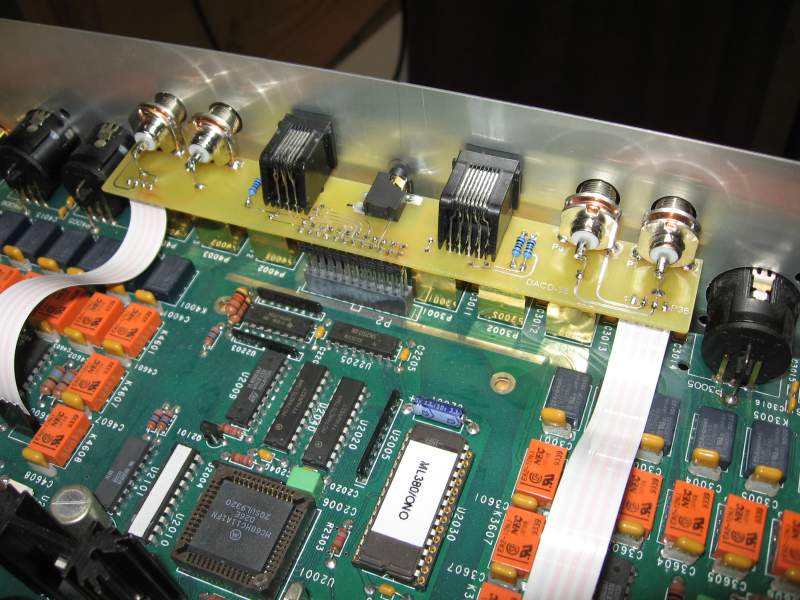

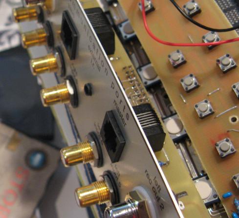

Here the first prototype of the small PCB that fits on the back of the preamp. It has thte RJ12 and RJ45 Master & slave connectors, the IR remote, 1/8 jack and both pairs of REC OUT RCA outputs. Pretty close to the original. A real pain to assemble, very small PCB traces, a lot of jumpers and the Cardas RCA are tough to solder. But a very nice look once done

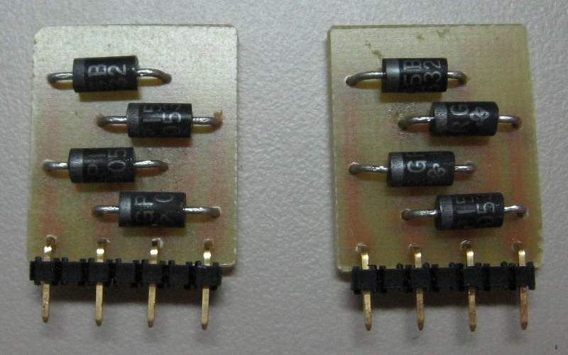

Hi. Good question and not easy to answer. My own ML38S modified to ML380S is using MUR860 diodes. But doing my research on the ML380 original upgrade kit, I'm pretty sure that ML use originaly MRP10B diode . This diode is the little brother (smaller rating) of the MRP15B they use in their top transport ML31.5.
I like the MUR860, but I really like to try also the MRP10B. I didn't have the time yet to do so. I just completed the small mounting PCB. The price of these small diode is so low that you may try both and decide which one you prefer. Bye...

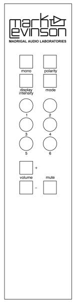

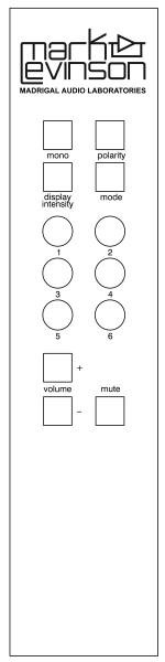

For the guys that bought the last kits in 2007 with the new remote design (with button with studs), I will also provide a remote front plate. This plate is an exact replica of the original but with mechanical specs to accept the new remote and button choice.
