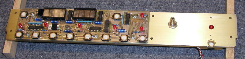

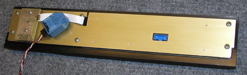

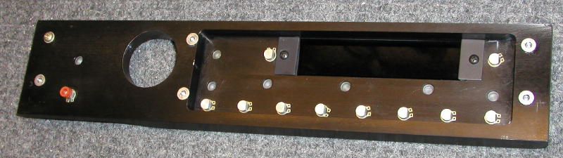

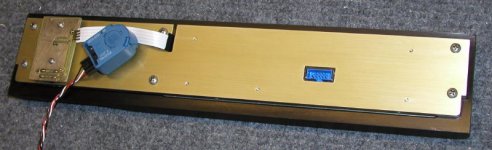

Yesterday, I decided to implement a "real" front panel on my ML preamp. I bought some ML36 DAC panels as those seemed very suitable fro a preamp as well. Here's display board mounted on front subplate. The plate is alodined, that's why gold color.

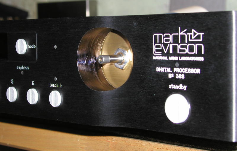

The close up of the hole. Panel thickness is about 1" here, but I did not have any troble using 1 3/4 hole saw for that purpose. My advise is to use one size smaller first (in my case 1 5/8), but not completely through, and then finish with final size. As you see the edge came out very good: clean without any burrs.

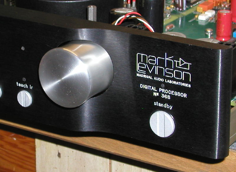

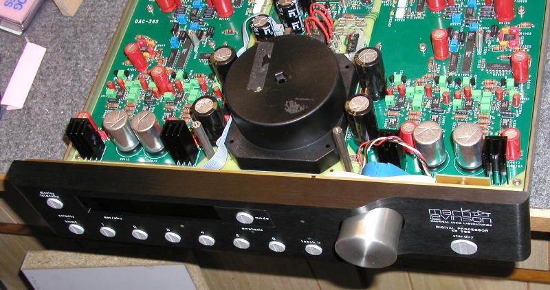

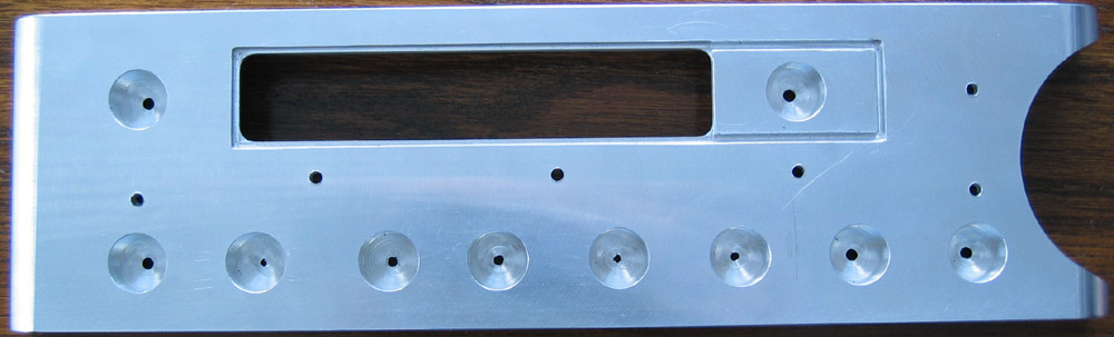

And finally, the knob. This time I went for a different look. This arrangement is similar to ML32 preamp (with an exception that my knob is 1.75, ML32 has 1.5 knob). I was already getting a bit bored by the big 2" knob in center, and this seems to be more refreshing. Took me about 3 hours to fabricate the knob, having aluminum mounted in a drill gun and using belt sander for shaping. I'm pretty much satisfied with a result. Later I etched it and lightly anodised. It will not discolor or stain.
I have more than 50 BG caps in this preamp, mostly N type😉

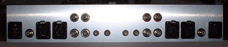

I'm putting together a small group purchase for the ML38 back aluminium identification plate. It will be exactly like the original ML38 plate 😎. A perfect copy, great quality scratch resistant, anodized aluminium with serigraph lettering and holes already drilled with CNC machine. The real thing. I did a high quality (700dpi) image for the lettering using Photoshop and use AutoCAD to provide a dxf file for the drilling. Using Photoshop I reproduced perfectly exactly the same font and font pitch used on the real plate.
On the real ML38, the rear panel is part of the case, 1/8" black anodized aluminium. Then an nice brush aluminium alu plate is installed to identifiy the in/out.
The plate has all the I/O connectors already drilled including the rec/out 4 rca connectors. The holes will accept Cardas GRFA RCA connector. The remote control RJ connectors are identify but not drilled, since most user won't install them anyway.
The rear panel will then be identical to this image, See: http://www.marklevinson.com/image_library/380RP_lo.jpg
The nice thing also is that this plate can be use as a drill guide for the structural rear plate.
I received today the prototype drill plate without marking. It fits perfectly, see image.
Contact me rapidly if you are interested. I'll place the order by next week.
