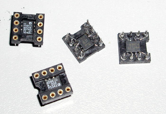

BTW, if I wish to use two single opamps using an adaptor that is being shown in one of my pics
do I need to solder ecap and bypass cap on each single opamp or just solder one ecap and one bypass cap at the adaptor pins?
