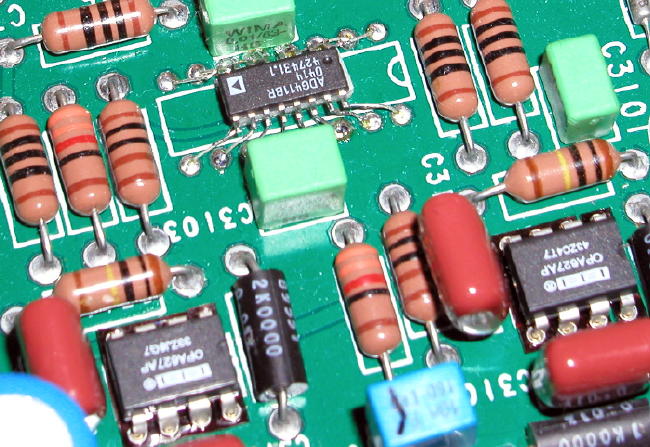

Sunsun22 said:
Hi Carlos,
Talking about the bypass caps on the opamps. There is no ground pin on those opamps, do I need to use a wire to ground it to the PCB? Thanks,
Sunny
Yes, there is no ground pin.
You need to find a ground as near as possible from the op-amp.
Sometimes one of the original PSU caps is near, the other one is far away.😀
Or you may have a ground line passing nearby.
Use your DMM if in doubt.
The worse the layout, the more difficult to do this.🙄

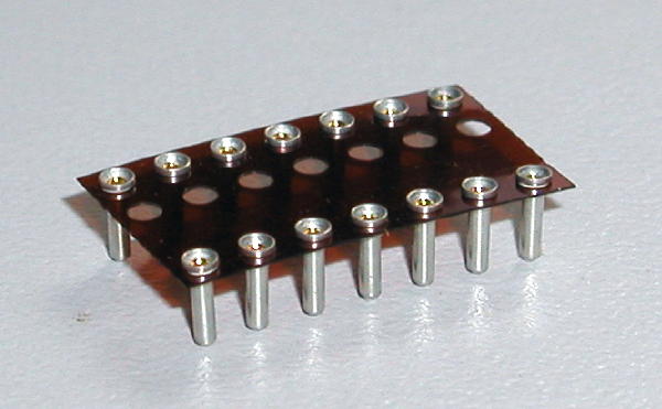

Sockets........?
Both op amps and decoupling caps in sockets? You are adding parasitic inductance and ESR that are greater than that of the cap itself. Not only will this move the resonant point of the caps and add damping, changing the way the film bypass cap interacts with the other filter caps, but it can move them to a point where they sound better when in the sockets (for awhile until the leads oxidize and the socket ESR changes over time).
This might even be complete waste of time to see how the capacitor is going to sound when soldered in to the board. You had better test the film cap with the exact type op electrolytic that you going to use since even changing the size for a given electrolytic of the same brand, voltage and capacitance will move the resonances to different frequencies and Q's. I know it is probably quick and dirty, but is more dirty than quick.
How long does it take to solder a capacitor in than stick it in a socket? I think I might be paying more attention to Carlos about decoupling. Doing this way will mislead you as often as not. I thought most of this had been covered on the forum. No offence intended but maybe a little more reading and less "leading" is in order?

Re: Sockets........?
I don't know why, but it feels like I'm reading Fred Dieckmans' comment.
While what you say is true, but let me do things my way.
It doesn't take long to solder one capacitor, but it takes much longer to solder/desolder 20 capacitors, especially when you have to remove the board from a chassis to do that. If you are testing 60 caps it takes even longer. I'm not even mentioning 4 layer board and the chance of damaging it while desoldering.
And the difference between caps is very obvious even when mounted in sockets.
Desoldering op amp from this board is virtually impossible. I tried it once and I damaged through hole plating, I just cut it off now and desolder ea. pin separately. The sockets for op amps I'm using are special type, without any plastic parts and pins flush with a board.
Here you are, Fred:
